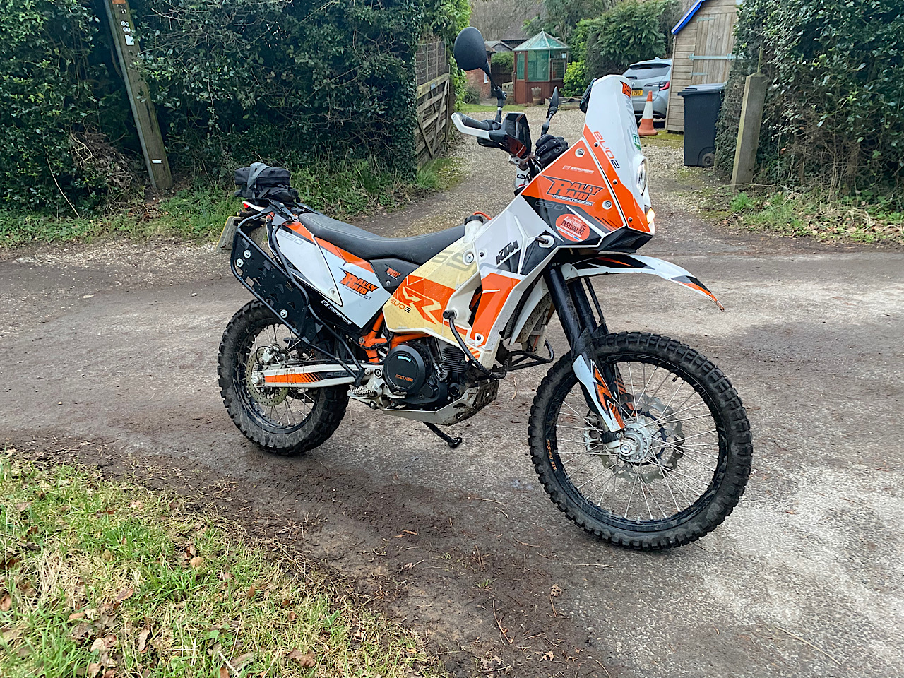

It’s got tkc80s on it at the moment which are 60/40 off-road/road. I’ve never used them before so will give them a go. If I don’t like then I’ll change them to a d606 rear and mt21 front that I’ve used before and like.

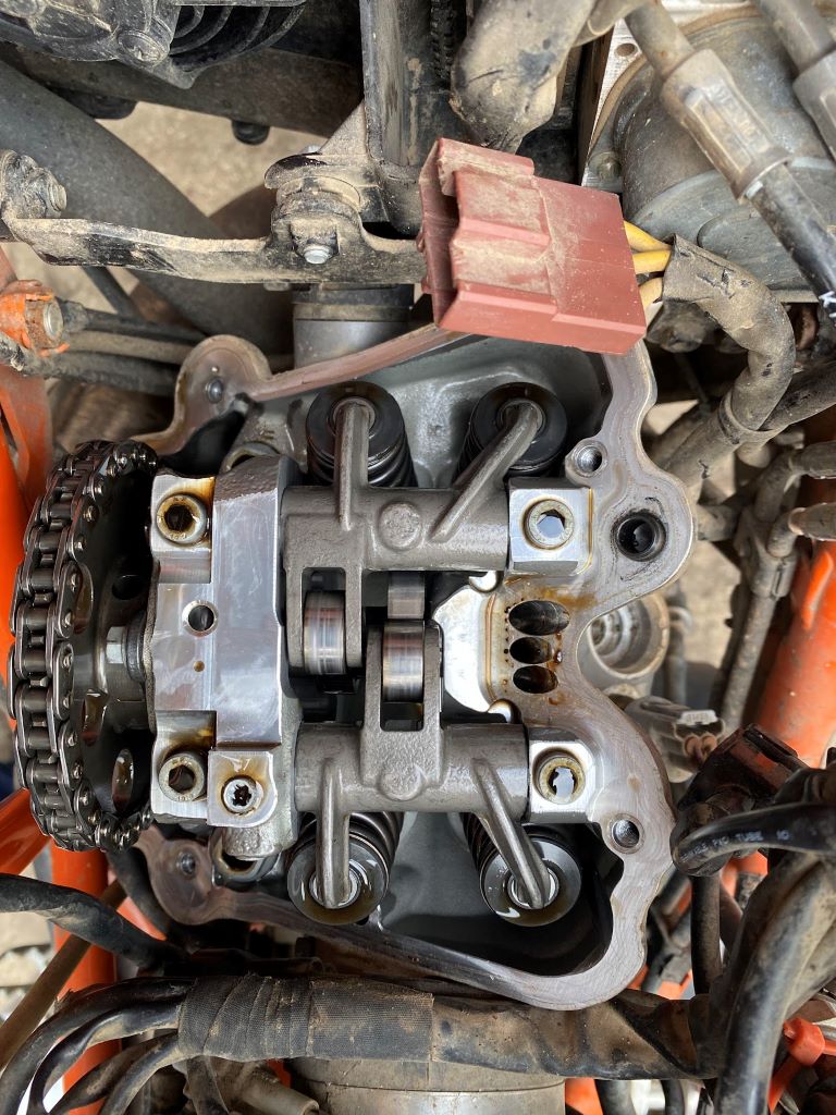

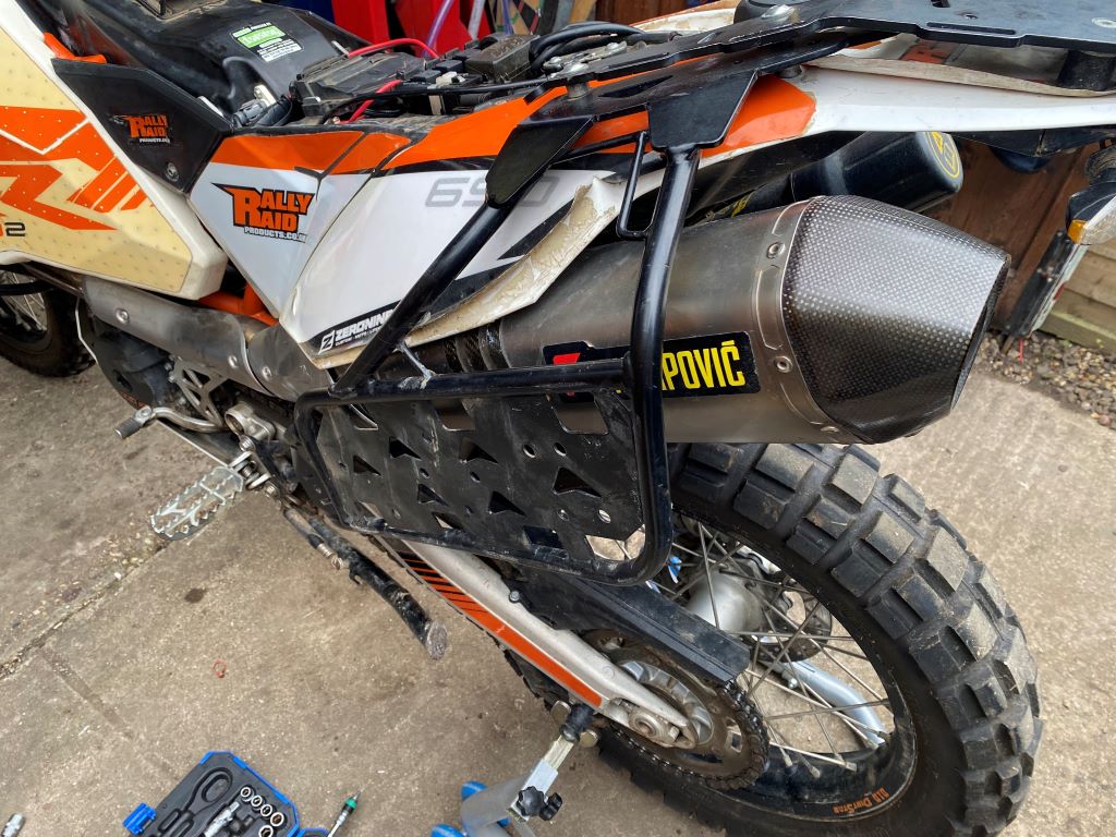

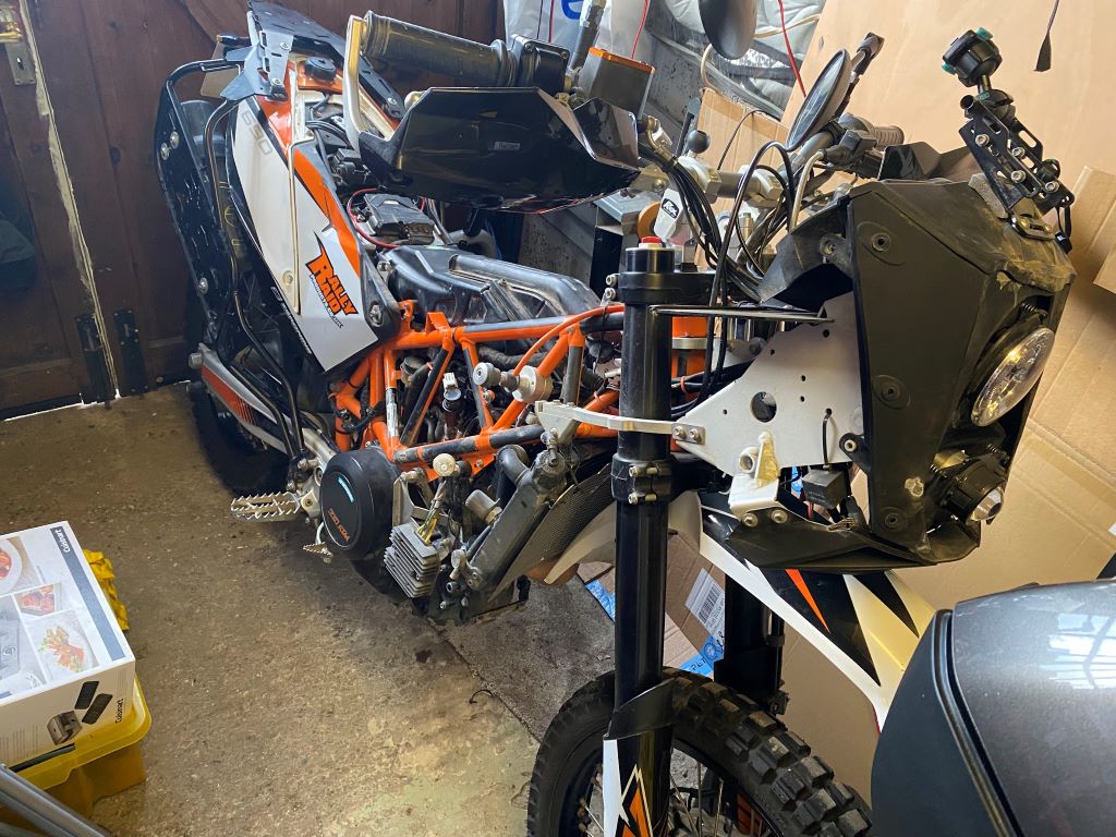

Had more time to look at the bike over the last two days than I anticipated so checked the valves as well as servicing the bike. Bit of a faff getting all the rally raid tanks and stuff off but will be much easier next time now I know what I'm doing. The pivoting bar risers are a great bit of kit and let you put the bars just where you need it. I ditched the kriega luggage plates as they looked weird, I couldn't see a use for them and it was just more weight.
The valve clearances were all in spec and the rockers and bearings were as new. You can see some witness marks on the rollers but they can't be felt so no where to speak of as you'd expect after a couple of thousand miles.

I've never seen inside the head of a 690 before, I can see the idea behind having rollers on the cam followers, but I've never seen another engine with that and I wonder if it isn't just unnecessary moving parts?

I can’t recall seeing them on anything else I’ve serviced. It seems like an obvious reduction in friction I guess but every other engine works perfectly fine without them. Also these seem to be a point of failure on these bikes so can’t really see the point.

They're pretty standard across Harley'sLe_Fromage_Grande wrote: Sun Dec 24, 2023 1:41 pm I can see the idea behind having rollers on the cam followers, but I've never seen another engine with that and I wonder if it isn't just unnecessary moving parts?

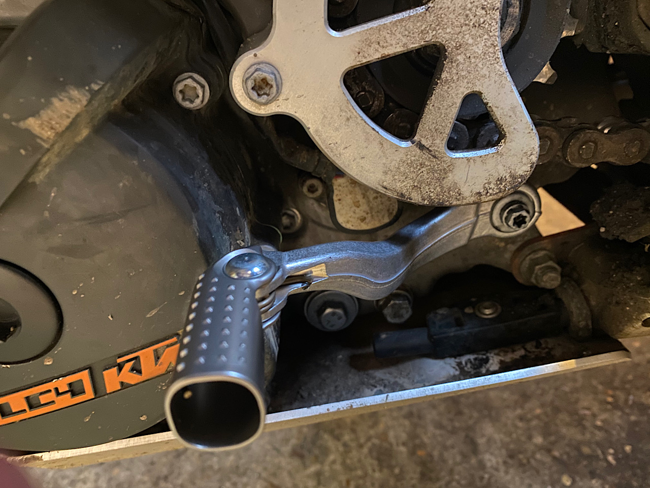

I am going to have to change the gear lever as it’s horrible. I saw this in a YouTube video a while back and wanted to see what it was like but it needs changing. The folding end folds in when you change down. The solution is to use the gear lever from a 2017 ktm 450 exc, part number 79434031100 which is the same dimensions but a longer end bit and a stronger spring.

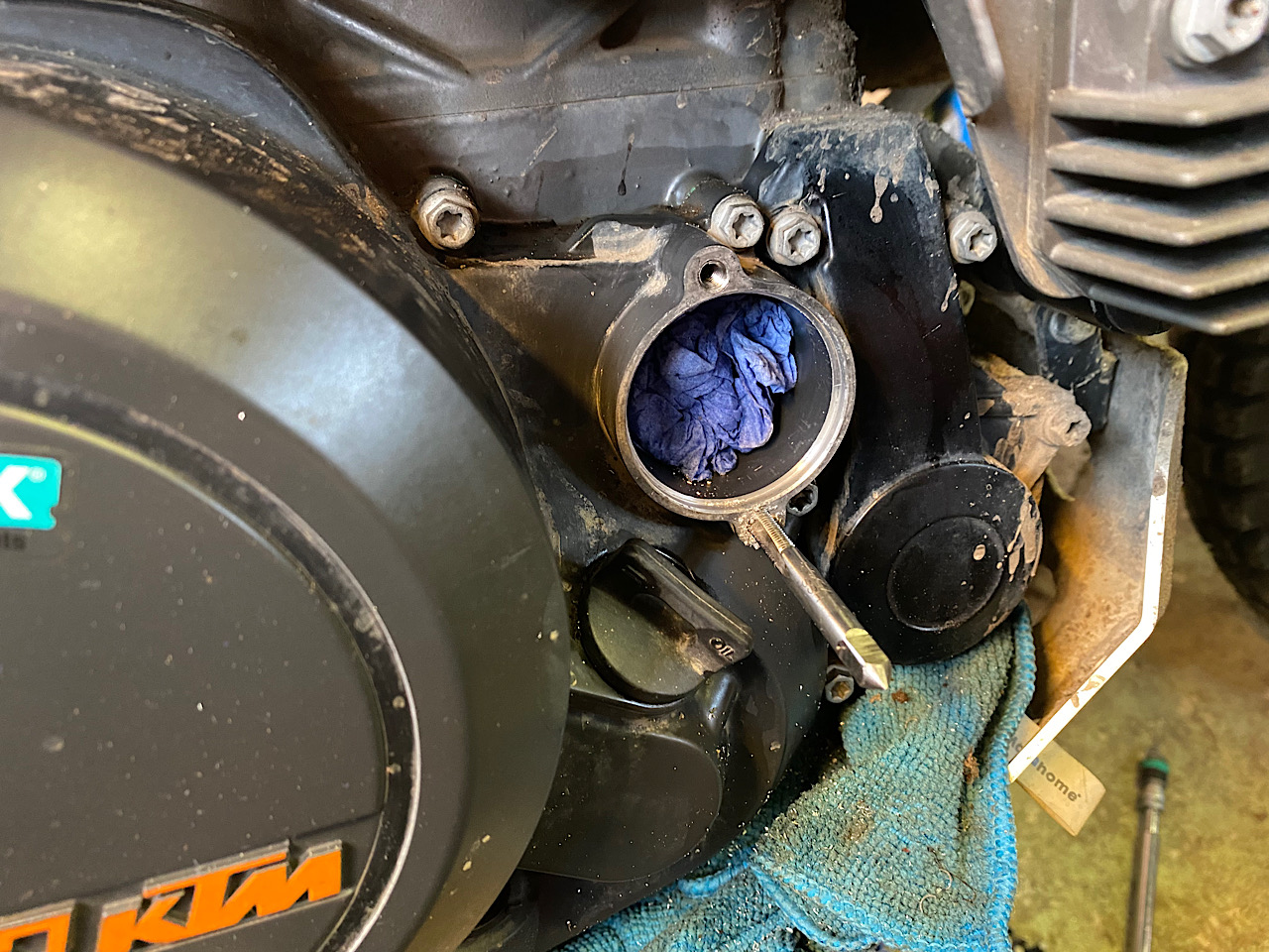

Replaced the gear lever with one from a 450 which is a perfect fit and feels a lot better. I also drilled out and helicoiled all the 8mm threads holes holding the oil filter covers on as all the threads have been damaged by some monkey in the past.
