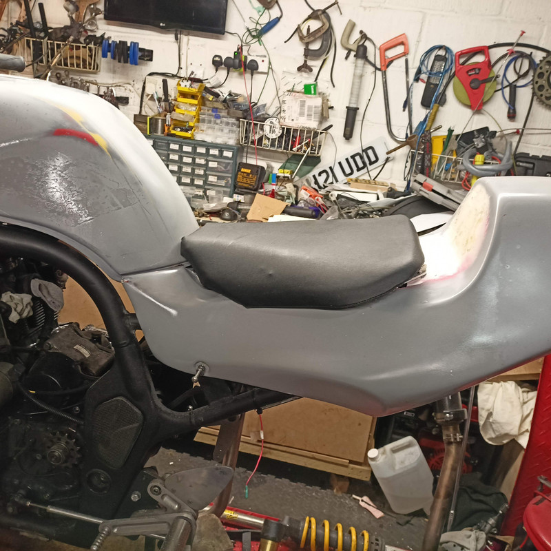

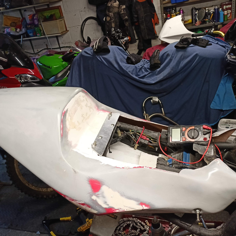

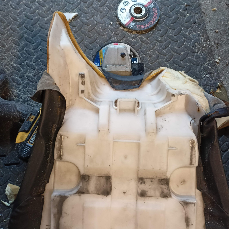

Bob’s comment above particularly made me smile, and I know he’s right- some of the stuff you see in a club race paddock is shocking aesthetically with all manner of wood, MDF, self-tappers, coach-bolts and gaffer-tape holding them together ( I have a sneaking suspicion that our Canarian member’s much posted scabby old LC would have fallen into this category ), but although my Bandit is I guess typical, just knowing that sort of stuff is there, even if it’s not on display, makes me itch so I set about sorting the seat issues.
The easy solution would have been to chuck a little bit ( well, £130ish) of cash at it, and buy a nice new fibreglass race seat, but having chosen this bike over that lovely freshly built bike I mentioned in an earlier, ’ve sort of set myself a challenge of saving money where I can to justify that decision, and of course save the planet along the way

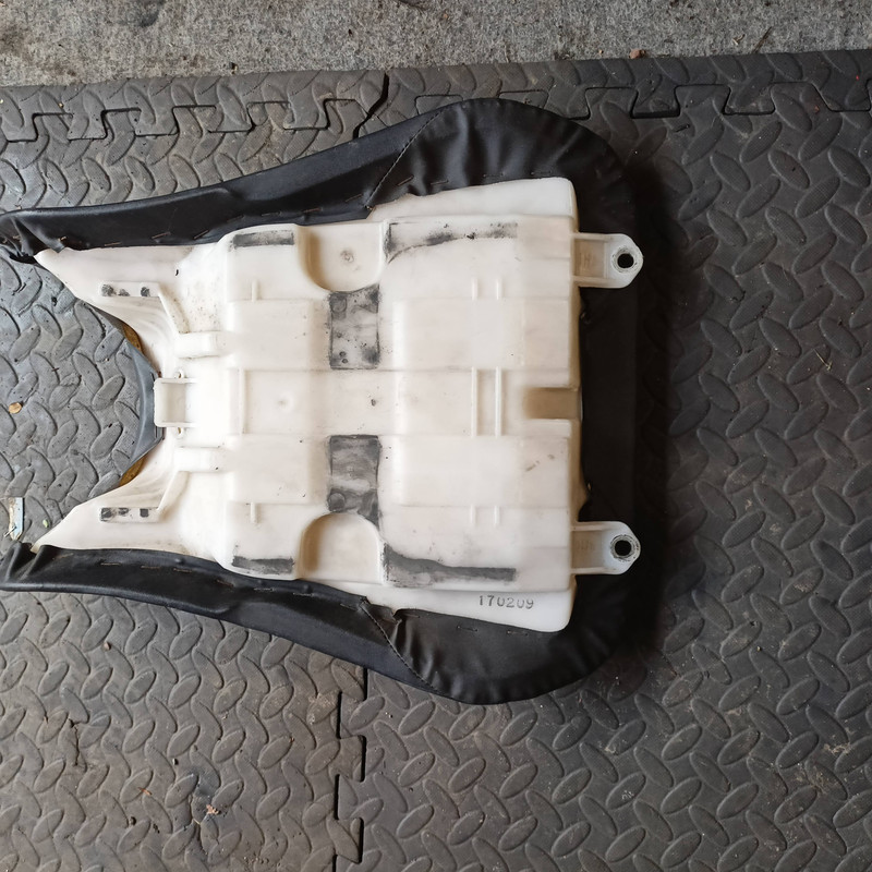

So, looking at what I had ( am not certain, but pretty sure that this seat was originally intended for an old PI R6, or Gixxer) , and thinking of the seat height I wanted ( although the previous effort it looked shit I thought the height seemed good in relation to pegs, bars etc when sitting on it) I decided that another pile of race foam wasn’t going to cut it, and I’d see if I could make an OE riders seat from a sports bike fit.

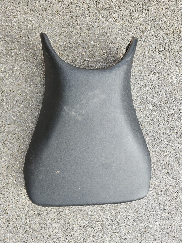

I started with offering the one from my Tuono up, purely as it was in the garage, but it was loads wider so I started looking at pics of 80s onward sportsbikes. It looked to me as though an R6 or early R1 seat might fit the bill, so after seeing a 5SL ( the first FI R6- 2003ish) seat for £15 on eBay I thought it was worth a gamble, and if I couldn’t make it fit, I’d just buy a new one-piece fibreglass race seat.
So this is what I started with
The width was pretty much spot on, but was much too long at the front so out came Mr angle grinder, and after a good few cuts of both the existing fibreglass seat unit and the seat pad itself (after unpicking the staples holding the cover on of course), it was getting close
Once I’d got it sort of the right size and sitting at what I think is the right(ish) height, I then had to think about how to secure it, which basically entailed making a couple of brackets out of 3mm ali sheet ( no wood here ), like so, a tang at the front and two studs to bolt it down at the rear
And this is it fitted- Yeah, it's nowhere near a perfect fit to the lines of the fibreglass, but it sits solifdly on the frame and my new brackets mean that both the fibreglass piece and seat pad are now properly and securely mounted, they can be removed and re-fitted in seconds with a 10mm spanner, and I think it will look much better once the rear pad is fitted fibreglass is painted, and I may also trim the seat base and foam a bit more to improve the looks

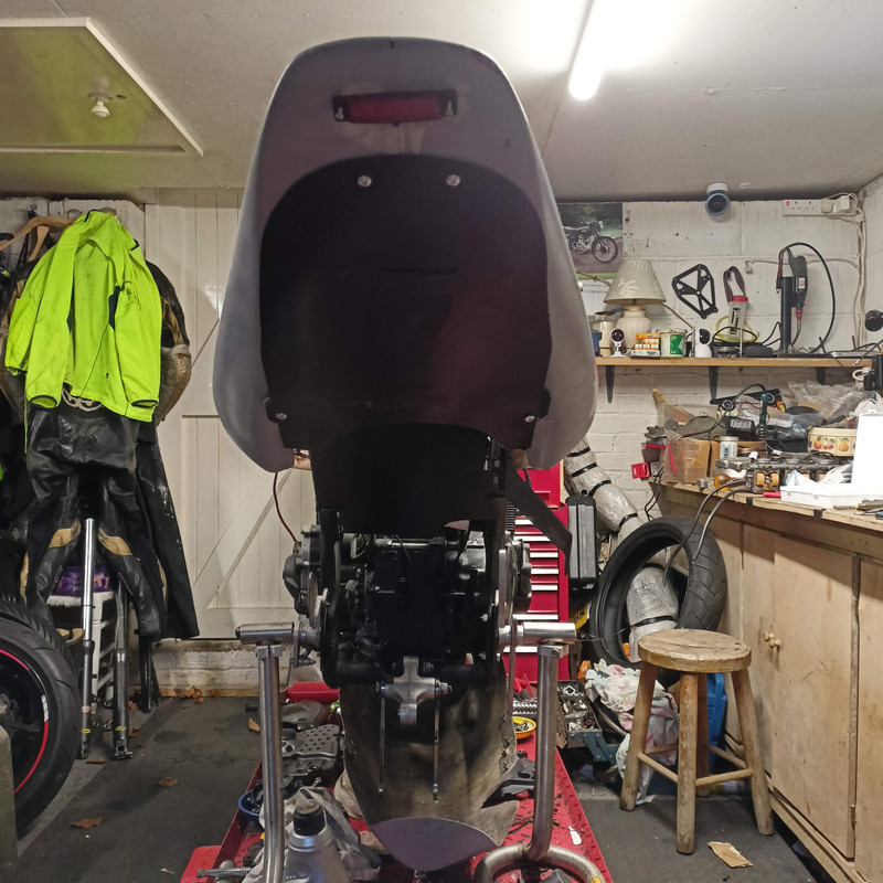

Next, I turned my attention to the undertray.
Previously, this was secured with cable ties only, and whilst that kept it in place, it’s a real faff when re-fitting, and well, there are better ways of doing it IMO.
So I pop-rivetted 4 x Dzus sockets onto the seat unit, and job-jobbed.
Any of you who aren’t asleep will notice that the two in the middle at the back are a bit off-centre, but that is because that’s where some of the previous cable ties were through, and I didn’t particularly want to drill even more holes in the seat unit, and they were close(ish) enough.
Whilst I was at it, I’ve also mounted a £7 LED rain light too.

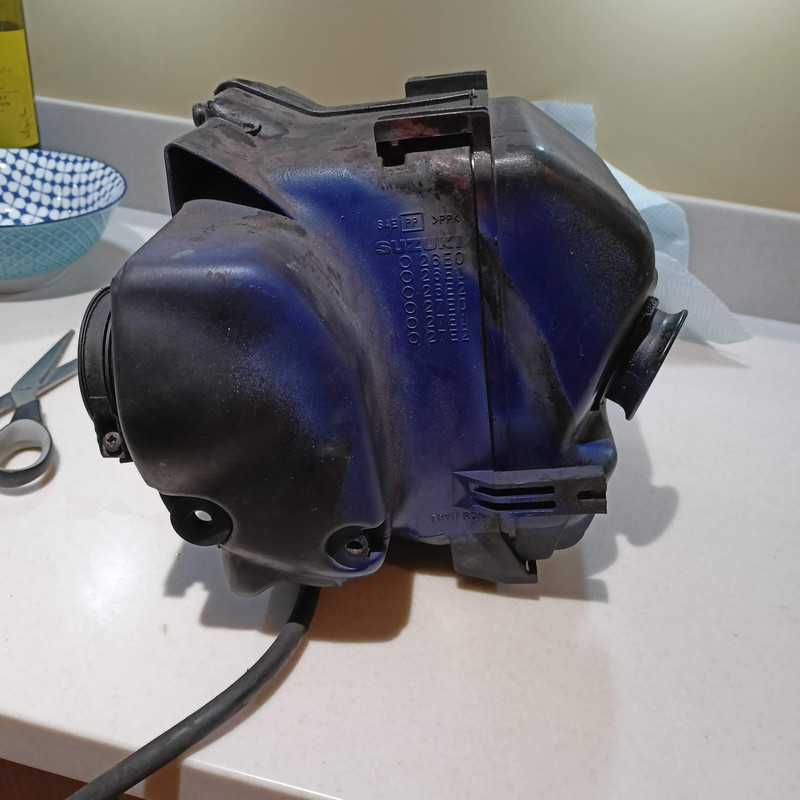

I’ve also invested the princely sum of £18 on a new ( to me) airbox, as the old one is very tired with the tangs that secure it to the frame, and one of the ones that secure the lid all broken- this is the “new” one
As you can see, it has seen some rattle can action ( bet the bike it came off looked nice eh ), but that’ll clean up, and it’s structurally in good nick which is the key thing

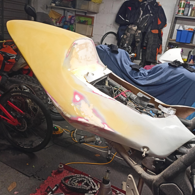

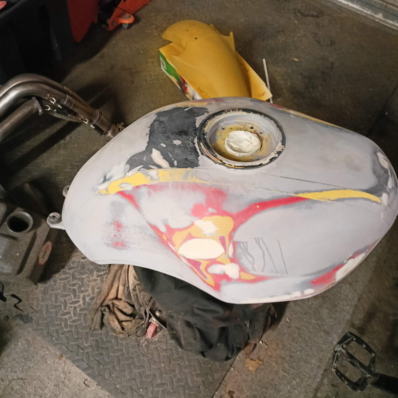

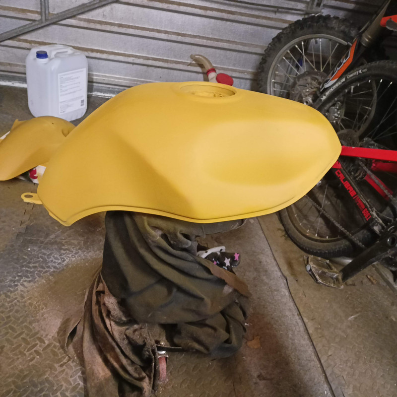

Time for another little update.
Swing arm has now had a bit of a rub-down, a bit of primer where needed and a couple of coats of rattle-can satin black.
@Potter 's comment a few posts back about duct tape and tie-wraps, along with my distinct lack of responses/ calls back from painters and wrappers made me think a bit and change tack- he's right, it's only an old Bandit club racer after all, so rattle can is what it’s getting all over now – will save me a good few £££ into the bargain too
So out has come the filler and rattle-cans and currently the tank, front mudguard and seat are filled as good as there are going to get- prepping is tedious eh
And I’ve also now given them a coat of that matt yellowy filler primer.
Not started on the bellypan yet but that’ll get the same treatment.
I’ve also changed my mind on the colour scheme- I was planning on banana yellow all over, but from what I can gather half the grid is going to be that colour (well the ones that aren’t just a munged together heap of standard mismatched scabby panels are ) - as for what I’ve changed it too, well you’re going to have to wait until I’ve done it to find out, but I’m going slightly retro, it's more than one colour and non-Suzuki- that’s all I’m saying at the moment
And as the bike desperately needs new throttle and clutch cables, and Venhill will do you pretty much any colour outer for no extra charge, I thought "Why not", and I’ve done a Bellwood - no boring black cables here, it’s getting matching colour control cables- how cool is that eh?
Aside from the cosmetics, there’s not been a huge amount more progress but I have sorted the battery box situation- as previously mentioned, the shock was supporting it- not really a great idea as aside from the vibration damage that would likely result, it was wearing away both the battery box and (admittedly crappy and due for the skip) shock.

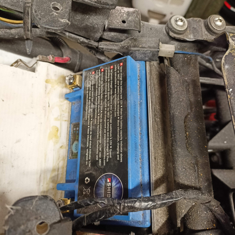

This is how it currently sits, which means the bottom touches the top of the shock, and it moves when the shock does…
And this is how it needs to sit IMO

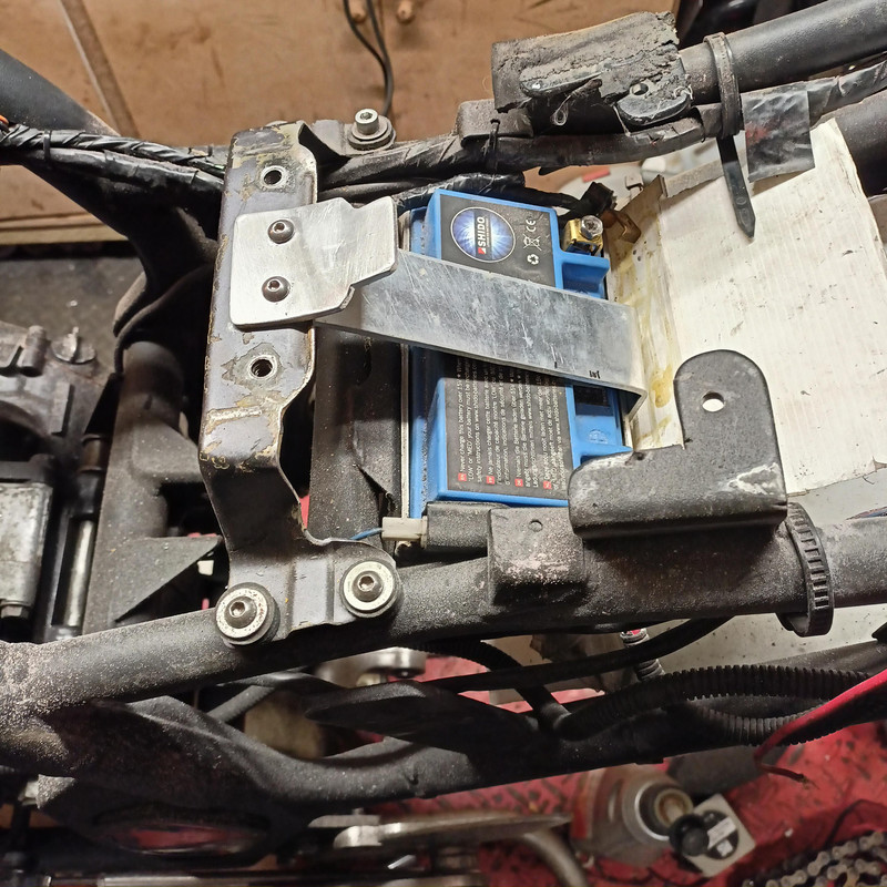

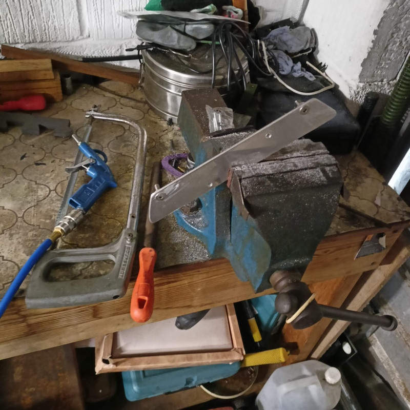

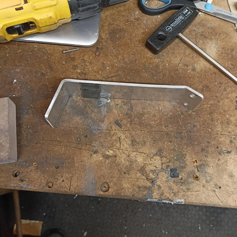

My first idea was the drill and tap a couple of holes in the frame cross-member behind the long edge of the box and bolt the box to it with countersunk screws, but as soon as I went to take the battery out to remove the box and do it, I realised the flaw in the plan, as the box has to swivel towards the back of the bike ( basically it’s resting position when the shock is removed) to be able to get the battery out, so if I had gone with this plan, I wouldn’t be able to get the battery in once I’d secured the battery box
So, a little bit of a re-think , out came the hacksaw and file and my Heath Robinson solution is this
Basically another piece of 3mm ally that bolts on underneath my new seat front bracket, and holds the back of the battery box up nice and tightly like so

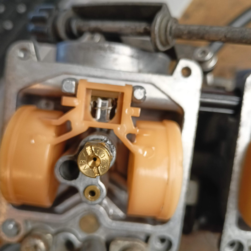

Aside from that, the only other thing I’ve done is drop the float bowls off the carbs
-All nice and clean in there so far and I’ve discovered that it’s running 102.5 main jets in the outer two carbs and 105s in the centre two, a little up from standard which as far as I can gather would normally be 100 and 102, but that’s as far as I’ve got.
I need to pull them apart completely and give the cold-start jets and pilots etc a good run-through, to see if that sorts the cold running issue.

Your paint looks a lot "Neil, Neil, orange peel" in the photo, alloy brackets look good, one size up on main jets isn't much, if it has a race pipe I'd be going two sizes up.
