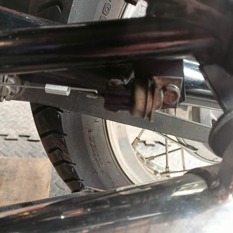

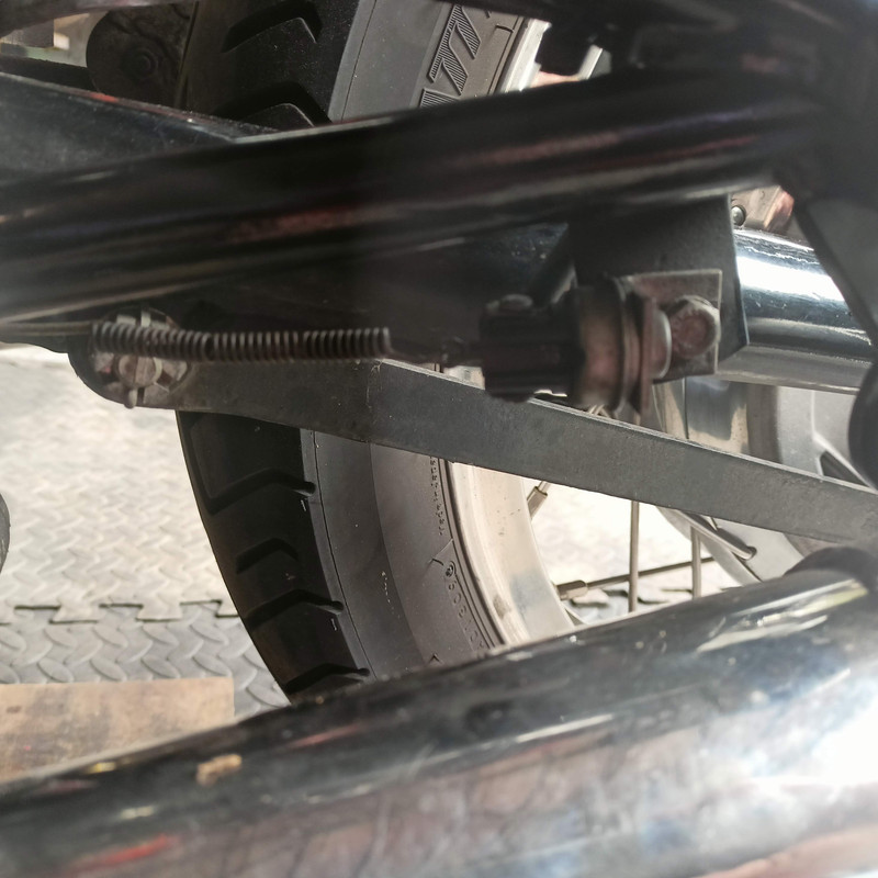

Just a little update- when I got back from my run around the lanes on the old girl a few days back, I noticed that the brake light was stuck on when I got home, and on further investigation, wasn’t working off the rear brake most of the time, so I set about sorting that out today.
Like a lot of the little things on this era Italian bikes, it’s not really a thing of beauty, and it’s in a place where it will be underwater pretty much the whole time whenever the bike’s ridden on wet roads
It is the original switch and hence fairly ancient and well worn, it was very inconsistent in operation, sticking on sometimes and not working at all other times so I thought that chances are I’d have to replace it with a generic Chinese one as the originals don’t seem to be still available, but before I did, I took it off, pulled it apart, cleaned it up internally as best I could, gave it a bit of lube and voila! it’s back from the dead, well, for the time being at least :)
Externally it’s pretty weathered and horrible, so when I send some odd bolts and spacers etc off for re-plating soon I might take it off again soon and see if I can improve it cosmetically, but in the meantime, I’ve just treated it to a new shiny spring :-)

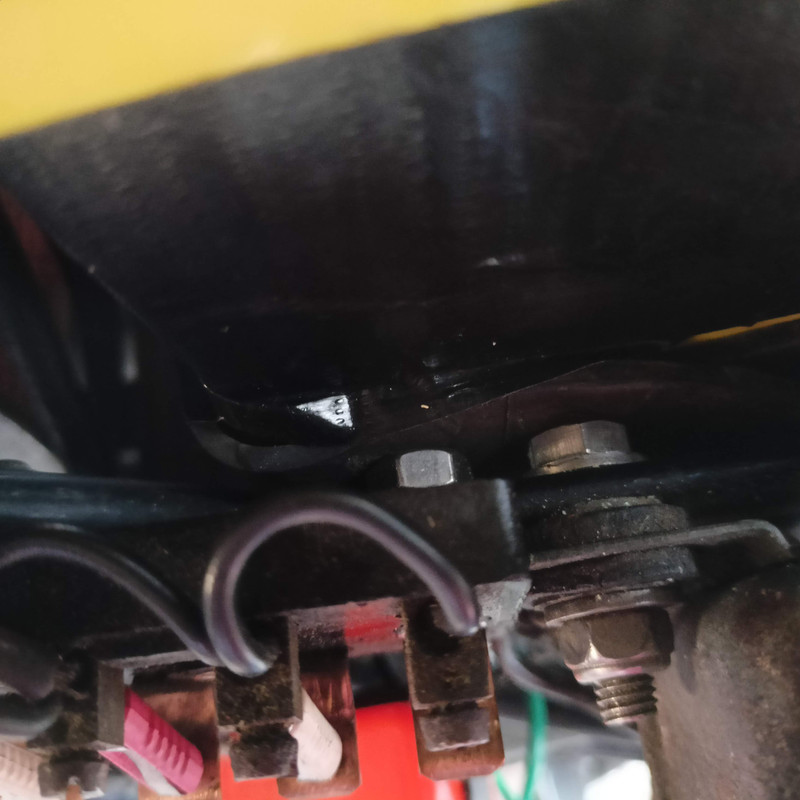

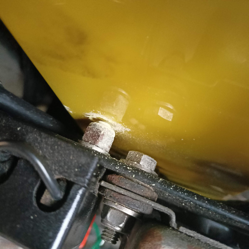

One positive of having this minor issue was that it caused me to remove the LH side-panel to chase the wiring through and I caught this before it did any serious damage- I should have spotted it really when I secured the battery months ago, the nuts holding the fusebox on are unnecessarily deep ones, and vibratey thing that this bike is, one of them has been digging into the ( slightly non-standard size ) Motobatt.
Anyway, the good thing is I caught it before it punctured the casing, so have shortened the screws and replaced the nuts with regular depth ones so they can’t make contact, and also taped some double-thickness enduro inner tube around that area of the battery too for good measure.
