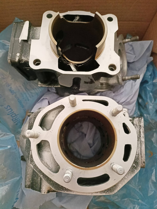

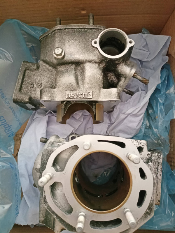

Vapour blasting is probably the least intrusive of all the blasting methods, and not the method you’d use if you wanted to get rid of paint or rust etc, but it was perfect for what I wanted here, namely to remove the old carbon and gasket remnants and any loose paint, ready for their new coat.
So that’s what I’ll be doing today/tomorrow and when they're painted to my satisfaction the motor will go back together as all the new pistons, gaskets etc were purchased weeks ago and are just sitting there waiting for me to get my arse in gear.

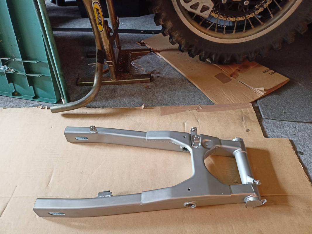

A few weeks back I rubbed the swinging arm down, primed, and put the first coat of silver on ( which has now had plenty of time to harden
) so it will get a light flattening with 1200 grade and another coat today, allowing me to re-assemble the rear end of the bike.

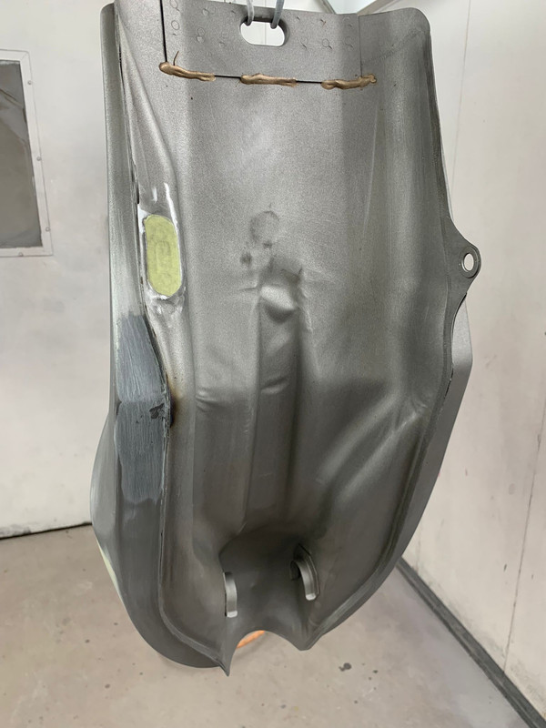

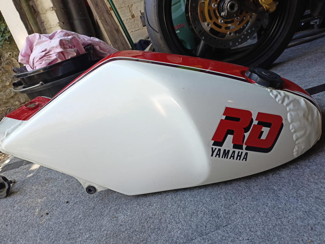

And finally for this update, I am very sad to report that unfortunately, we have a casualty of the rebuild process, caused by my laziness/doziness
When I took the tank off all those weeks ago, It was fairly full of fuel, and rather than draining it I simply plonked it on a bench- due to the shape of the tank it sits nose down when not on the bike, and unbeknown to me had a leaky cap, which meant a steady little stream of petrol was tricking out, there was obviously a chip or two around the filler neck and this is the result.
Feck eh!
I’ve dropped it in with a guy in Wokingham (Triple C Paintwork) who was highly recommended and although not an LC specialist, he does lots of Ducati stuff, particularly the older ones, and what I've seen of his work looks good.
He was initially looking to see if he could just sort that area, but after taking it down there and a proper detailed look we've jointly decided that he's going to re-do the whole tank properly- I’m so annoyed with myself as that’ll be another £400-odd and it won’t be ready for another couple of weeks yet, but I guess realistically it would probably have happened sooner or later anyway.
So that’s where we are at the moment- all being well there will be a flurry of activity on it over the next week or so, with my aim that as soon as the tank is back it’ll be MOT and shakedown ride time, so as The Missendown Flyer would say, "stay tuned kids!"
Feck eh!

Whoops on the tank !!!! i hate it when little things fuck up a good plan !

Yep, I could have cried, but I guess it would have happened at some point anyway!

I assume that's non-factory paint currently then ? I'd have thought factory stuff would be OK with petrol.Tricky wrote: Thu May 26, 2022 11:31 am Yep, I could have cried, but I guess it would have happened at some point anyway!

Thats what I thought too (and still think it must have been resprayed at some point, albeit a decent job if it has) but he said not necessarily on older stuff if it's able to get underneath.
Anyway, I dunno, but whether it was or wasn't original paint , it's definitely not going to be any more

Your not the first person to have done that with a YPVS tank

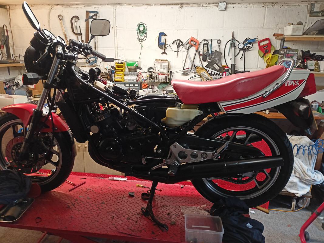

Time for another little update.
Unfortunately we're not quite there yet , primarily due to delays on the tank where a couple of weeks is looking like turning into a couple of months, and I've still got to sort the replacement set of pipes I have for it, but we're not far off.

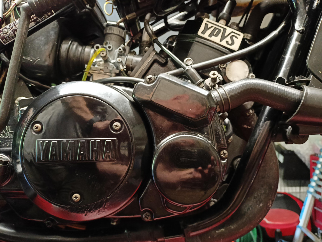

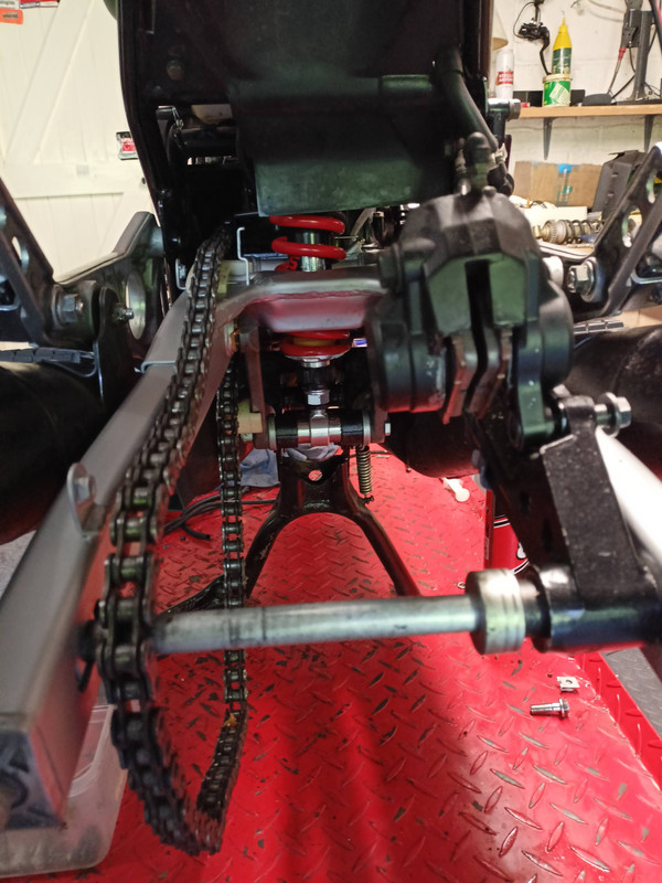

The swinging arm and linkages are all back in with the new YSS shock
And I sprayed the blasted barrels with Simoniz gloss before the motor went back together with new pistons/rings and small-end bearings-one thing that is massively apparent is the difference in compression just feeling through the kickstart to what it was before the rebuild, which is very pleasing.
And I know I probably keep banging on about it, but the simplicity of these bikes and ease of pretty much any job on them really is a joy compared to current, or even post-90s era stuff which is typically almost always covered in plastic and wires and full of fussy little fasteners.....

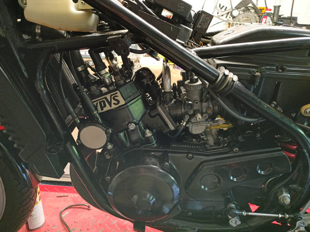

Anyway, I was bored of waiting for the tank so yesterday I bolted the original exhausts on and lashed up a temporary little fuel tank from a plastic bottle to allow me to start it
And this was the first attempt at starting
Fired first kick
- what a difference to previously where it would always take 4 or 5 kicks, and usually a lot more than that when it had been standing.
I've replaced all of the oil and fuel lines with new ones so I'd I mixed up some pre-mix to tide it over whilst it works its way through on the engine side, and it's getting there...
So I'm happy. I'm going to crack on and sort my "new" replacement standard exhausts, strip back, and also re-finish the clutch cover which I haven't touched yet as although it's OK from a distance, it really isn't up close as you can see and has to be sorted
Fired first kick

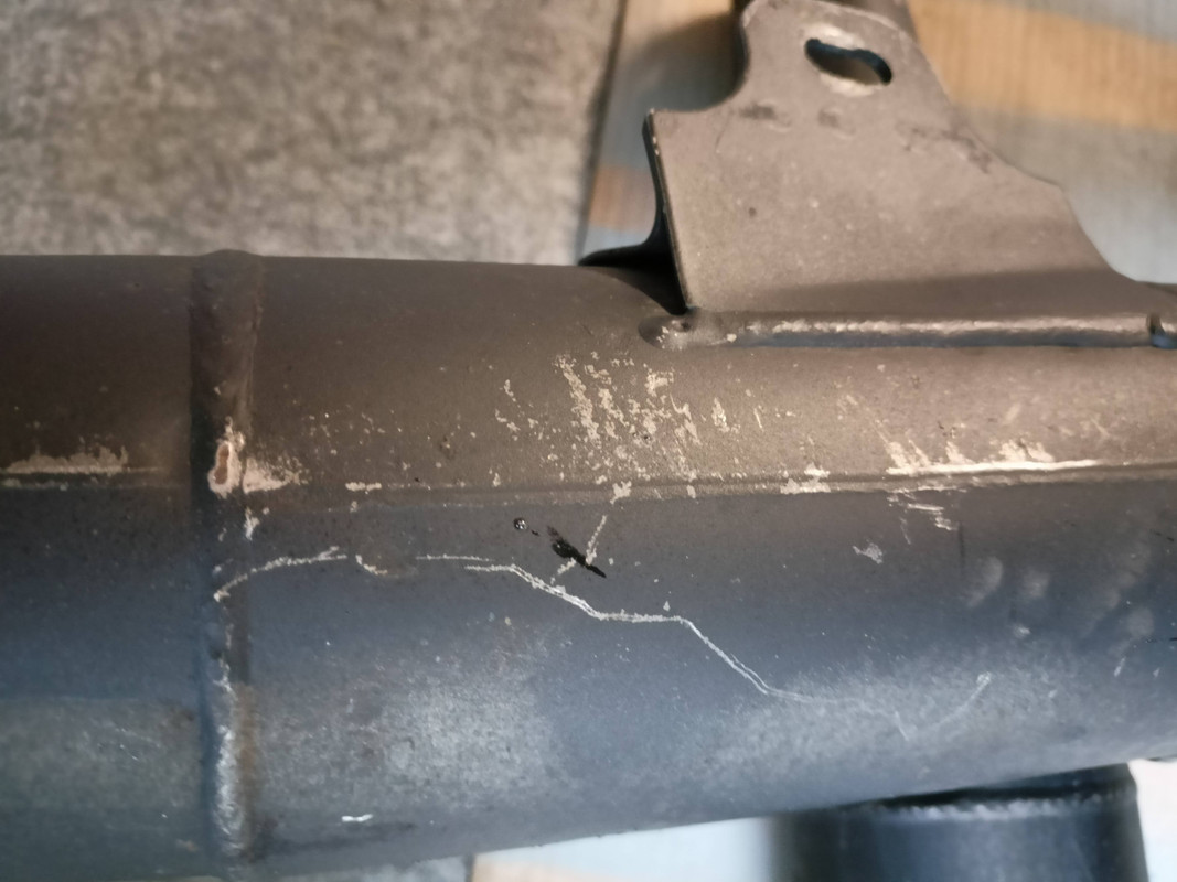

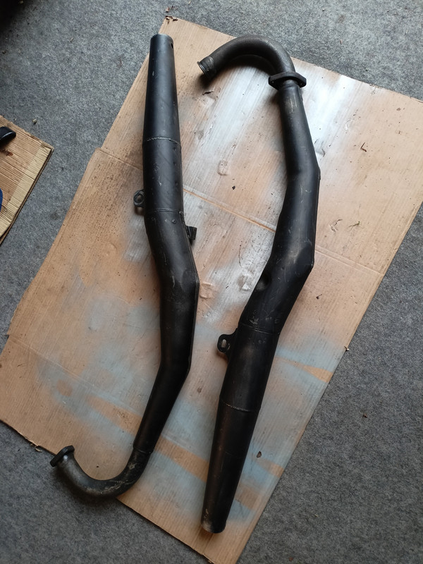

The originals, whilst sound, and not the worst in the world, do have some dinks and unsightly gravel rash as can be seen in this pic
These are the replacements I have- they are dent and rash free, and cosmetically they are A1 (or at least will be with new paint)
But do require some repairs, namely welding up a crack in the LH one
And a bit of re-fabrication of the back-ed baffle mount in the RH pipe
I'll get them sorted over the next week or so, give them a coat of VHT satin black, by which time hopefully the tank will be back and it will be MOT time

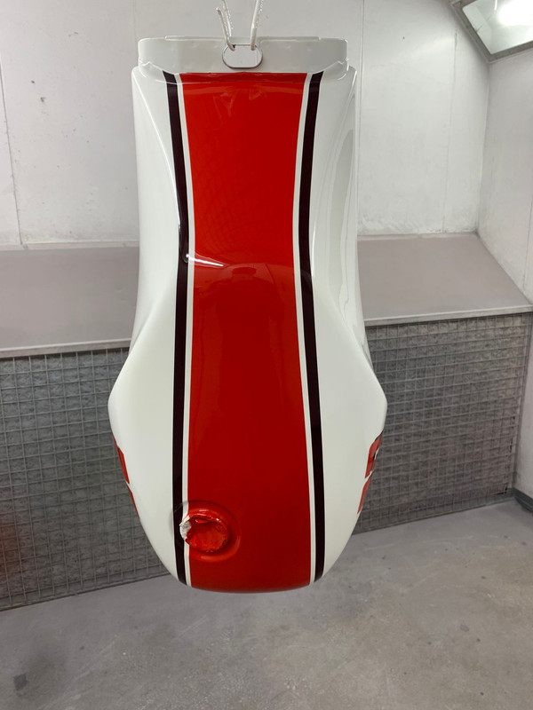

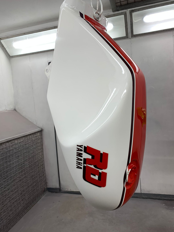

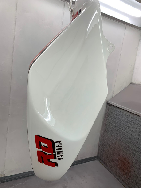

Looks like we at last may have some light at the end of the tunnel- I spoke to my paint man today, he's now back at work after a bout of covid , and the holiday s before, think the dog may have ate his compressor at some point too, but anyway, the really positive news is that the LC's tank is finally just about done, he says he's just got to cut it back and finish it, yay!.

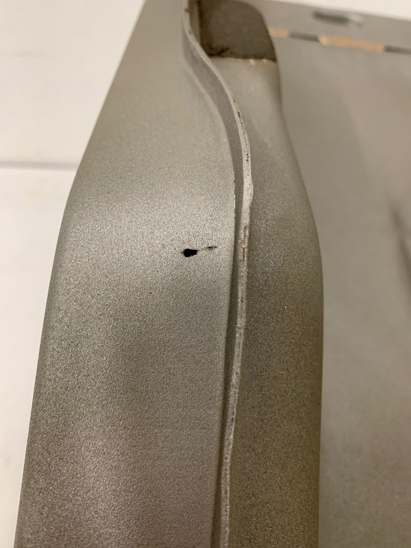

In fairness some of the delay was due to a small hole appearing in the usual (lowest) place on LHS when it was blasted
That's been welded and rubbed back
Ando this is how it now looks, awaiting final finishing
Fingers crossed I'll have it by the end of the week, so I'll be able to run it down for an MOT , get it taxed, then I'll start showing the residents of Southern England what a proper motorbike sounds and smells like
