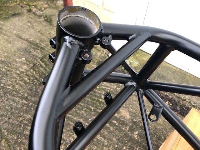

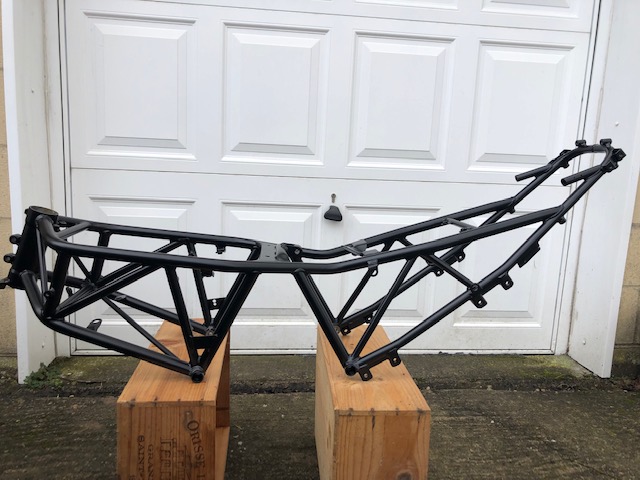

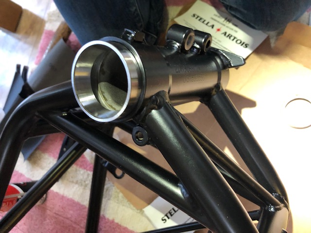

I collected the frame on Thursday from Steve at TPCS & I’m very happy with the result, the satin black finish is great & the strengthening bar I had welded in place looks like it should have been part of the original design (Ducati).
900ss frame powdercoated.jpg (90.12 KiB) Viewed 1045 times

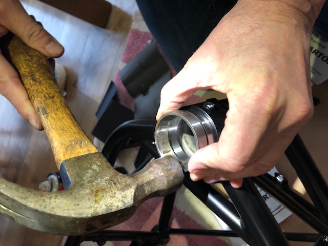

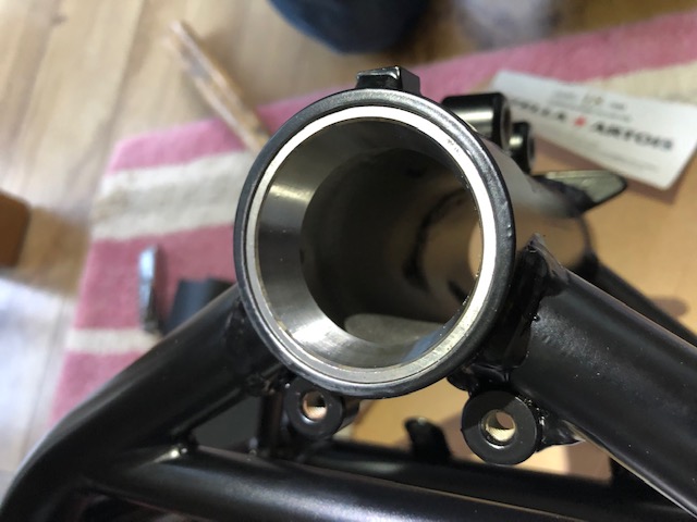

This afternoon we introduced the frame to the new head bearing races & with a few taps from the Universal Adjuster the job’s a good un.
900ss head race fitting.jpg (80.49 KiB) Viewed 1043 times
909ss head race fitting.jpg (79.23 KiB) Viewed 1043 times
900ss head race fitted.jpg (63.31 KiB) Viewed 1043 times

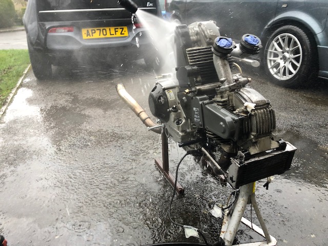

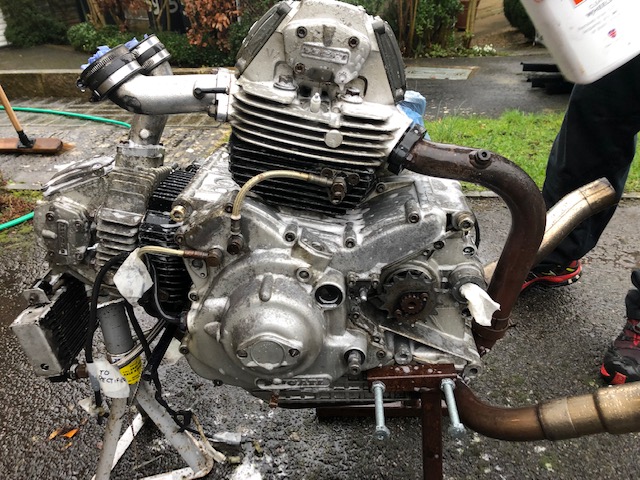

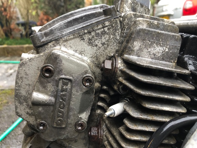

Today I've been mostly cleaning the engine before fitting it back in the freshly powder coated frame.
2 hours with a pressure washer & the best chemical products commercially available gave me only slightly improved version of Ducati's finest 1994 factory finish. As Aristotle once said you can put lipstick on a pig, but it's still a pig. Or maybe he mused about polishing a turd? I get my classical education mixed up these days. Whatever, he was on record as a huge fan of air cooled Ducatis.
I'm the first to admit I'm not very good at cleaning stuff, but short of tearing down the engine & doing it properly this will have to do. Lets call it a half-Weeksy.
Photos below & believe it or not some of the pictures are the after ones :wtf:
900ss post clean 2.jpg (118.69 KiB) Viewed 946 times
900ss pressure wash.jpg (121.74 KiB) Viewed 946 times
900ss post clean.jpg (149.95 KiB) Viewed 946 times

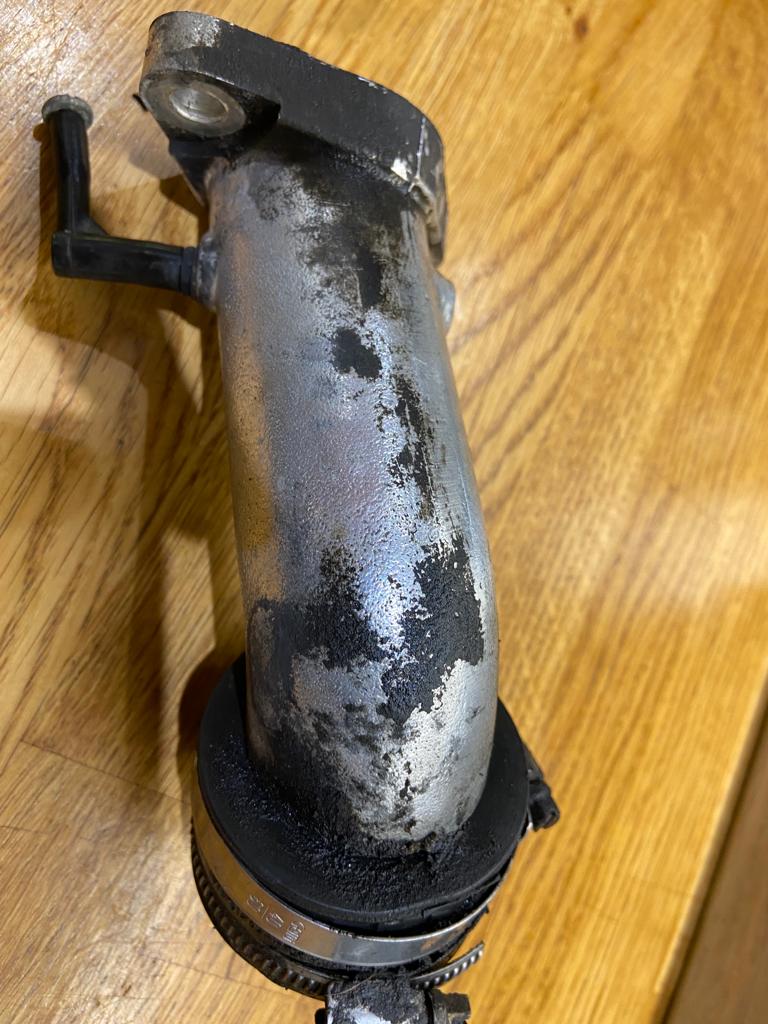

Some bits cleaned up better than others

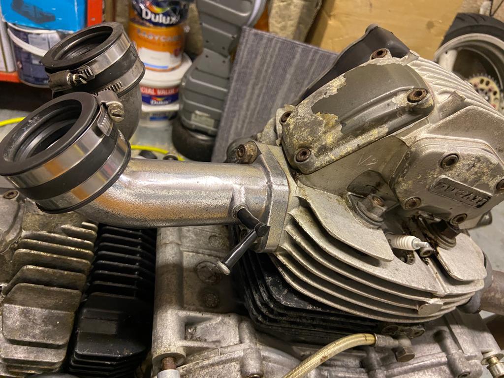

900ss pre clean inlet.JPG (113.68 KiB) Viewed 936 times
900ss shiny.JPG (136.44 KiB) Viewed 936 times

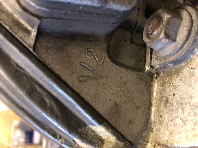

The V2 stamp confirms this engine has the big valve head, which is good news. No one wants small valves :shifty:
900ss V2.jpg (84.36 KiB) Viewed 929 times

IanB wrote: Sun Feb 13, 2022 9:11 pm Today I've been mostly cleaning the engine before fitting it back in the freshly powder coated frame.
Hey that's way more than I do. I'm just like a window cleaner really. Clean the big shiny bits

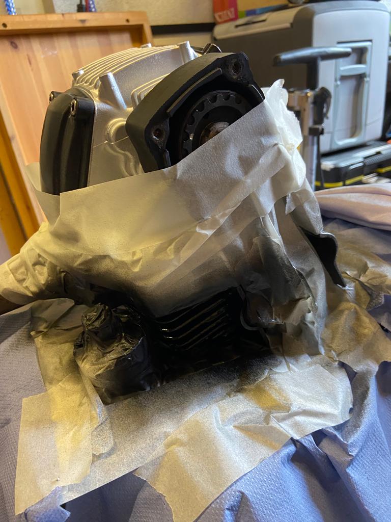

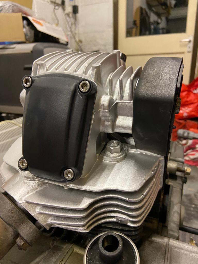

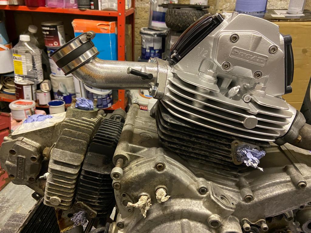

Rattle can fun & games this week.
Rattle can 3.JPG (146.79 KiB) Viewed 843 times
Rattle can 4.JPG (103.91 KiB) Viewed 843 times
Rattle can 5.JPG (108.36 KiB) Viewed 843 times

That's going to look really good :)
Posts: 26930
Re: Ducati 900ss Light Resto/Fix Up
Nice job mate.... nice... I'm shocked... but hugely impressed !!!
