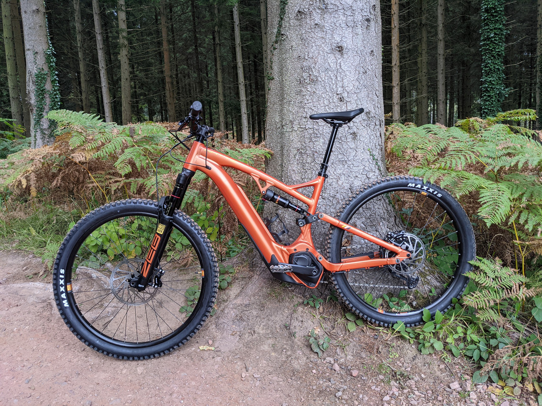

And here it is, I've had a couple of miles to fiddle with setup and now the child has just buggered off on it

Sweeeeet.Taff wrote: Thu Oct 14, 2021 6:50 pm

When someone asks you to describe the colour you can say, with justification, "it's all of the orange..."Taff wrote: Thu Oct 14, 2021 6:50 pm

Nice, single click changing is there for a reason. Iβve seen gears fold in half, chains snap and rear mechs break changing under load in full power mode so make a point of backing off when changing and only one gear at a time

Burnt orange if you don't mindmillemille wrote: Thu Oct 14, 2021 7:41 pmWhen someone asks you to describe the colour you can say, with justification, "it's all of the orange..."Taff wrote: Thu Oct 14, 2021 6:50 pm

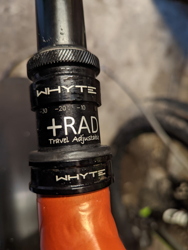

I noticed this on the weekend..
It turns out that by fiddling with a little plastic shim in the dropper, you can reduce the travel by 30mm. I suppose it could be handy if you feel that the post drops too far, a bit like using the enduro collar on the reverb

That's clever... does it just decrease the drop or the overall length ? Would be useful if the post was too long and you could reduce it's actual length by 30%

Yes, it reduces the length.
The shim seems to stop it traveling right to the top of is movement.
So if my Mathew wanted to ride it, I could set it to -20 and the seat height would be about right for him without adjusting the seat post clamp. I'm not telling him about that bit.

That's brilliant and for exactly the reasons you state there.Taff wrote: Mon Nov 15, 2021 8:36 am Yes, it reduces the length.

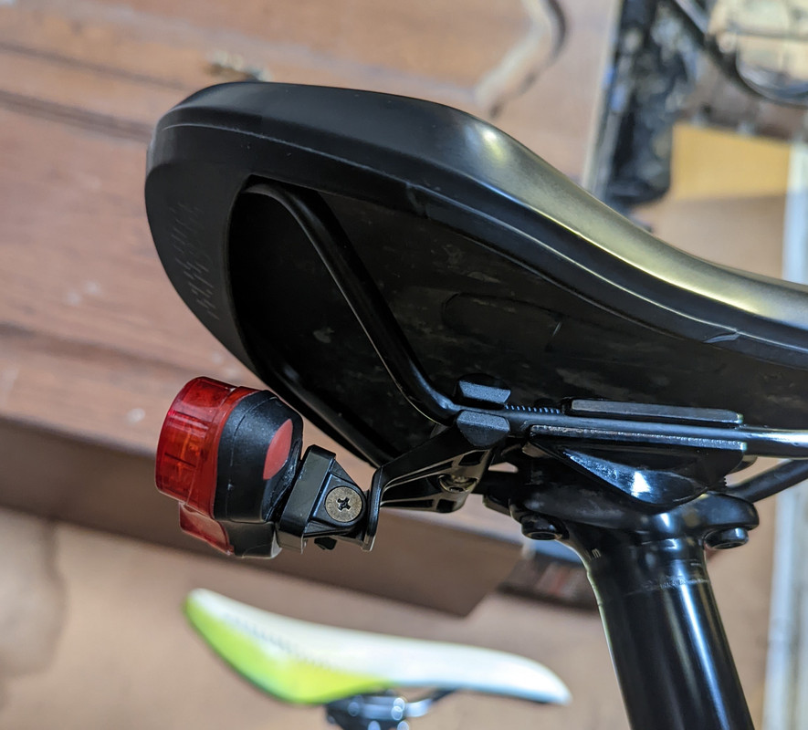

I've had to relocate the rear light because where it was at the bottom of the dropper interfered with the mudguard, so I found this handy little seat rail mount

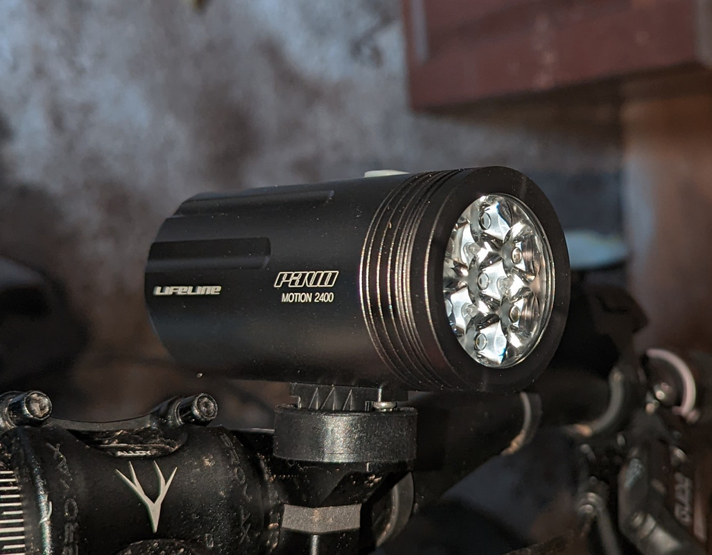

And I really dislike the separate batteries on the cheap Chinese lights that I have so I got one of these from CRC
Night riding is a go go go

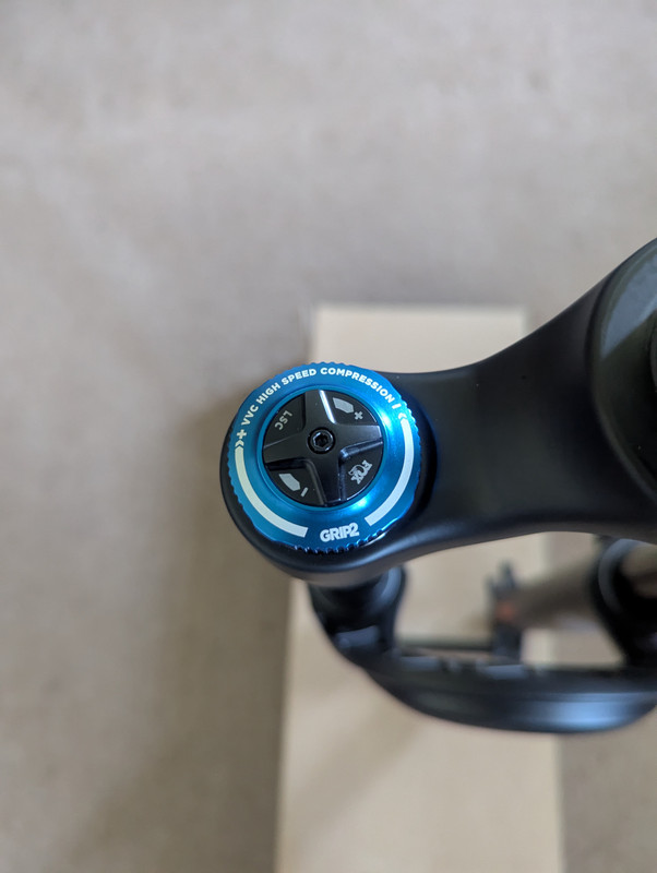

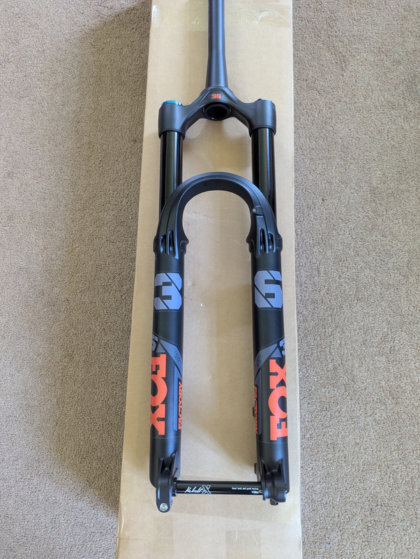

The last time my forks (zebs) went for a service they told me that the internals were wearing and I should think about chucking a charge 3 damper into them, which was the plan for this spring...
But then I found Fox 36s with the grip 2 damper on sale in Merlin cycles for Β£445, so that's a no brainer.
I need to cut the steerer down to size this afternoon and then start twiddling the knob things.
