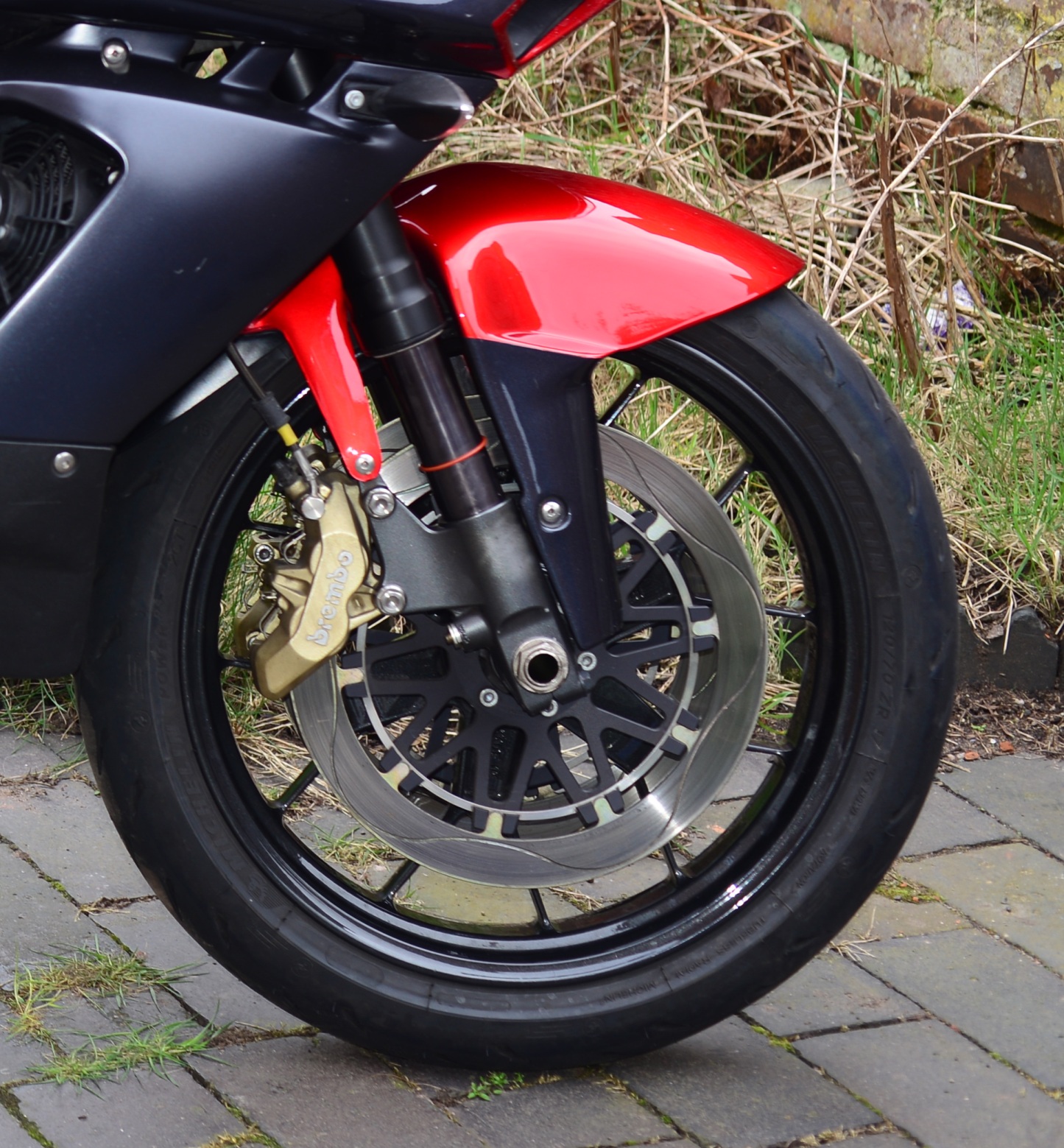

So for the last couple of days I've managed to finish off the Falco's winter servicing. Since November last year it's had the Ohlins shock serviced at Revs Racng in Brum, I've overhauled the Showa forks (new seals, bushes, complete stripdown/clean and new oil). I also had the outers re-anodised as they were showing signs of the old anodising starting to fail. I also replaced all the bearings and bushes in the swingarm and cleaned and lubricated the suspension linkages. It's also had a new chain and front sprocket.
In order to get at the suspension linkages and shock the pipes had to come off, and while they were off I handed the complete system over to a local polishing company for a satin finish polish. They did a cracking job and it really gives the bike a visual lift. Pipes are stainless and cans are titanium oval Akrapovic but de-badged. I prefer stealth. Here's the old girl in the back yard in a rare dry spell.

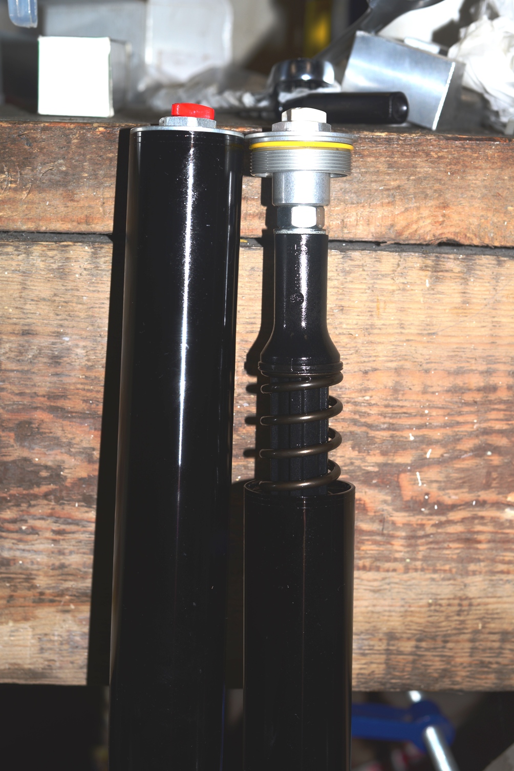

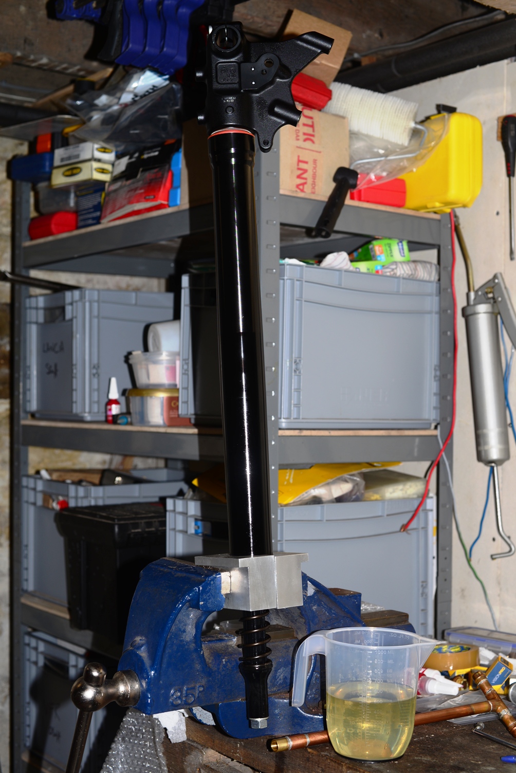

Well it's been a day of qualified success, I guess. My cunning plan worked, inasmuch as I was able to reassemble the forks, but the way KTM have designed the forks means that it's impossible to adjust the oil height/air gap using the conventional tool for the job. You have to assemble the fork completely dry, then add a measured amount of oil. If you want to (say) reduce the oil level/increase the air gap, all you can do is pour some oil out of the fork, then add back a smaller amount. I can't think of any way of accurately measuring the air gap.
Reassembling the forks upside down (so we have here upside down, upside down forks) allowed me to fit the springs and sleeves to the damper rod, and then fit the fork tops to the projecting part of the damper rod and thus reassemble the forks. But it's a decidedly pants way of designing a fork. The 20 year old Showas on my Falco are a much, much better design.
Having said all this, I think I have just thought of a way to get round the 'wrong way up' reassembly. The damper rod that runs through the centre of the fork has an M20 x 1.0 external thread and is hollow, to allow the adjuster rod to sit inside it. If I were to tap an internal thread in the damper rod (something like an M6 thread, at a guess), then that would enable me to retrieve the damper rod from the bowels of the fork with a piece of M6 threaded rod and set up the air gap in the conventional manner.
But I've just fitted the forks back in the bike and unless my meddlings have made it worse, it's time to ride the sucker. You've had the rant, here's the pictures. First off, a close up of the part of the forks that gave me grief. The damper rod is inside the hex nut, but not visible.
Next up, a view of the complete fork leg and the general wasteland that is my work bench.
Lastly, a close up of a buttoned up fork leg and one awaiting final assembly, showing the rather nasty plastic fork spring sleeve/guide that KTM fit to their forks, and the damper rod connected to the fork top.

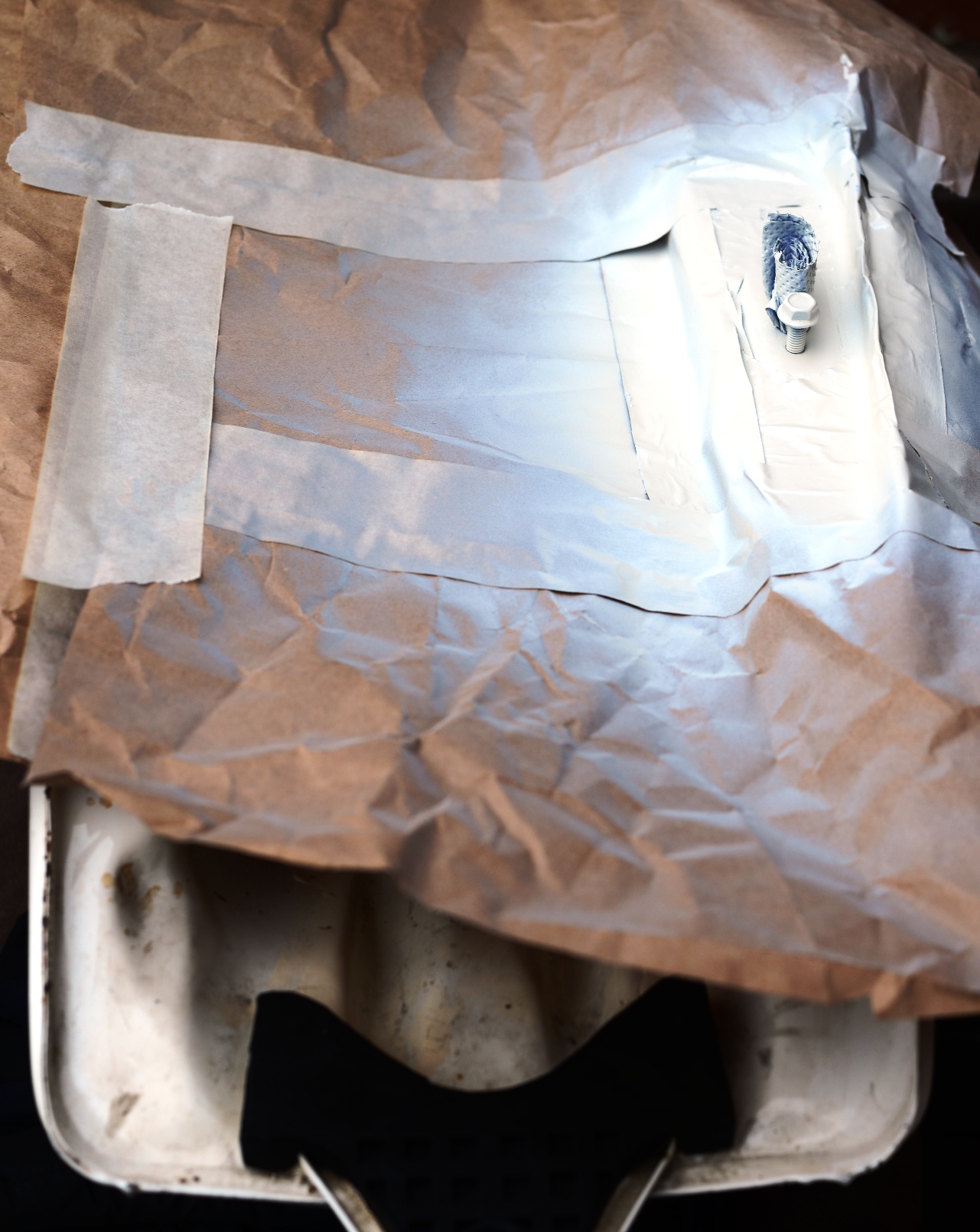

While I'm waiting for April 1st and LC tax and MoT exempt status to arrive, I thought I'd better get on with fixing the outstanding stuff on the bike. Before I got the bike on the road in September I'd sent the fuel tank off to have it de-rusted and coated internally. It's never seen ethanol and as I'd like it to stay hole-free I felt that was the best solution. I fitted the tank and it and the bike had done around 200-250 running in miles when I noticed something amiss when filling up. Basically the tank lining was peeling off...
So I took it back to the dealer who straight way said 'I've never seen that happen before', but also promised to completely re-do the lining at my convenience. When the bike came off the road in November I took the tank back to the dealer and left it with them for as long as it took. I got a call in mid-Feb to say the tank was ready but was advised to leave filling it with fuel for a couple of weeks. So for the last month it's been sat curing in front of the radiator in the front room. If it's not ready now, it never will be...
Today it dawned on me that I needed to fix the seal between tank and fuel tap, as it had been a bit 'drippy' in that area. When I took the tap off to clean it, it had taken some of the tank paint with it and the surface needed flatting down, priming and respraying. Today was the day, as it was dry, I had the necessary rattle cans and time was marching on. Lots of epoxy primer and several coats of Halfords finest generic white spray paint and this was the result. Time will tell if it's done the job or not...

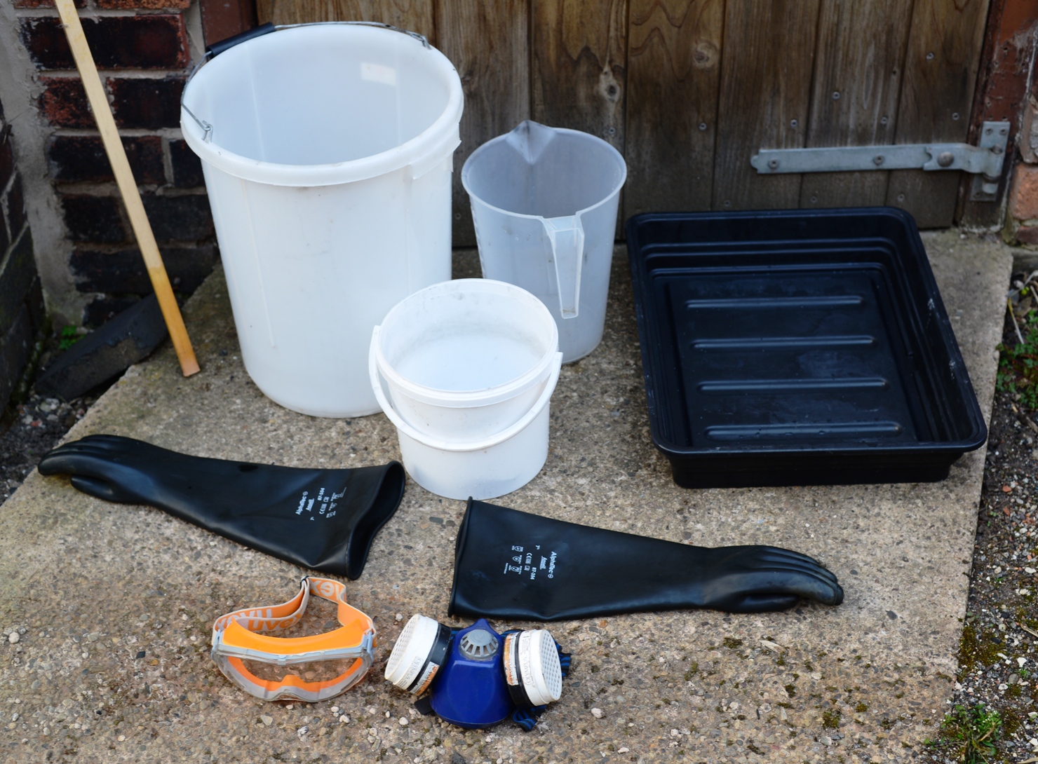

I finally got round to/plucked up the courage to do the long-threatened caustic soda treatment on my LC's exhausts today. I've been a bit put off by the reputation that CS has but took a bravery pill, manned up and got thr fuck on with it. It's messy, time consuming and you really wouldn't do it anywhere but outside, but it all passed off without any major alarms. We have what looks like a washing line but isn't in the back yard (garden is far too grand a term) and so the exhausts were strung up to that, as level as I could manage (one at a time).
I then mixed up approximately 5 litres of solution (working on a ratio of 1kg CS per 5 litres of warm/hot tap water. Always add CS to water, not the other way about. I wore a face mask and eye protection while doing this, as well as tribal size black marigolds. The addition of CS to water generates an exothermic reaction, further increasing the heat of the solution. This is a Good Thing. As it turned out my guess of 5 litres wasn't too far out. The LC exausts swallowed about 4 and a half litres of solution before dribbling out of the end. I put a tray down to ry and catch any overflow. This worked, partially...
Once the zorst was full I then decided to agitate the angry CS pixies by playing a blow torch over the pipe, mainly because I could. I also dimly remember my old Chemistry teacher stressing that heat speeded up reactions, and I'm impatient. I gave each pipe about 2 hours soak time, with intermittent blow torch attacks, and then emptied the contents into a 25 litre bucket. The fluid that drained out was impressively black/dark brown with lots of lumpy bits of carbon. I've no idea how much old carbon is left inside but I simply CBA to do it again. After that, copious flushing with hot water into a nearby street drain ensued, until the water started to run a lighter shade of brown.
So that's about it really. The picture below shows the kit I used, but the bucket of CS powder and the blowtorch are missing. I'm very glad it's done and the next step is to get them ceramic coated satin black.
