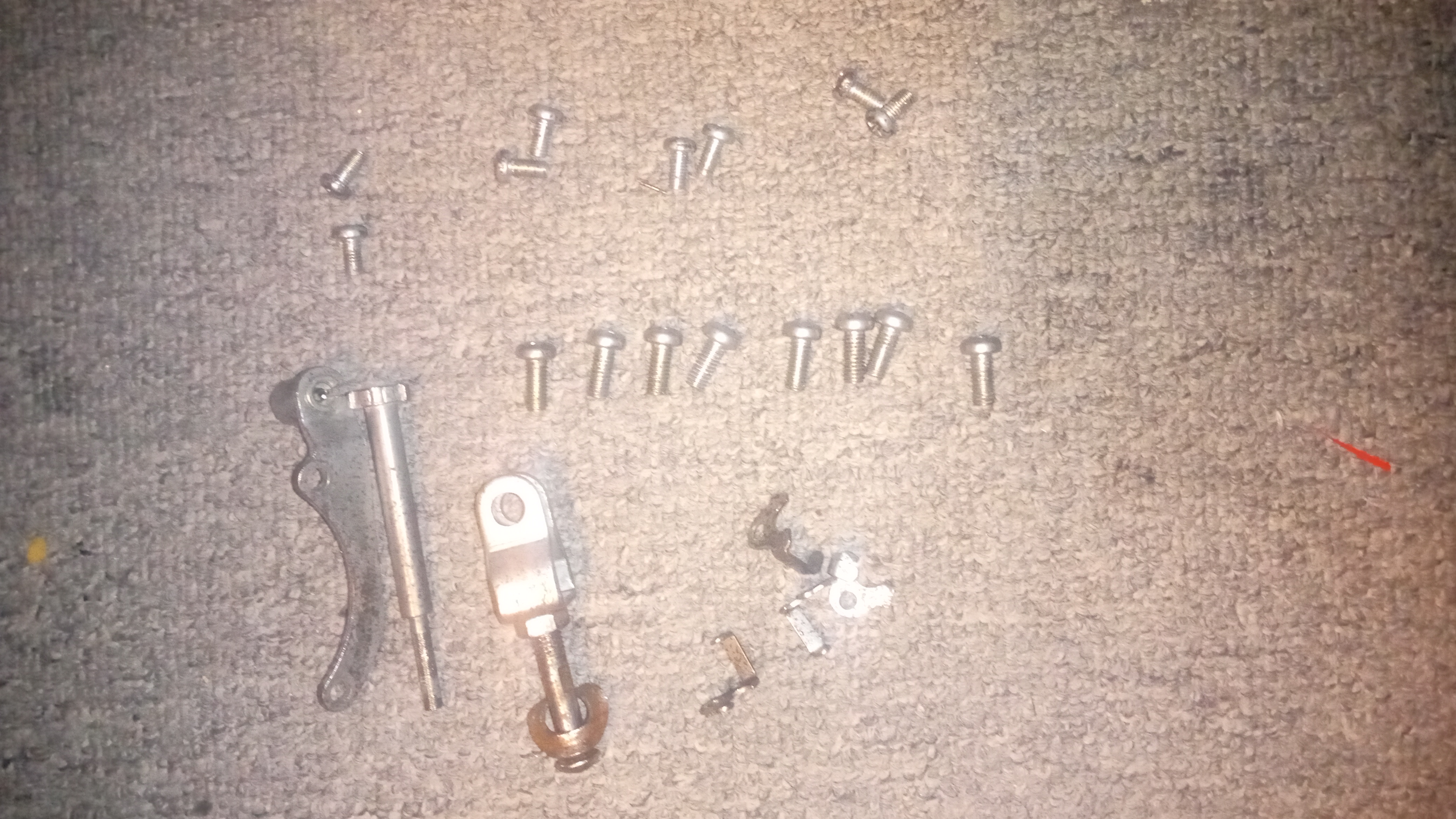

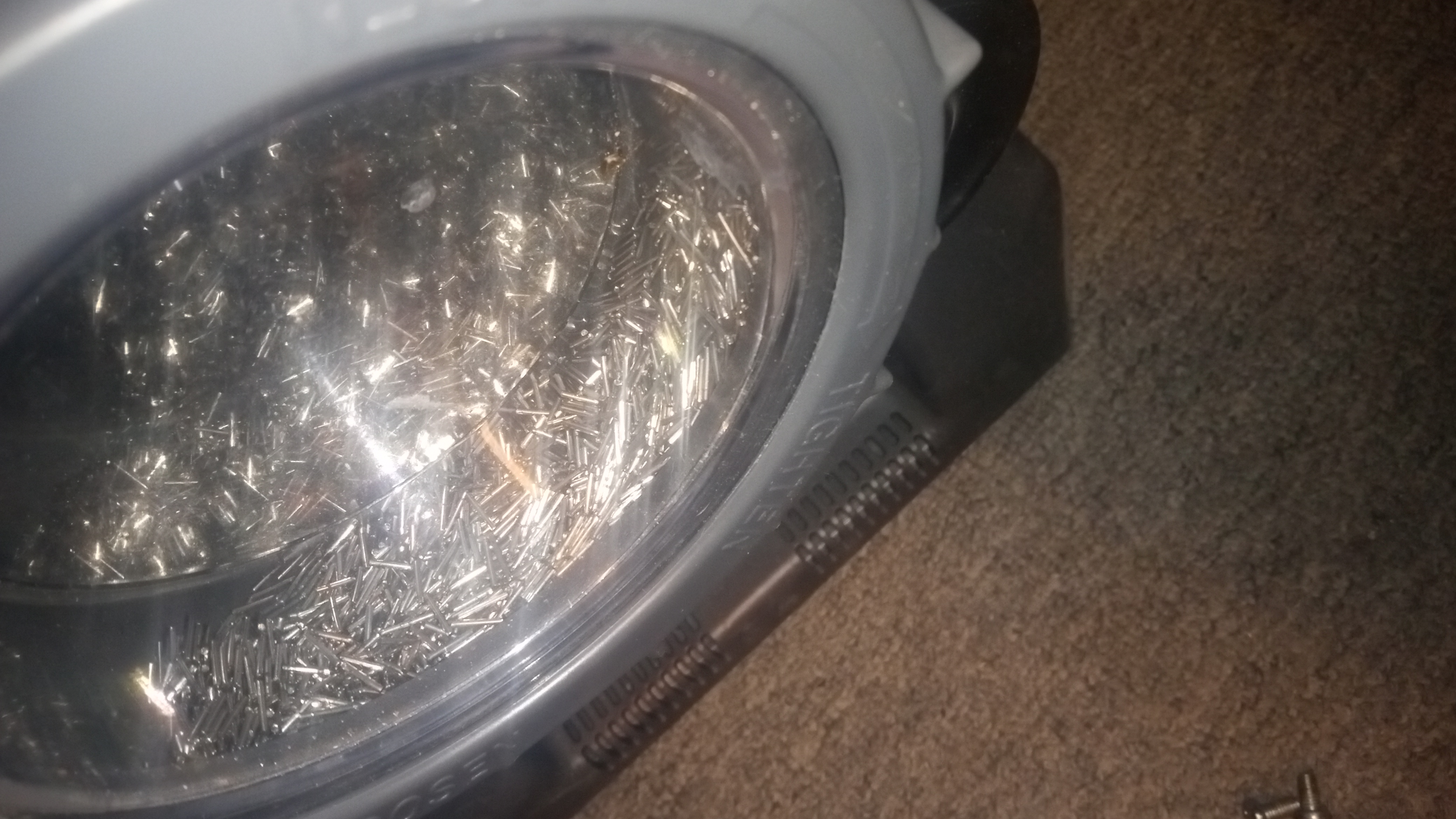

Still no movement on the rear brake lever pivot. If I had my press set up I'd just put some pressure on the doodad & walk away for a week.
Maybe an hour in the ultrasonic would result in some progress.
Rear brake lever is in the tumbler which is using stainless steel pins as the media, timer set to 90min.

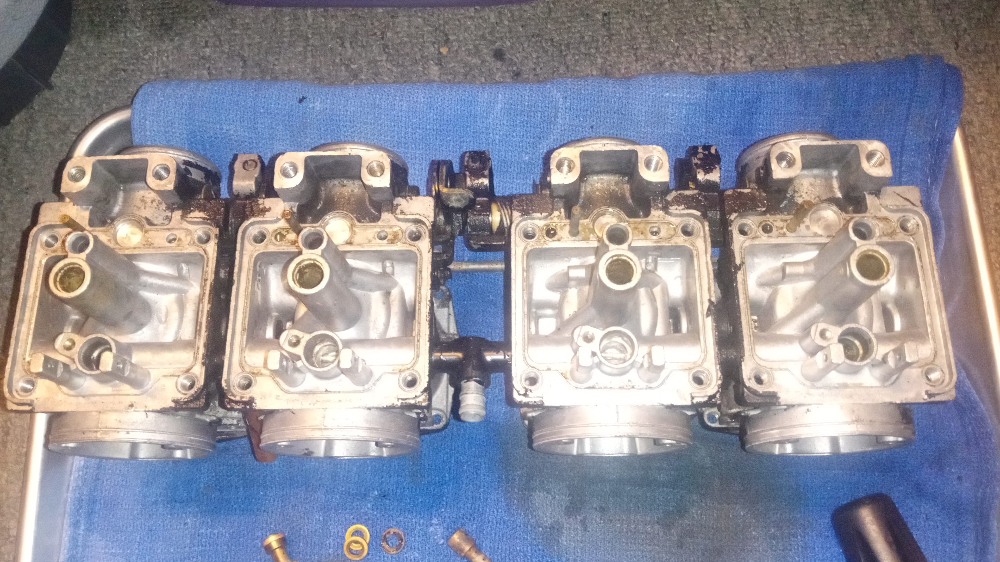

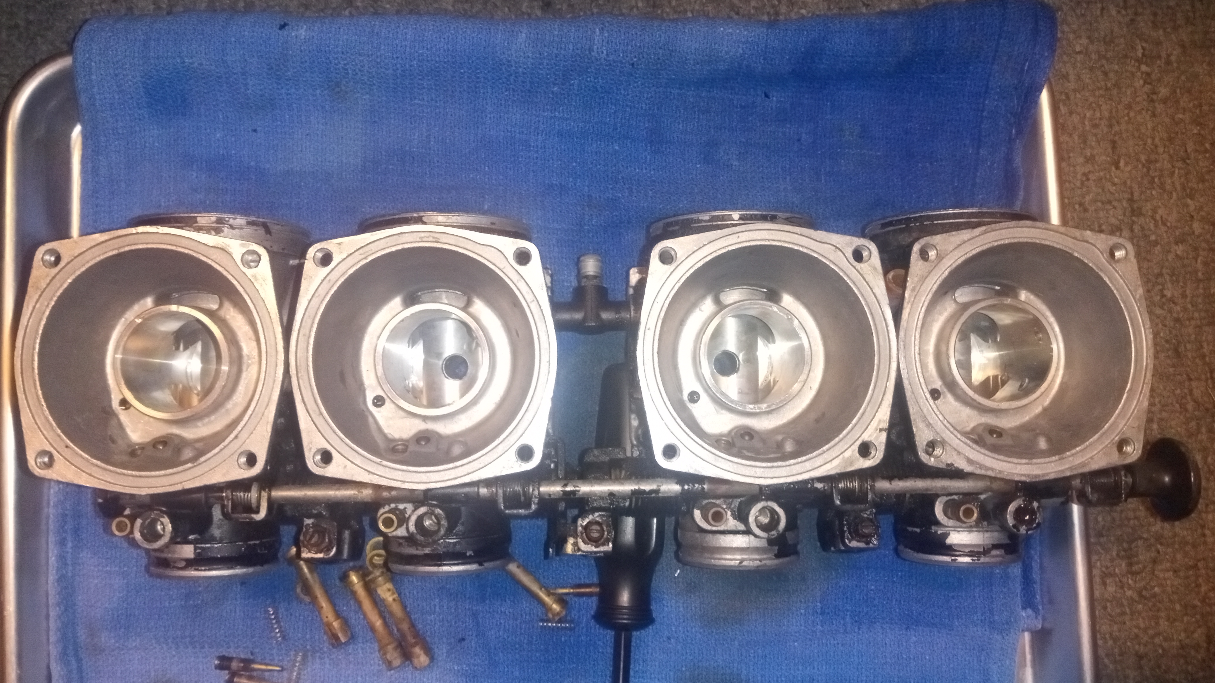

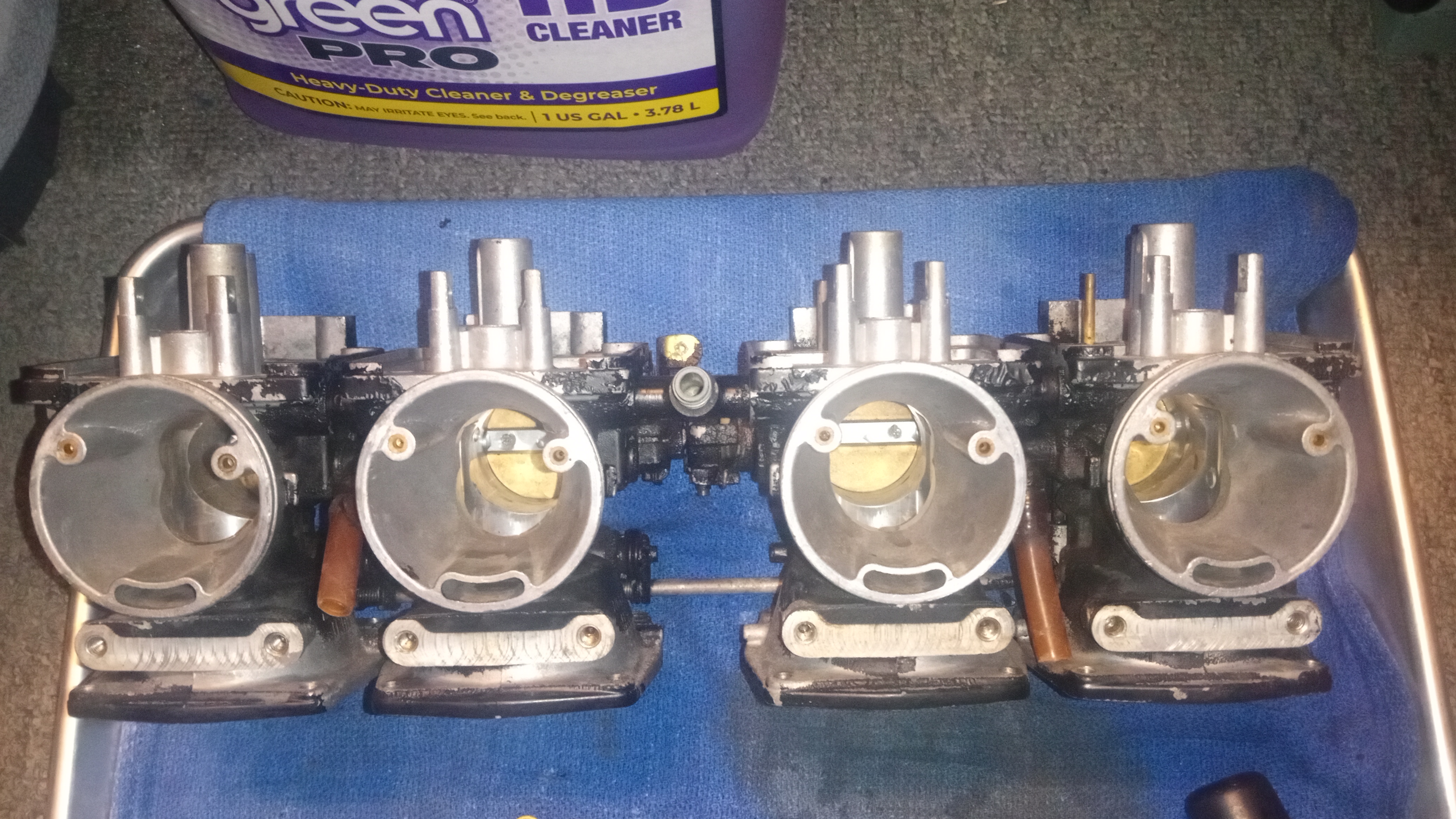

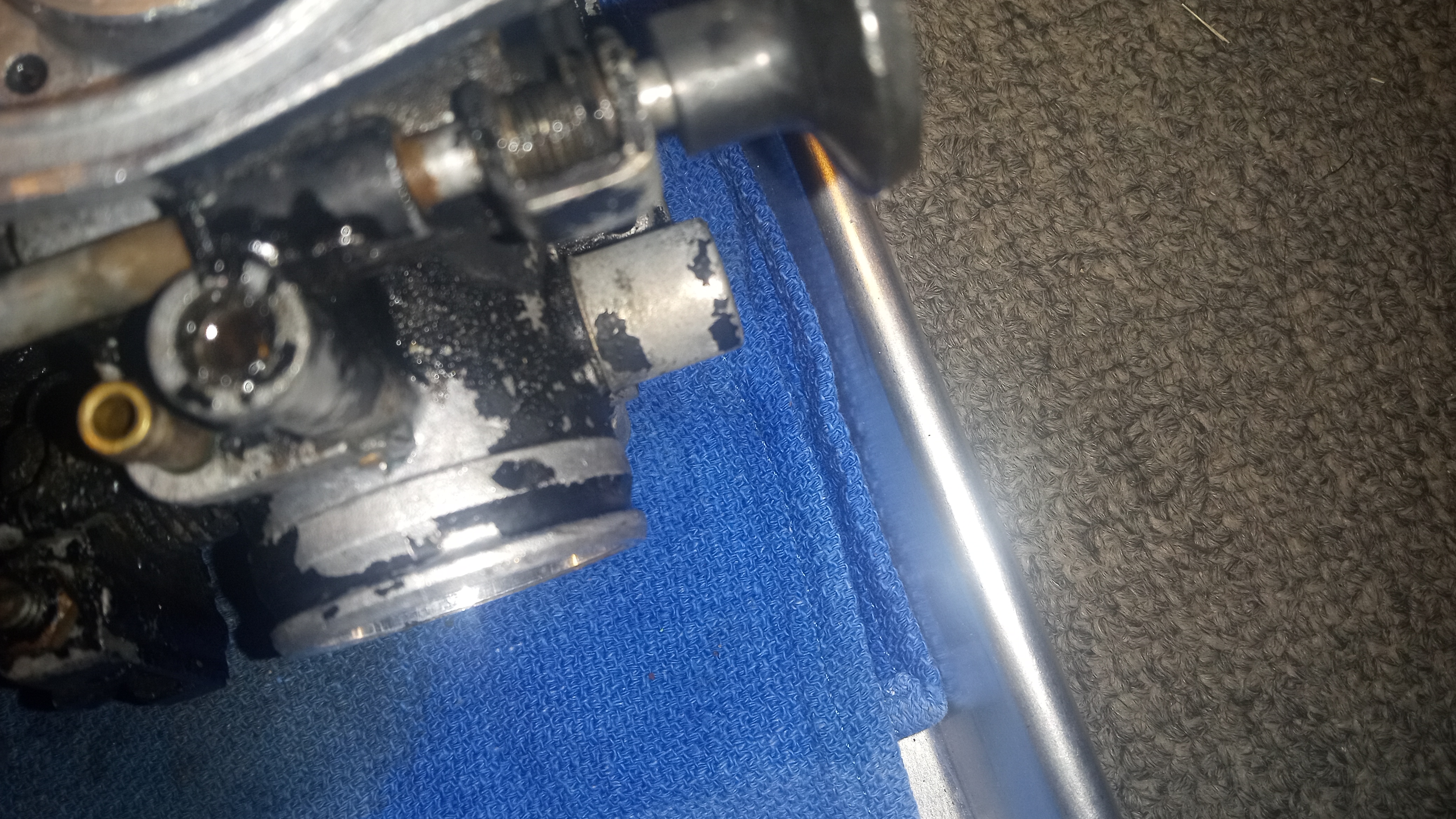

Got snookered, something is holding the choke bar in place & I can't see WTF is it, probably a small Ping!FuckIt!
Also got a mullared airscrew(?) that doesn't want to come out. It's currently drowned in Kroil. Got all the other doodads removed though (except the choke doodads).
They've had an hour in the tank so far, they're going back in again (probably tomorrow) now I've got the emulsion tubes out. They'll also be getting a soda blast to remove the buggered paint

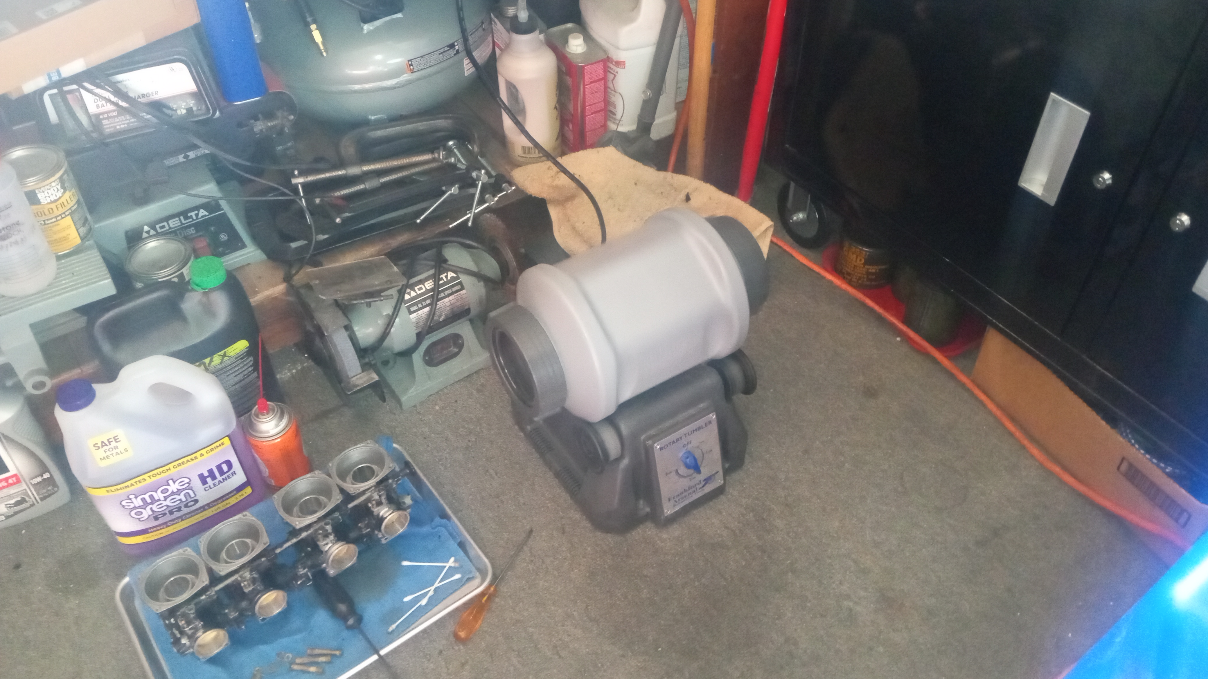

Bunch of hardware is in the tumbler, set the timer for the max 3 hours.
Slides with the needles poked through the box so they're not resting on the diaphragms...

Had a look in the tumbler after 2 hours, reset the timer to 3 hours again, will probably do that again before I go to bed tonight.

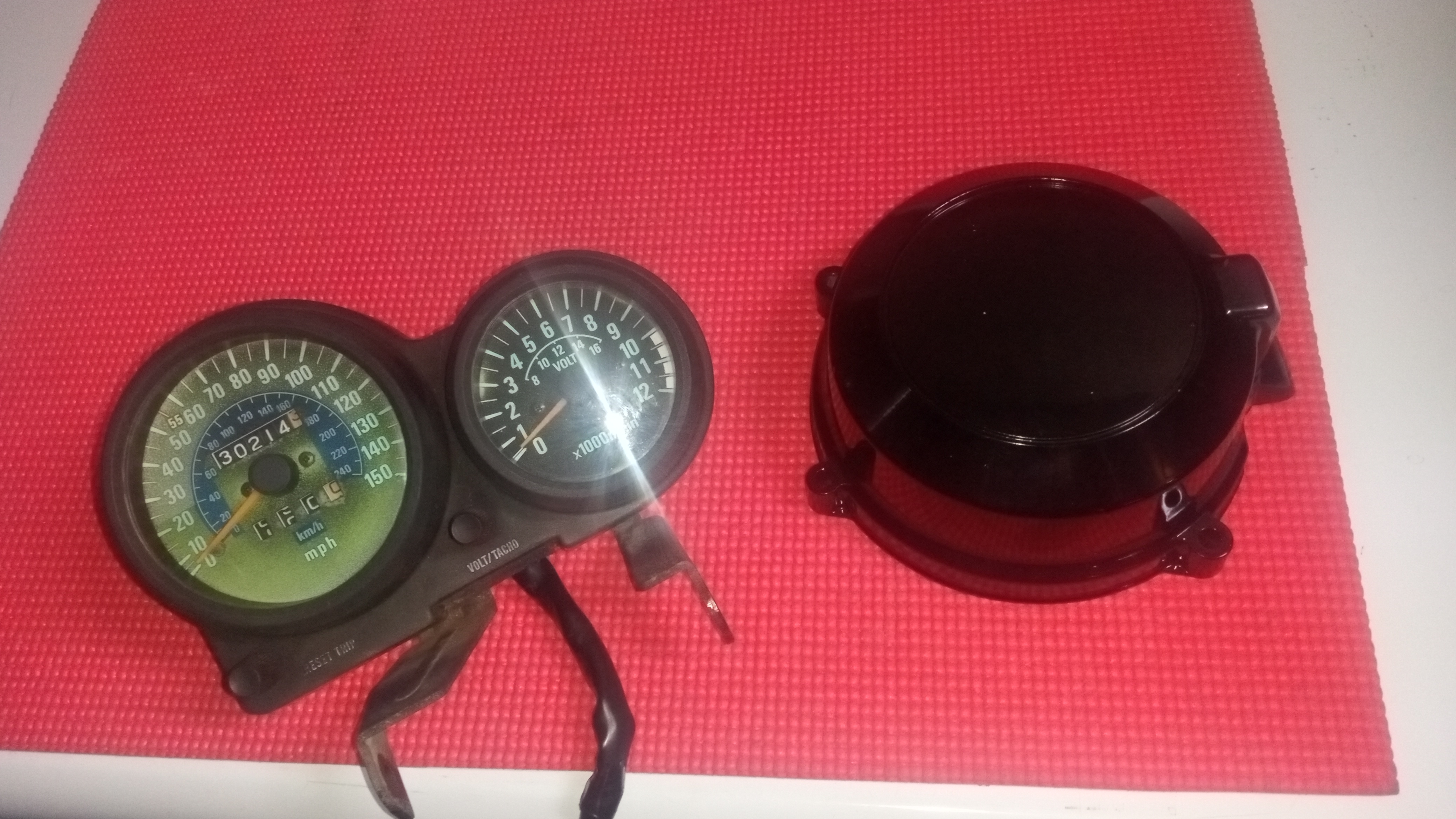

NOS Generator cover & Speedo/tach showed up. Mate sold me the speedo/tach for $25
I especially like that the black speedo face is fading to the faster green
