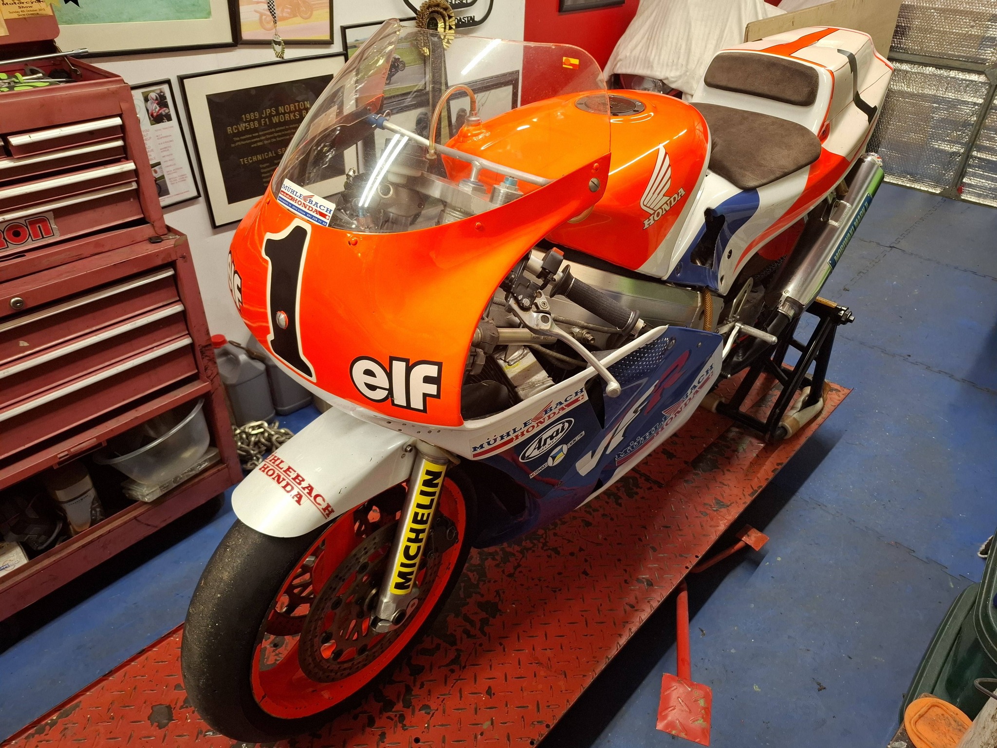

Well looks like I'm going to be getting intimate with a race RC30, a mate has been asked to service it and get it running, which means I'll be going over the electrics on it.

Here it is, apparently it has electrical issues.
Re: Do you think the RC30 is an iconic bike?
Posted: Thu Mar 05, 2026 9:16 pm
Le_Fromage_Grande wrote: Thu Mar 05, 2026 9:06 pm 645487759_27117865377802911_57572710122996174_n.jpg
You need the special factory leccy hammer ;)

Yorick wrote: Thu Mar 05, 2026 9:16 pm
I'm hoping there aren't any irreplaceable HRC bits that are fecked

It's got carbs with no TPS, there's no power valves, no exup and if it's a proper race bike it'll be running total loss, half a dozen wires at most :)

I hope so, mates ex MSS Superstock ZX6 has a chopped about road bike loom - that's how it came from MSS.
Did the wiring on it today, turned out to be very easy, it has an HRC loom which I found the diagram for online, all it needed was new battery terminal loops and removing an old charging socket removing.
Apparently it was 4th at the Austrian WSB round in 1988 and won the Swiss National Championship 2 years running, it's crammed full of HRC bits.
It's tiny without it's bodywork, it looks about the same size as a 400, it's an utter barstard to work on, everything is fiddly and difficult to get at.
The bloke who owns it doesn't ride bikes, he imports them from Switzerland and sells them here, so my mate is probably going to race it, but he's not keen because it will be slow for the class it has to race in (Period Superbikes I think) but it needs a lot more work on the chassis, the brakes float a bit too much amongst other things, once it's ready we'll be doing some testing on a local airfield we have access to and then it will be a trackday at either Cadwell or Snetterton before it gets raced.

Brian is talking to Ian Martin who runs the Team Bike RC30s, but the engine would need a full (expensive) rebuild for that, there's a fair chance it may throw an HRC titanium rod the first time it's thrashed, the bloke that owns it doesn't want to spend too much on it, so far including purchase it stands him in at about £10K, it'll probably need another £3K spending on it without an engine rebuild.
