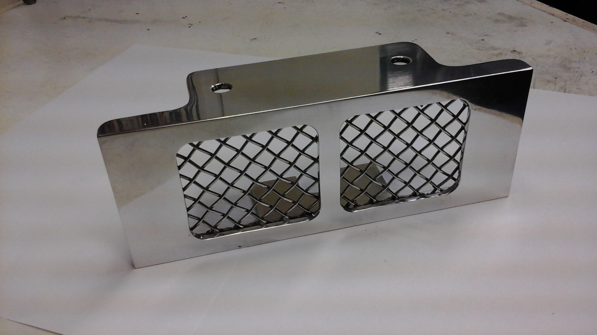

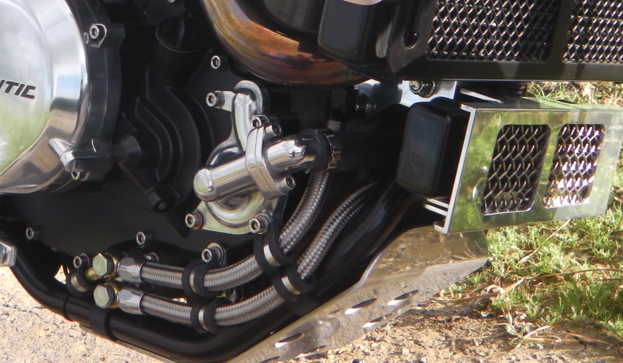

Oil cooler fitted and guard made from 'U' section ally with some coarse mesh fixed behind the cut outs with JB.

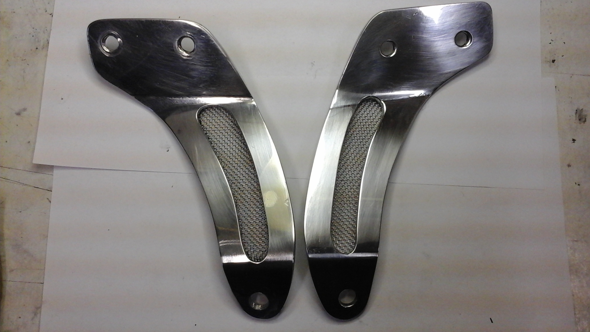

Forgot about these rear engine support brackets!

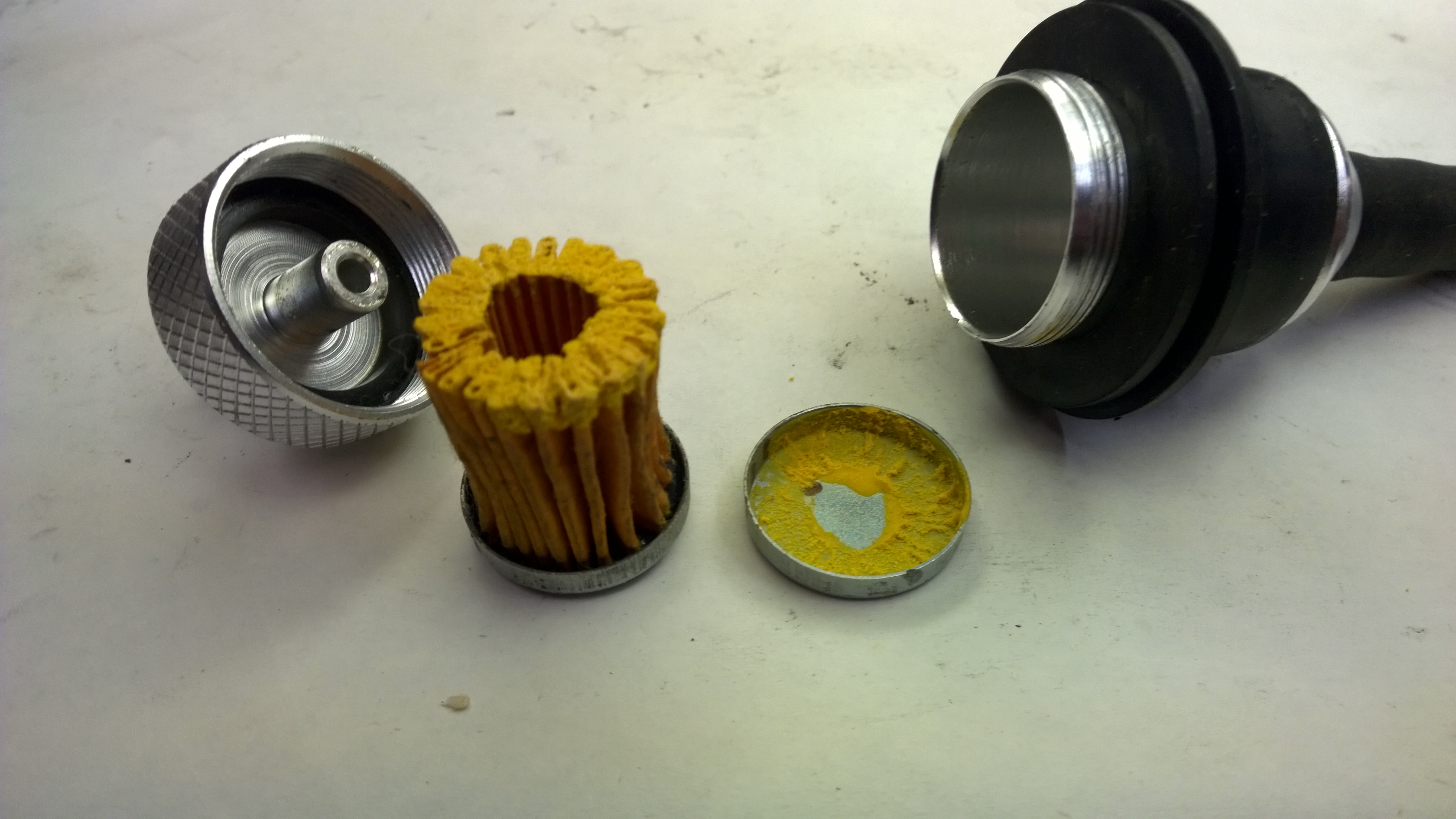

Post by Dave G »

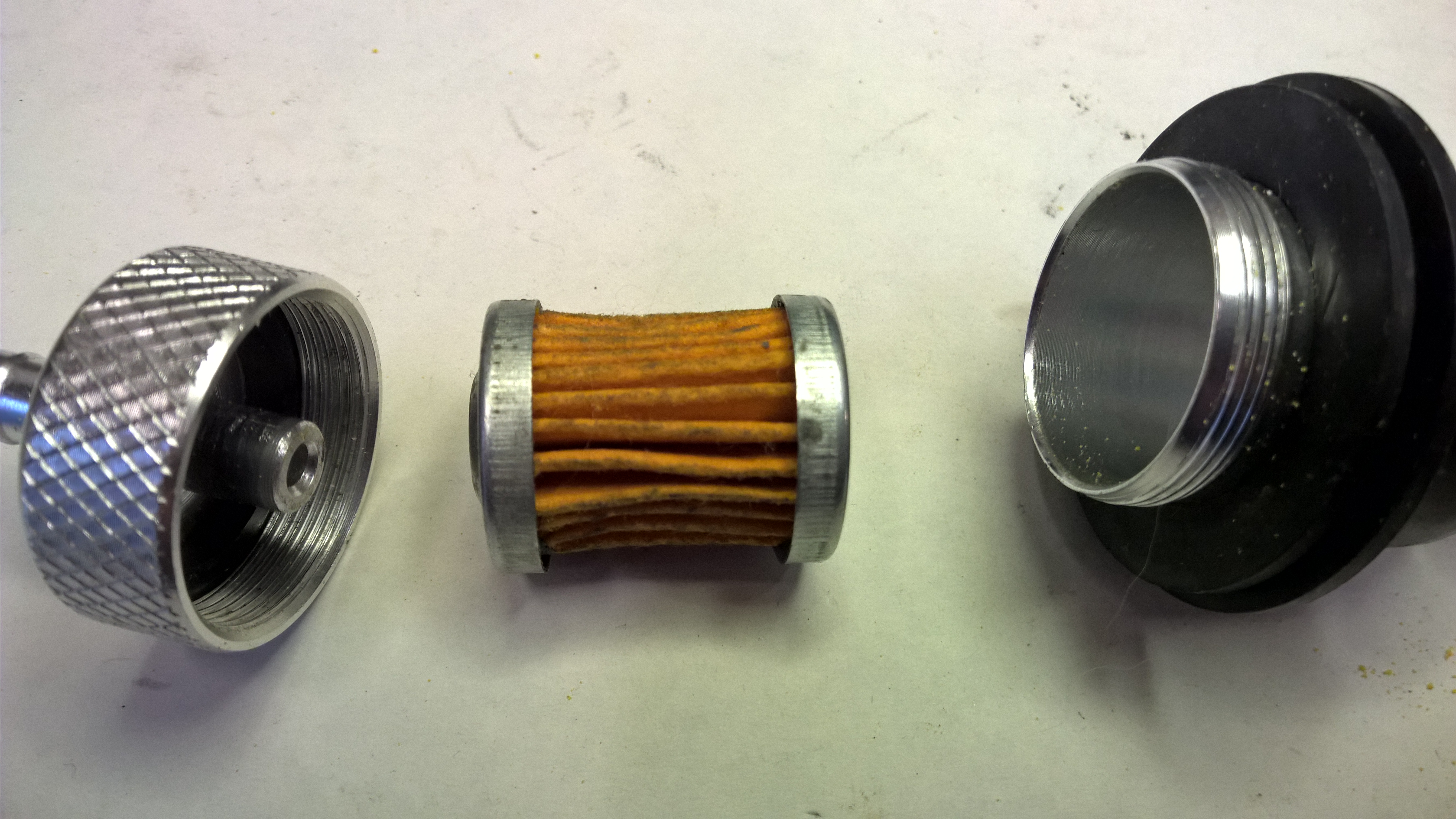

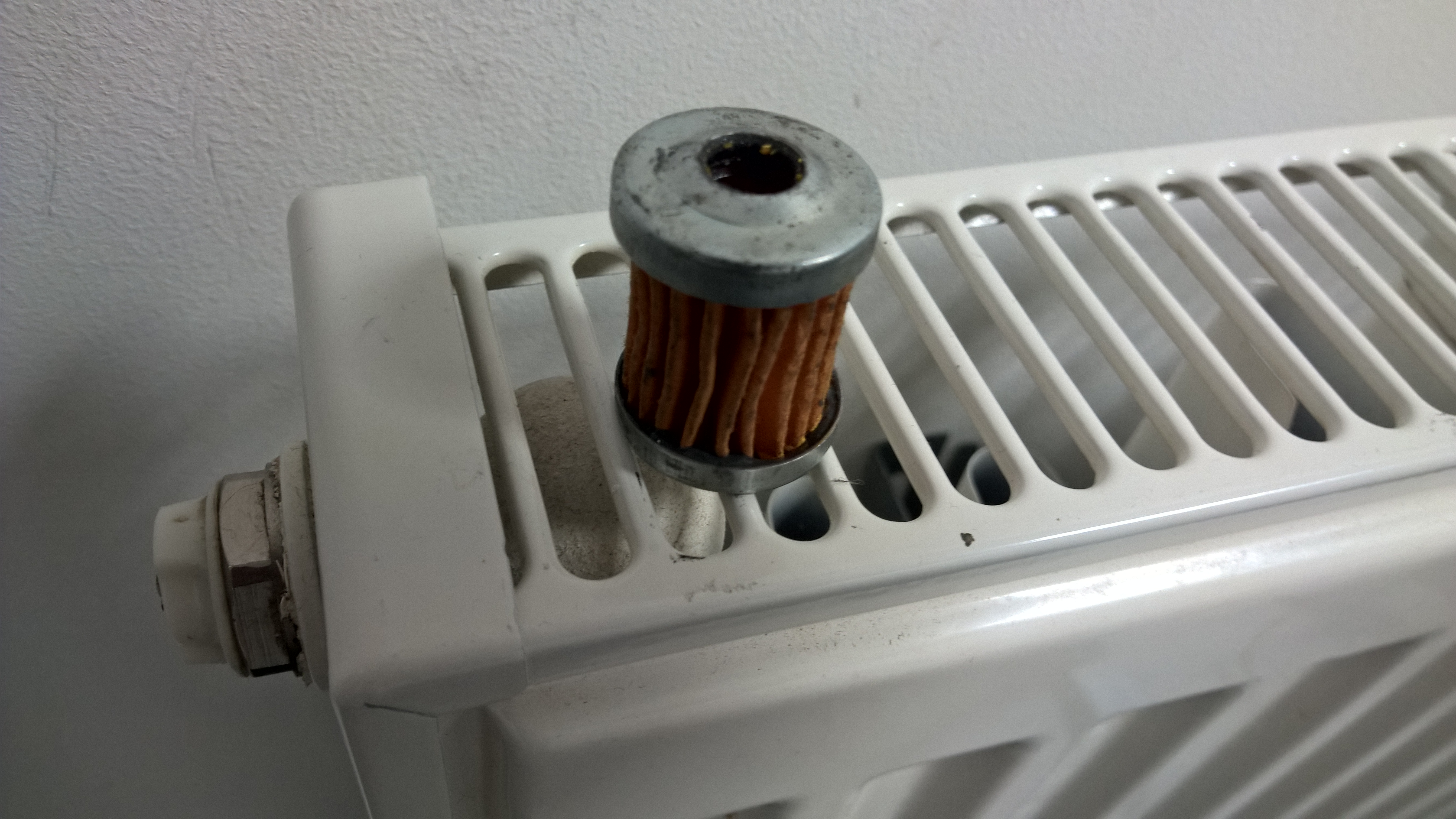

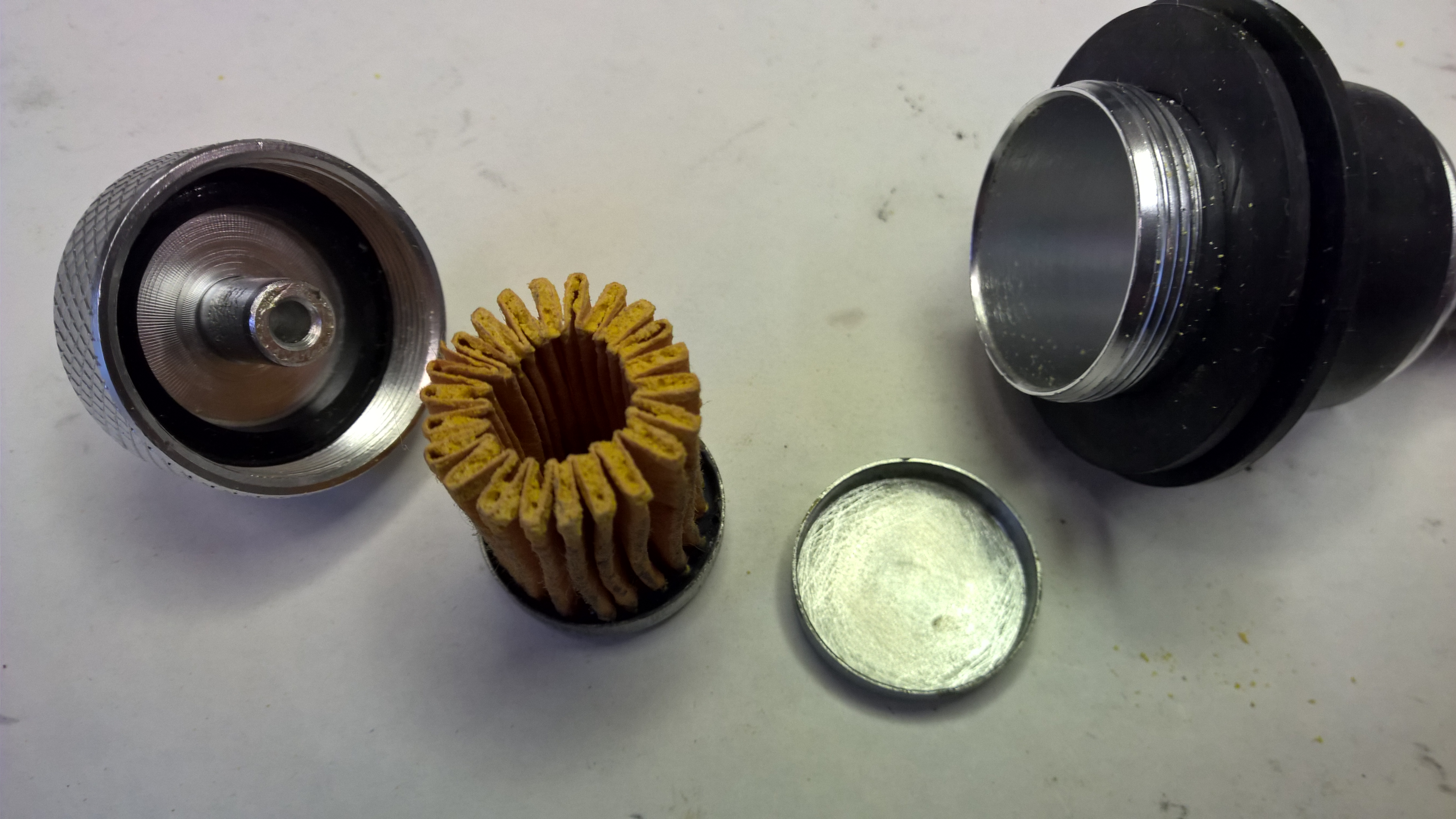

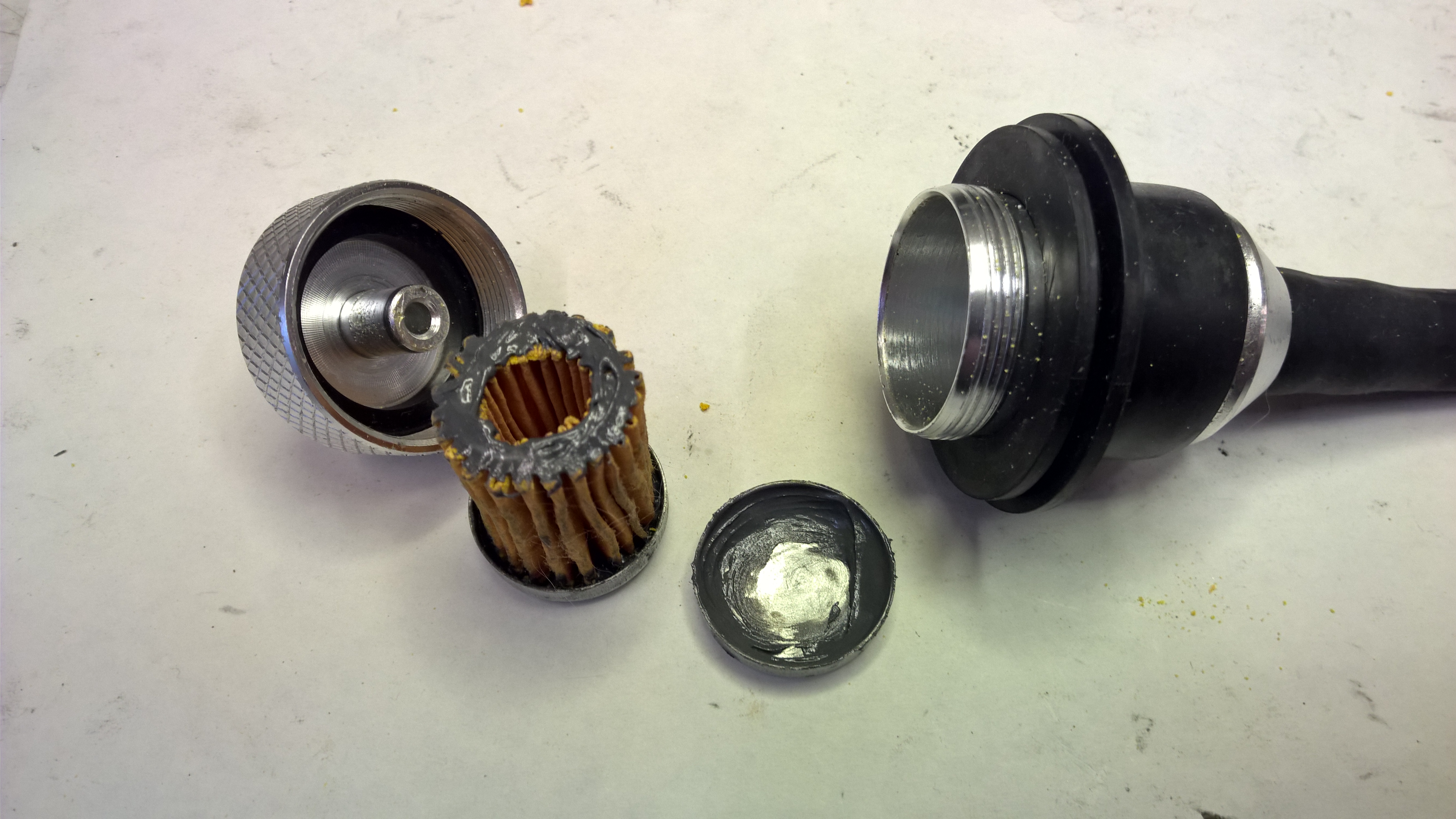

The end caps of this in-line fuel filter fell off when I removed the cartridge from the housing. JB to the rescue, I'd already used the stuff on the inlet port so I was confident that fuel wouldn't be a problem. Curing on a radiator speeds up the process and sets after about 5 hrs.
Posts: 9038
Has thanked: 2287 times
Been thanked: 2672 times
Re: Projects using JB Weld
I use it as filler when restoring bench vices.
Dave G
Posts: 143
Joined: Thu Sep 18, 2025 5:55 pm
Has thanked: 88 times
Been thanked: 71 times
Post by Dave G »
Great stuff. It seems to be used quite a bit for restoration work to level and smooth pitted metal.

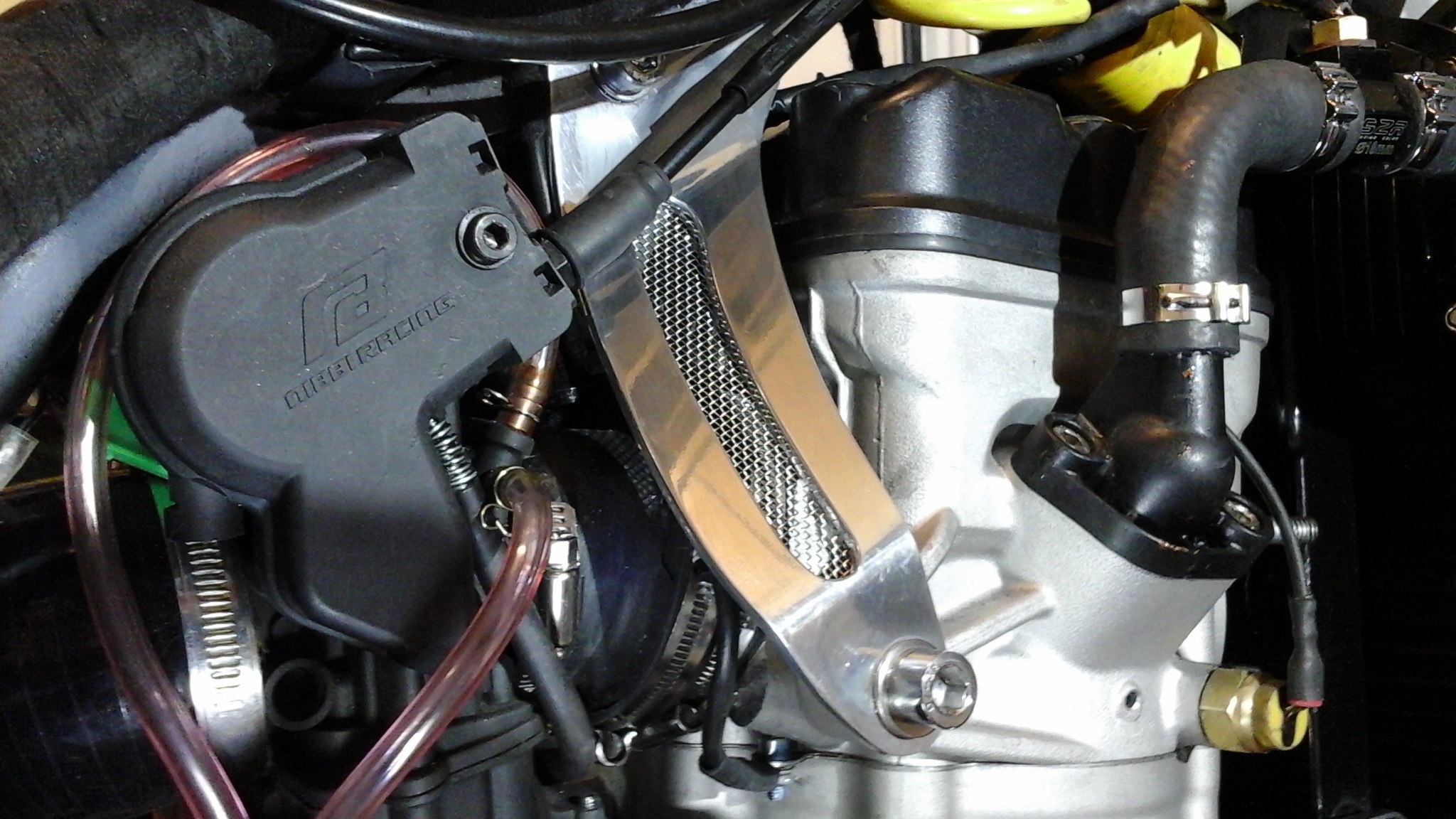

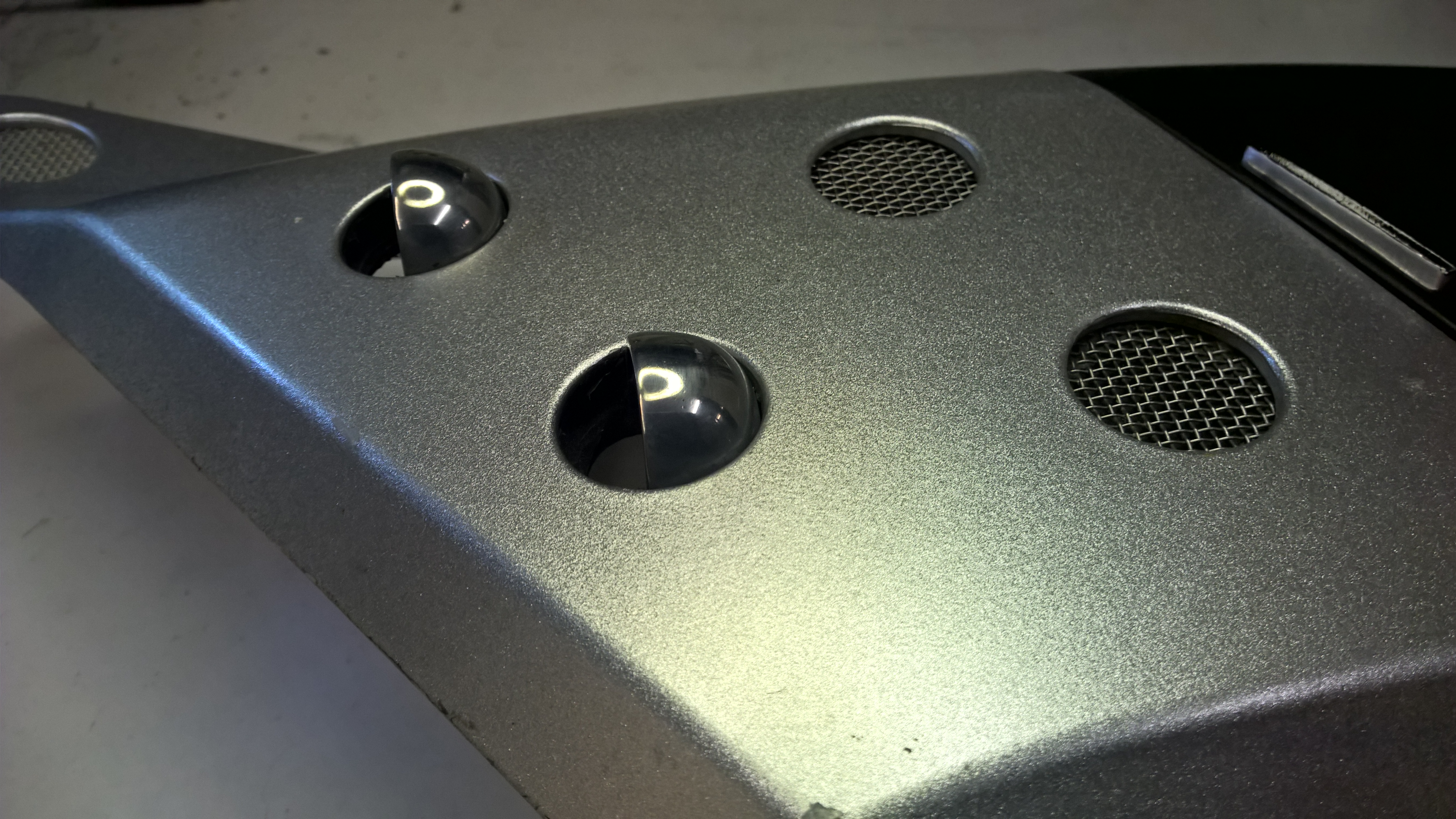

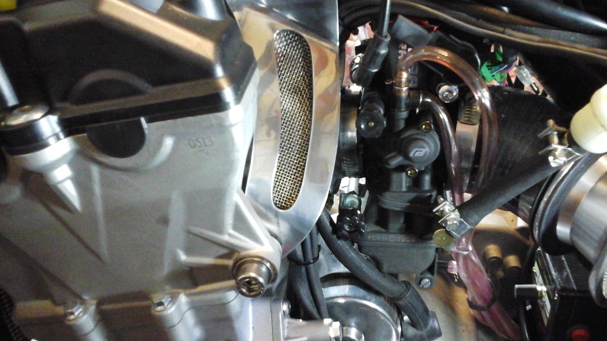

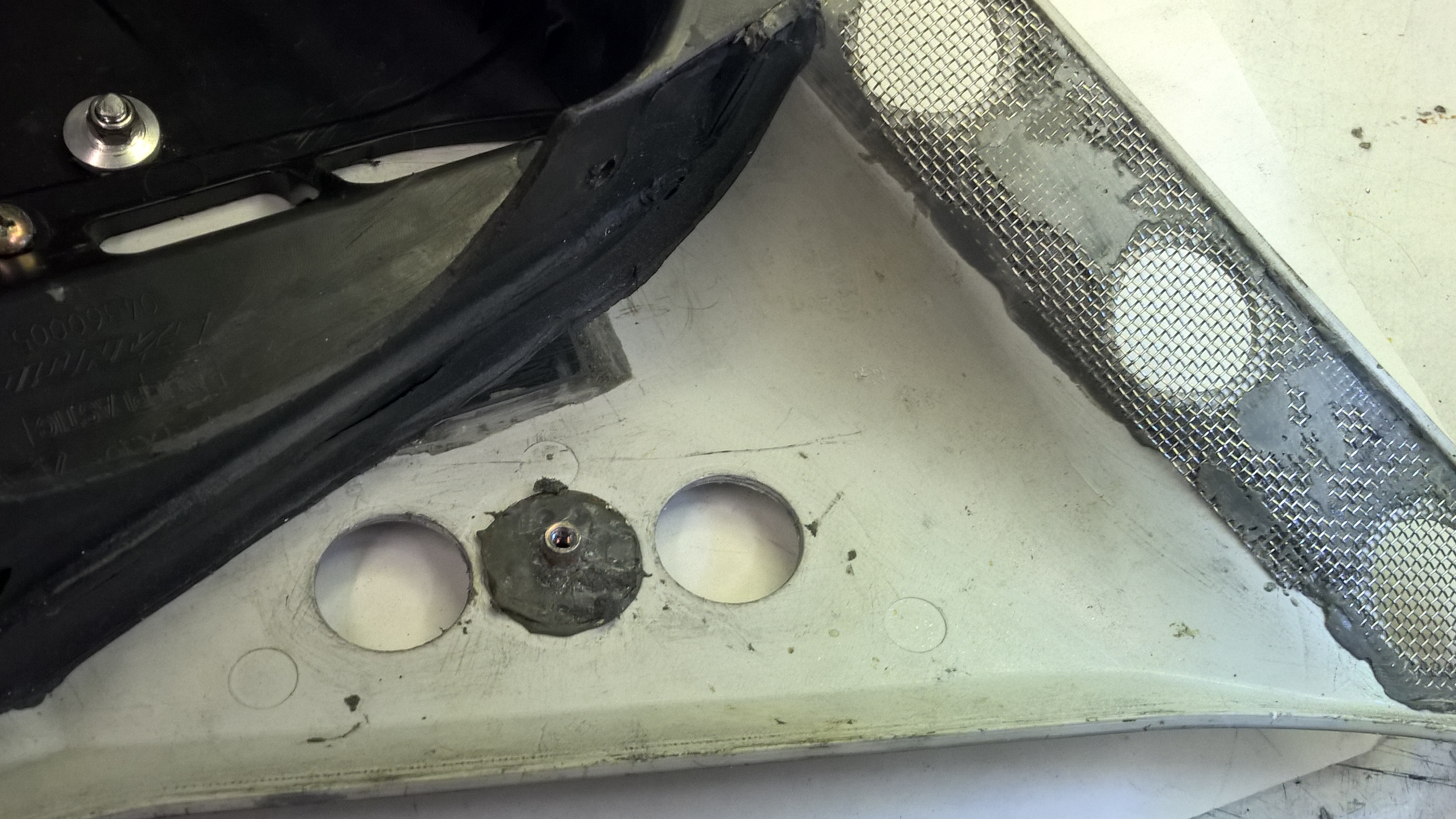

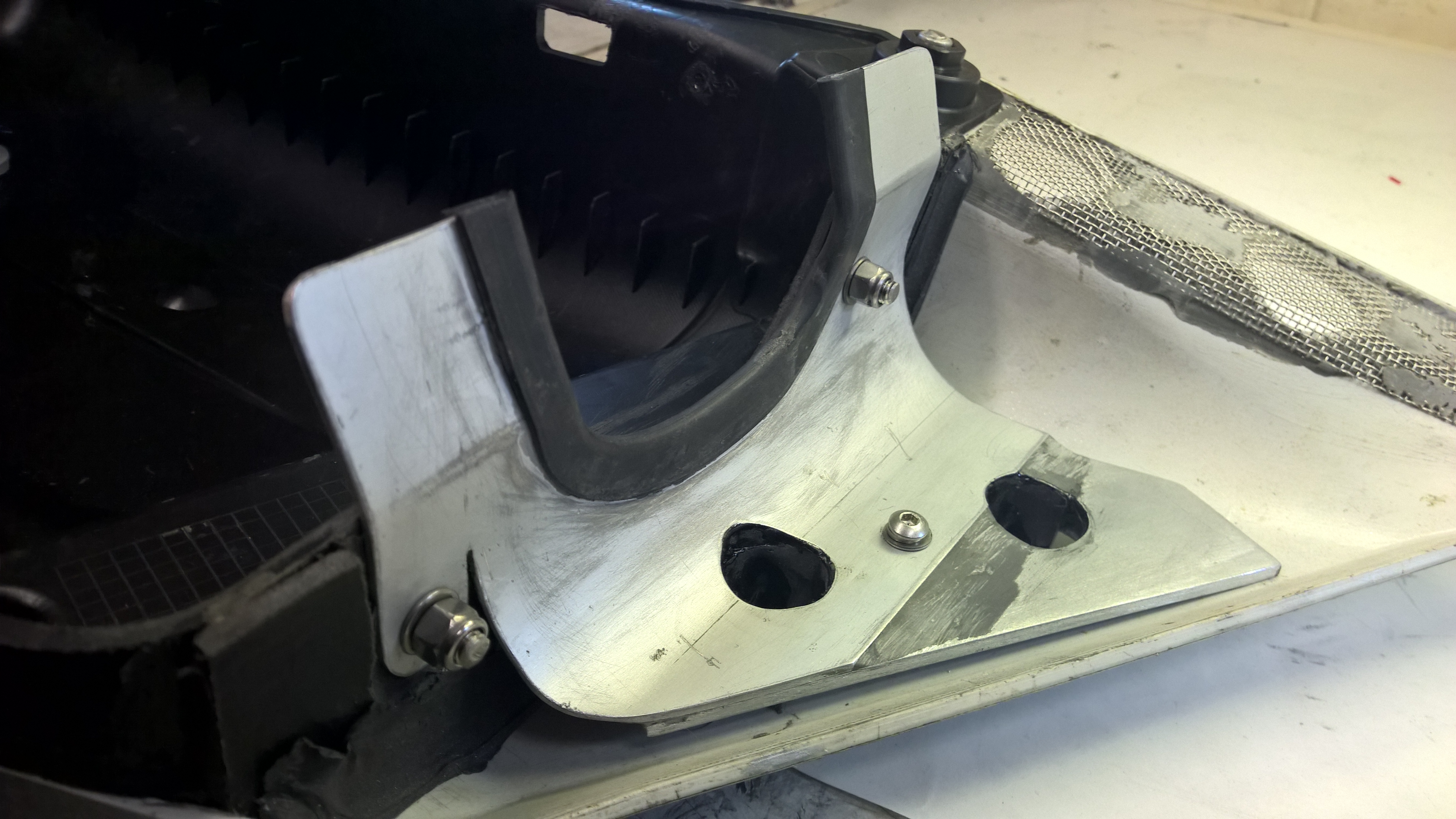

I modified the rear of the left side panel to incorporate a couple of air scoops and used some ally plate shaped to guide air into the carb, all stuck together with JB.

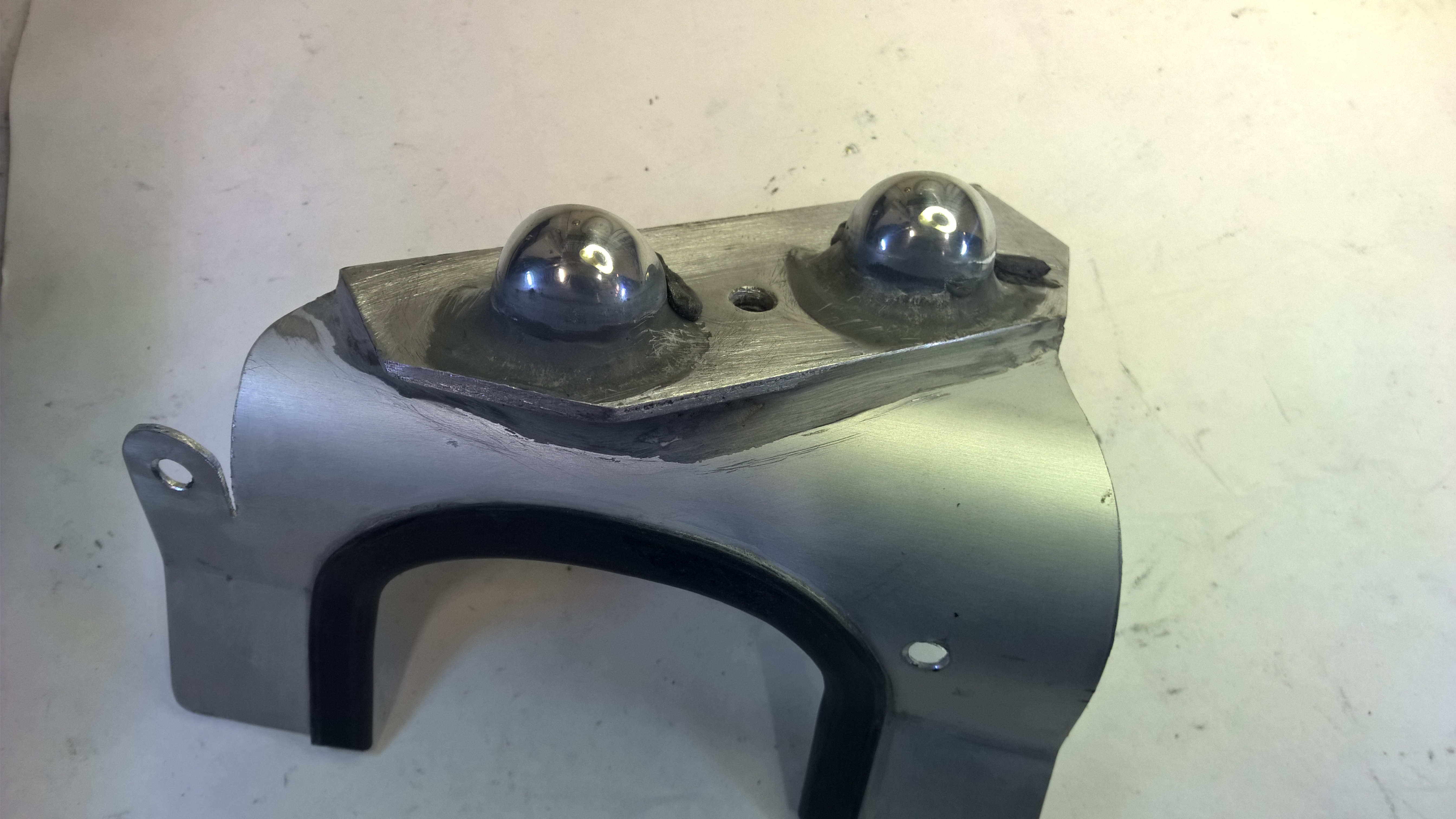

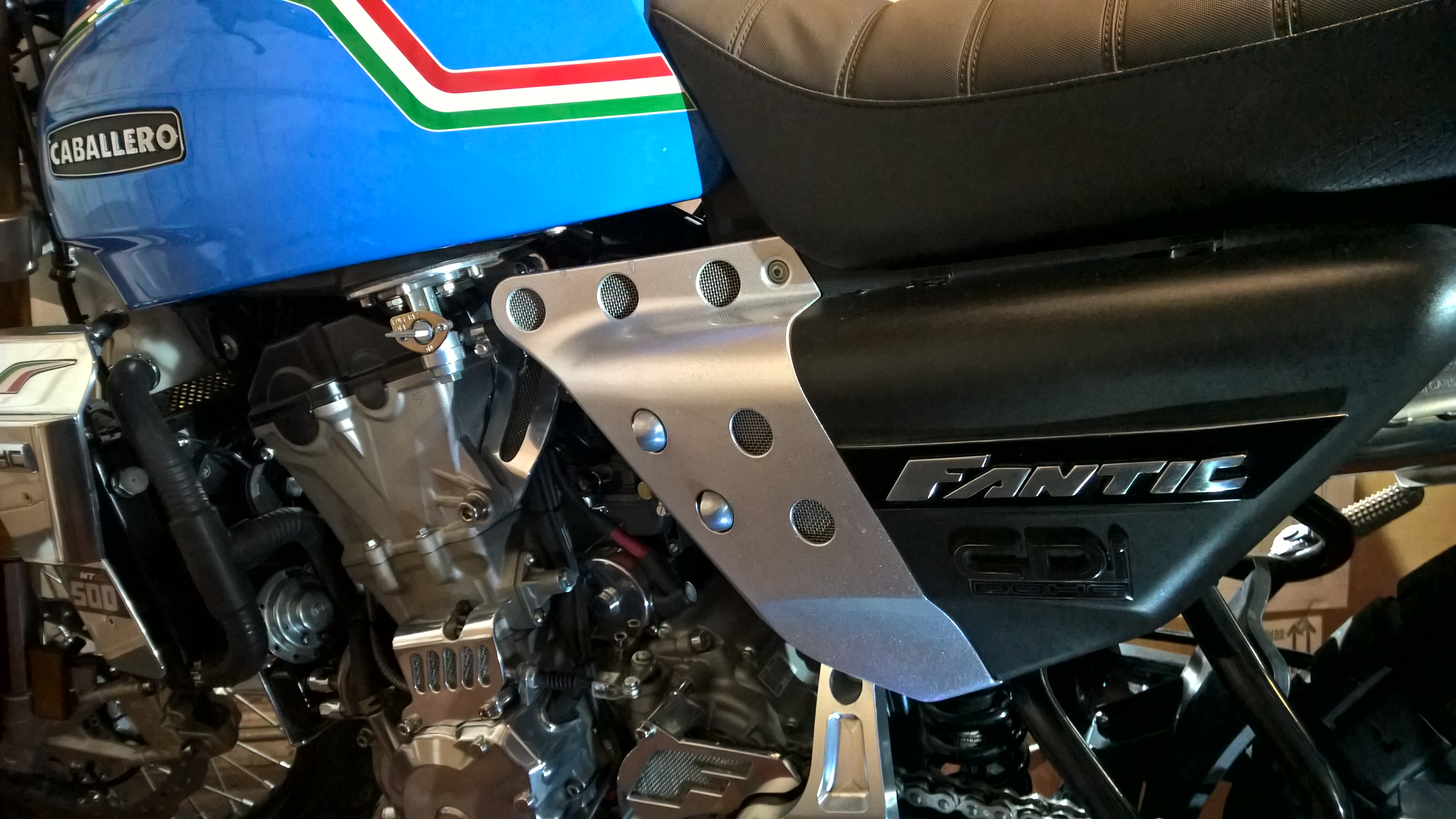

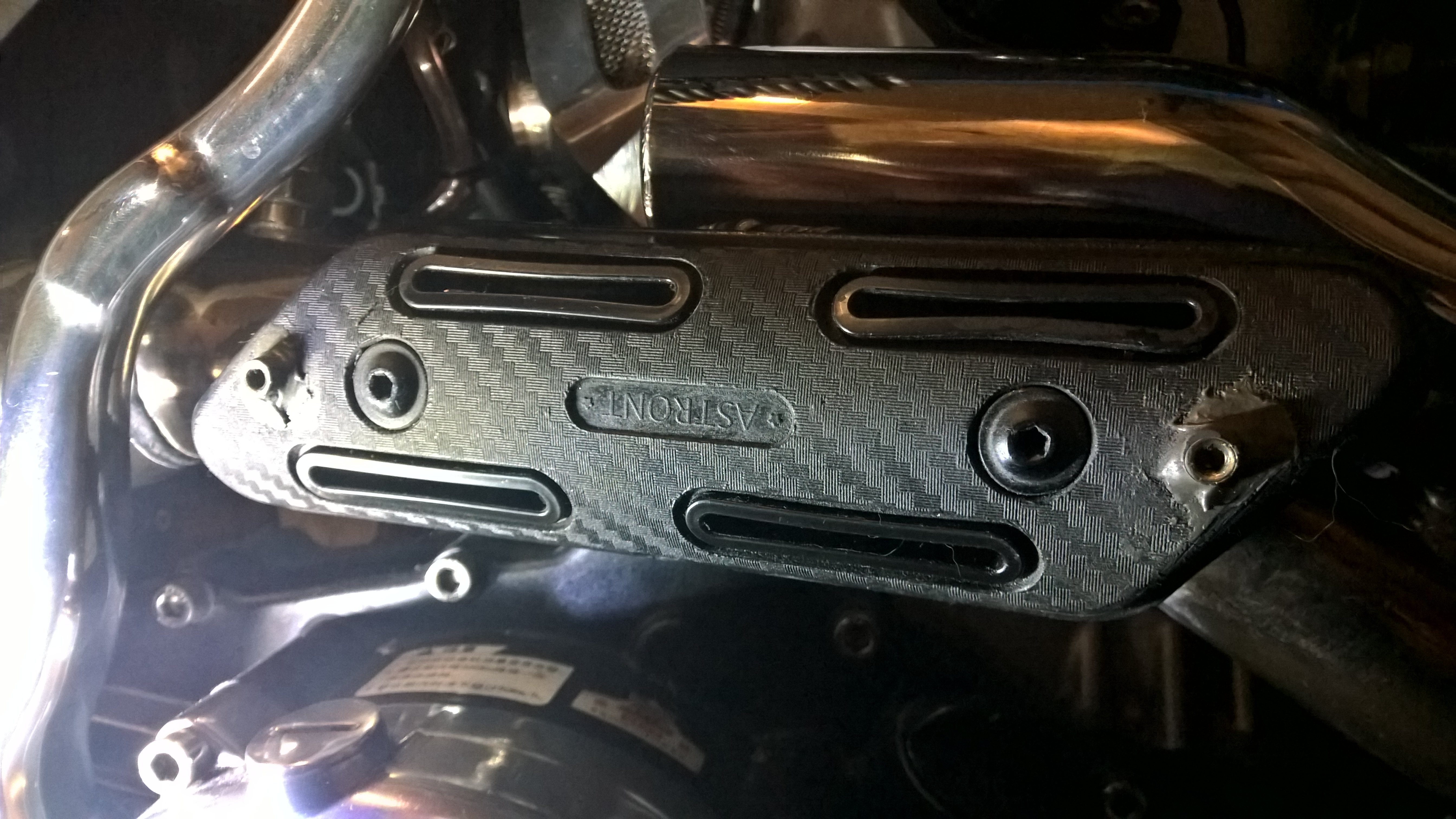

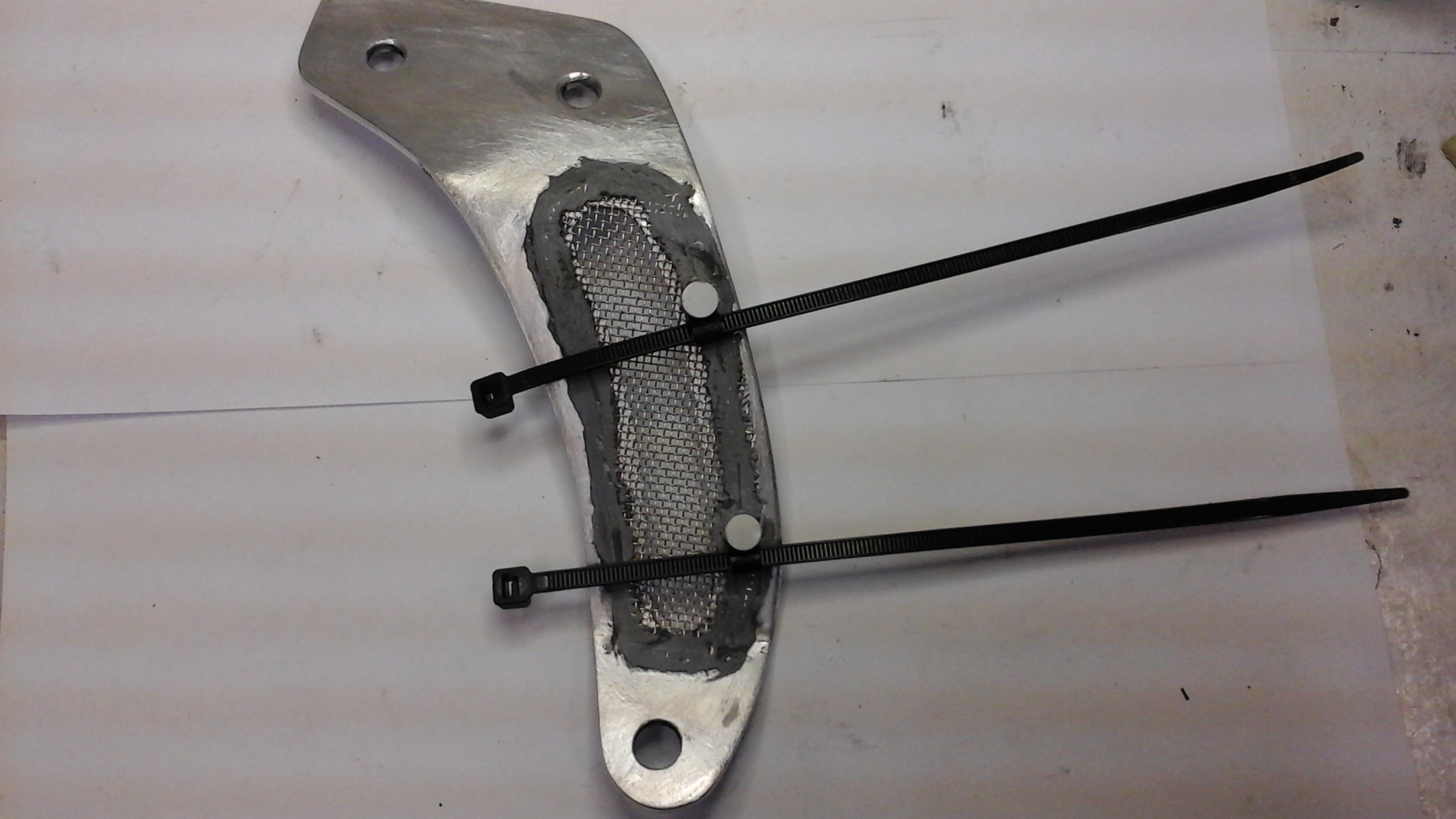

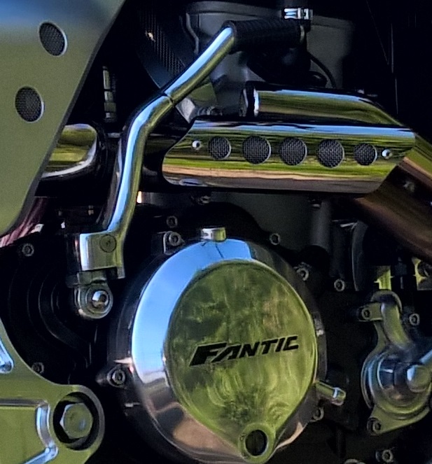

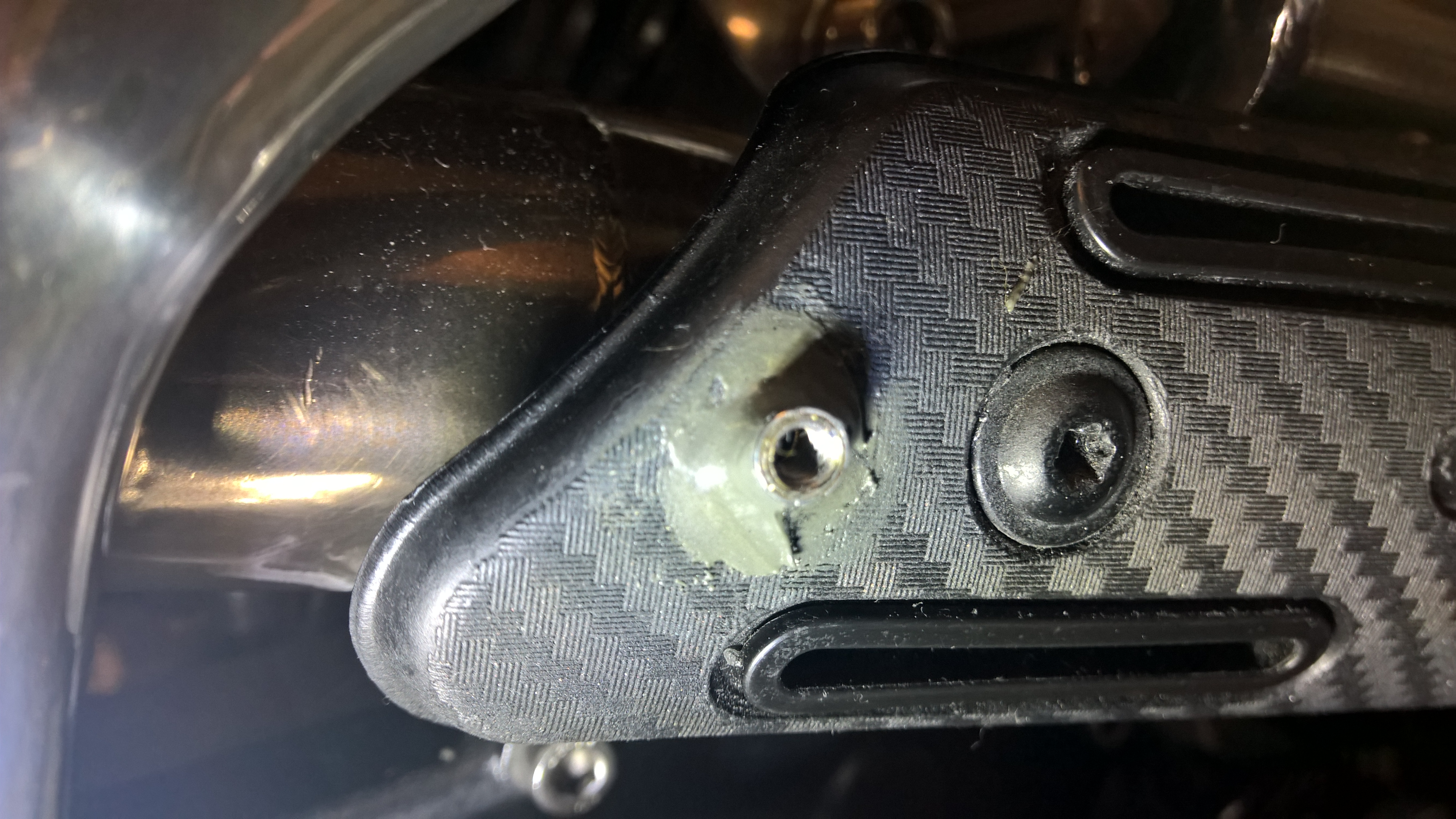

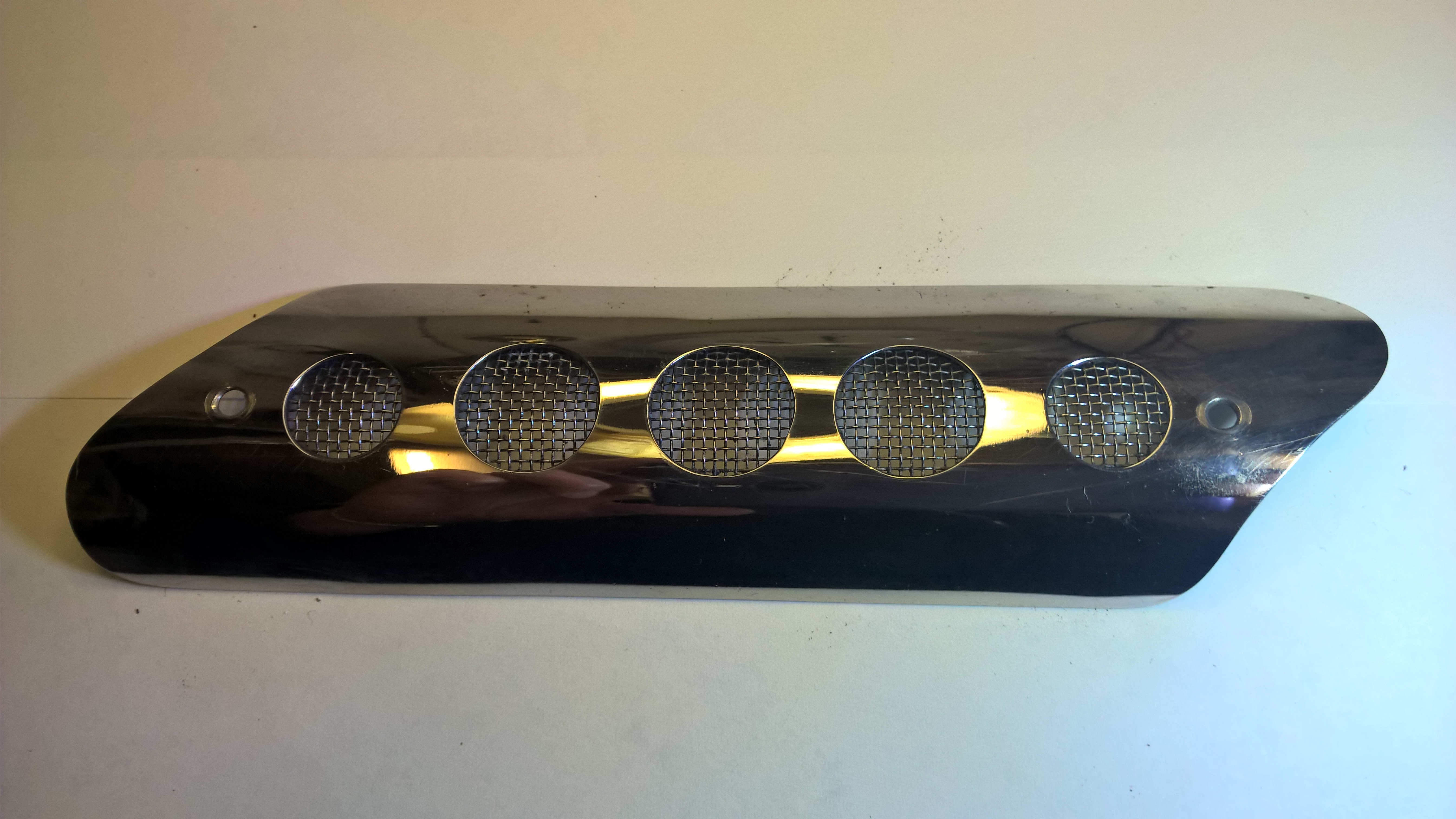

When I did the kickstart mod to my Fantic I had to remove the exhaust heat shield and the exhaust bosses to make space for the lever and come up with some sort of alternative. I purchased this shield from Aliexpress.
heat shield.jpg (76.32 KiB) Viewed 1139 times
Although it did the job it didn't look good!

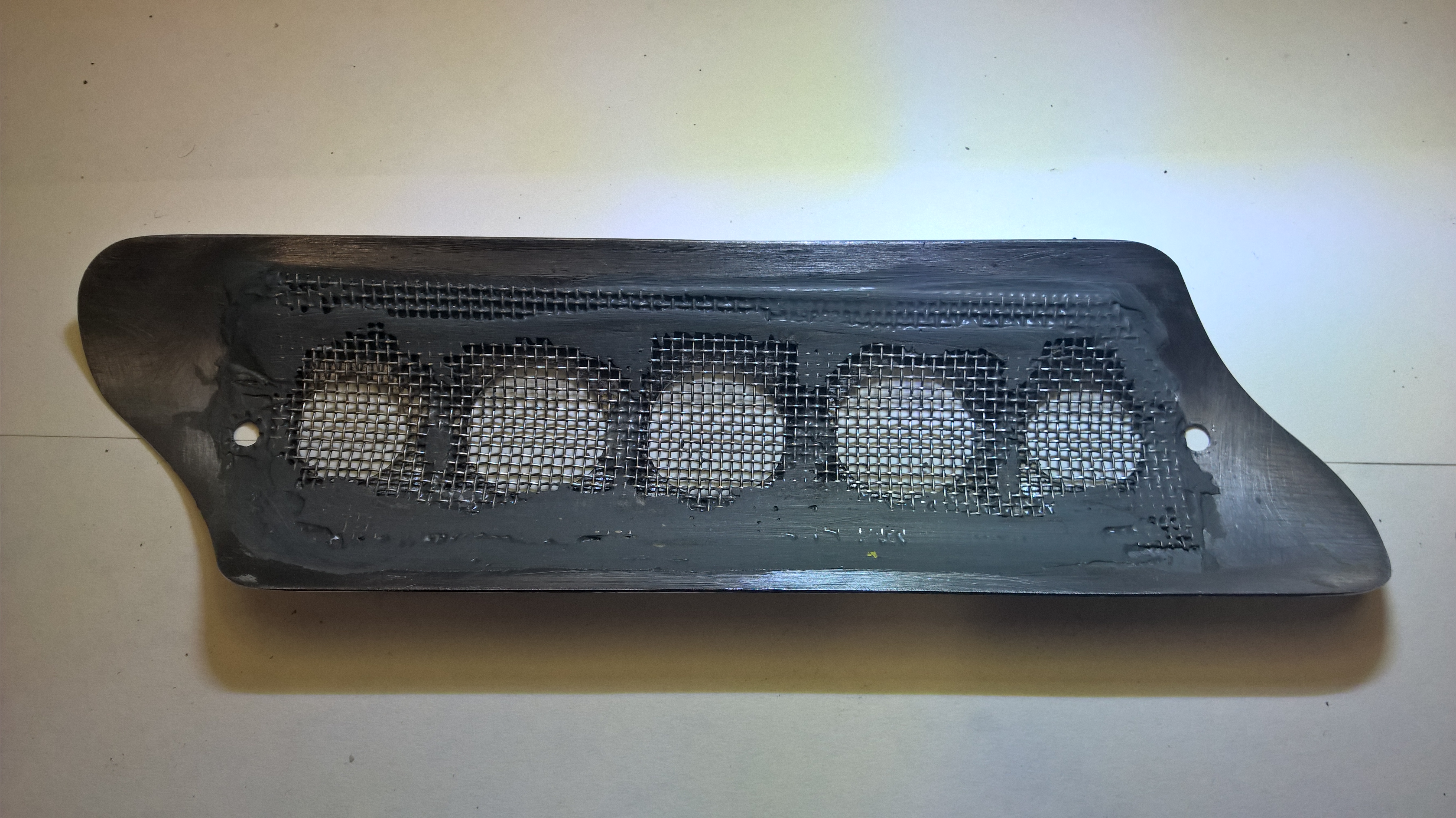

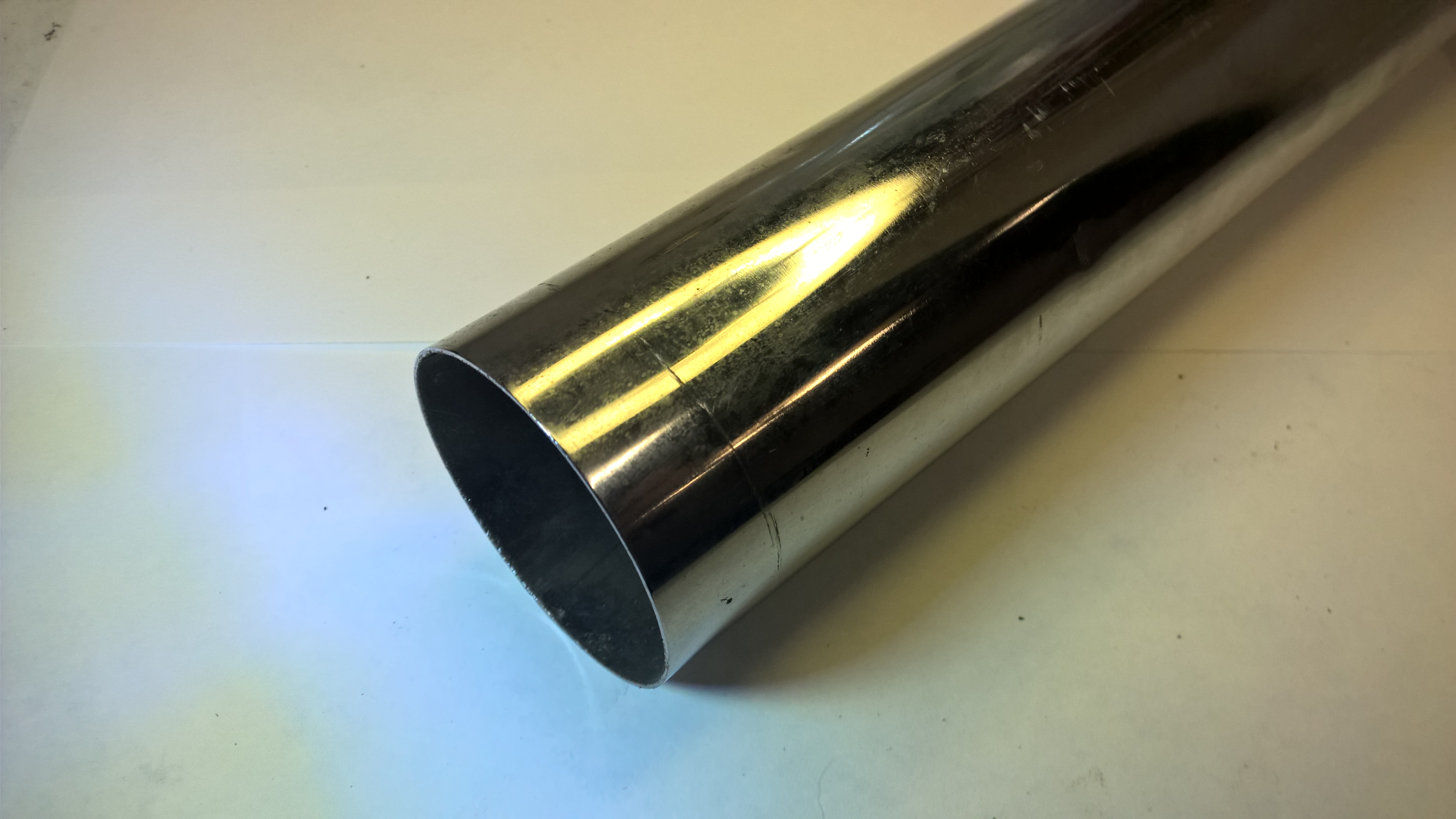

I decided to cut down this table leg and make a fancy cover
I used the heat shield as a template and came up with this
The mesh is stuck to the rear with JB
4mm bosses then stuck in place onto the heat shield with JB
This is what it now looks like
kickstart and cover.jpg (189.76 KiB) Viewed 1139 times

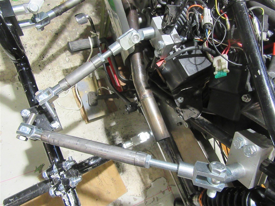

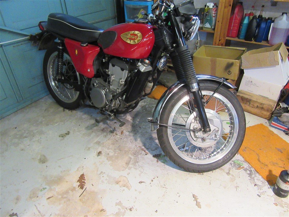

A few.... It's a 1969 BSA rolling chassis fitted (not by me) with a Suzuki DRZ400 engine giving quite sprightly performance. I'm currently engaged in fitting a Steib sidecar - all fittings have been made, alignment sorted out and the body tub is off to the paint shop next week. I'm having it done in the same red as the tank & side panels.
Here are a couple of pics.
In solo form:
A pic showing the mounting brackets for the sidecar which I made from aluminium bar:
This is the chassis propped in place for initial setup:
This shows some of the struts (made from seamless steel tubing with internally threaded adaptors before they were welded in)
and this is the body trial fit with the tonneau cover loosely applied.
