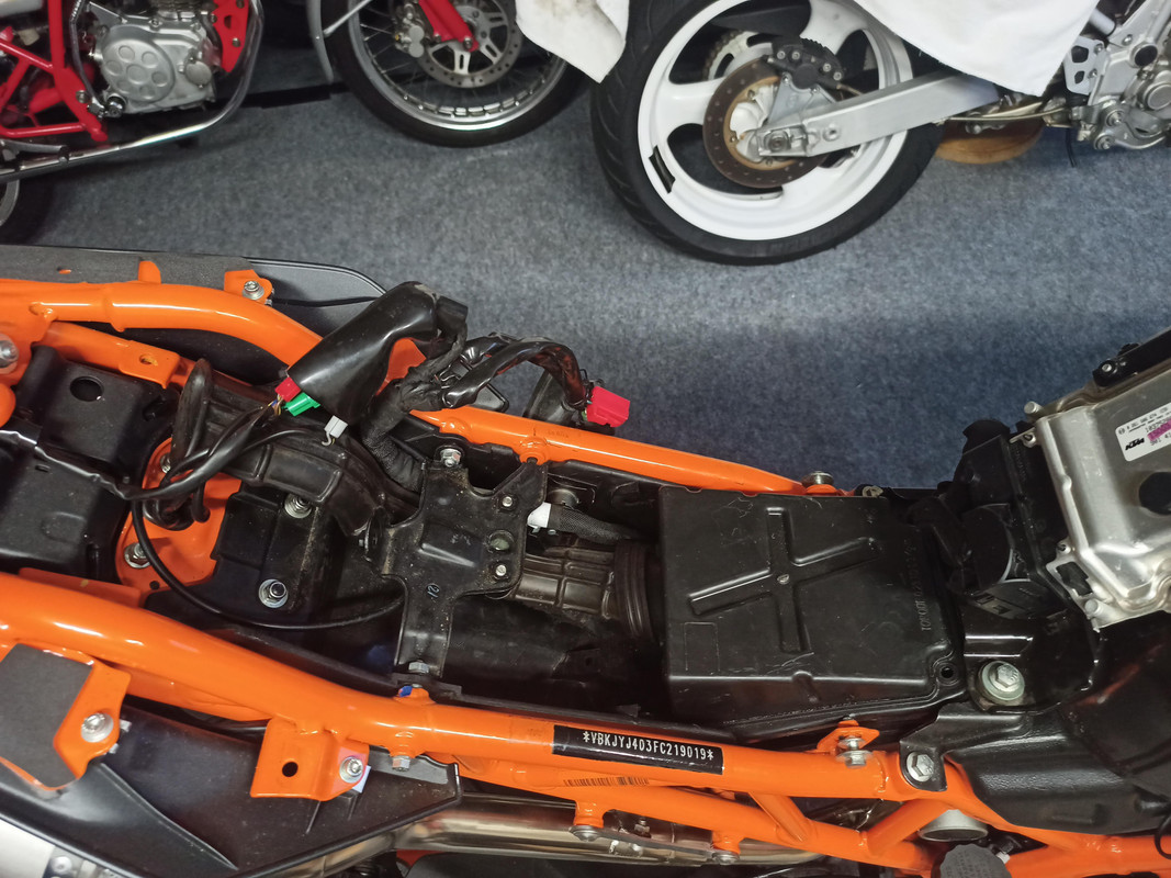

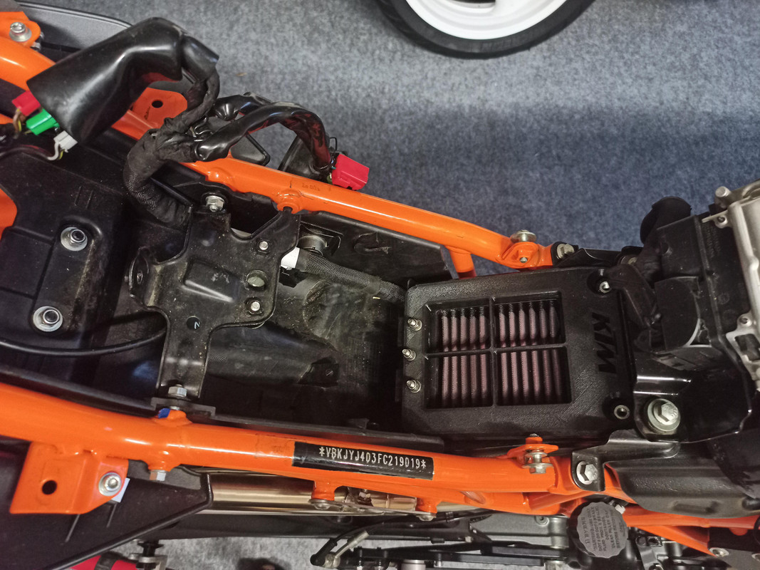

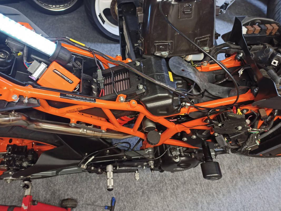

Well tomorrow is dyno day.
As I mentioned above, my original plan of doing runs with the RapidBike box on then stripping that out for the Powertronics has been amended as I didn't want to risk not testing the Powertronics new loom I obtained for the RC before I got to the dyno, so today I removed the RapidBike unit and loom, which was a slight faff as it sits up alongside the battery at the front of the tank (Powertronics goes under the seat) and also is sliced into the OE loom in a couple of places, and once removed, I then installed the Powertronics box and Quickshifter I had on my 390 Duke with a new replacement loom as the RC and Duke are slightly different.
I also installed a K&N filter and replacement open airbox top which with fueling adjustments is meant to make a fair difference in the mid-range- we shall see..
I had planned to do all stuff this at the Dyno place tomorrow, so I'd get before and afters of every combination, but due to me not being able to be there, it's not really feasible, but what I should come away with is 3 traces , and two new custom maps, and a comparison as to how it stacks up to my previous 390
So, some pics, as I know we all like them
This is the RapidBike unit, the finned alloy box which slots in a space in front of the battery
Standard airbox and long snakey trumpet, which really isn't that big and draws air in from under the rear seat hump
And this is the new custom made lid with a K&N in there,
And half-way through the Powertronics install
That's it for the moment- Full report and dyno graphs to follow over the week-end, followed over the next few weeks by front fork and sticky tyre upgrades before venturing out for it's first trackday shake-down in April

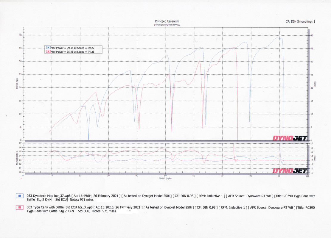

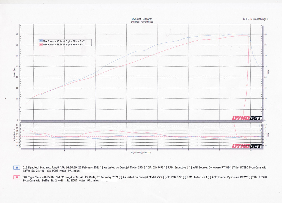

The RC390’s day on the dyno was an interesting one, with both good, and not so good outcomes .
The numbers we’re talking about are tiny here really, some may say comical/pathetic, particualy if you present them as £ per bhp, but what was interesting for me was comparing this one with my last slightly later (2017 Duke v 2016 RC ) 390 which I kept completely standard in terms of intake and exhaust.
As well as the comparisons with my old one, the boys here had also done another RC390 a month or two after my Duke and that one had a full de-cat system and they installed and custom mapped a PowerCommander on it, so I got that trace added to my before and afters for comparison .
Bottom line is that this bike (my RC390) is very slightly (~1 hp) down on peak power over my 2017 Duke and the other RC390 they mapped , but massively (relative term) stronger in the mid-range than either of them.
By massively, I mean approx. 5hp and 5ft/lbs – those numbers sound small, but believe me it’s significant when peaks you have are approx. 40hp and 25ft/lb.
The Powertronics and custom map made my old 390 feel more like my 525 in the middle, and this one now has some 20-25% more between 4k-6.5k than that one so it will be lively mid-range and will be a massively better road bike.
The road isn't really where this one is going to spend much of it's time though, and it's a shame the open airbox and Tyga exhaust doesn’t add any peak ( in fact this one was approx. 1hp down on my last one , but being realistic, that sort of difference can be down to so many things its not significant) , but that was probably an unrealistic wish on my part, and although on track I don’t anticipate spending much time in the mid rev-range, I’m sure there will be times when it’s of benefit.
Anyway, that’s the good stuff.
The not so good stuff is that this one likes a bit of a drink- of oil that is
It was on the dyno for about 5hrs in total and did a lot of runs, probably 50 or so, and drank 250-300ml of oil in the process- that's from top of sight glass to the bottom, and a lot on a relatively small single that only holds about 1.5l.
It’s got good compression ring sealin, as witnessed by the decent power we got, and no visible smoke under load , but coming back onto the throttle after shutting off would give us a stinky blue haze in the air.
Keith, my dyno man’s theory is that he doesn't think it's got any piston or valve damage (it’s done 900 miles in total) and the issue most likely stems from having “ too good” put oil in it when new, and been nursed too much in the running in period, with the result tht the oil control ring isn’t sealing as well as it should.
According to him Yams are prone to it, and R6s are particularly so if treated too gentle when new. My 390 Duke didn’t use a drop in my 2k-odd miles of ownership, and that was ridden flat out everywhere from day one so maybe there is some merit in that theory.
Anyway, we shall see. My plan is toplay it by ear for the first trackday or two, keeping an eye on the oil level, and if I think it’s a problem, the engine will come out and I’ll whip the top off for investigation, and assuming there is no damage in there, it’ll get a new set of rings ( and a bore hone if relevant, not sure if theses are chrome), follwed by my version of running an engine in

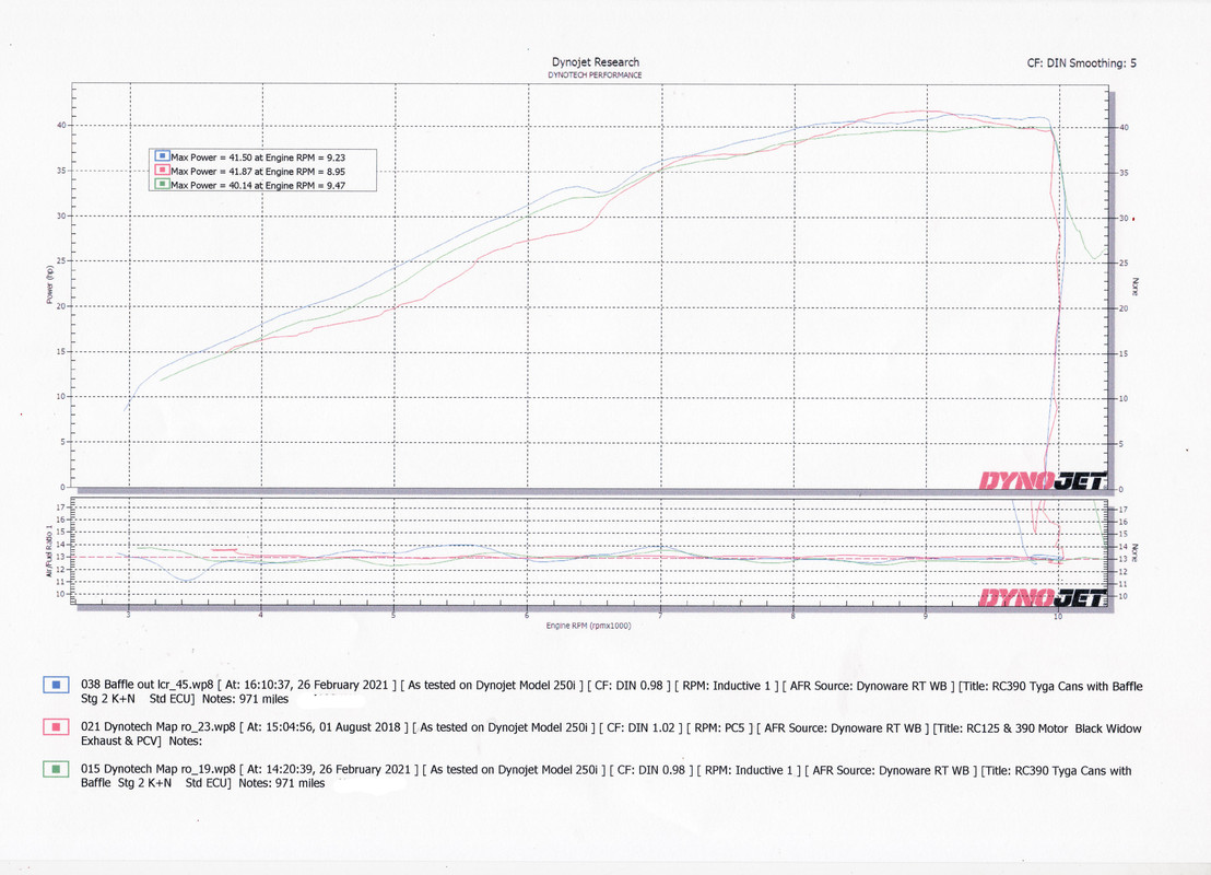

So the graphs:
This one is the hp before and after- less than 1hp increase at peak, but a healthy 10% or so increase all the way from approx. 5.5 to 8k, which is worth having and will definitely be felt.

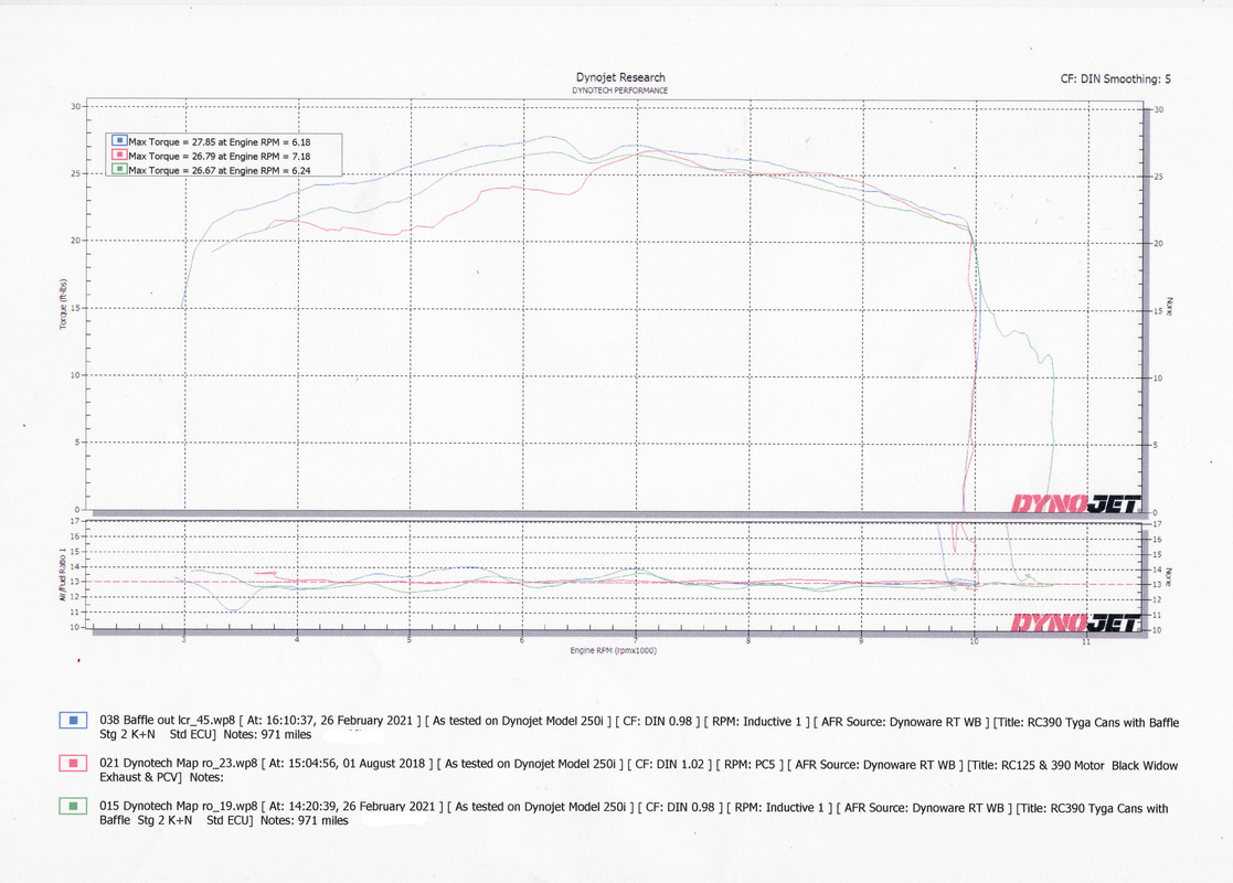

These two show the final hp and torque graphs with baffles in and out (green & blue) compared against the Power commander equipped RC390 (red) they mapped, the curves of which just about identically match my post-tune 390 Duke.
What the AF traces on these two graphs also show is how much finer they can map with a PC5 than they can with the Powertronics unit, as you get 250 rpm increments on the PC5, compared to 1000 rpm on the PT, and that allows you to get a lovely, much smoother A/F trace than you can with the Powertronics unit.
But that doesn't really affect things too much in riding experience swings and roundabouts- the Powertronics scores in other areas- you can create custom ignition advance maps, vary rev limiter and alter quite a few other parameters that Dynojet don’t give you access to- not that important or relevant on a standard engine, but once you start playing around with compression ratios, cam timing etc
And this is the before and after roll-on, which going from what it was and those of my 390 Duke, look very healthy- should be a wheelie monster!
So, the upshot is we have a nicely mapped engine and a good base to work from- I’m going to change the oil (it came with what looked like pretty fresh 300V in it, so I haven’t changed it yet ) and whack some semi-synth in there, rag it around the roads a bit over the next few weeks assuming the weather stays reasonable, and I think I’ll book onto an April trackday at Bedford and see where we go from there before I make any decisions about pulling the engine to bits.
Will keep you posted...

Tyga dual-exit under seat ehhaust and de-cat
K&N air filter with open top airbox
Powertronics custom fuel and ignition map
Quickshifter
ABS removed
Bendix MRR front brake pads
Cup adjusable rearsets
Dunlop Alpha 13 part-worns (CB500 racer cast-offs) fitted
Its still running bog-stock (non-adjustable) front suspension and all the lights, plate hanger and standard fairing and plate hanger etc is in place, albeit the mirrors will come off for the TD.
I have acquired a fibreglass nosecone which means that I will be able to ditch the front fairing and lights, but I've run out of time for this weekend so it'll do its first trackday with all the lights.

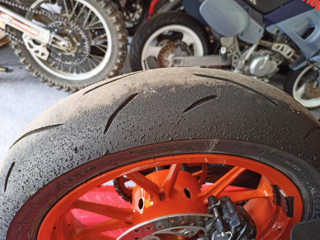

The 390's rear Dunlop at the end of the day with my "new" £30 R6 shock fitted
