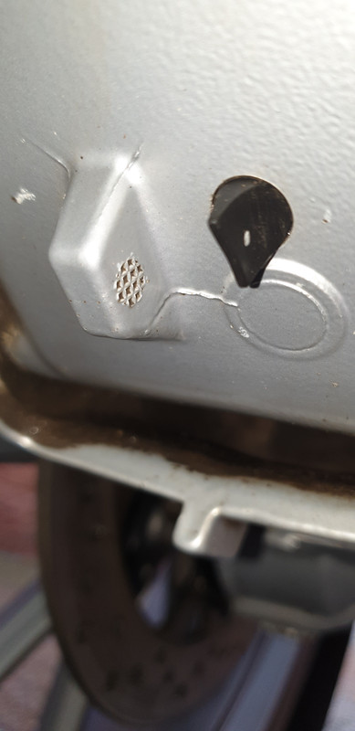

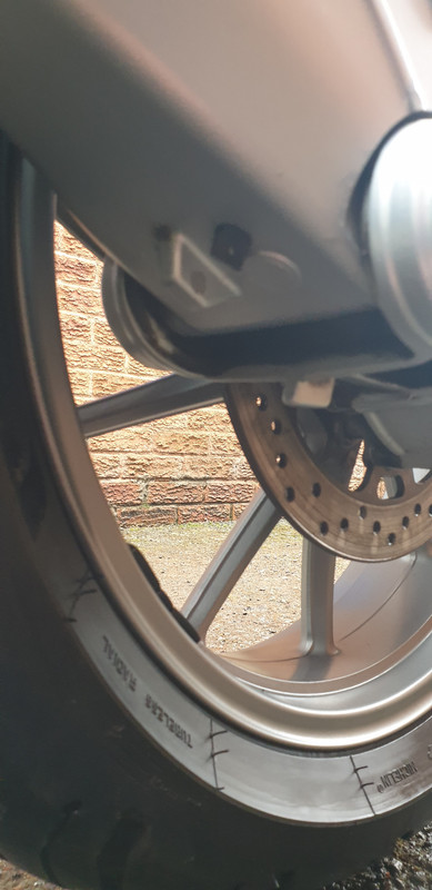

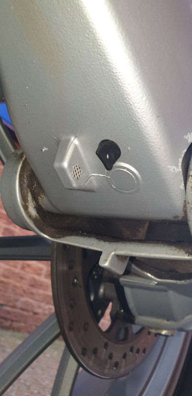

Picked up bike today, took it for a cuppa, covered it in road shite, first wash completed, will need a bit more tomorrow, maybe.
They drill swingarm and put in a little rubber breather to stop water building up inside. Overall, very happy, new driveshaft at no cost to me. It's a keeper.
