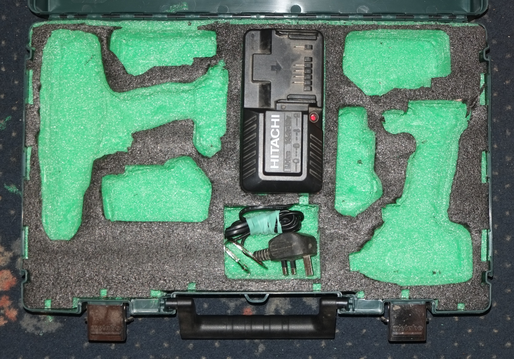

A month or so ago I acquired a cordless impact driver mainly for woodworking and DIY stuff (i.e. not an impact wrench for automotive use) and also decided to purchase a couple of extra batteries as I now had 3 cordless tools using the same Hitachi platform/battery set (a drill/driver, impact driver and 115mm angle grinder). The drill/driver came with its own carry case that held the driver, 2 x 2.5ah batteries and charger, but no room for anything else. The impact driver and angle grinder arrived bare, with no carry case, so I needed to start thinking about storage options.
Around about the same time Weeksy posted up a 'give me some storage solutions' thread that had some useful suggestions, one of which was a product called Shadowfoam. It did sound a bit Lord of the Rings-ish, but I didn't let that put me off. As it happened I had a good size Metabo carry case that had recently become surplus to requirements (I'd sold the scary-powerful Metabo die grinder that it housed) and I was pretty sure that this case could house 4 batteries, a charger and a drill/driver and impact driver if I was smart about the layout. So I bought a chunk of Shadowfoam in a fetching black and green colour combo to (sort of) match the Hitachi green and black and when it arrived (impressively quickly even during the pre-Christmas rush) I set about fitting it to the Metabo case.
The slab I bought measured 1 metre x 510mm x 70mm and there was enough material to comfortably make 3 inserts for the carry case, so event if I cocked up with my first (or even second) attempt it wasn't the end of the world. There's a thin (5mm) black top layer and then a succession of approx 10mm layers of your chosen colour which (in theory) should peel away once you've made in incision with the supplied scalpel and 5 blades (top marks for that, by the way). In practice the layers are more than a bit reluctant to peel, as my battered fingernails will testify.

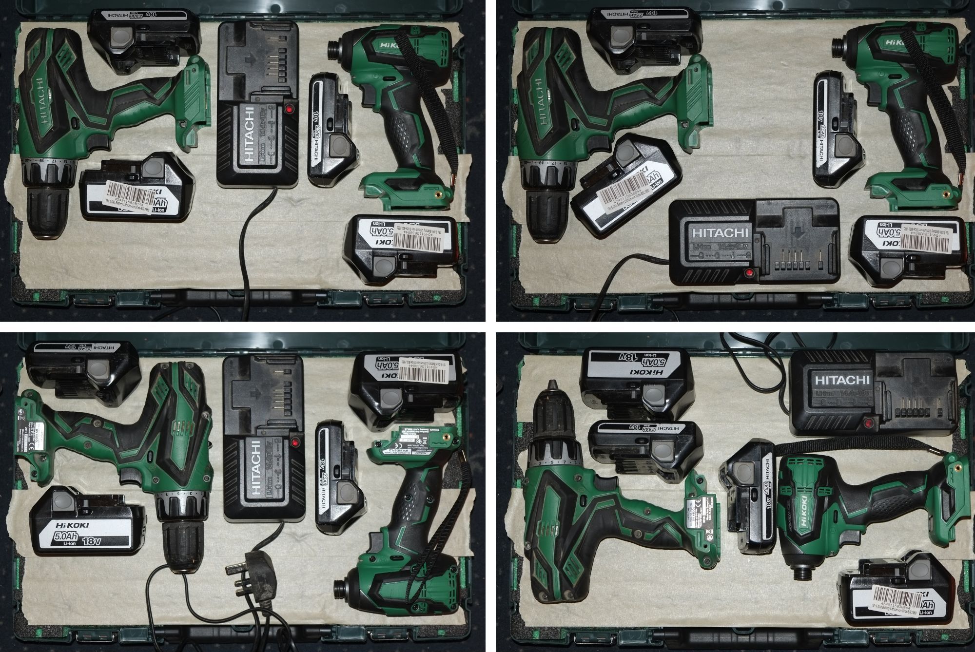

But before I started hacking away at the foam I needed a design to follow. So having fitted the SF into the case I got some wide masking tape and covered the surface of the SF with it and tried out various layouts. This is a composite image of four of the layouts I tried.
I took photos of each layout, loaded them up onto my PC and then flipped between them until I decided on a winner. Once I'd done that I recreated my favourite layout and carefully drew round the outline of all components with a Sharpie onto the masking tape. Then came the (frankly tedious) process of carefully cutting around the outlines marked on the masking tape. For each shape I initially just cut in to the depth of the scalpel blade (about 20mm) all around the outline of the component then dug in with my fingers and ripped the top layer or two out, revealing the green lower layer(s) of foam. This then gave me an outline to follow when excavating further. The blurb that comes with the SF makes this out to be simple and that the layers will detach fairly easily. In my experience they put up a fair old fight. Any way, after much cutting, hacking and peeling (and a number of chipped fingernails) this is what I was left with.
There are still some loose bits of foam I could tidy up if I could be arsed, but I can't. It'll do. The foam grips the various bits and pieces quite snugly and should protect the contents when being bounced around in the back of the van on the way to the south of France, so that's the main thing. I've also got some egg-box foam on order to stick in the case lid, so that the contents are completely encased in foam of one type or another. And this is what the plot looks like with all the bits in their respective nesting places.
So all in all |I'm very happy with the end result and equally happy that it's all done. I can't pretend that it's fun to do, but the end result is worth it.
And I have a 1 metre x 700mm piece of the stuff spare that I now need to find a use for...
