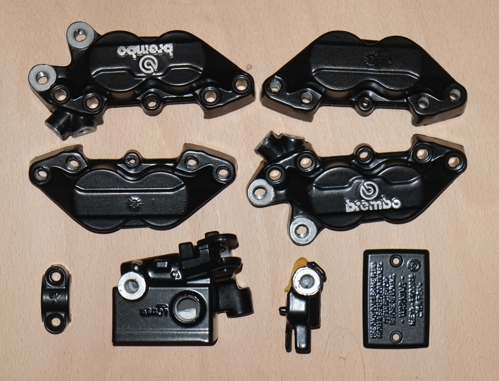

Last year I finally hit on a front brake master cylinder/caliper combination for the LC that gave me what I wanted - more power, excellent feel, while still looking (kind of) OE. The only problem was that the (eBay sourced) master cylinder was mechanically and hydraulically sound, but looking a bit crusty round the edges. And the calipers (being Brembo Goldlines) were a bit shouty compared to the black OE Nissins. So on December 6th I sent them all off to a chap I know who does excellent quality powder coating.
They didn't arrive until December 21st, by which time the chap in question was sunning himself in Cuba. So it wasn't until earlier today that the freshly powder coated parts made their way back to me. And when they did, I found that things were not as I'd hoped (I made my feelings known in the BYP thread in General Mayhem). Basically all the mating or sealing faces had been powder coated, not masked. So when fitting the calipers to the forks, there would be uneven powder where bare metal should be, likewise for all the faces where brake lines were to be connected, there was uneven powder instead of bare metal. I was not best pleased.
Faced with the option of sending them back for remedial work (with all the delays and hassle involved) or doing it myself, I reluctantly chose to DIY. Fortunately I had recently purchased some super heavy duty paint stripper (not the feeble imitation on sale in your local B&Q) which munched its way through 2-3mm of powder and clear coat with impressive rapidity. By masking off surrounding areas I was able to contain the chemical reaction to where it was needed (for the most part) and after a couple of (nervous) hours all the offending powder coat had been removed.
But I would have much preferred not to have had to do it...
All the bare metal parts in the photo below had previously been coated with powder, and there are some more faces you can't see. If I ever send any more stuff for powder coating to this guy I will mask all required bits off myself before sending them...

One lesson I have learned is that getting calipers (or any part of the braking system) wet painted is pointless unless a brake fluid-resistant clear coat is applied on top. Before having the calipers powder-coated I had them wet painted by a very well known company that advertises on eBay and specialises in bike brakes (no names, no pack drill) and they didn't do this. As soon as brake fluid came into contact with the paint it went tacky/sticky and stayed that way. This annoyed me no end, and so I sent them off for powder coat.
Powder coat with a clear coat on top is brake-fluid resistant (as long as you don't leave them soaking in the stuff), but your chosen powder coater must mask off all the sealing/mating surfaces as well as the piston bores.

So today I've been reassembling the powder-coated bits, particularly the master cylinder. Before it can go to powder coat every single piece, moving or stationary, that isn't part of the actual casting must be removed. This includes the sight glass, brake microswitch, brake lever and (crucially) the piston and all associated parts. Knowing how these come apart and how easily certain parts can be permanently damaged, I ordered up a brake master cylinder refurb/repair kit off eBay. When the kit arrived I was a bit concerned about how good the kit would be as it wasn't OE, but an All Balls copy. As it turned out, that was a pretty fair description...
For a start there were no assembly instructions or even a diagram - I know that I ought to know how to assemble it, but I would have expected something. The parts included in the kit were as scant as they could be and still be referred to as a kit - no piston, washer or c-clip - all those had to be re-used (thankfully mine were in OK nick). They did include a spring, the two seals (subtly differently sized but no indication which went where), a circlip, a rubber boot, two reservoir screws, two copper washers and that's yer lot.
When it came to mounting the wiper seals on the piston, the bottom one went on OK, but the top one was simply impossible to fit onto the piston shaft as the rubber used was just too inflexible. In the end I had to salvage and re-use the old one, which rather negated the point of a rebuild kit. And when it came to fit the circlip which holds the whole plot in place, it wouldn't flex sufficiently to slide down the bore using circlip pliers but jammed halfway and had to be driven into the groove using a hammer and screwdriver.
Moral of the story? Avoild All Balls master cylinder rebuild kits like the plague...
