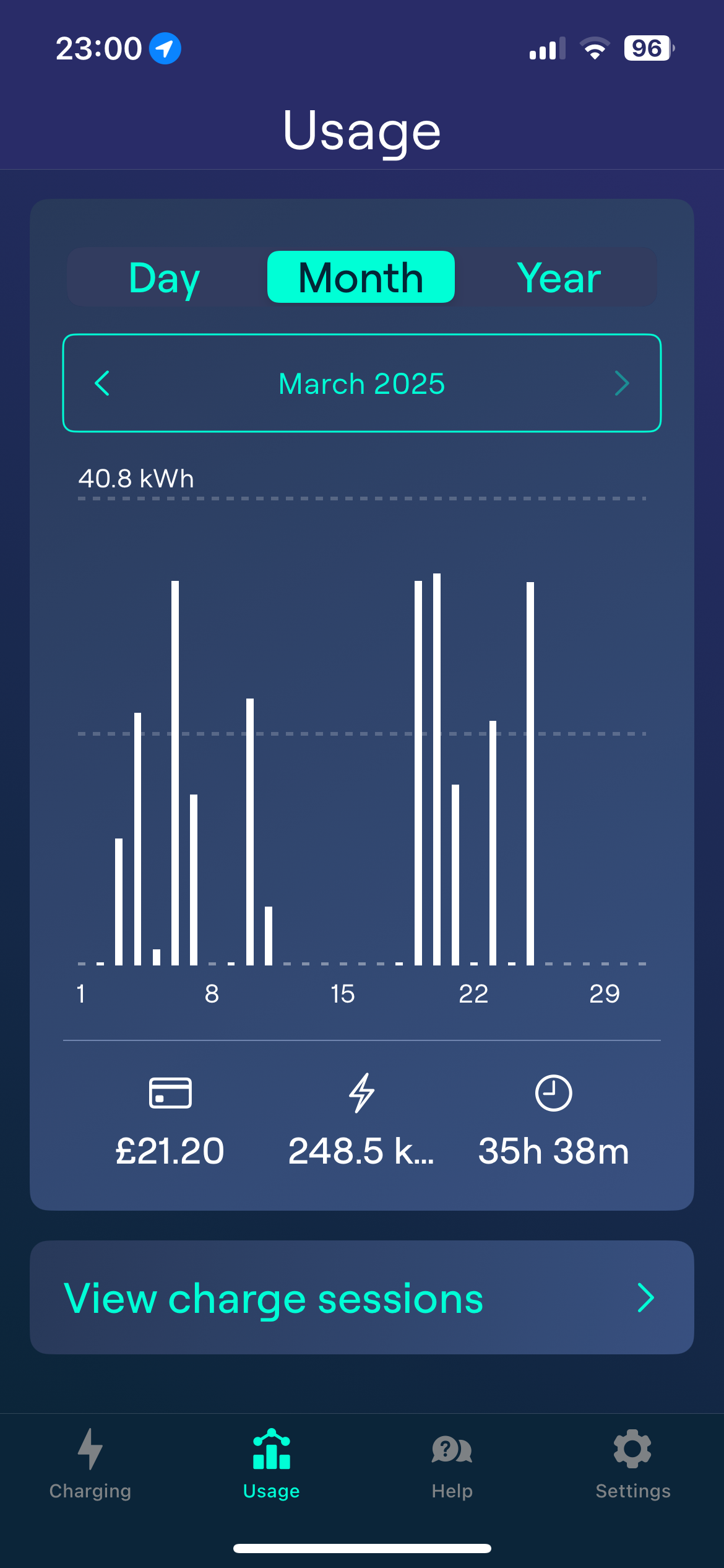

Posted: Fri Mar 28, 2025 11:05 pm
by wheelnut
My ‘fuel’ spend for this month. Probably about 1000 miles. I was away 11-18th.
