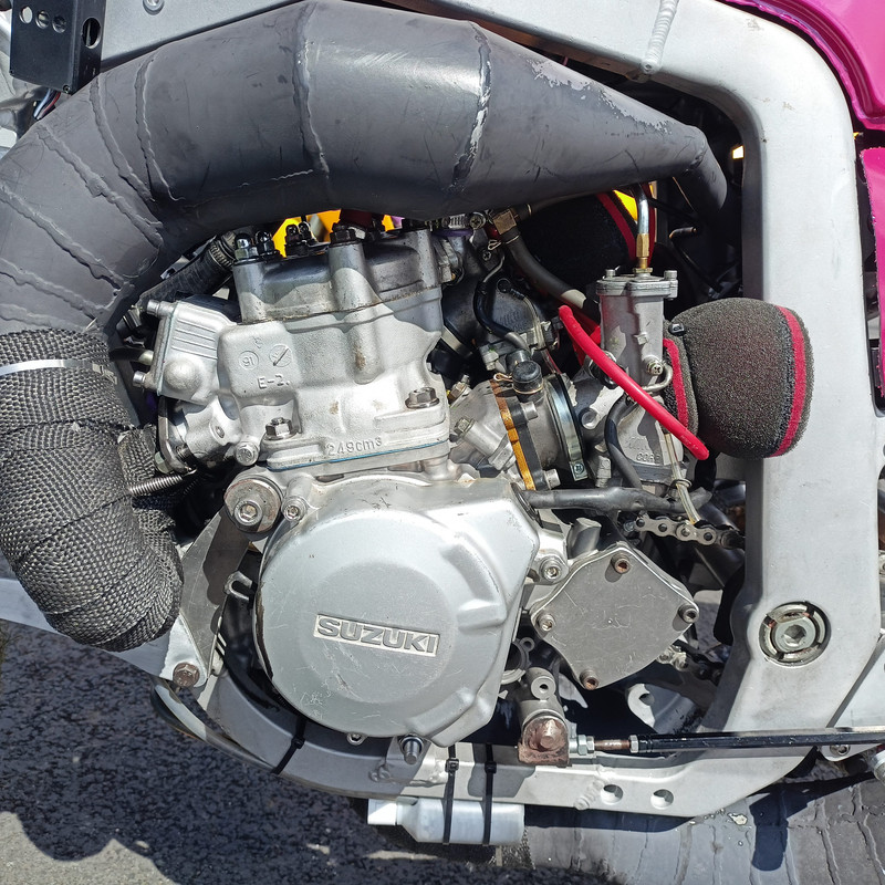

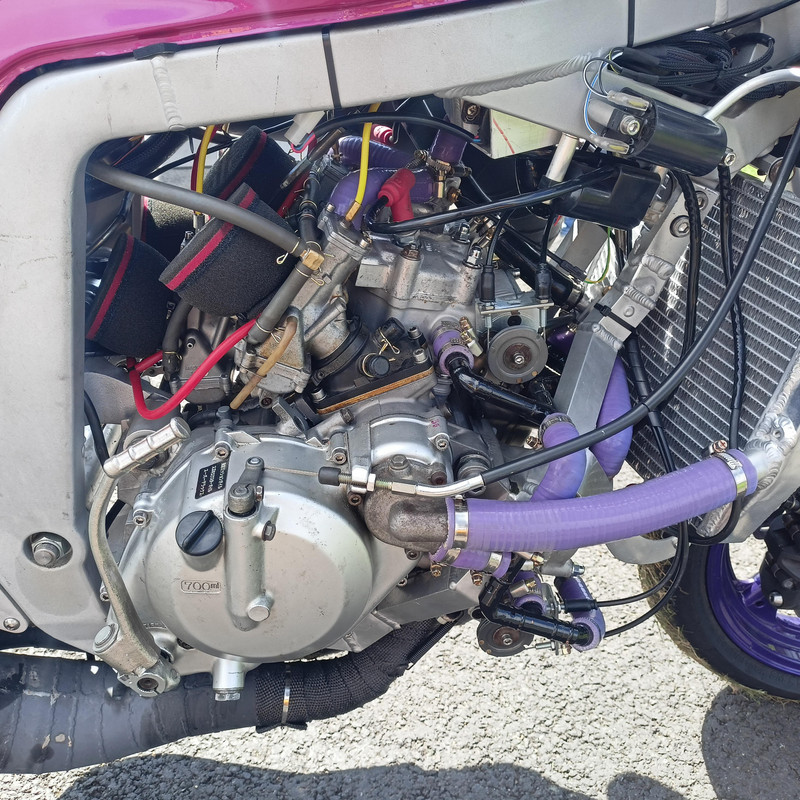

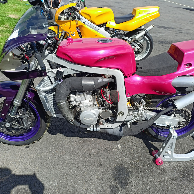

At a Cadwell 2-dayer trackday I did last week
What is it, you may ask, or at least that's what I did as I watched it going around in one of the other groups, so I found the owner, who was also the builder of it, and ended up having a really interesting chat with him about it.
Basically it's a home-made RGV500 , constructed by welding 2 x RGV250 motors together, Alan Millyard style, and plonking the lump into a GSXR400 frame, with an R6 rad, and various other bits that he could make do the job by the sound of it.
He was over the moon as this event was only the third time the motor has run, the first two times had resulted in bottom-end seizures within a couple of miles due to crank manufacture / joining issues , and although he definitely wasn't breaking any speed records, had a big smile on his face as he's solved his seizing problem as he was in and out leaving a stinky blue haze around Cadwell :thumbup:

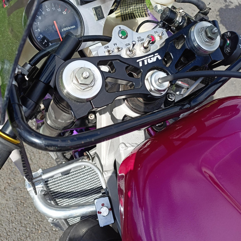

Some quite novel solutions to issues he's encountered, and interesting use of bits from other bikes - my favorite was the lubrication one- as apparently due mainly to his current failure to find a suitable alternative oil pump with sufficient capacity to servve the whole motor, but also due to where the standard oil pump is driven on the RGV, he is currently running two oil pumps- one exactly as standard RGV250, and the other electrically driven.
As initially installed it was apparently massively over-oiling with the gearing he was able to give it, and he currently hasn't worked out a way of regulating the amount of oil that pump provides with throttle position, ( as of course the standard pump does), he has installed a simple speed-control pot as may be seen by the LHS of the tank in the pic below.
Aparantley the paint dot at 9 o'clock is for ticking over/warming up in the assembly area, 12 o'clock is once he's underway on most of the circuit, and as he comes onto the straights he flicks it to 3 o'clock with his left glove, before flicking back to 12 o'clock at the end of the straights just before he tips in :lol: 8-)
