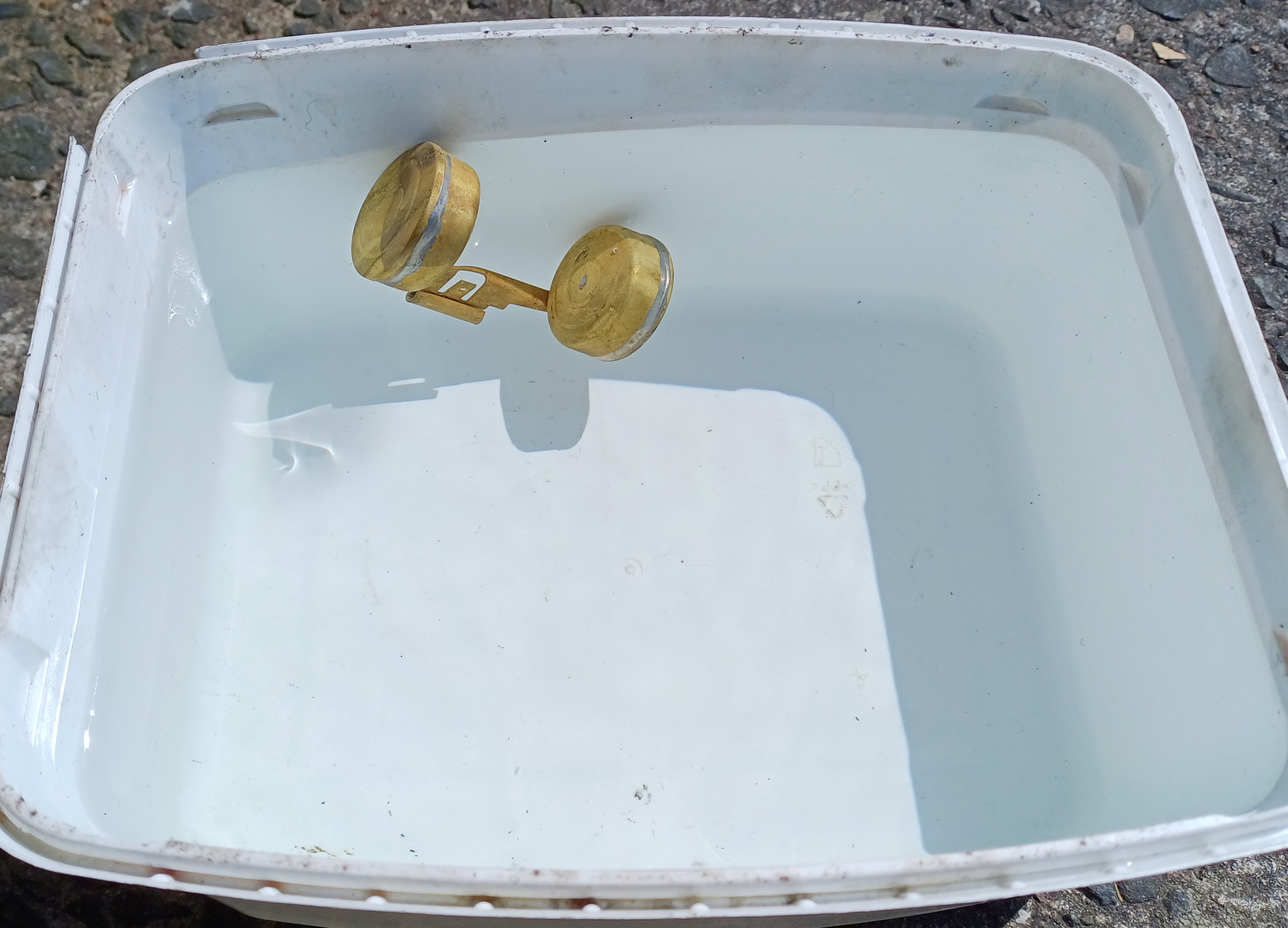

Re: Kawasaki H1 1971
The bike began behaving oddly on cold start a while back,the middle cylinder lagged a bit behind the other two,then popped and banged into life. I'd the carb off a few times and found nothing amiss,so as it ran fine otherwise,I have just ridden it and waited for further developments.
The further developments came today in the form of pissing fuel continuously out the overflow on the middle carb,so off came the carbs once again.
As exhibited in the pic below,we see the offending article,one leaking float. I have a spare set of carbs,so I stole a float off them to keep the wheels turning.
I'm even getting better at refitting the airbox hoses,this time I didn't even say 'cunt' once.

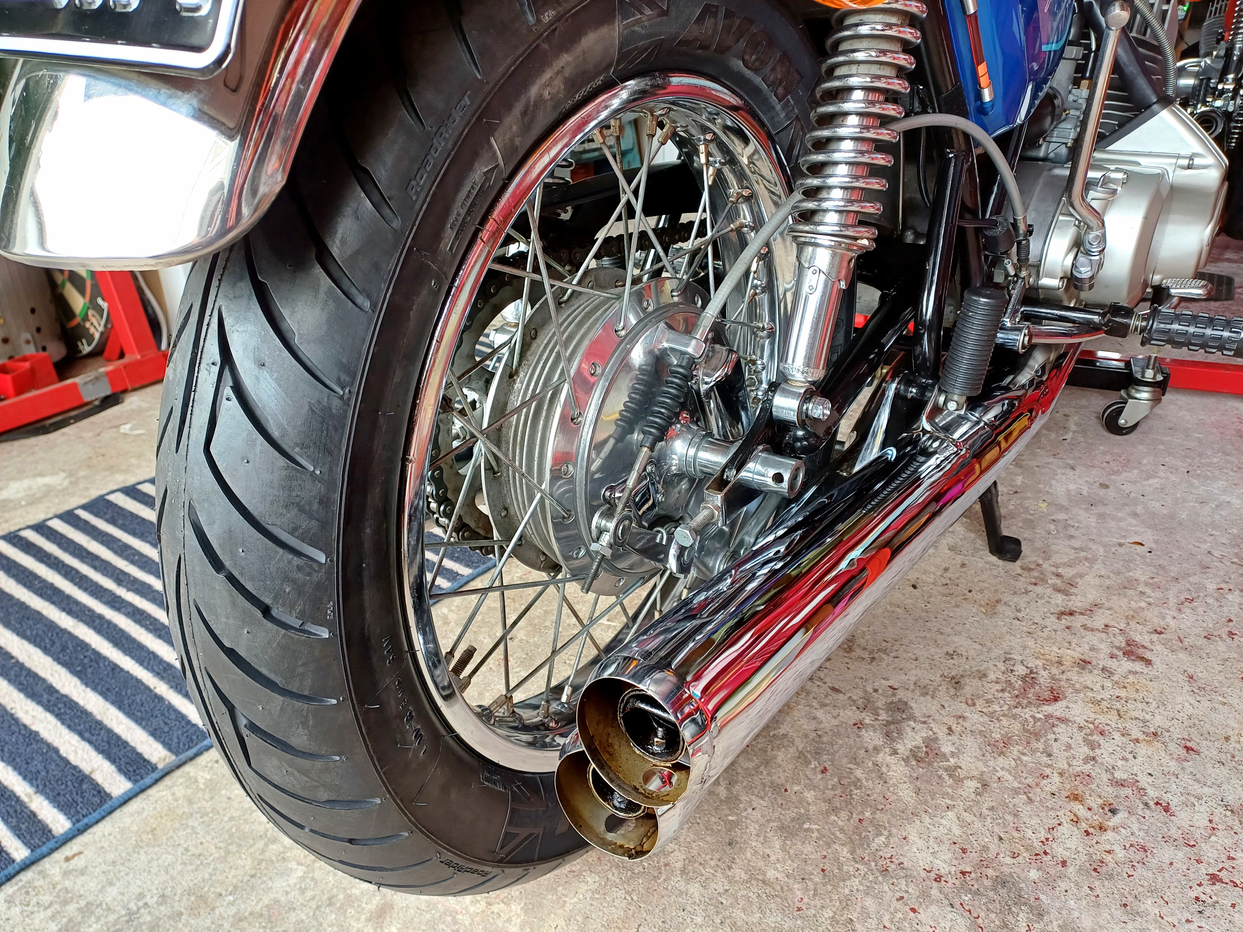

Nice new rubber for the rear. Avon Roadrider 2. Just need the rain to stop now.

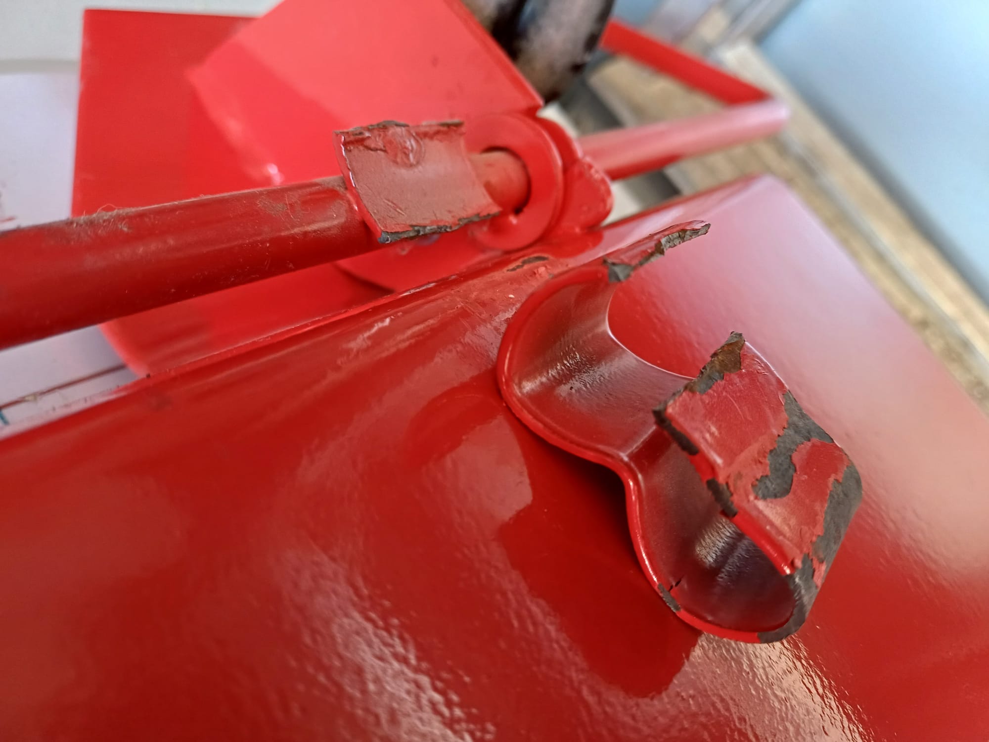

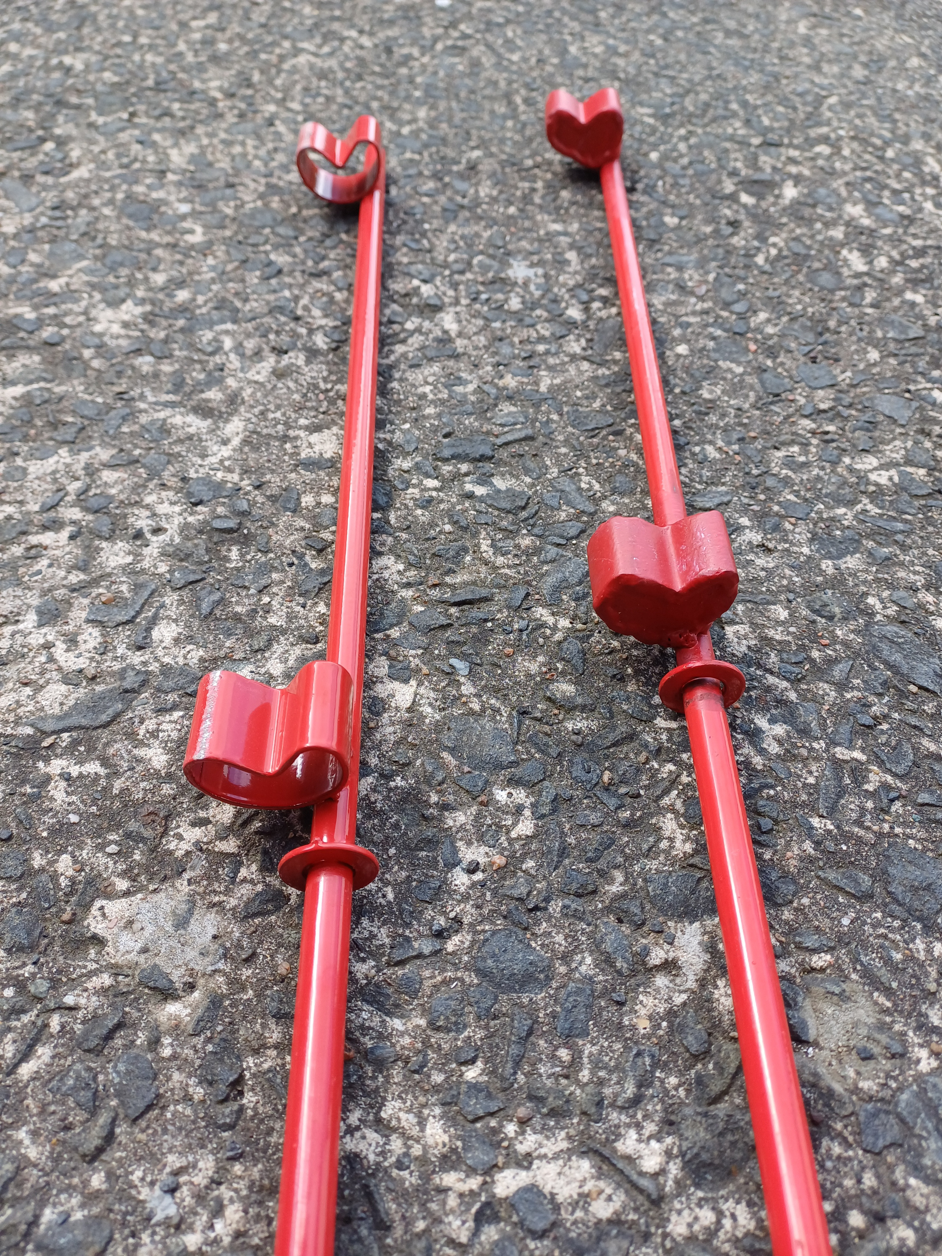

The mainstand dolly I bought a while back has sheared off the little feet used for the brake,so I got a mate to beef it up with weld. Not pretty,but fuctional.Should stick the pace now.
The place I bought the dolly from a couple of years ago sent me a replacement part free of charge,which I wasn't expecting. It'll do for a spare,but I'll probably never need it now.
The company is Louis Motorrad in Hamburg.
Awwww... they made them in little heart shapes.
You broke their heart!

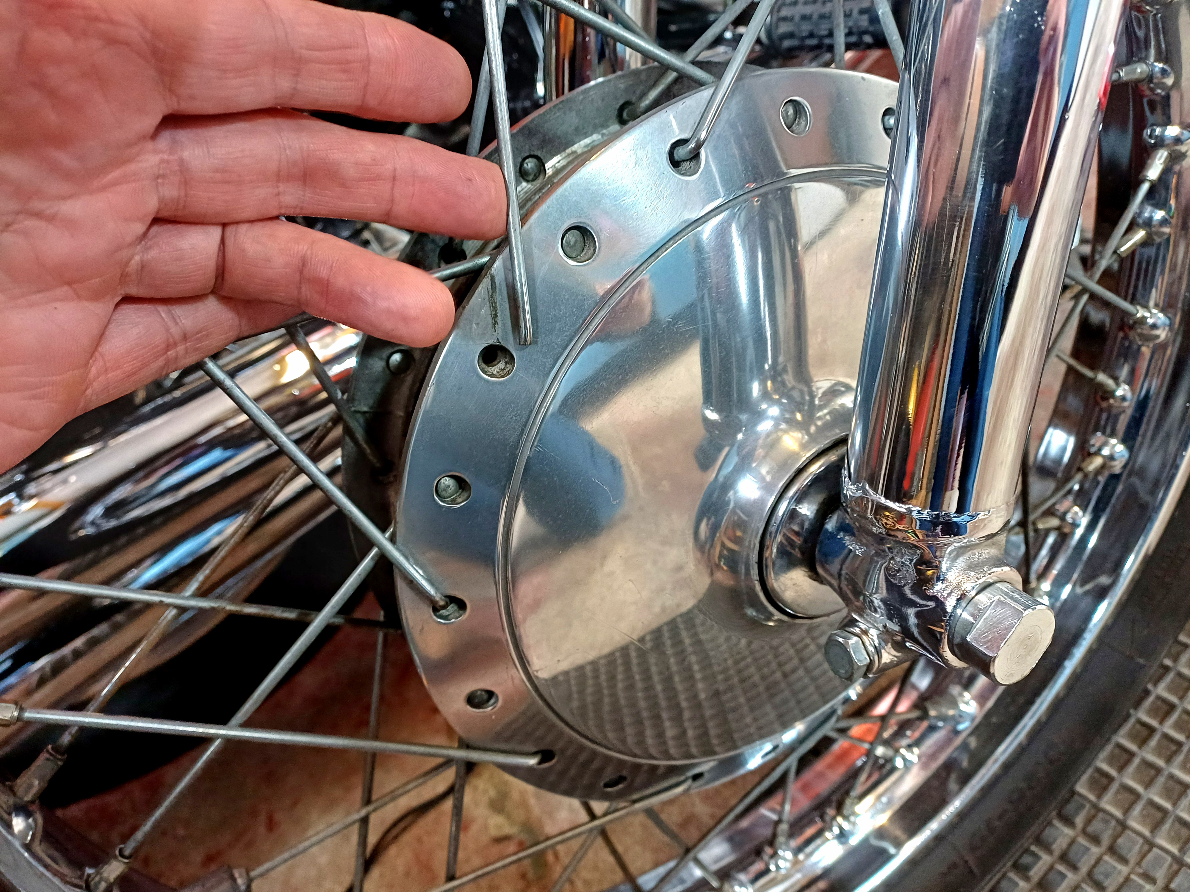

Don't listen to those who say cleaning time is wasted riding time.
Cleaning is maintenance. Fact.
The roads are shit. Fact.
