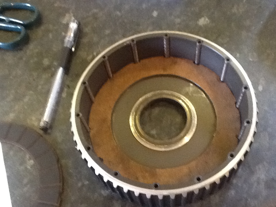

Cork mat glued to the back of the (Hayward belt drive) basket, so an extra plate could be squeezed in.
