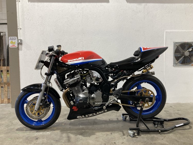

It means that we are now a two-Bandit family, or possibly even nearly three as I've got a spare frame with it amongst other bits, and already have two other Bandit engines in the garage,( albeit one will never even run again due to the fecking great big hole in the crankcases) but 8-) eh!
And here she is- arguably in far nicer nick than my No1 bike was when I first acquired it, I am sure you'll agree, particularly if you compare it with the pics on the first page of this thread.... :hmmm:

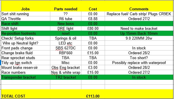

Anyway, this is the current list I've compiled, and as you may guess from the green shading , I've already completed some already.

Sprockets. I don't know your situation with gearing for each Track, but you'll find that the sprocket you need, and need now, is on the other bike. When running 2 Bikes I would have 2 sets in the sizes required.
Tyre warmers. Some do and some don't have warmers on wets. If you do...........plus extension leads to be able to run both.
Take a little bit more fuel to each meeting, if you've been on both Bikes over the weekend, when you get to the last race you'll find the fuel you need will be in the "other" Bike.

Nobby wrote: Sat Mar 01, 2025 4:16 am Sprockets. I don't know your situation with gearing for each Track, but you'll find that the sprocket you need, and need now, is on the other bike. When running 2 Bikes I would have 2 sets in the sizes required.
Cheers , and yep I'm on all that- I have 2 sets of sprockets so can have them both set up the same if I want- TBH with the Bandits, you can do pretty much all the circuits we go to on the same gearing, with just really Coombe and Snetterton (and depending on the day, possibly Pembrey ) needing something different.
As for warmers, I never use them on the Wets so I reckon I'm fine on that :thumbup:

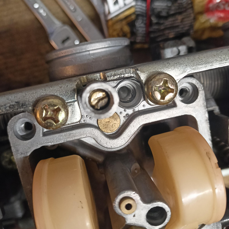

Carbs are also now off and on the bench, nice and clean on the face of it but have a couple of the pilot mixture screws have half their heads snapped off meaning it's not possible to get any purchase on them, and even after soaking they are seized absolutely solid, so I've ordered some titchy easy-outs, and of course new jets and pilots screws etc to sort that
The screws in question look to be backed a fair way out so It does at least partially explain the shit running, although I'm not yet convinced that's the whole cause, and although it's not a real biggie, it is disappointing that people just lie- he seemed genuine too :(
