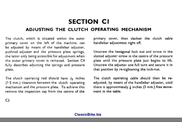

Re: Classic Triumph Bonneville
The clutch is definitely involved in starting on these bikes. The classic thing to do when starting is pull the lever and give it a couple of kicks, the second one is dead easy as the clutch comes unstuck and hence frees the kicker from the engine.
More importantly, my googling reveals that slipping clutches on start is a common problem
You just wait.
If the simple clutch adjustment doesn't work I'm gonna have to break into the primary casing! Fortunately there's a little spy hole (that one in front of the rear brake pedal) to allow clutch adjustment.

- Posts: 13954
- Has thanked: 2552 times
- Been thanked: 6257 times
Just tried that. Sorta helped, but not fixed it. I'm not sure if I'm actually screwing it all the way in though, I've loosened the nut as far as I dare (don't wont to lose it in the case!) but even then I'm not sure if the screw is contacting or I'm just picking up the lock nut again.
Also had some fuel vapour go bang in the exhaust. That was a) bloody loud and b) proof that it has fuel and sparks at least some of the time.
If you put it in 4th gear you can push it along the road (with difficulty) and the engine doesn't turn over. So the clutch is not gripping really. Further proof is that it is much more "positive" on the kicker with the plugs out and hence when it's easier to turn over. But even then its not perfect.
