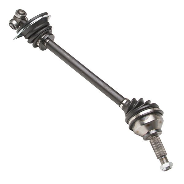

Well i'll find out in the next day.... or two... Dave the mechanic some of you will have seen, he's got the unit next to MArk at Ride in Bike Tyres in Reading... both have been there forever. lol.weeksy wrote: Tue May 24, 2022 1:34 pm If i can get that done and sorted for £200-300 then i'll happily keep the thing, it goes, stops, is comfortable etc.
Daves a proper old school boy and doesn't even take payment by card.... so things like fangled electronics are outside of his remit. But this sort of thing of spannering and pulling bits apart is right up his street. The suspicion based upon noise, discussion and internet wisdom is 'drive shaft'
They're £70 or so supplied. https://www.eurocarparts.com/search/654 ... 5IQAvD_BwE
But obviously need fitting and depends if it is that, just 1 or 2.... who knows.
Dave isn't known for things like speed of turnaround, or giving you a loaner to get you home (hence my cycling yesterday). But he's cheap and he's very honest, he'll do exactly what's needed, no more...

Re: Are vans better offroad than cars ?
I've changed them on a different car many years ago, I don't think it was a difficult job so hopefully won't cost a fortune.
If I read the dash in the earlier pic right it's done 75k miles. I think those half shafts have a limited life (think they were done a couple of times in nearly 200k on my previous car. I'd say (from the other issues and them ignoring the noise) that whoever had the car before you scrimped on the maintenance and probably missed some service interval stuff. Probably got it through the MoT and left it at that.
It's Catch 22 with cars like that, you chuck money at them so need to stick some miles on to recoup it...but you lose confidence in them and want rid (but probably won't get the money back on sale). I'd be on '3 strikes and out' with it. One more....
