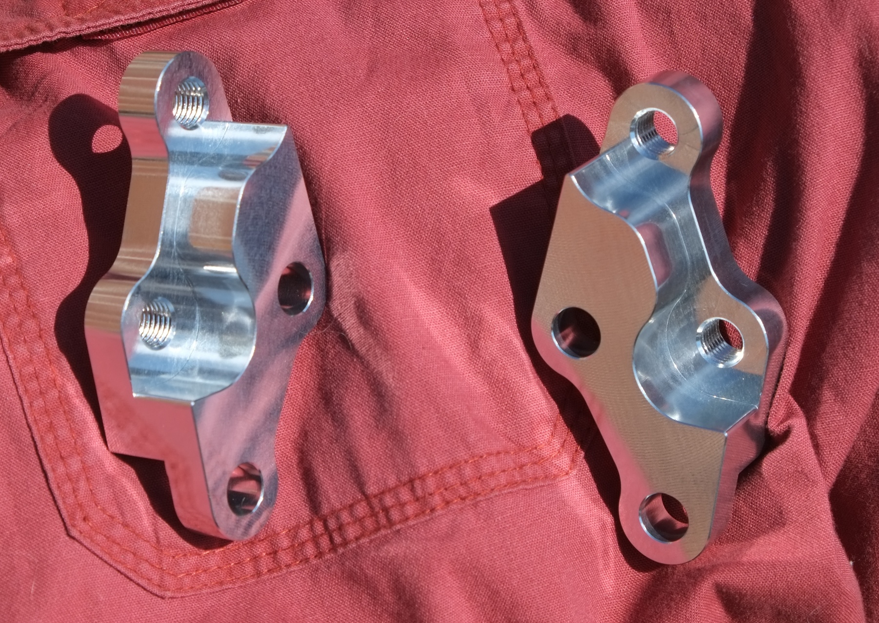

The stuff in question is a set of brake caliper adaptors. all the way from Webike in Japan. It all started when I was browsing a thread on the RDLC nutters forum regarding alternative calipers for LCs. As you may recall, I upgraded the brakes on the VFR earlier in the year, so that left the old calipers surplus to requirements. These are old (mid-1990s) Goldline Brembo 4 pot jobs, as fitted to early 916s. Not shabby, by any means.
I asked some questions on the forum and one of the peeps gave me a link to a set of adaptors. They looked absolutely bang on - made to fit 1980-82 350LC (well, OK RZ350 in the blurb) with 42.5 mm mounting centres and 4 pot Brembo Goldlines with 40mm mounting centres and single pad pin. Check. These are the calipers:
Price including 3 day courier shipping was a very reasonable £83.40 so I hit the buy button and a few days later these little puppies turned up:
Mmmmm, Shiny, shiny...
I can't actually fit the calipers and brackets to the bike yet, as I decided that I wanted stealth rather than gold bling and sent the dismantled calipers off to Powerhouse in Chesterfield for them to clean, refurbish and repaint in satin black (same as OE). The Brembo name and logo will have the paint removed in similar fashion to OE. Just in case you'd forgotten what an LC caliper looks like, here 'tis:

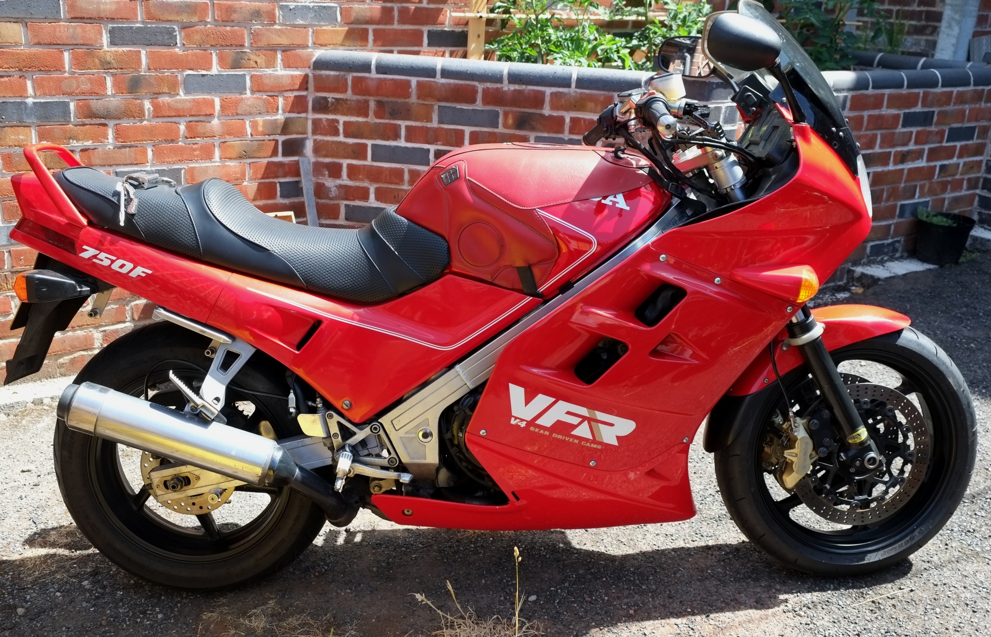

It's taken a while, and a lot of that time has been largely wasted, but the old VFR has its MoT and is back on the road. It was away at 'a man who can' for nearly 3 months and when I got it back it was apparent that nothing had really changed with the exhaust and all the old problems still remained. It's become apparent that when using Motad downpipes you can't mix and match with OE Honda stuff - you need to use Motad's own collector box. So at some point over the winter I'll get a custom collector box made up to my specifications in stainless. I'd use a Motad collector box if I could find one, but they are as rare as rocking horse sh1t.
Anyway, the 'new' calipers on their home-brewed brackets feel really good and strong even on the short run down to and back from the MoT station, so that's a plus. They should realistically be even better after the pads have bedded to the discs. For all my bike MoTs I use a scooter emporium within spitting distance of the Sheffield United footy ground called Armando's. They have some really nice vintage scoots from the 60s and he's very happy to MoT bikes. It's ideal because he has no interest in servicing bikes, so I know that it will be an unbiased, honest result.
Herewith a couple of pics of the old girl.
