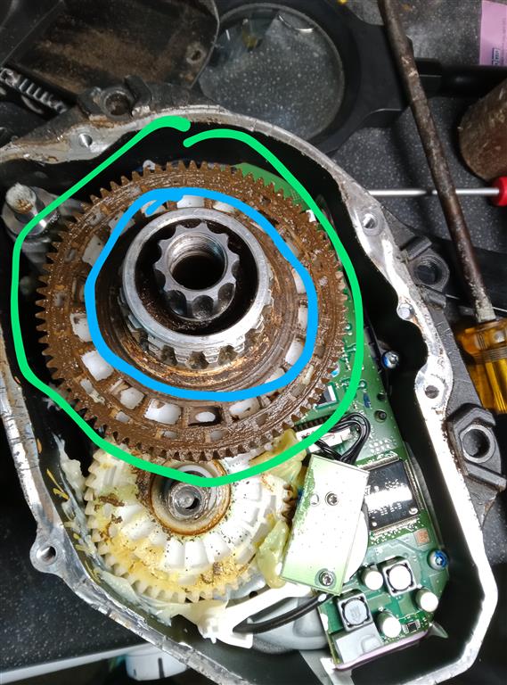

A few more photos but not much progress.
Got the cover off to find that the bearings circled yellow are seized. Knocking out the large bearing shouldn't be too hard but removing the gear and smaller bearing is likely to more difficult.

The blue circled bearing keeps the gear on the crank. From the videos I've seen, this gear should have come off with the cover in the photo above. The crank and gear turn by hand but it's clear the bearings are goosed. Getting it off could be tricky given the circuit boards...
