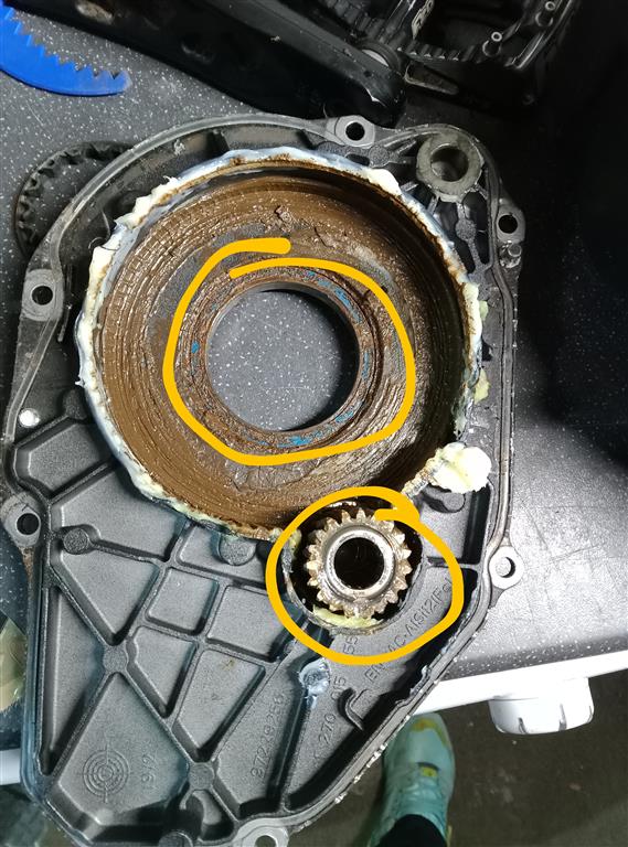

Going to try to. Seems that I might need to invest in a hydraulic bearing press and possibly a decent large bench vice.

Yeah, if I was using my bike regularly then I'd ask the shop mechanic to deal with it but given I ride infrequently it's (a) slightly harder to justify the expense and (b) I have the time as well as a mate with a hydraulic press. I also do feel the motor is so far beyond repair that I'm unlikely to make matters worse (famous last words).
To be fair to my bike, it gets abused. Ridden infrequently, chucked in the back of the car after the ride and if lucky it gets washed when I get home but more often than not it won't be washed for a few days which by then the sandy water has done its damage.

A few more photos but not much progress.
Got the cover off to find that the bearings circled yellow are seized. Knocking out the large bearing shouldn't be too hard but removing the gear and smaller bearing is likely to more difficult.

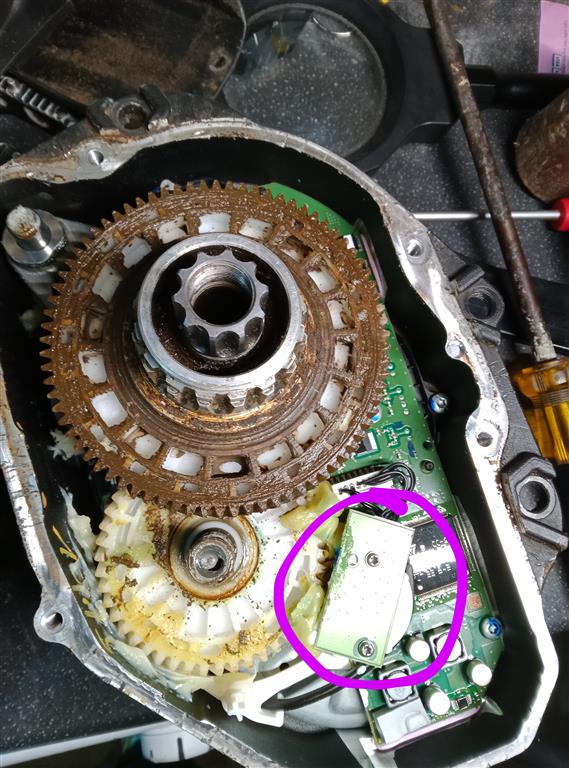

The blue circled bearing keeps the gear on the crank. From the videos I've seen, this gear should have come off with the cover in the photo above. The crank and gear turn by hand but it's clear the bearings are goosed. Getting it off could be tricky given the circuit boards...

As I understand it, the actual gear driven by the motor is located beneath the circuit boards circled purple. Haven't been able to check that yet.
