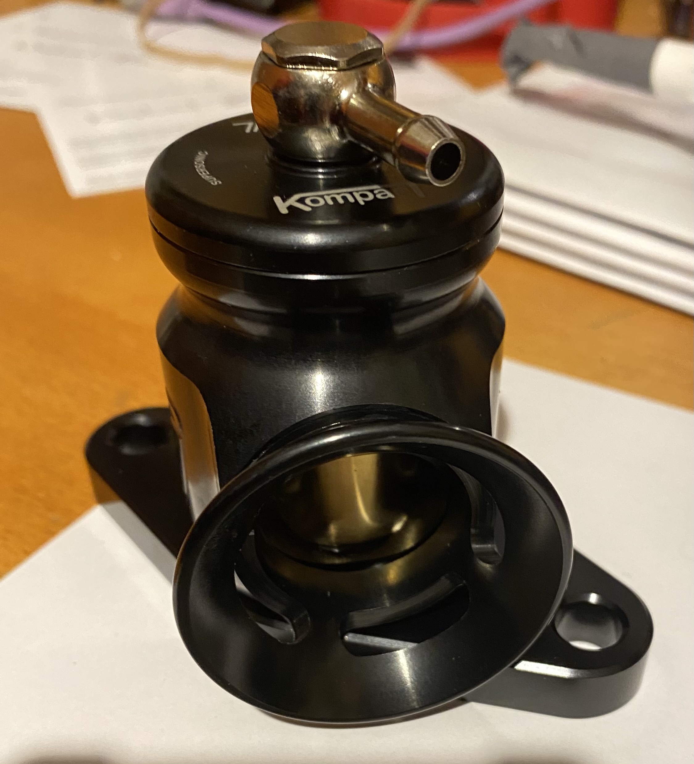

Wooosh
And H M R C didn’t sting me for import either !!!

Re: Shiny new bike day
It is, still has to dump the excess boost. This is basically a billet and vent to air rather than recirculate version of the stock one.
Makes sense, not sure why I thought the SC was different to a tubby, they both do the same thing, just different methods.
The BOV might get rid of the cool chirrup sound though. That sound is the compressor stalling, meaning its trying to boost but the 'downstream' side pressure is too high and it can't boost any more.
We shall have to see what tunes the engine plays with the valve fitted!
Valve that goes "WHOOOOOOSH" fitted. Supercharger still chirrups, happy days.
