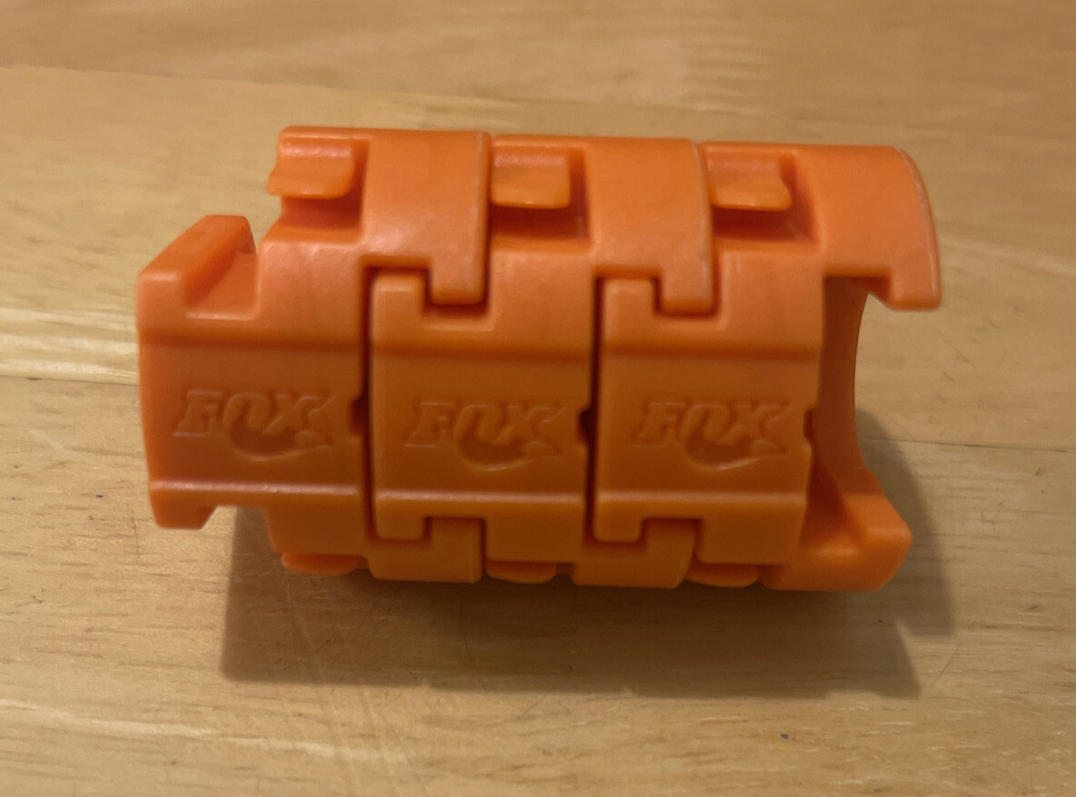

i’m thinking of whipping the shock out this week and throwing in a volume spacer or two. It’s running a Fox DPX2 which i’m happy with, but even at 225psi i’m getting to the bottom of the travel on many many times in a ride, so would like to be able to keep the pressure around/less than that and get a bit less through the travel at times.
edit.
Vol spacer installed and set to 210psi this time...
edit.

Still getting the FuelEX to my 'nice' sort of feeling... it's not far off but i would ideally like a little less air in the front end. So just picked up some volume spacers which should help there.

Re: NBD. The "didn't you have one of these?" Trek Fuel ex9.8
Contrary to popular belief... You want less spacers in the fork ideally, not more... Run less sag with less spacers up front, and fine tune with a little compression damping to stop the fork blowing through its travel.weeksy wrote: Tue Oct 31, 2023 1:39 pm Still getting the FuelEX to my 'nice' sort of feeling... it's not far off but i would ideally like a little less air in the front end. So just picked up some volume spacers which should help there.
Air forks have a naturally increasing spring rate as they go through their travel anyway, increasing this by artificially reducing the spring volume chamber normally just results in an overly active fork in the top half of its travel and an overly harsh one in the bottom half...
I found best setup on a 150mm Fox 36 with GRIP2 damper to be 1 volume spacer and around 20% sag, with a little low and high speed compression added to assist bottom out resistance. Even 2 volume spacers (which increased the compression ratio from 1.9 to 2.3 as measured with a shockwiz) made it feel too progressive... I had a go on a mates with 5 in once @ 150mm travel. He was running 35% sag (so giving up all his useful travel, not to mention about 1deg of head angle too) but still couldn't access the last 30mm of travel!
If you want the best of both worlds... Plush off the top, controlled bottom out resistance and oodles of mid stroke support, then get one of these...
https://www.pinkbike.com/news/review-di ... idge2.html
Absolute game changer for me... I now have mid stroke support I could only dream of previously, along with super supple off the top feeling and perfectly controllable bottom out resistance.
I have a fair bit more vested time effort and knowledge in this than most, but suffice to say I've had long conversations about this topic with the people who know a lot more than I do, those who actually design top notch suspension as well as those that service and maintain them too...weeksy wrote: Tue Oct 31, 2023 3:01 pm Interesting... I'm not convinced i agree i'm afraid... but deffo interesting.
"Tokens" are a cheap and easy way for the end user to "tune" their suspension... Put it this way, motorbike tuners might suggest you add 5ml of oil to a fork leg to make a drastic change to bottom out resistance, yet you're adding several 10ml volume spacers into a much smaller chamber on your MTB fork!
They exist to make the fork feel more "plush" off the top on the shop floor... At the detriment of actual control and performance on the trail... All because most forks have an overly sticky or ineffective negative air spring.
I know Chris Porter pretty well professionally these days... Top bloke! His knowledge on suspension is second to none, but also a really nice genuine guy too. Anyway... His story about when Fox came to him to help develop their volume spacer system in response to Rockshox having released tokens... He said he knew the writing was on the wall for their relationship when it became all about marketing rather than actual performance! Needless to say, first thing Chris does when setting anybody's Fox/Rockshox fork up is remove ALL the volume spacers and then set the sag... If the desired bottom out can't be achieved with zero spacers, even with adjustable compression damping and/or adjustments to the oil and shim stack, he will begrudgingly add a single spacer.
The Diaz Runt I listed to above is basically pretty much what Ohlins and Manitou have been doing for years (and ironically, Marzocchi back in the early 2000's) with a dual positive pressure chamber that equalises part way through the travel. It was a major design feature on the EXT Storia fork that CP helped develop too...

Being slightly bigger that the Scousemeister, I sometimes find myself on the limits of air suspension effectivity. I always care open the forks , remove the tokens and set up the sag. And if that kind of works then I am okay. I have never understood why reducing the effective volume (hence making the fork more progressive at the end) is ideal. I can see that as bikes manufacturers are looking at riders of 75kg as the norm, that if you are much lighter then maybe tokens are the way to go.
Oddly , despite being a bit bigger than the norm, with no tokens in and 25% front sag, it is still very rare to use all the travel. I general run with no compression and relatively slow rebound.
On the back end , I know the CC in my Cotic has no volume reducers , no compression, runs at the right sag , has been to TF Tuned, and still I probably only get 60% of the travel. But Cotics are meant to be progressive rear suspension.
The Trek and 161 have similar rear suspension set ups ( and shocks) - both are much more plush and move through their whole travel so seem much more planted at times. I have no idea if the have volume reducers or not. The eeb runs at about 25-30 psi higher on the rear than the non-eeb
@Mr Moofo progression from the linkage is FAR more preferable than creating progression in the shock. Geometron G1 is designed with approx 33% progression for instance, meaning it can run a coil shock natively for best results. Most mainstream bikes have less than 20% progression these days, but to be fair, that is still a lot better than where we were 20yrs ago where many full suspension bikes had a regressive suspension curve to help deal with the teeny tiny air shocks that they mostly used to run back then.
The other benefit to getting rid of volume spacers/tokens and running less sag, is you're not giving away all your ride height, your fork is staying further up in the travel, precisely where you want it to be. I want to give away the absolute minimum of available travel in negative travel (without it topping out harshly), I have paid for my 160mm of travel, I want to bloody use as much of it as possible, not give 60mm of it away in sag as many people do...
This isn't at all odd... It's how it should be. Those of us who've eaten a few too many pies have the added advantage that our weight helps minimise the effects of the negative air springs on modern forks, the "problem" that tokens are trying to overcome for smaller/lighter riders in general. Anyone who's ever ridden a fork with a coil negative spring (even with air positive) will know how ridiculously pointless the whole exercise is, other than being able to market next years fork that has a "bigger/better negative air chamber for reduced stiction"... Get rid of it altogether FFS! Job done...Mr Moofo wrote: Tue Oct 31, 2023 3:45 pm Oddly , despite being a bit bigger than the norm, with no tokens in and 25% front sag, it is still very rare to use all the travel. I general run with no compression and relatively slow rebound.
