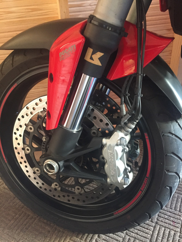

She was, i got her in with them quickly because of a short time to sort an issue before another tripCount Steer wrote: Wed Jun 14, 2023 8:37 pm I think Trinity was introduced to the Jordan enterprise over a suspension issue before.![]()
Sarah knows you now @Trinity765 ....if you need something done quick give her a bell
Once you have it sorted have a look at these as i had issues on the Multi with a couple of seals going within not a lot of miles so fitted some seal protectors and havent had an issue in over 40000 miles since between the 2 bikes. designed for offroad bikes but work really well on the Multi
