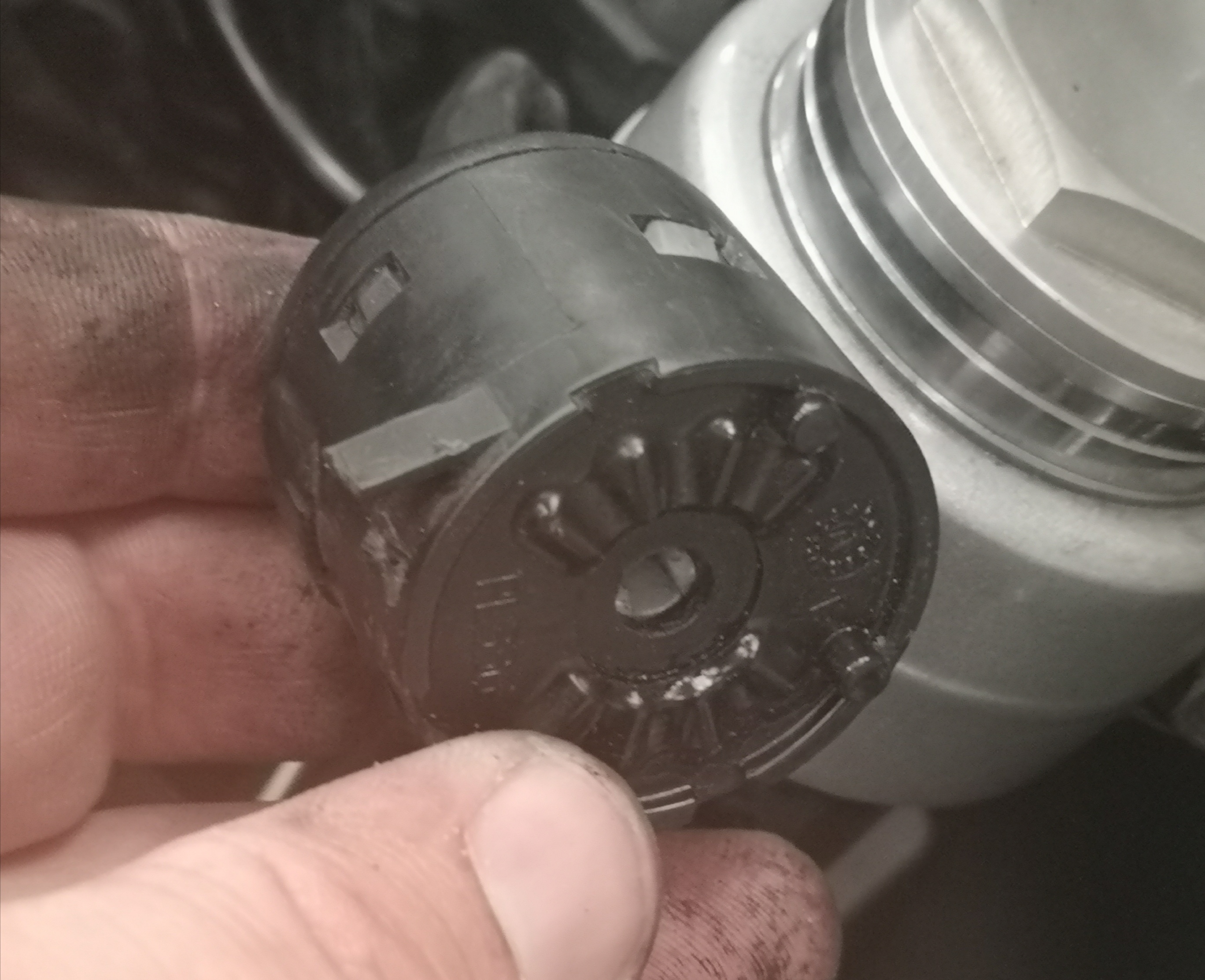

Any suggestions on how to start the engine?
The ignition barrel is goosed, key doesn't fit and there is a strange cylinder dangling loose which I assume is part of the ignition circuit...

Beancounter wrote: Thu Aug 04, 2022 6:01 pm Any suggestions on how to start the engine?
Screwdriver in the centre slot of the dangly bit and you should be able to click it round into its on and start position, reverse to switch it of.
That’s shit mate, sorry you’ve been targeted

Gregor wrote: Fri Aug 05, 2022 12:15 pm
I’m wondering how the actual fuck do the thieves get bikes running when the ignition should be disabled without the key with the immobiliser chip present. Surely it’s not as easy as ramming a screwdriver in the lock.
Look on ebay or facebook marketplace, you can buy immobiliser bypass boxes for about £30.

Sorry Gregor, missed your post initially. Appears to have been as easy as that - screwdriver in the ignition and off they went. The ignition barrel is so mullered now that it doesn't turn at all. Not that that matters given they removed the actual switch from the barrel to make it easier to start.
The cylinder is the switch...small screwdriver will turn it on.

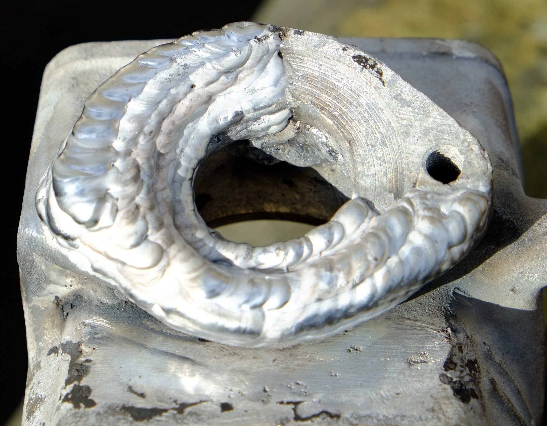

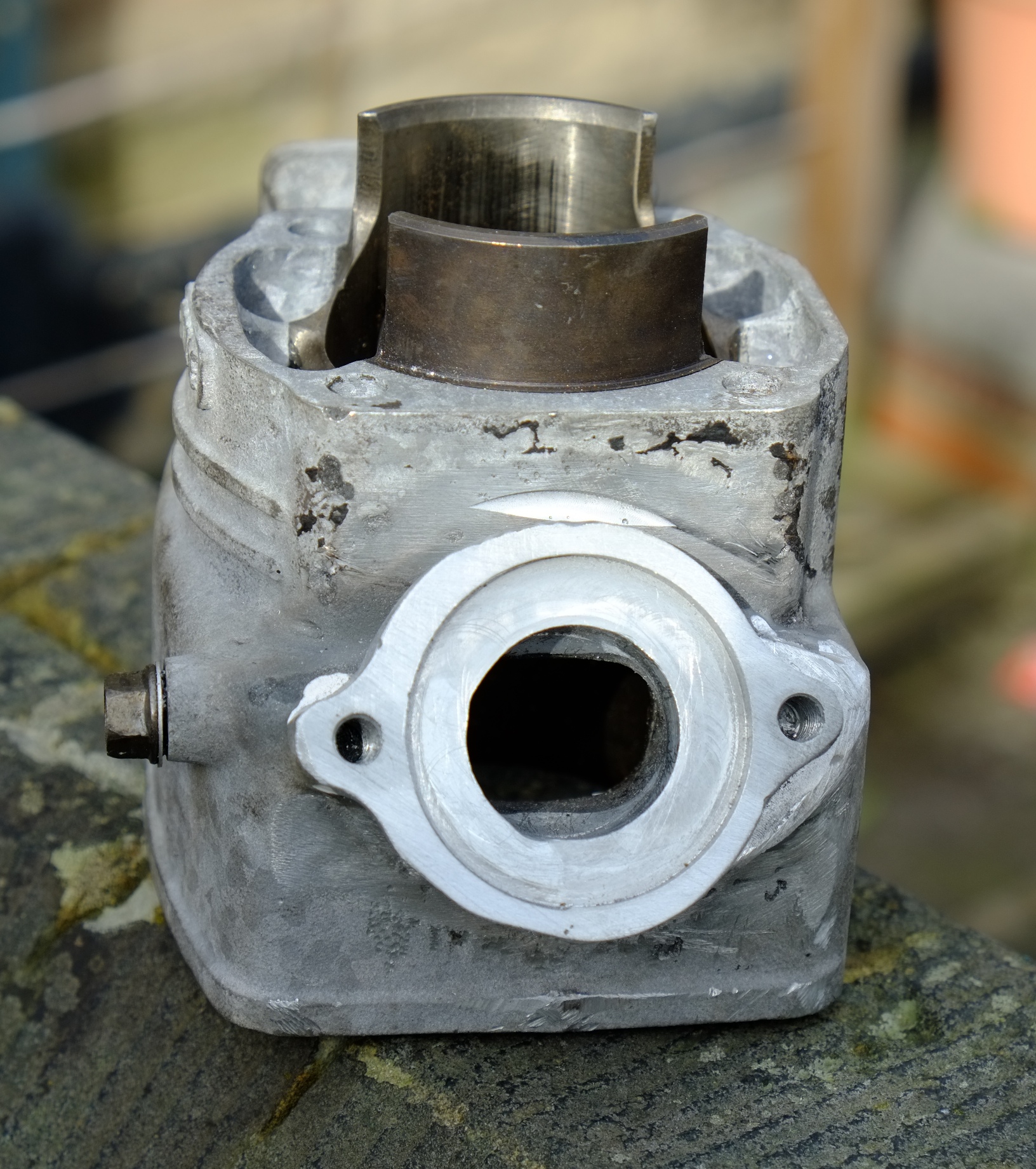

I've come late to this, but getting the broken part of the frame built up with ali weld, then grind back to an approximate shape, then drill and tap for footrest mounts seems favourite. This is what my tame local welders did for me on a 350LC cylinder that had half of the exhaust flange broken away:
What the barrel looked like before:
After being ground back and built up with weld:
And after machining:
So it's definitely doable, you just need to find someone who is capable of doing it (and the subsequent machining)

mangocrazy wrote: Wed Jan 11, 2023 4:12 pm I've come late to this, but getting the broken part of the frame built up with ali weld, then grind back to an approximate shape, then drill and tap for footrest mounts seems favourite. This is what my tame local welders did for me on a 350LC cylinder that had half of the exhaust flange broken away:
Thanks, that gives me some hope the problem is not insurmountable. :)

From what I gathered from 'my' welders, half the job is getting lots of heat into the cast ali. Aluminium is very efficient at moving heat away, so you really need to soak the part with heat before welding. I've walked into their place and seen a large butane torch directed at some heavy duty ali they need to weld and they won't start welding until the piece is uniformly up to temperature.
