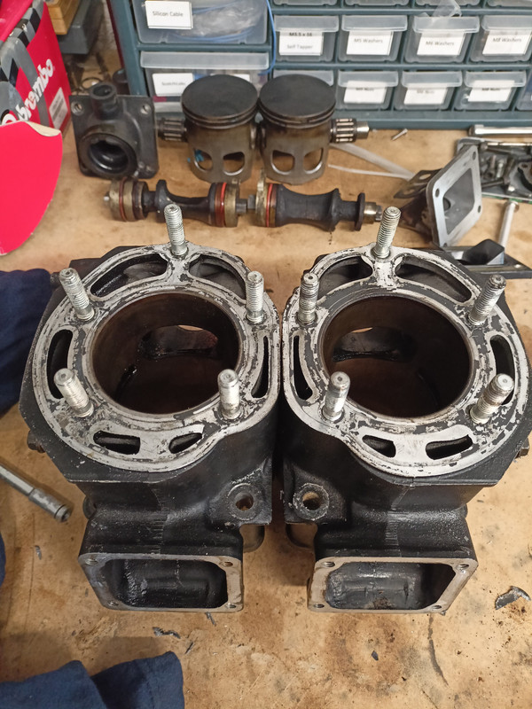

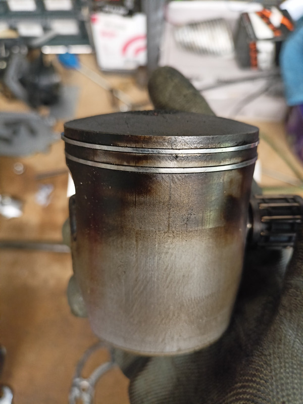

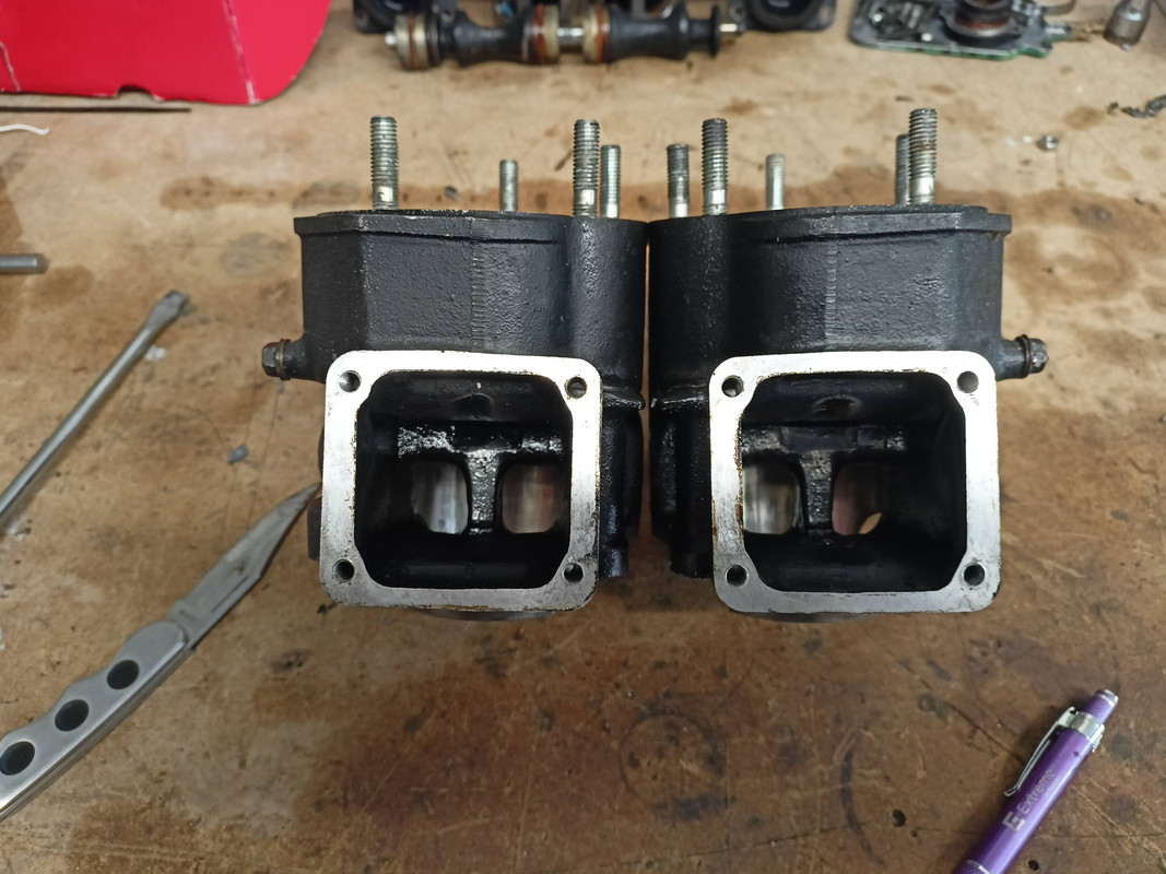

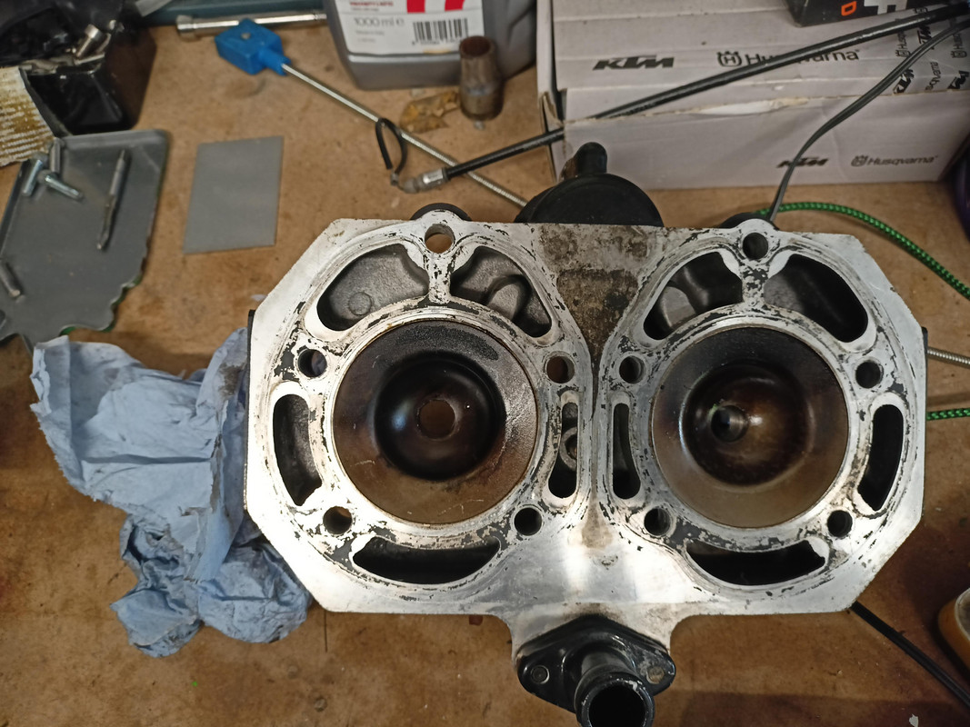

Working on these old bikes is so good, no faffy fairings or unnecessary / unusual clips or fasteners, just standard tools and they are in pieces in no time- life was so much simpler back then, I love it!
Anyway, the LC motor is now is pieces-you can of course usually never really be completely 100% certain with something of this age, but now I’ve got it apart, I’m now as sure as I can be that this is the first time this motor has been in pieces since it left the factory- well, the top end of it anyway, which is as far as I’ve gone, and TBH as far as intend to go with the engine strip now.
All of the fasteners are the originals, they didn’t look or feel like they’d been moved before, and it’s on standard bore with genuine Yam pistons, and everything thing else as far as I can see.
And it’s all good news - no signs of any detonation or any previous blowups in the head

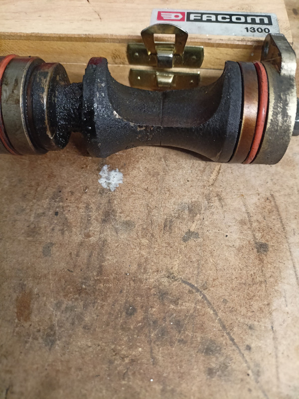

There is a fair bit of carbon build up on the PVs and pistons, but everything was still moving freely, there were no leaks from the PVs and their bearings feel lovely, so they will get a good clean up and some new seals purely because of age, and will be good to go straight back in.

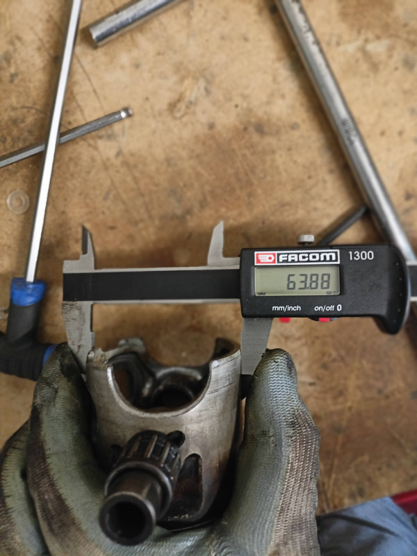

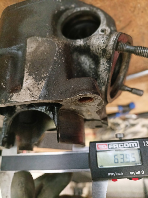

The bores are excellent, with no visible or measurable wear or damage, so I’ve dropped the barrels into my local vapour blasting man this afternoon, and when they're back they will get a new coat of paint and reassembled.
It was particularly pleasing to see that the reason that it is down on power and a bit flat is simply due to carbon/ gunge build-up;- the rings on both pistons are completely gummed into the grooves on the exhaust port side, and haven’t been sealing properly for a while I would guess, I knew it was down on compression, but of course, until you have it in pieces, you can never be completely sure of the reason
Whilst the pistons look to be in reasonable nick and I am sure I could likely get away with just giving them a good clean up and a new set of rings, they are almost certainly at least 37 years old and have done approx 15k miles, which is a lot for pistons in a smoker so they will be replaced, along with of course small end bearings and gudgeon pins etc

The head is a lot better than mine.
I think I'd stick with the Yamaha pistons and fit new rings to them, the quality of all of the pattern pistons available is a bit dubious, I've bought Mitaka ones for mine, about £100 for a pair of piston kits, but I'd rather have the original Yamaha ones.
The Athena gasket kits are good quality.

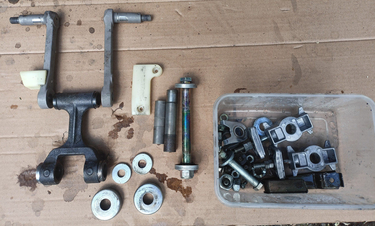

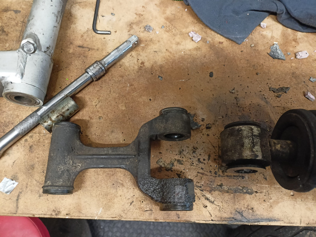

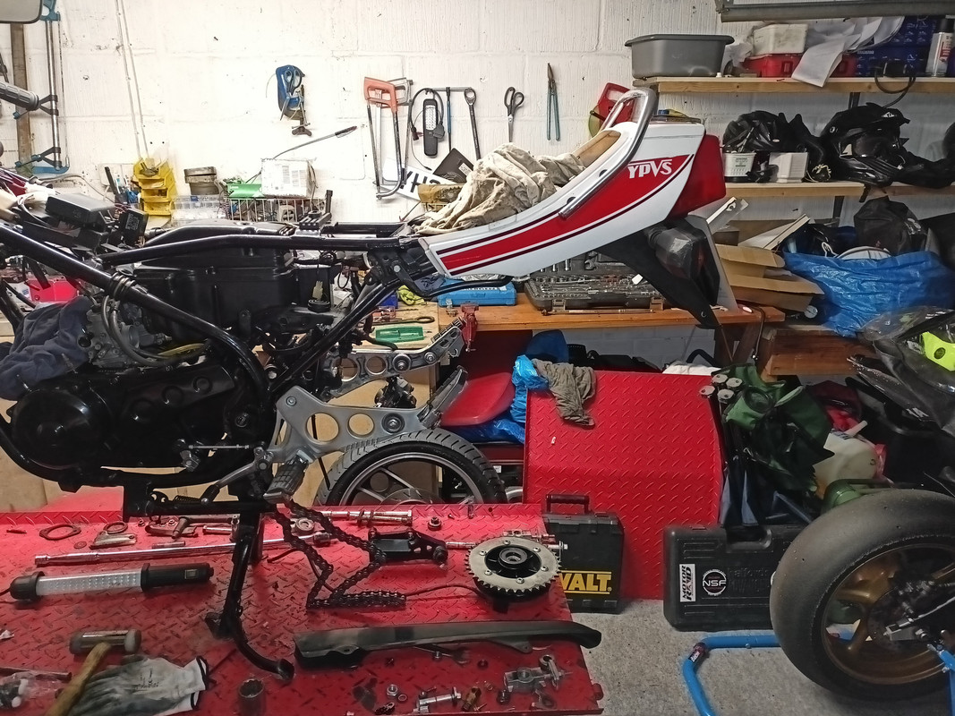

A bit more progress on the LC yesterday, and this is how it’s currently looking
The disassembly process, as with the engine top-end was very pleasurable- everything easy to get to, no seized, bodged or non-standard fasteners, and all came apart lovely and easily- not something you can ever rely on with swing-arm spindles and shock linkages, etc on a bike of this age, but no problems at all here.
The linkage and dogbones are a bit grotty, but nothing that a soft wire brush in the parts washer won’t sort- all the bushes, bearings, and spindles still contained some grease, and are in really decent nick considering the age with no discernable play, roughness or corrosion to speak of so they will get a decent spruce up and "we go again", as all the cheesy footballers say

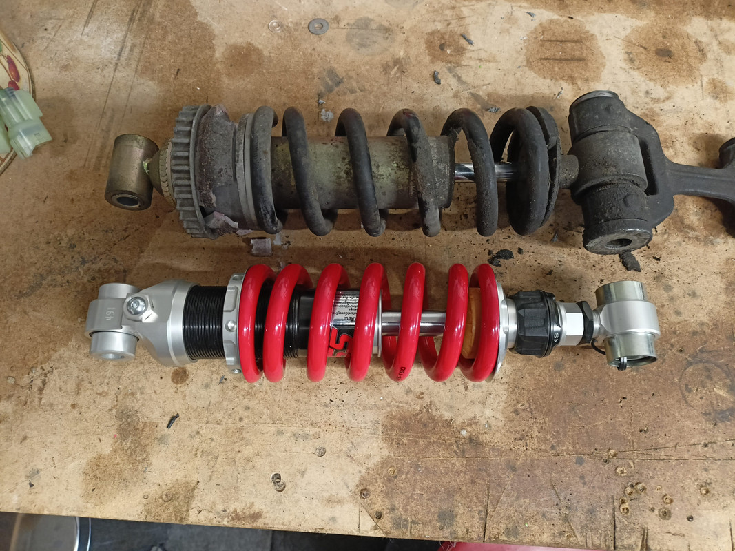

The original shock wasn’t too bad either- yes it's grubby but no oil leaks and even the little rubber belt that adjusts the preload is in decent nick- not that it really matters as of course, it will be redundant with the new YSS shock.

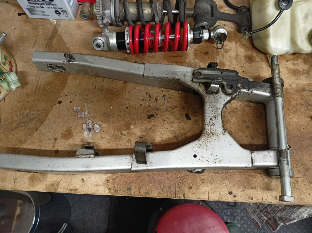

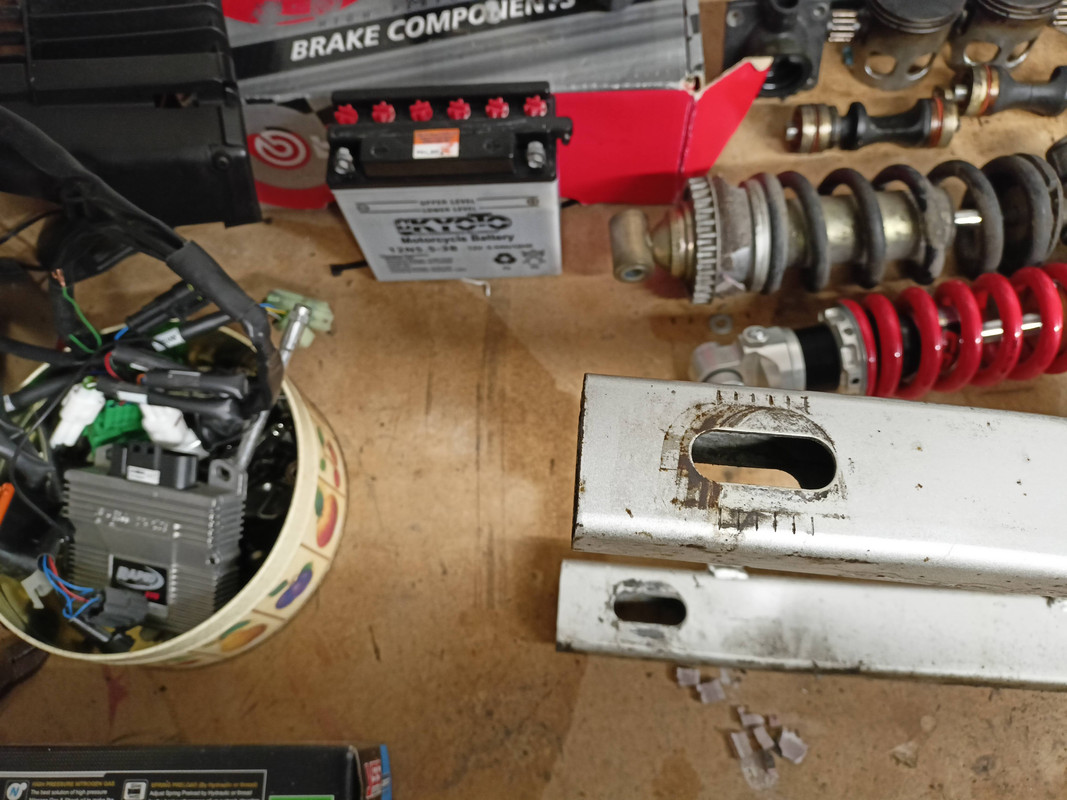

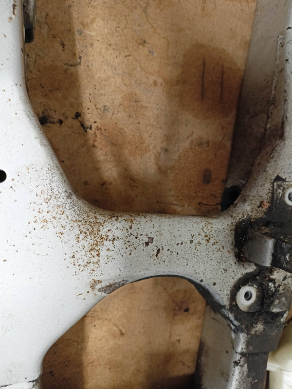

As for the swinging arm itself, the corrosion doesn’t look to be any worse than I imagined, so it will get a rub down, or maybe blasted, and I’ll give it a rattle can job, as a first pass at least, and will see where that leaves us.

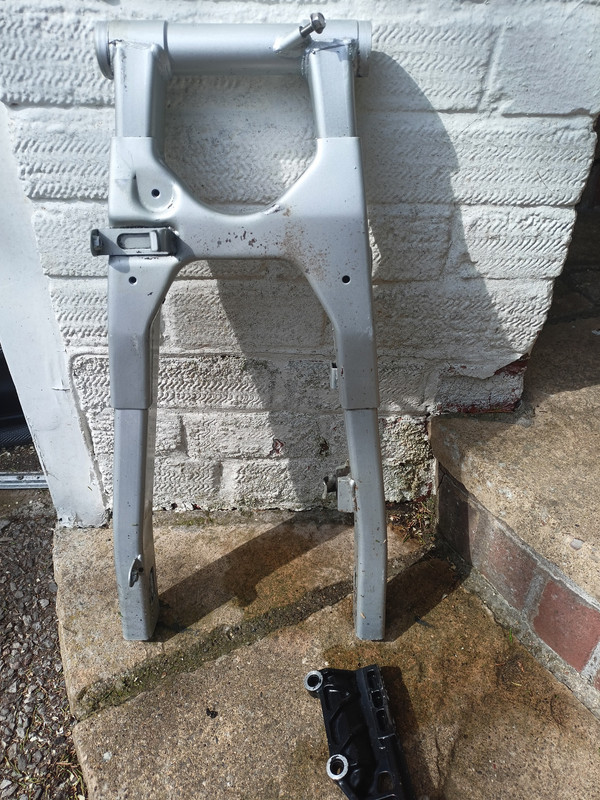

Little bit of an update- I haven't got the barrels back yet, but having said that the new pistons and gaskets, etc haven't arrived so it's not really holding me up , but in readiness for it all going back together I've done a little bit of cleaning - the head came up lovely with just degreaser and a green Scotch-Brite pad- the paint on it is original and save for a few chips, pretty much as good as new so it's ready to go back on
The suspension linkages came up lovely too, again with nothing more than a green pad and degreaser.
The swing-arm is nice and clean now and my Yambits order arrived on Friday with the right colour silver paint, so if I get a chance later today I'll get the wet and dry out and getit prepped ready for paint

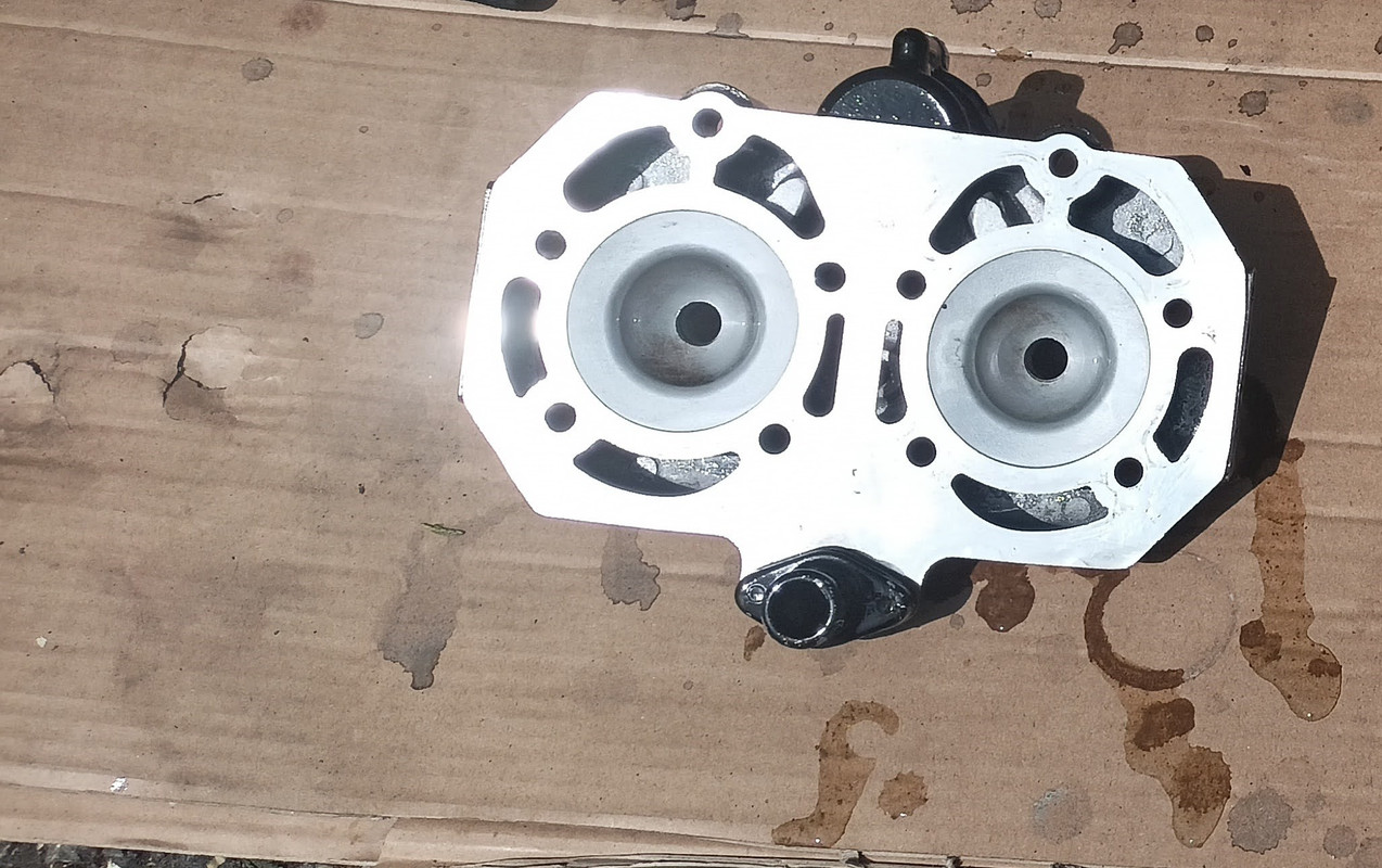

Re: RD350N1 Mild Restoration / Build Thread
That head is superb, I don't know if I've ever seen a used YPVS head as nice as that, all the ones I remember seeing had evidence of mild detonation.
