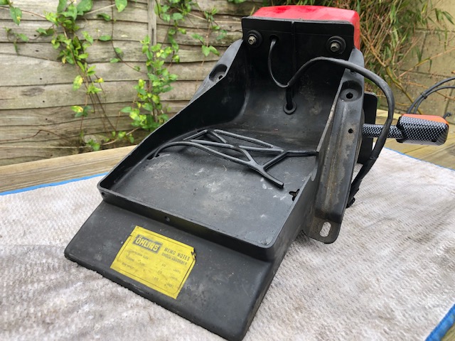

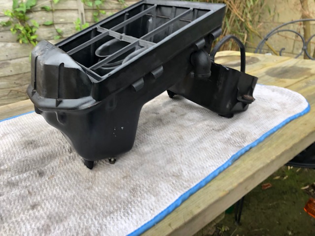

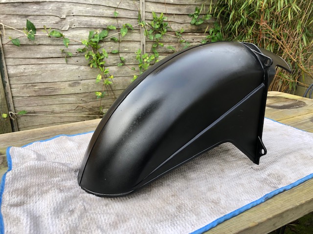

Cleaning time whilst I wait for the frame to come back from powder coating.
Posts: 26930
Re: Ducati 900ss Light Resto/Fix Up
Google Trim Gel. It'll bring the black bits up a treat..
https://www.cleanyourcar.co.uk/chemical ... k-trim-gel
Little round yellow applicator sponges work best.
https://www.cleanyourcar.co.uk/foam-wax-applicator

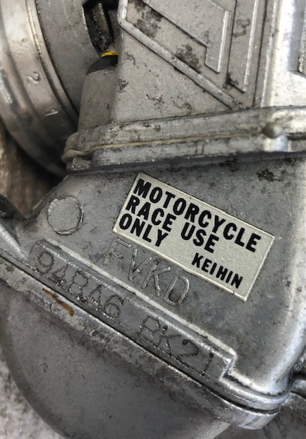

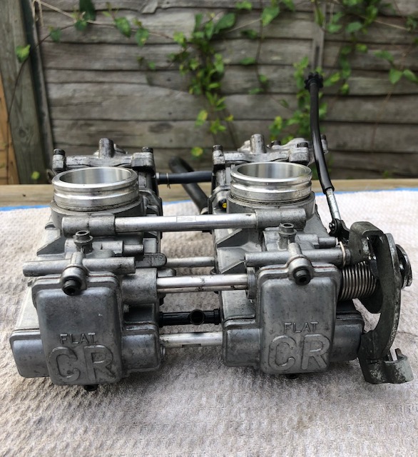

Some Japanese loveliness
FCR sticker.jpg (98.99 KiB) Viewed 1041 times

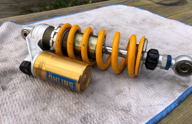

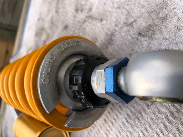

Some Swedish loveliness
Ohlins close up.jpg (80.05 KiB) Viewed 1040 times

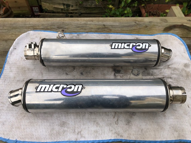

Post by IanB »

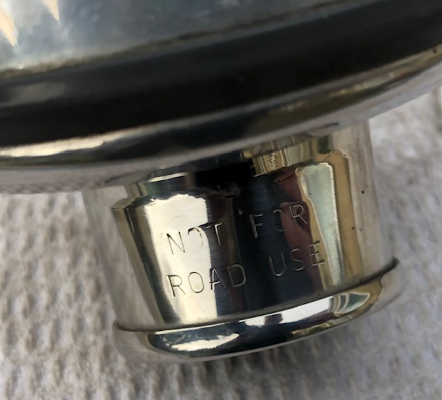

These will do until I can locate some high level Termi or Silmoto pipes
Small print.jpg (65.86 KiB) Viewed 1037 times
Posts: 26930
Noisy!!!
Post by IanB »
weeksy wrote: Sat Jan 29, 2022 12:26 pm And I'm not going to mention the £12.99 M&P indicators because I KNOW they're not staying.
Are they?
They will definitely join the box of stuff to be distance tested !
