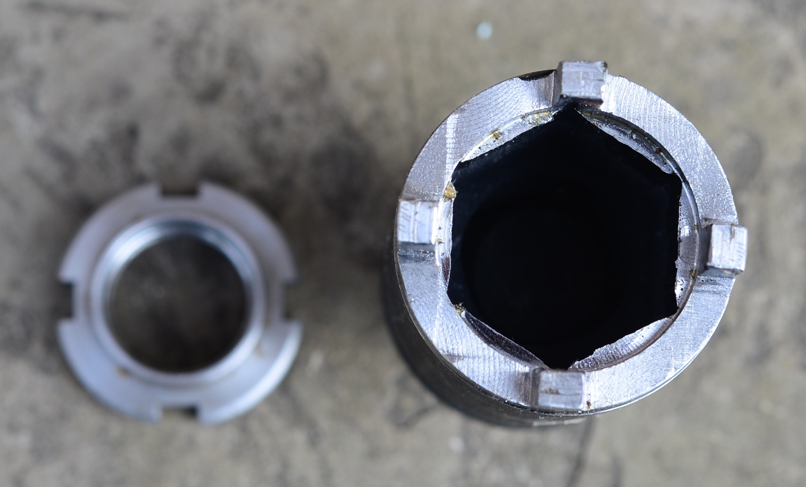

As an aside, I had to get a local engineering firm to machine a 26mm impact socket down to make a special tool to remove a ring nut/castellated nut from the gearbox shafts of my Lancia Beta.
Cost? £50 plus the cost of the impact socket (about a tenner). And that is a genuine one-off. Any kind of low volume production would reduce unit cost dramatically.

I have a homemade one something like that for the swingarm nut.
It isn't green though,so no one gets to see it. :(
