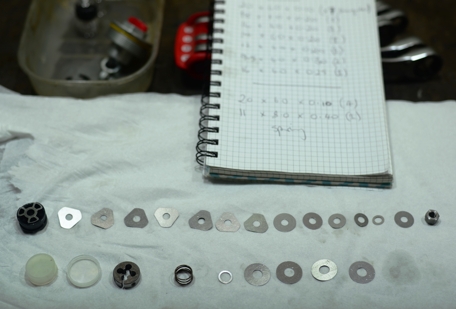

I finally plucked up the courage to attack the staked end of the compression stack with an Aldi Dremel clone fitted with a diamond burr. This allowed me to remove enough of the staked material to permit removal of the end nut. Once I'd removed that I was able to measure the thread pitch, which came out at a scarcely believable M6 x 0.5. I've encountered M6 x 0.75 before, but never M6 x 0.5. That is a ridiculously fine thread.
Anyway, I was then able to measure the shim stack and relay the results to a suspension guru I know. To reduce the harshness of the high speed compression damping he suggested that I remove the shim closest to the shims around which the shim stack deflects to see if that improves matters, although his view was that the piston itself may well be the problem, not flowing a large enough volume of oil.
Anyway, it's something to try (along with increasing the air gap), so it wasn't a totally wasted exercise.

So while I had the forks off the bike and drained of oil, I thought I might as well see what the rebound (RH leg) shim stack looked like, if only for reference purposes. This time the staking on the rod was only done in a half-hearted manner and the nut came off with only a small amount of resistance. I cleaned it up with the die, in the same way I did the rod on the compression side. I spread all the components out on a piece of clean towel on the bench and measured everything up. What was noticeable was that the shims closest to the piston were what I would best describe as triangular. I guess this was done to reduce obstruction through the return side of the piston as much as possible. Any way here's a picture of a shim stack, if that floats your boat...

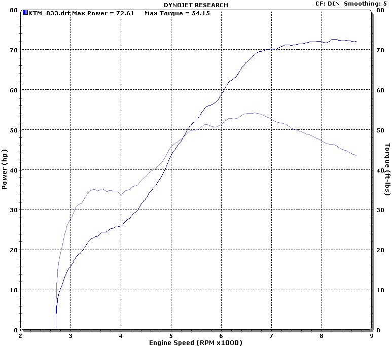

A bit more detail on the 690 Duke (R). It's a 2017 model (the last of the line of the R models) with the latest, twin balance shaft, engine. It's Euro 4 and the slow speed fuelling has always been snatchy when running in the closed loop part of the map. To meet emissions targets it has to run impossibly lean in the closed loop, leading to rideability problems. Euro 4 compliance hits big singles the hardest, which I suspect is one of the reasons why KTM have called time on the Duke 690 range (the engine lives on in the SMCR , Enduro and Husky bikes).
Back in November 2019 I took the bike to Andy at BSD Performance to try and fix the low speed fuelling issues. The dodgy-by-design fuelling was compounded by the rather aggressive nature of the fly-by-wire throttle, which gives an instant reponse to the throttle in all gears, including the lower ones. On one of my favourite roads, which has a lot of hairpins and 2nd and 3rd gear corners, a combination of the above meant it was difficult to maintain smooth progress. In the higher gears it was great, instant grunt, but it was all a bit too much in the low gears.
Unfortunatelly Andy found that all the maps on the bike were write-protected. He could read the maps but not alter them, so all he could do was disable a couple of sensors. However a year later when I contacted him, he told me that he now had software that could defeat the write protection, giiving him modify access to all maps. So not only was he able to correct the low speed closed-loop fuelling, he could also modify the throttle behaviour in the lower gears, making the initial response softer and more gradual. Full gas in all gears was still available at WOT but the 'slope' of the response was gentler initially, ramping up the more the throttle was opened. He also managed to find a couple of extra horses lurking at the top end, bless him... :)
Here's the dyno trace. 72.61 bhp at the rear wheel is not shabby for a 690cc single. What it does show is that there's precious little to be gained by hanging on after 7000rpm. Best to change up at 7k and use the fat part of the torque/power curves.
