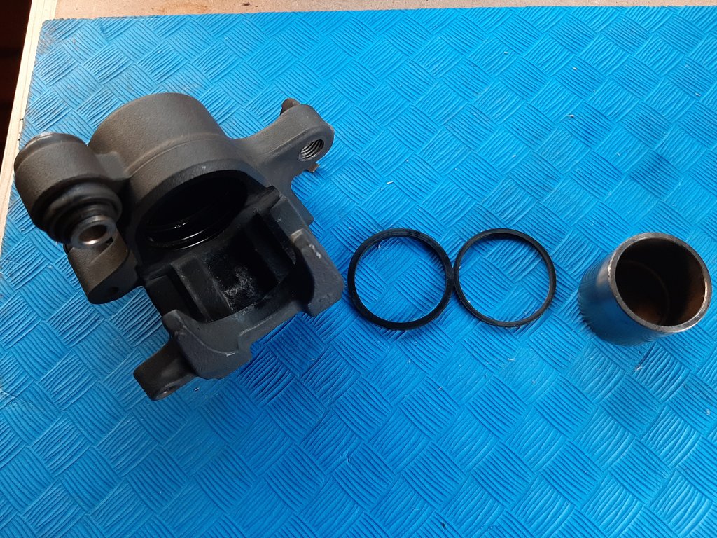

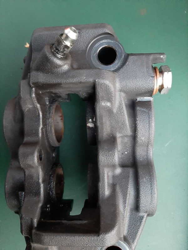

Managed to find an hour today to drain and then pull the front calipers. It was nice to find some SBS sintered street pads with a good amount of material left on them.
Calipers were a bit grotty but the pistons have cleaned up better than I thought they would with a good brush over with brake cleaner and now look like they wont need replacing.
Still going to pop all of them out to inspect the seals and hopefully wont find any nasty surprises

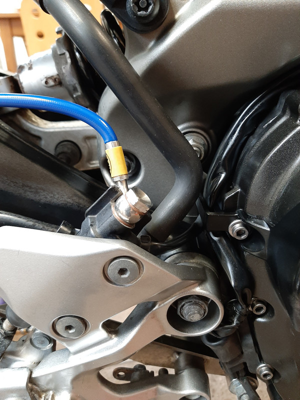

The postman dropped off the last piece of the rear brake parts for the Mt09 I've been waiting on so with a couple of hours spare I put it to good use and assembled everything.
Everytime I looked at the rear brake hose where it was connected at the cylinder, it bugged me that it was always under tension and looked like if left as it was would eventually fail.
I thought it was just fitted incorrectly but when removed it turns out that was the only way it actually fitted without fowling anything. It may have fitted if one of the banjo's was the other way up so its either assembled incorrectly or the wrong hose.
New hose (The blue hose didn't look right against the swingarm to me so I ordered black), new stainless disc bolts, pads, resevoir hose clip and fresh fluid.
Also found a small piece of black protection tape i had left over from something else and covered the rub mark on the swingarm while I was at it to.
Starting to look a little tidier

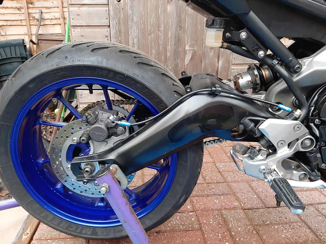

Even though I'd managed to get a useable rear brake I thought it could be improved so decided to revisit it today.
On very close inspection it became apparent the caliper wasn't sitting squarely with the disc and when the pedal was pressed it flexed.
A quick Internet search found a couple of threads about the front sliding pin being easily bent if not assembled correctly. I'd not removed it only regreased it before reassembly and looking at the old pads you could see they were chamfered so it had been like it for a while.
5 mins removing the pin and then holding the brake on whilst retightening the sliding pin sorted it and it now has a good solid pedal
Re: The darkside with a twist of fun
New shock coming? That one looks brave and krusty!
Scuffmark
- Posts: 206
- Joined: Tue Sep 29, 2020 12:03 pm
- Has thanked: 264 times
- Been thanked: 191 times
Its only the part you see in the picture thats krusty the rest of it is in pretty good shape considering its age.
It works just aswell as a newer one .... which is poorly
Don't worry it will be replaced.

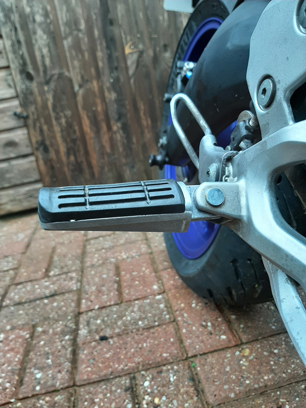

These aftermarket footpegs came fitted to the MT09 and whilst they look ok in the pics the rubber was quite hard and not very grippy, they also didn't sit flat, more angled down at the ends so I've replaced them with some standard ones.
Which meant I could now set the rear brake pedal to suit my size 11's
