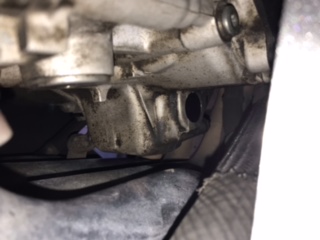

Re: Gsxr1000 K6
Nothing too exciting, but when I had the fairings off for cleaning, I'd noticed some oil weeping from what I think is the balancer shaft seal - the big black circle in the picture.
I had a quick read around, and causes are (unsurprisingly) that the seal is shot and needs replacing/fixing, or that the bike has too much oil in it... checked the oil, and the sight glass was completely full - so I figured I'd drop the oil and make sure the right amount was in there.
I emptied out just under 3.5 litres - Suzuki say you need 3l without filter change, and 3.3l with a new filter. I didn't change the filter. That's quite a bit of extra oil that the dealership put in. It was pretty black, and looked a lot older than the 400 miles I've done on the bike since I've had it...
With the nice fresh oil, which now nicely sits just under the max line in the sight glass, I went out for a little play, just 15 miles or so, and came back to find no more oil weeping which is pretty good news. Replacing the seal is an engine out job and probably would've seen the bike traded in.
Interestingly, I emailed the dealer twice about this, and now over a week later have yet to get a reply. I know phoning is easier, but I prefer to have a written record of stuff. Had the bike continued to weep (or if it starts again), I'll be on the phone and they can sort it.
