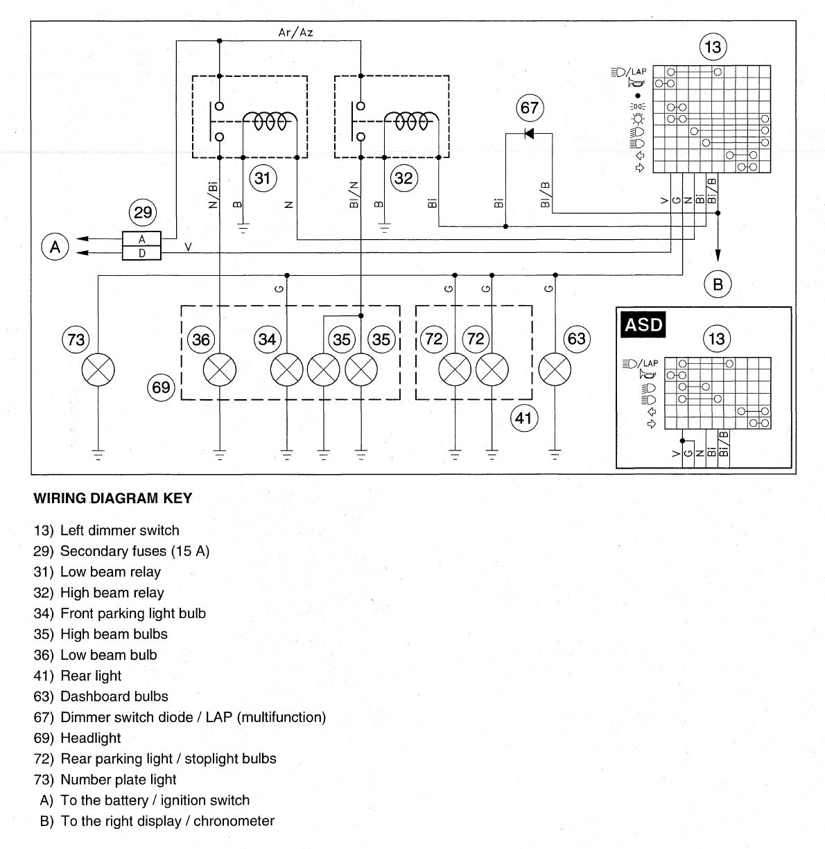

I'm reluctant to disconnect or bypass the diode plug, as from my reading of the lighting circuit diagram it has a function entirely unrelated to the indicators. I've attached a screenshot below from the workshop manual PDF that clearly shows the diode and its connection. And I'm pretty sure I've disconected the loopback/diode wiring and it made bugger all difference to the indicators.

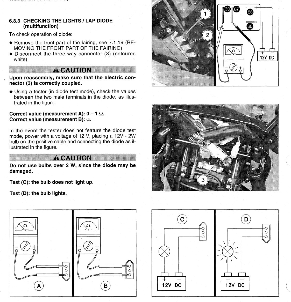

There is a specific section in the manual for checking the LAP diode (see below), so I don't believe it has any relevance to the mafunctioning indicators, although I'm happy to be proved wrong.

I've never heard of a LAP diode and in that diagram it doesn't seem to have anything to do with the indicators. It might be doing something quite different.

The V60 Aprilias all had a lap timing facility as well as the ability to change between mph/kph, degrees C/F, set the rev limit warning light etc. etc., so I suspect that's what the diode arrangement is connected to. I've only found one Scotchlock on the whole of the wiring loom, and that was used to splice into the fuel injection circuit for the Power Commander (which I've removed).

That's interesting. The "ghost" voltage mentioned can happen with LEDs that pass a small current - enough to show on a multileter but not enough current to power anything. The process described is very similar to what I and others have said in this thread.....
- mangocrazy
- Posts: 8855
- Has thanked: 2556 times
- Been thanked: 4166 times
Re: Indicators not working on Aprilia Falco
I'd never considered ghost voltages, and always assumed that what a multimeter reported was 100% reliable. But it's not presenting a load, so isn't necessarily accurate. Every day's a school day...
