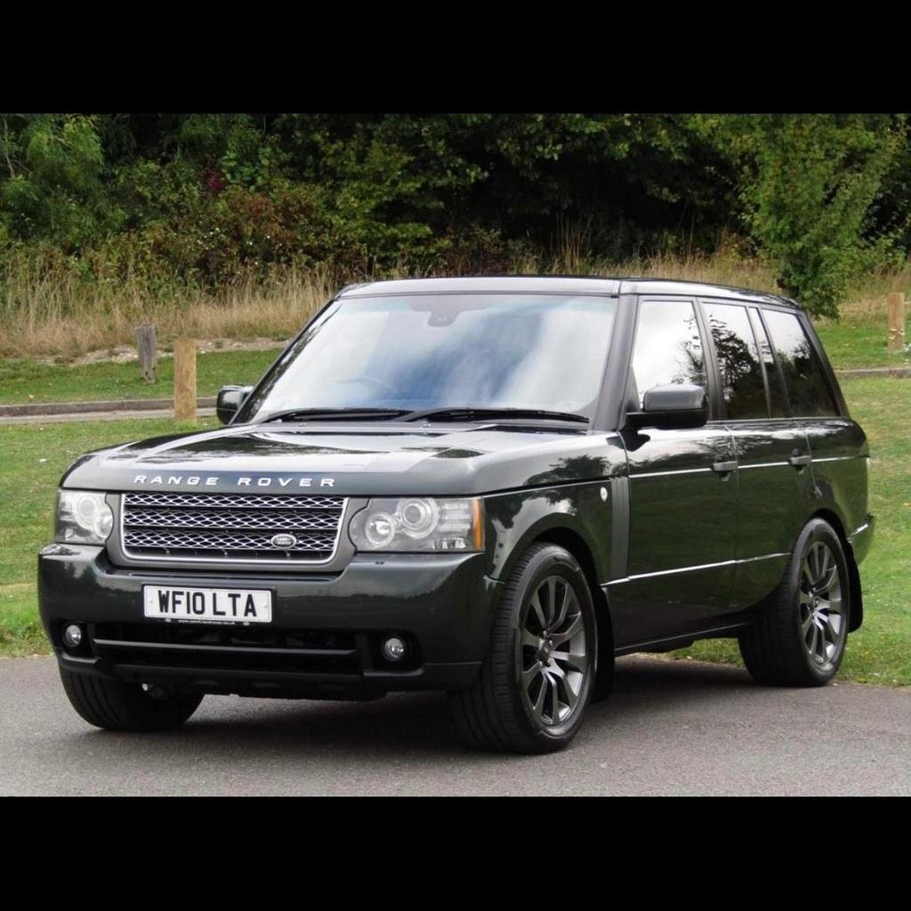

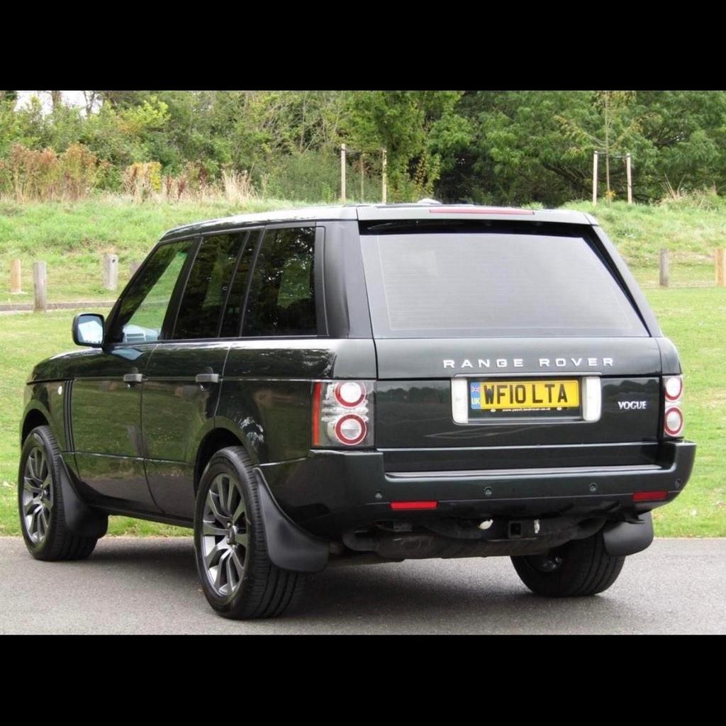

Changed my mind on the discovery and bought this instead…
It’s an tdv8 3.6 vogue.

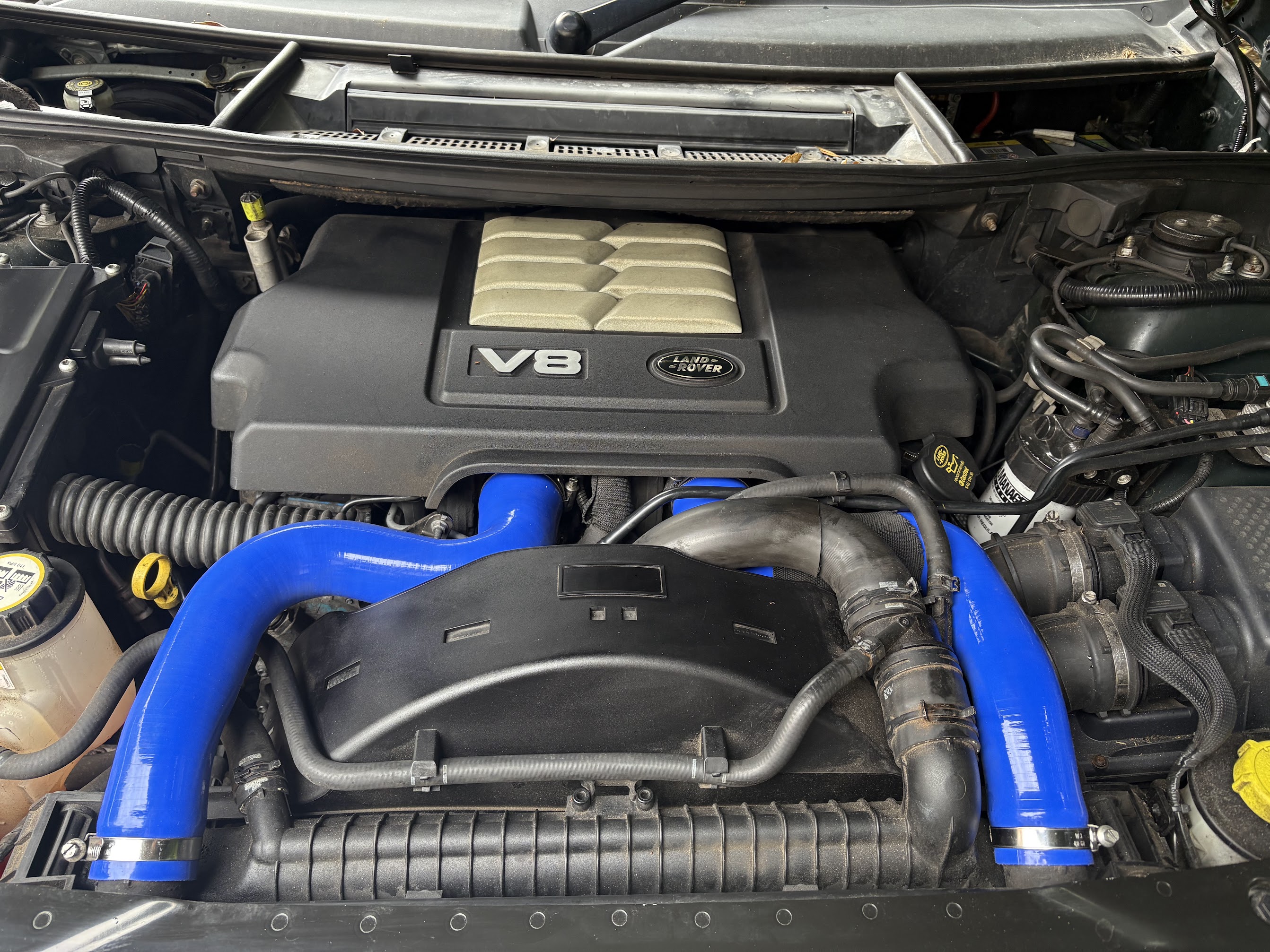

Had it for a couple of months now and it's been excellent. Really enjoying driving it and very happy all round.
The only fault I've had is that one of the upper intercooler hoses had developed a small split in it which got slightly bigger over the last month causing a ton of black smoke to come out of the exhaust under hard acceleration. I've replaced the two uppers and the two lowers and I have any missing boost back and I'm not a mobile smoke machine any more.

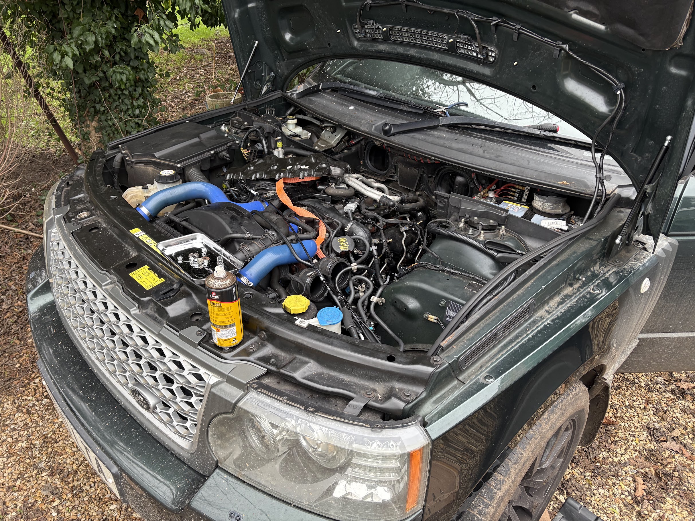

Probably should provide an update. Aside from the boost hoses, I've had to get a couple of things done...
I had an oil leak from the combined cam cover/inlet manifold. This was a big job that I gave to a specialist. It was potentially exacerbated by the increased boost from fixing the boost leak, but these things can leak. They found that two injector connections had been butchered and needed to be replaced along with the pipework. It turned out it was leaking diesel as well as oil, and probably the reason the engine bay was so spotless, as I assume that the seller had jetwashed it. They also replaced the thermostat housing as a precaution. This cost me just over 4k, but I was very pleased to have found a trustworthy specialist.
One of the egr to manifold pipes fractured and was replaced by the specialist. This cost about 800 but included fitting a new tyre and repairing a puncture in another.
I had a coolant leak from some aluminium pipes that form part of the heating system. The metal had either corroded or was a poorly manufactured part and sprung a small water leak. This took me about 10 hours of diagnosis, getting the part out, repairing it and getting it back in, but cost me nothing.

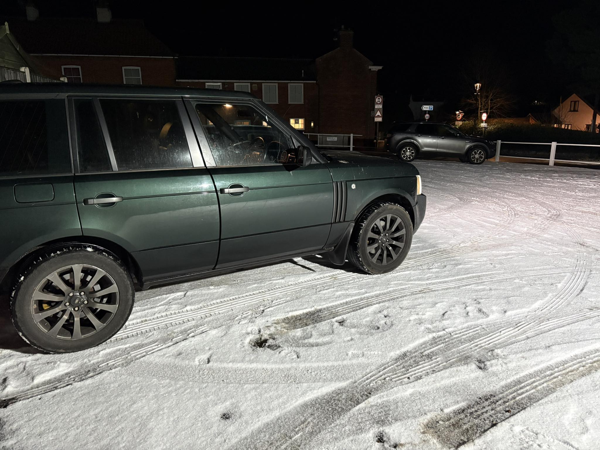

I've done a few decent journeys in it and use it regularly, and I absolutely love it. There's probably a limit as to how much money I'd pour into it, but it's an incredible car. It's obviously not as much fun as some of the quick cars I'd had, but as an allrounder I've never had anything that comes close, and I absolutely love it.

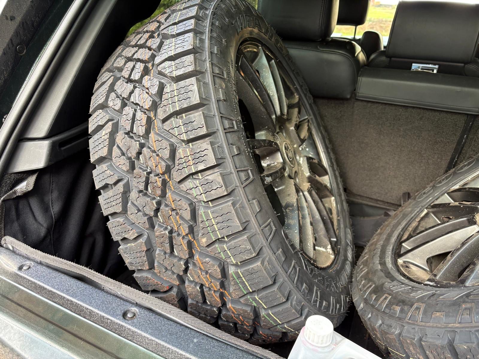

I've just bought a set of 19 inch wheels with some AT tyres on them and replaced the two that were worn out, so there obviously will be no more snow this year or for the next 3. I'm planning on going to explore some green lanes at some point soon.
