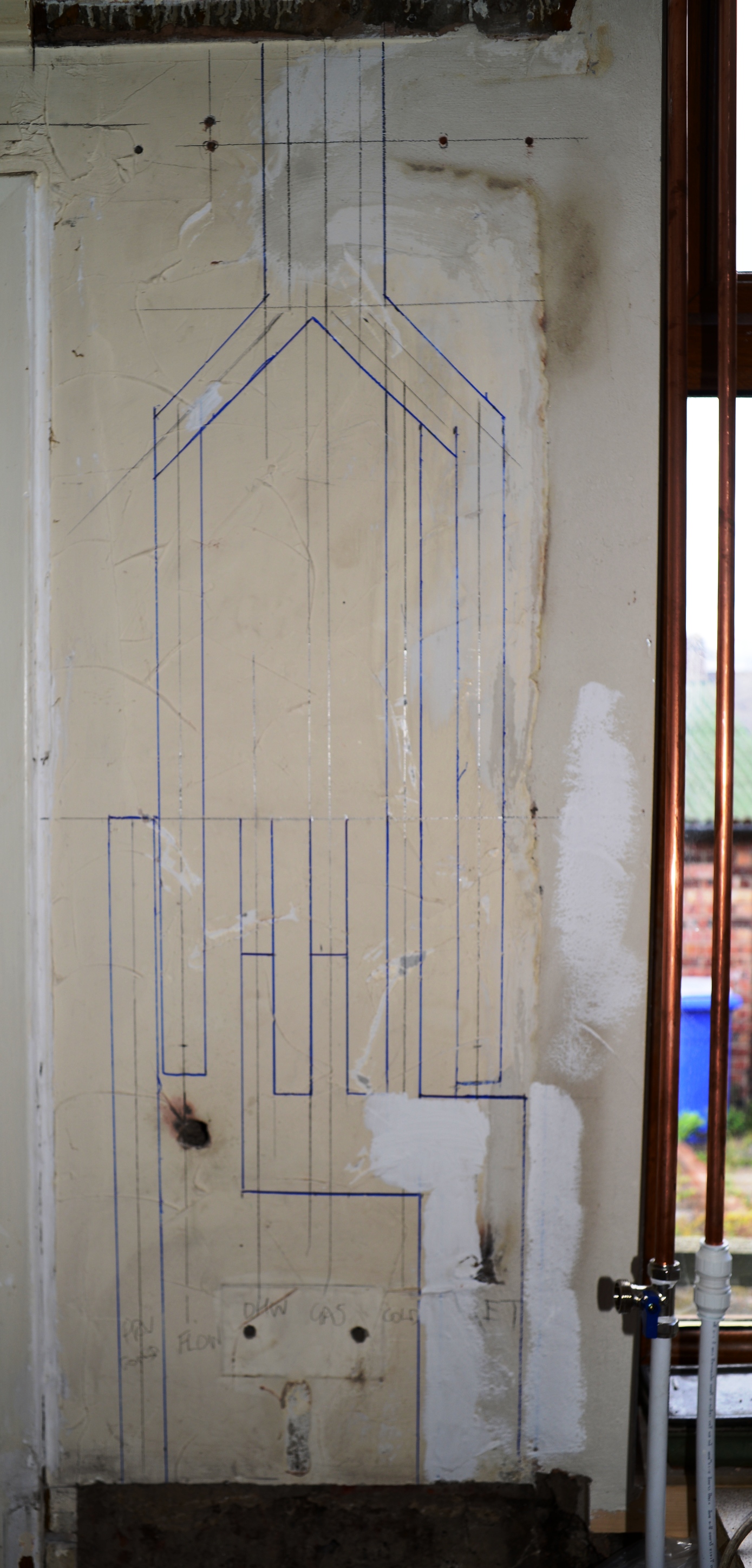

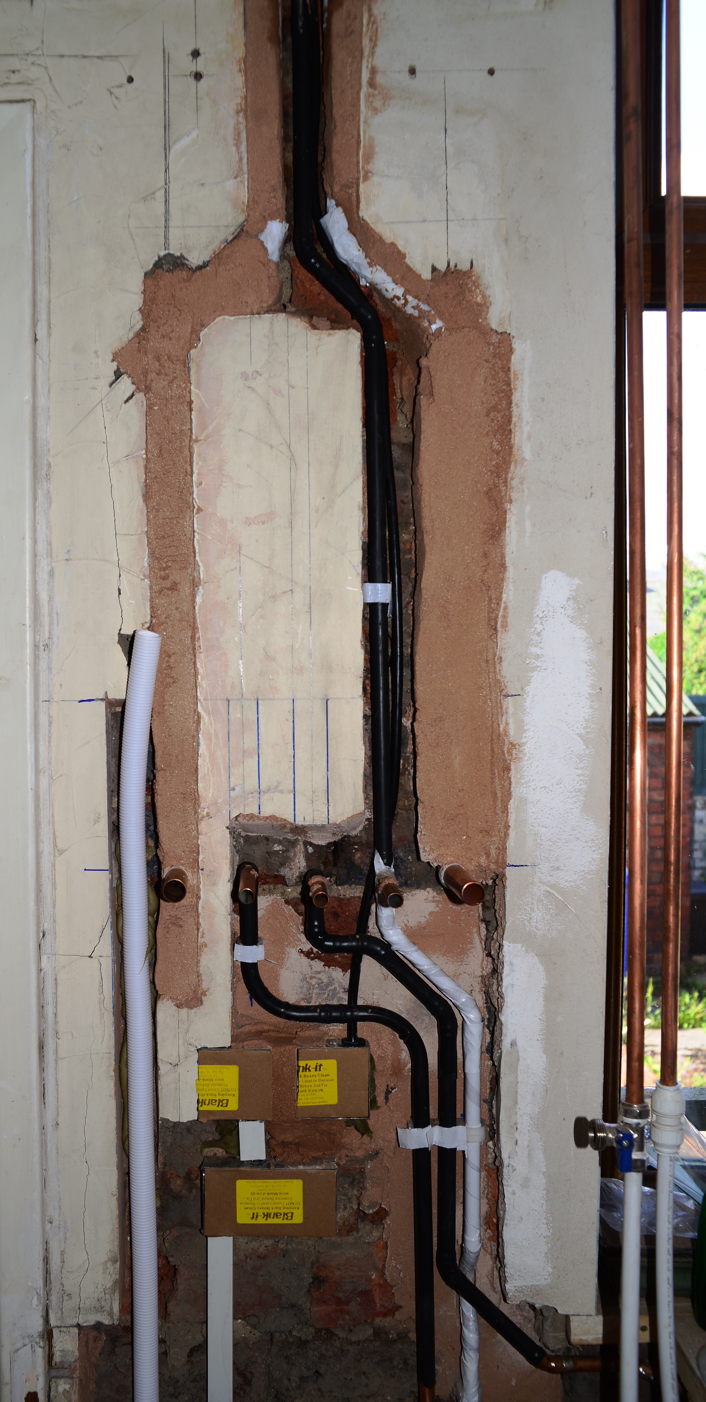

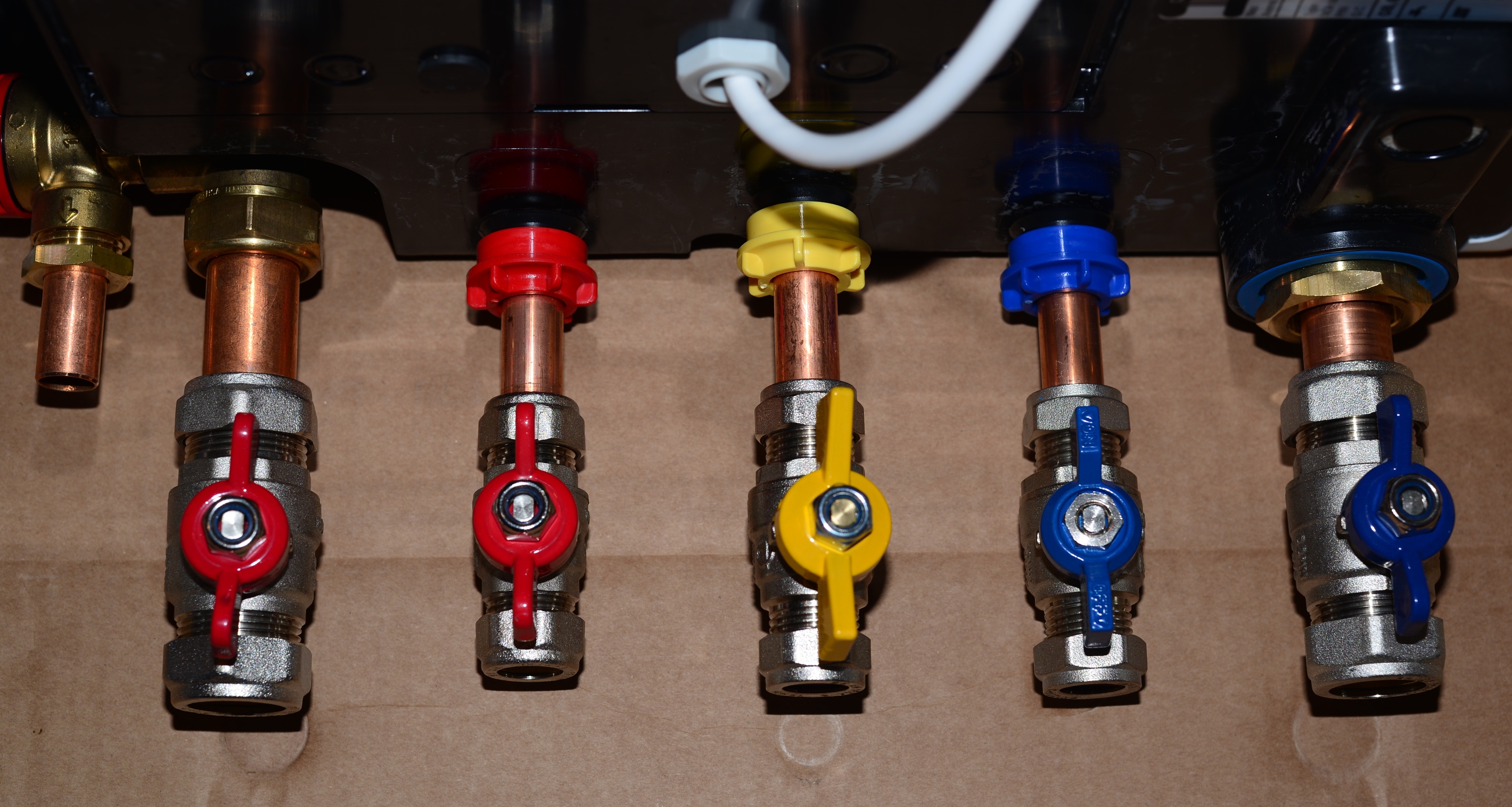

There are isolation valves all over the place in that part of the kitchen, along with multiple pipes embedded in the plaster. I counted seven in an area of less than a square metre...Cousin Jack wrote: Fri Dec 06, 2024 3:46 pmShould have put an accessible isolation valve at each end, you can never be too careful.mangocrazy wrote: Fri Dec 06, 2024 3:09 pm Should have bought a house with a cellar...I can access nearly all of the length of my cold water supply - it enters through the wall in the cellar, snakes its way through the cellar, up the stairs, feeds the bathroom then drops down to the kitchen. The only part that isn't accessible is the part that's buried in the kitchen wall, and I put that in from a single piece of copper pipe wrapped in tape to protect it from the gypsum plaster...
A nice eselction of isolation ball valves:
And part way through installation:
