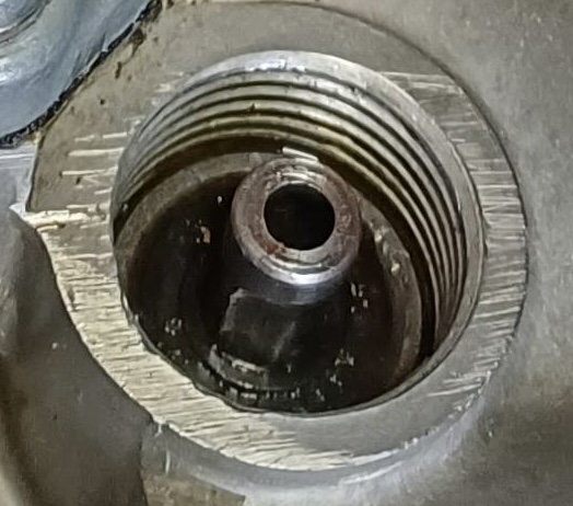

A tiny little oil seal down the tacho drive tunnel is weeping a little,but it looks like I'd need to take off the clutch casing to get at it properly,so....I've decided it isn't leaking bad enough yet. :lol:

Skub wrote: Fri Oct 27, 2023 6:08 pm A tiny little oil seal down the tacho drive tunnel is weeping a little,but it looks like I'd need to take off the clutch casing to get at it properly,so....I've decided it isn't leaking bad enough yet. :lol:
I'd class that as a self lubricating seal and ignore it, trying to fix it will no doubt involve snapped things and stripped threads.

Keep an eye on the cable to make sure it doesn't get too oily. I once had oil creep up a cable and mist the inside of a clock.
It wasn't a Kawasaki but I bet 'A' clocks are a lot rarer than later models.
Posts: 4434
Been thanked: 1224 times
Re: Kawasaki H1 1971
My friend Mr Bodger, who lives in my shed, asks if it’s a rubber-cased seal that withdraws upwards.
If so, sometimes you can screw self tapping screws (or similar) into it and pull it out. Take note of the writing on the seal first.
Of course, if that doesn’t succeed, you’ll have destroyed the seal.
Is there any wobble in the tacho drive spindle? That’s tough on seals.

Generally that spindle is pretty well supported, the bottom end below the gear goes into the casing and the top is in a steel boss which fits into the upper part of the case below the seal
It's not difficult to remove the cover, what's more challenging is keeping the oil pump oil tight the plastic washers on the banjos are pretty feeble but the bigger issue is the risk of stripping a thread on the oil pump, the metal is soft and the threads fine.
Been thanked: 14167 times
It looks like it would draw upwards and I have a new seal to replace it when I fancy,so those ducks are in a row. The spindle appears pretty solid.
I'll probably leave the job for now,or at least until a slight weep becomes more of an issue. I wouldn't be above using the self tapper bodge,ta!

Ian wrote: Sun Oct 29, 2023 10:34 am Generally that spindle is pretty well supported, the bottom end below the gear goes into the casing and the top is in a steel boss which fits into the upper part of the case below the seal
Yeah,those tiny fine threads on the oil pump are not to be messed with. There's plenty of oil pumps about with stripped threads,as thee knows,I'm sure! I'll not be going there unless it's very necessary and thankfully at the moment it's not. There is a little misting around the banjo joints,but I'm led to believe they all do that sir,so it doesn't concern me at the present.

Yeah they really do all do that, my first instinct was is it 2T oil that's got down the thread...
Just wipe it out with a tissue once in a while and put up with it until it becomes a problem.

Sounds like it’s an oil leak of the magnitude that I don’t usually repair.

Best solution I found was Graham Dyson rebuilt me a couple of cranks with labyrinth seals and no rubber seals except at the ends. Then I binned the oil pump and check valves and ran it on premix, it coped fine with me over revving on the track.
That's a bit of a radical solution though !
