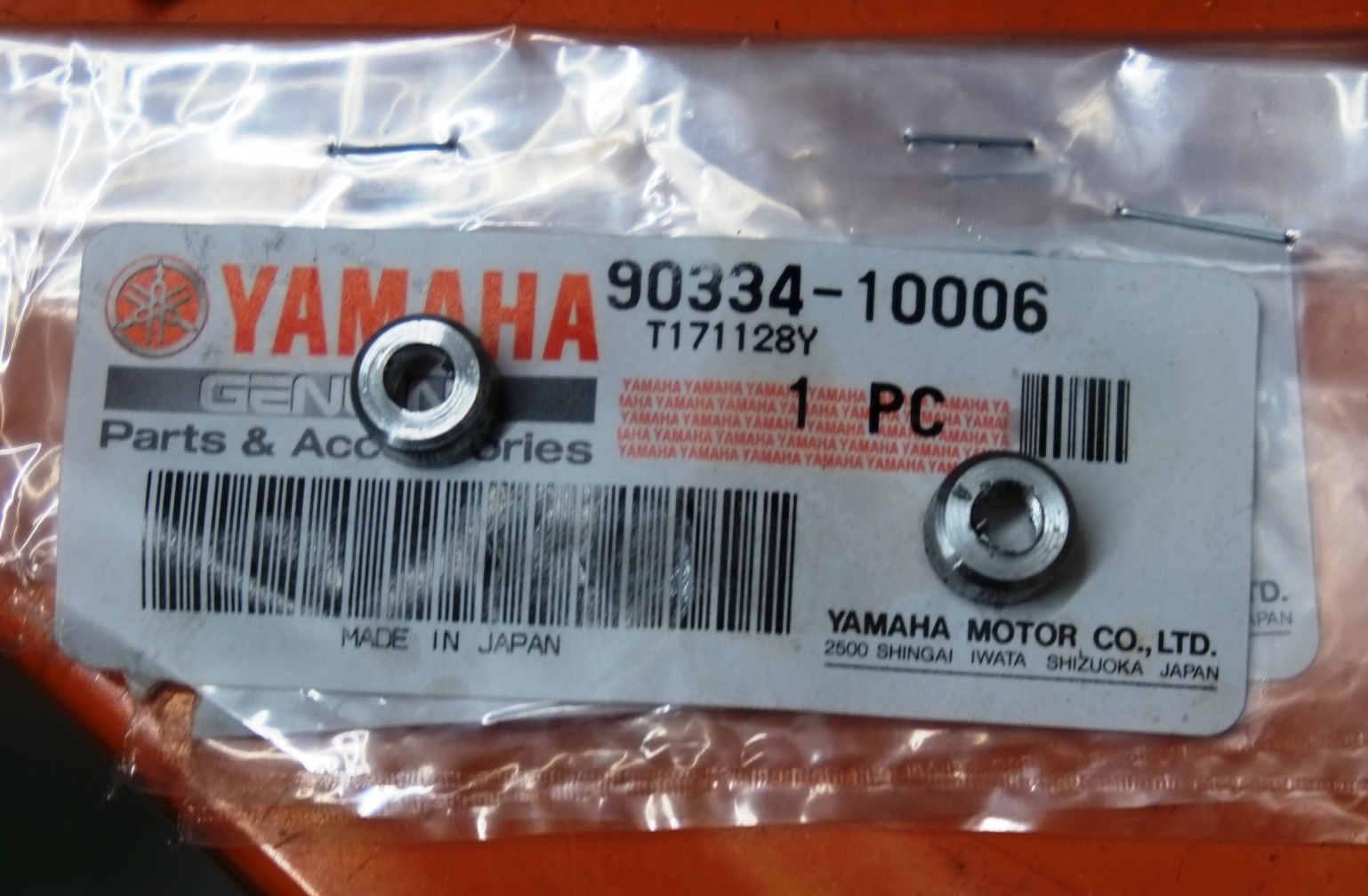

After further investigation (and consultation with the LC nutters on the RDLC forum) it appears that oil is weeping past the little alloy bungs that blank off the holes for the shift fork spindles. Apparently they work loose over time and start weeping oil. The cure (allegedly) is to give them a little tap (nothing too violent) to re-seat them and allow them to seal again. There are two such bungs, one by the neutral switch plate, and the other just behind the gearbox sprocket.
Just to be sure I've ordered a pair of new ones from Fowlers and if the weeping continues I'll be removing the ones in there at present and seating the new ones on a bed of silicone sealant. But I'll give the tap treatment a go first, as that's the easiest thing to do and I'm a lazy cnut.

However the other bike in the shed IS still leaking. The Tap treatment on the shift shaft plugs was entirely ineffective and I will now need to drain the gearbox oil (again), drill and tap the plugs, slide-hammer them out, clean any crap out and seat the new plugs on a bed of sealant. What joy.

Being ali the little plug didn't put up too much resistance. It's only 4mm deep and there is an air gap before you hit the end of the selector shaft. I drilled a pilot, then a 5mm hole as 5mm is the tapping clearance for an M6 x 1.0 thread. The plan was to tap an M6 thread then use some kind of slide hammer type arrangement to get the plug out. I was secretly hoping that the action of tapping an M6 thread would cause the plug to loosen its grip and come free; and believe it or not that was exactly what happened. Not just for one but both. That made life a whole lot easier.
I then cleaned up the holes with a mixture of paper towels, brake cleaner, vacuum cleaner and compressed air. But not at the same time. That would have been silly. Then I dug out the tube of Threebond I've been using for years and painted TB1215 over plugs and holes and tapped the plugs into the holes using a drift. One went in dead easy - the other put up a bit of a fight. Guess which is which...
And just to prove that I really did remove two plugs and replace them with new, here are the ones that came out:
So the new plugs will be left for a day or two (or three or four) for the TB to cure, and then the gearbox will be re-filled. Then we find out whether this has all been worth it or not. And having had a look at the grooves on the clutch pushrod where it encounters the oil seal, that is also getting renewed.
