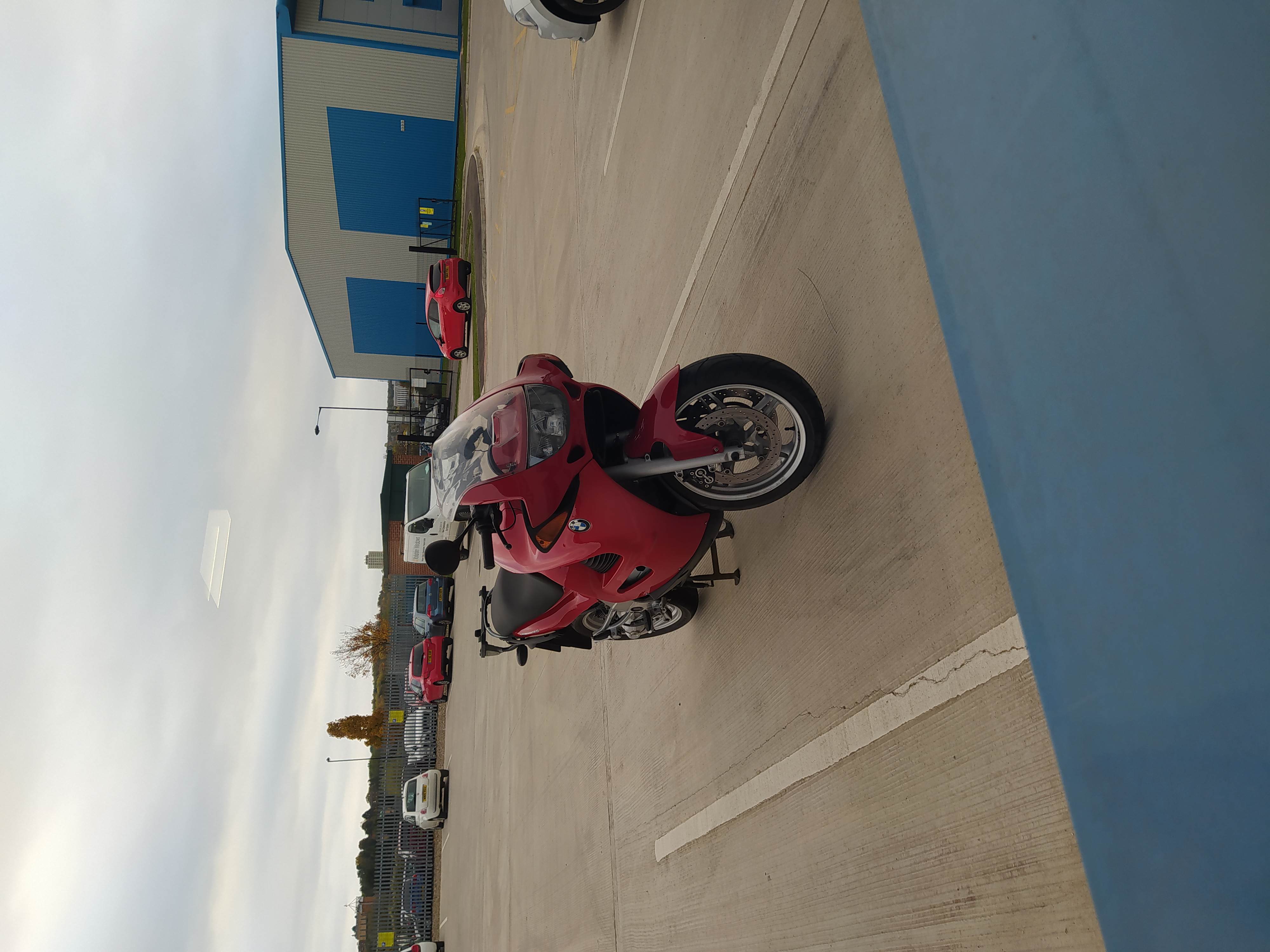

Re: The Big Red Bus
Long time no post.
Recently the Bus has received a set of R&G heated grips. I had a pair before I fitted to a Varadero, IMHO they're better value than anything Oxford offer, the controller just isn't as fancy.
I cut the old throttle side grip off as it start to rip as I pulled it off (fnar). A few gentle taps with the big mallet got the R&G grip on. It's interference fit, no glue used and it's 100% sold at full heat.
The original clutch side grip is mounted on a plastic tube that is held on to the bar with two screws. Undo the screws and it just slides off.
The R&G grip slides straight on to the bar, was a teeny bit loose, but some spray on impact adhesive sorted that out (after I'd remembered to let it go tacky first, oops).
The R&G controller is mounted to the top yoke using a stick back pad, Weeksy would have a fit.
The kit comes with some push in plastic bar end filler plugs, these were a bit loose, so I wrapped them in leccy tape to pad them out a bit and they've stayed put for the last 200 miles!
The R&Gs get so much warmer than the Oxford Touring grips the shop fitted to my old NCX and warmer than the official Triumph ones on the old Tiger XC.
They're wired direct to the battery for now, if I can be arsed I'll build a relay switched loom for the grips and the satnag. I did one for the Varadero and it was piece of piss and I'm crap at sparks.
The patch I made for the exhaust has blown off, somewhere between my house and Bridlington, it lasted a few hundred miles.
I've been using the Bus to commute this week and the MPG certainly takes a hit with the exhaust blowing, I guess it's throwing the lambda reading out. On the plus side I'm now using the stupid indicators like a natural, they're sooo easy.
