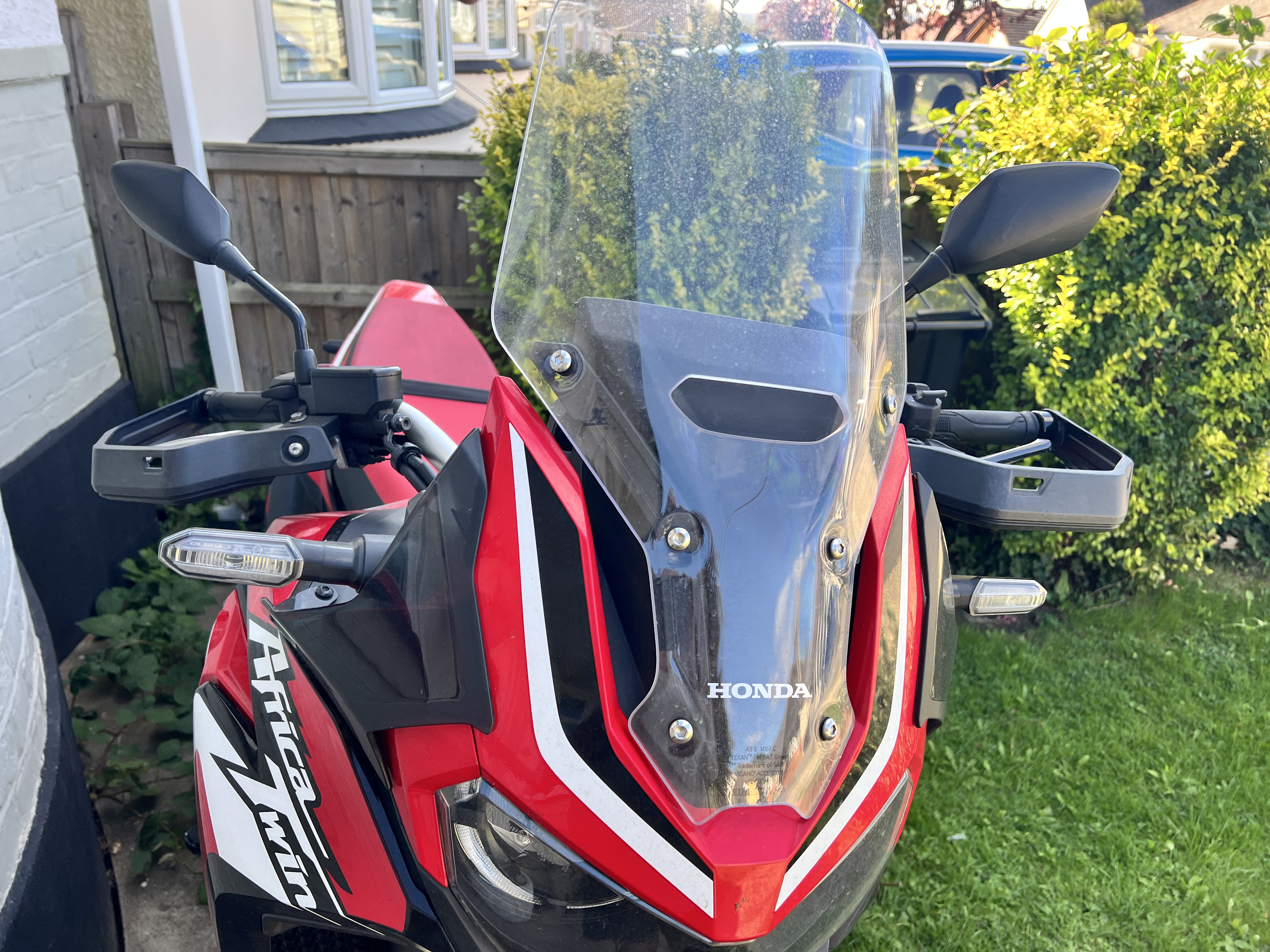

Rode the bike today. The new screen pushes the wind to just above my visor, so there is still some turbulence/buffeting but at least its not coming up under the chin bar now. Might be better when the colder weather comes and i revert to a non peaked m/x style lid too? I also have the option to drop the seat to the lower setting which might improve things even more? Not sure i'll bother though as seat to pedal height is more of an issue than a bit of buffeting.

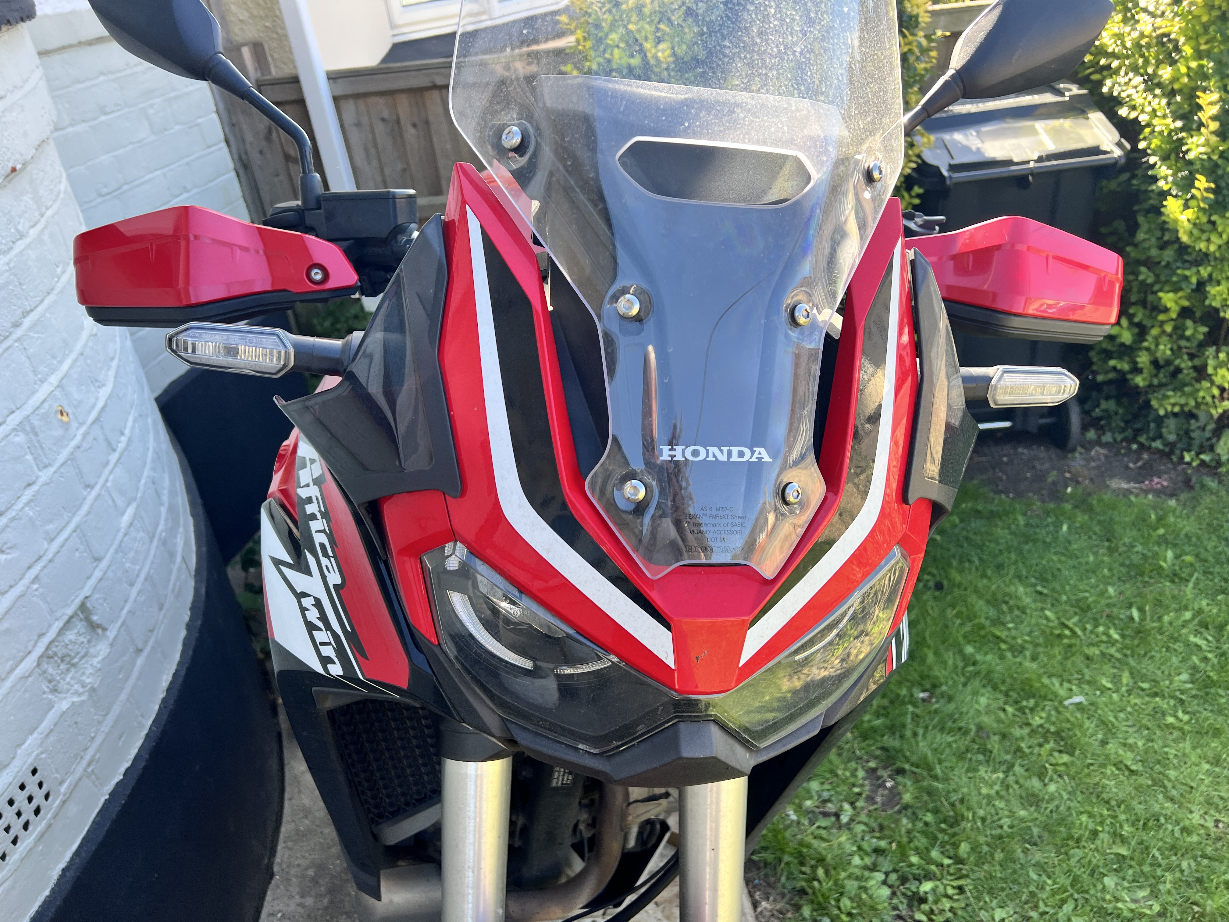

More winter prep with the hand guard deflectors fitted and I’ve fired off an email to the bike cleaners to get in booked in for a clean and ACF50 treatment. :thumbup:
