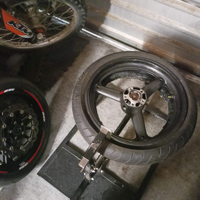

And now that I’ve got my two “new” front wheels before I got into replacing bearings and changing over tyres and discs etc, I thought that I’d just double-check that the MK2 wheel is, as people have told me, actually a direct replacement for the MK1, and I’m pleased to report that indeed it is- slots in with the same spindle and spacers with no mods required, so we're good to go

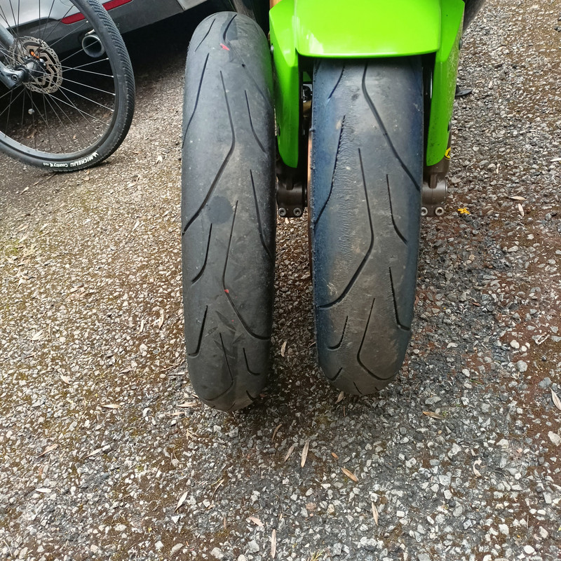

The difference between a 3.0” and 3.5” front wheel really is quite significant in terms of how a 120 tyre sits on it, this pic very well illustrates that -
Both tyres in the pic are identical ( 120/70 Sportsmart TT)- the one on the left is on my (3.0") MK1 bandit wheel, and the RH is my ZX6, which has a 3.5 rim- quite a difference in profile eh!
So I set about getting the rotten old tyres off the newly purchased MK2 wheels

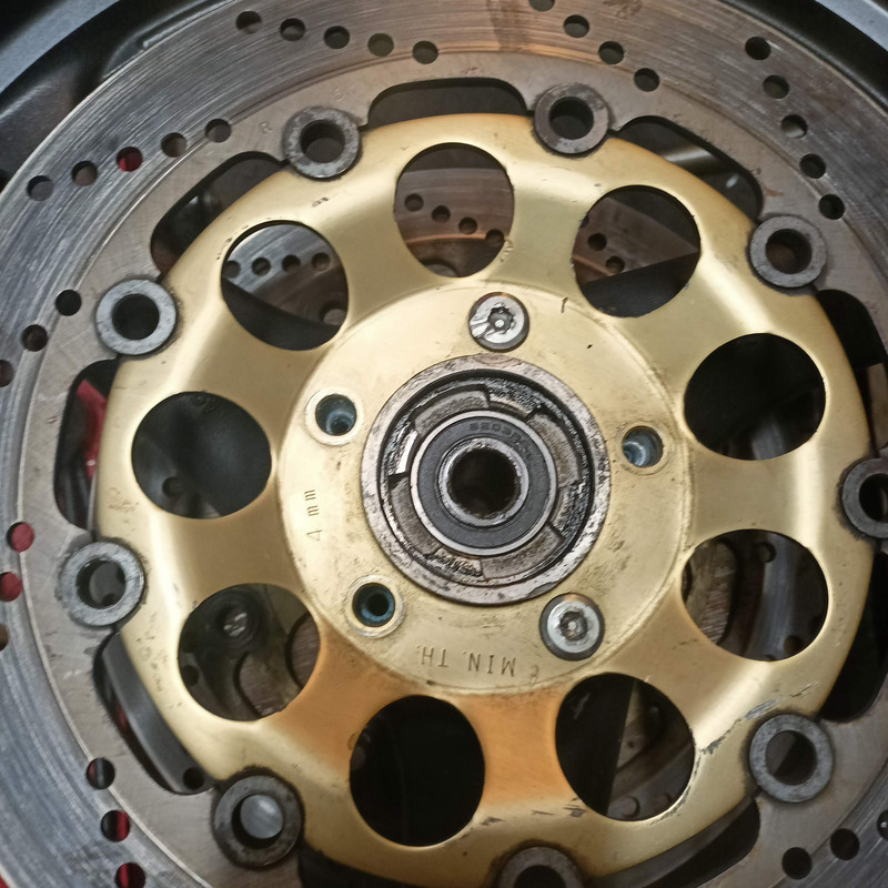

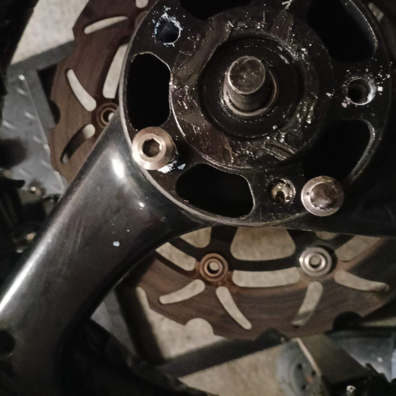

And the discs off my current wheels, and as is often the case with old stuff, it’s not always completely straightforward…
On my old wet wheel, the discs and bolts are OE Suzuki and it was obvious from both the state of a few of bolt heads, how ridiculously over-tightened they were and the huge amount of Loctite, that they’d been in and out before- I managed to get all but two out, unfortunately these two however have been previously mullered (there’s even a bit of a slot been cut in one ) and a 6mm Allen key just turns, so I’m going to have to get creative with those and drill them out I think…
My current “dry” wheel had after-market wavy discs and non-OE stainless bolts, and the heads looked decent in these, Oh good I thought and set about removing these discs- whoever had put them in hadn’t gone quite so mad on the tightening or amount of Loctite so the bolts all came loose nice and easily- one far too easily, and the head just dropped on the floor.
On closer inspection I could see that there is the remains of a bolt in that threaded hole that someone had had a very poor and failed attempt at removing- the hole that they’ve drilled is way off-centre, so it looks like they’ve thought “ fuck it”, sawed the head off one of the new bolts and stuck it on with black silicon to ensure it passes scrutineering- I kid you not- the offending hole is the one at the bottom of this pic, and next to it is the upturned fallen bolt head showing the remains of the silicon
But this doesn’t really matter to me as I won’t be using that wheel again, and it has a very small SH value, so I’ll likely just take it down the tip with those manky old tyres that I took off the “new” wheels.

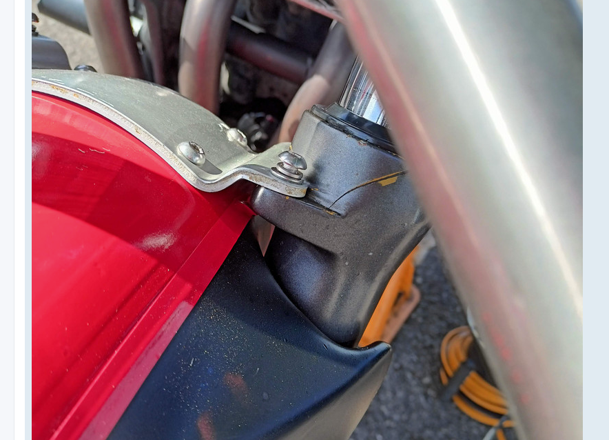

Errr is that a crack in the fork leg to the right of that bolt head?

Good stuff!
The rhs leg also looks to have a bad scratch on it?
¬Beat me to it.Ditchfinder wrote: ↑Tue Apr 02, 2024 2:02 pm

RE the fork lower "cracks"- fear not eagle-eyed ones! - It's just cracking in the grey metallic coloured coating only- not sure whether it's a powder coat, ceracote or whatever , but it has numerous crack in the coating- the fork lowers are an aspect of the bike that I haven't bothered stripping or re-finishing yet, plan is to strip them and some point and spray them a nice sort of OE silver.

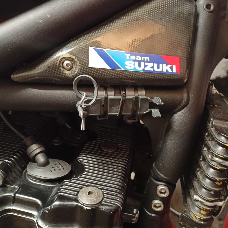

And in other news, I've taken on-board @Nobby 's advice and re-mounted the transponder bracket a lot closer to the front of the bike- it's not at the absolute front but is just about as close as I can get without putting it on a fork lower, which is simply not happening for me, (well, maybe I might reconsider if I end up losing a race by 0.00001sec but doubt that's gonna happen )- -am still surprised that a scrutineer recommended I put it down there

You can use an appropriately sized torx bit, an impact driver and a hammer to get fecked Allen disc bolts out.

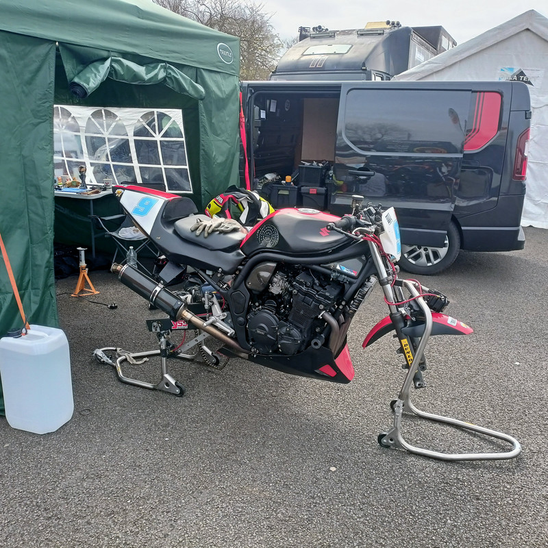

The week-end started well on Thursday afternoon when we arrived at the circuit with us managing to bag a really decent spot in the paddock directly above the scrutineering shed and just along from Alan the tyre man- really were fortunate there as despite it only being just gone 6pm just about everywhere with hard-standing was taken.
Got the gazebo up and the bike etc unloaded into it and buggered off into Louth to Mrs Miggins B&B (well, it was actually called the Beaumont Hotel but like a lot of places in Lincolnshire that I’ve experienced, it , and specifically the owner was, umm quite special...... )
