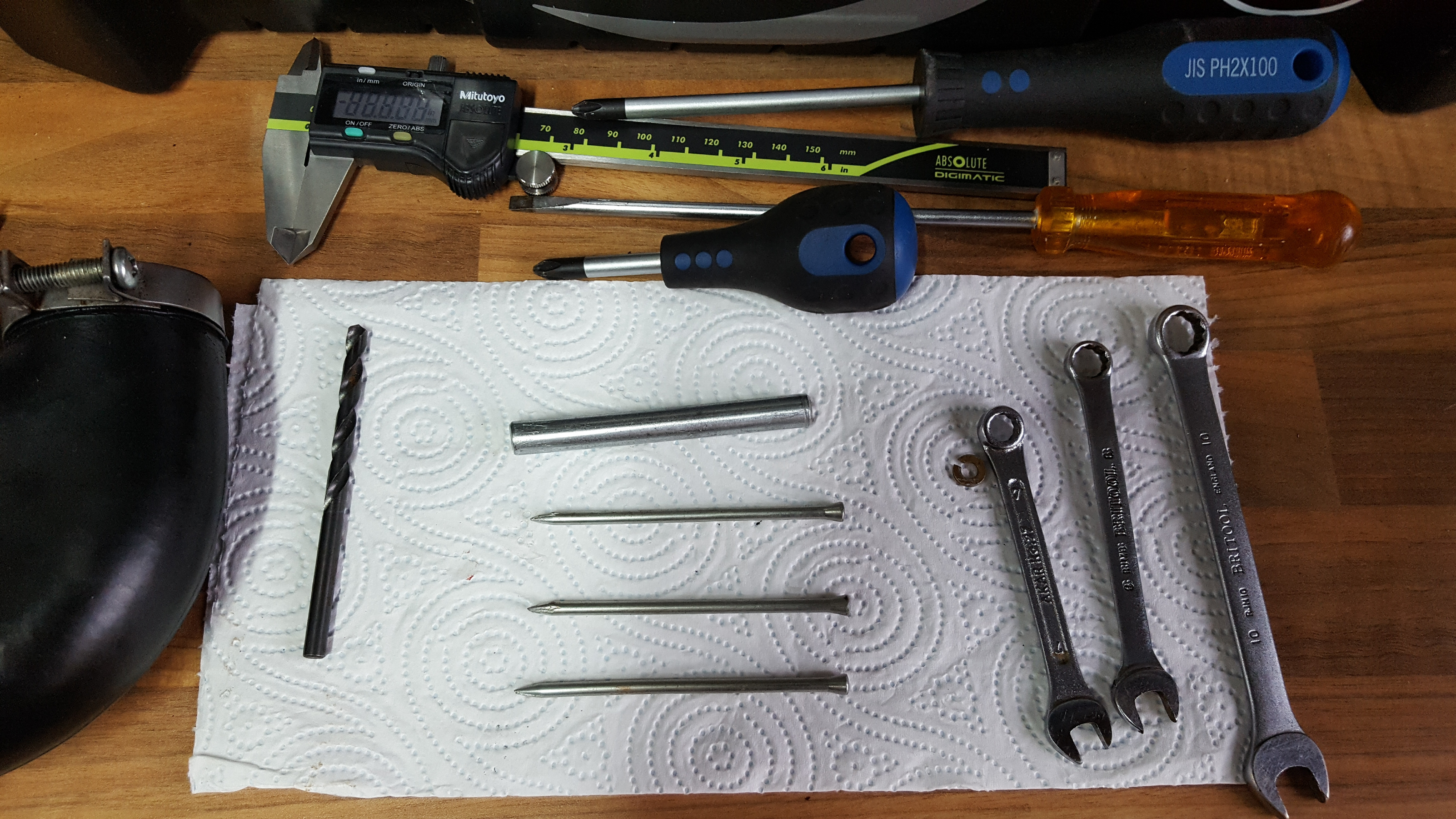

I finally got around to mechanically synchronising the carbs today.
Behold the necessary tools for the job.
H1 - Imgur (8).jpg (2.76 MiB) Viewed 175 times
3 obo nails.
5.5mm drill
A split washer. (not needed)
7,8 and 10mm spanners
A couple of JIS screwdrivers
A vernier. (not really needed)
High tech gear. :lol:
The process involved firstly removing the inlet rubbers,which I had to do anyway,as the originals are cracked in places.
Since the bike idled well before I start,I took a note of the slide gap at the mouth of carb number 3 as a reference. A 5.5 drill fitted nicely.
I then backed off all 3 idle screws,so the slides sat as low as possible.
Using the throttle cable adjuster at the bars,I raised the slide until the 3/8" rod went in and out smoothly. Carbs 1&2 got the same treatment,by using the carb top adjuster.
The top adjusters were then locked and the gap re-checked. All good.
Back off the bars cable adjuster until slack,then reset the 5.5mm idle gap on all 3 carbs.
The obo nails were balanced just under the slide and sticking out the carb mouth on all 3,so I could check they all moved at the same time and using the idle screw to adjust,if necessary. As it happens,they were all dead on.
The bike started first kick,felt crisp and idled at a steady 1400ish rpm.

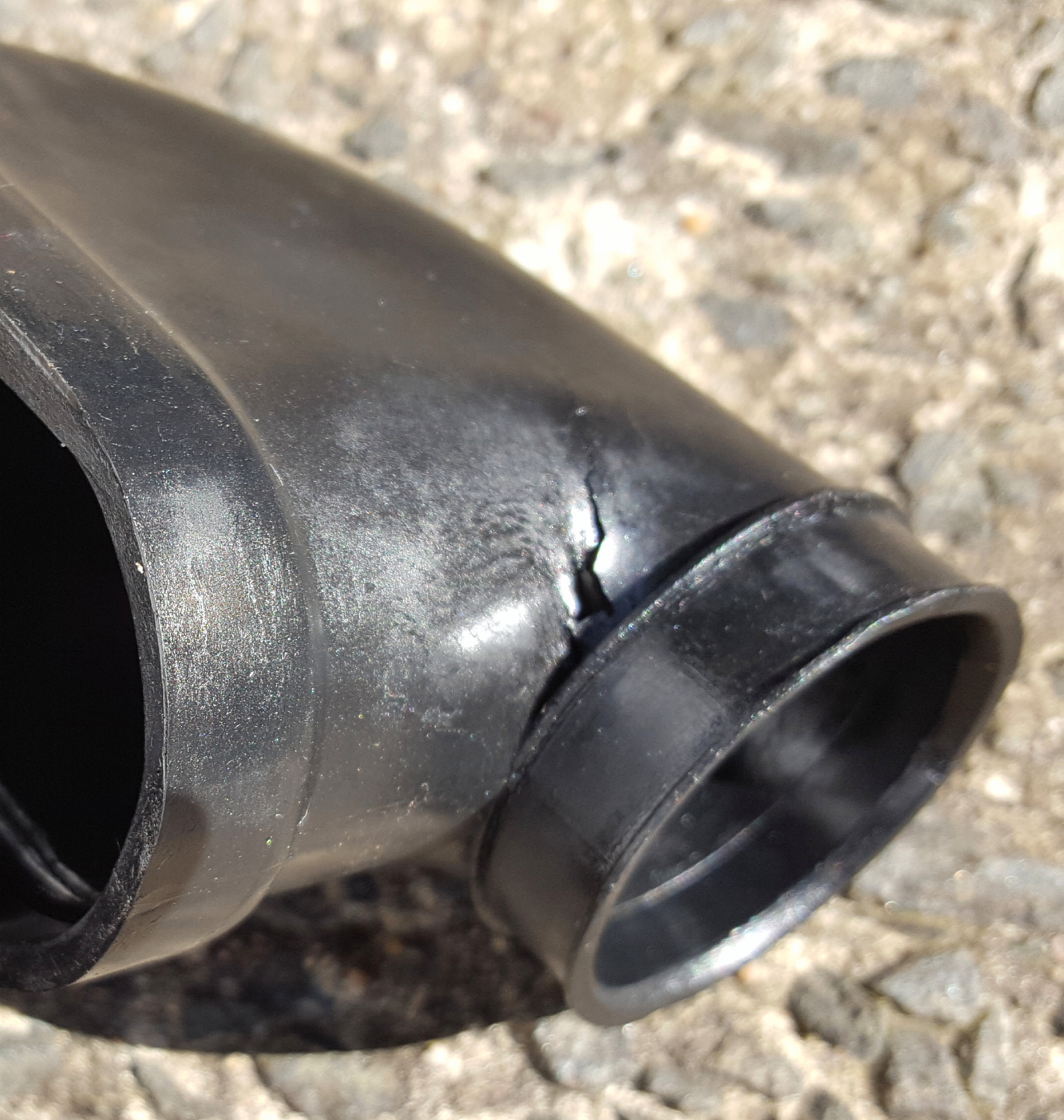

This won't have helped good carburation much.....

Re: Kawasaki H1 1971
Posted: Mon Aug 21, 2023 7:36 pm
by Druid
I had similar problems with my GS750, 50 year old rubber loses a bit of its flexibility. You can't get replacements for love nor money, there's sometimes good reasons for fitting pod filters :(
How easy is it to get replacements for yours?
Posted: Mon Aug 21, 2023 7:45 pm
Druid wrote: Mon Aug 21, 2023 7:36 pm I had similar problems with my GS750, 50 year old rubber loses a bit of its flexibility. You can't get replacements for love nor money, there's sometimes good reasons for fitting pod filters :(
Fairly easy to get them as reproduction parts,but they know how to charge. £125 for 3 rubbers was the cheapest,some were looking £150. I'm glad I didn't need any of the 5 clamps,the two big ones make the rubber look cheap!

Skub wrote: Mon Aug 21, 2023 10:36 am This won't have helped good carburation much.....
Depending on how far round the split goes, I reckon that could be repaired using something like CT1 hybrid polymer adhesive/filler. It sticks like sh1t to pretty much everything.
Posted: Tue Aug 22, 2023 4:40 pm
mangocrazy wrote: Mon Aug 21, 2023 10:03 pm
That's probably the worst part,shown in the pic,but there is general 'dozing' all over the three sections,so any repairs would be ongoing.
It's just too long new.

Are you going to bite the bullet and buy new/reproduction? I'd be tempted to try a repair first, especially as the part is largely out of sight.

I'd just fit pod filters and go up two sizes on the main jet, three if you're feeling cautious, you might need to drop the needle a notch as well.

mangocrazy wrote: Tue Aug 22, 2023 6:07 pm Are you going to bite the bullet and buy new/reproduction? I'd be tempted to try a repair first, especially as the part is largely out of sight.
Bought and fitted the same time as I synced the carbs.

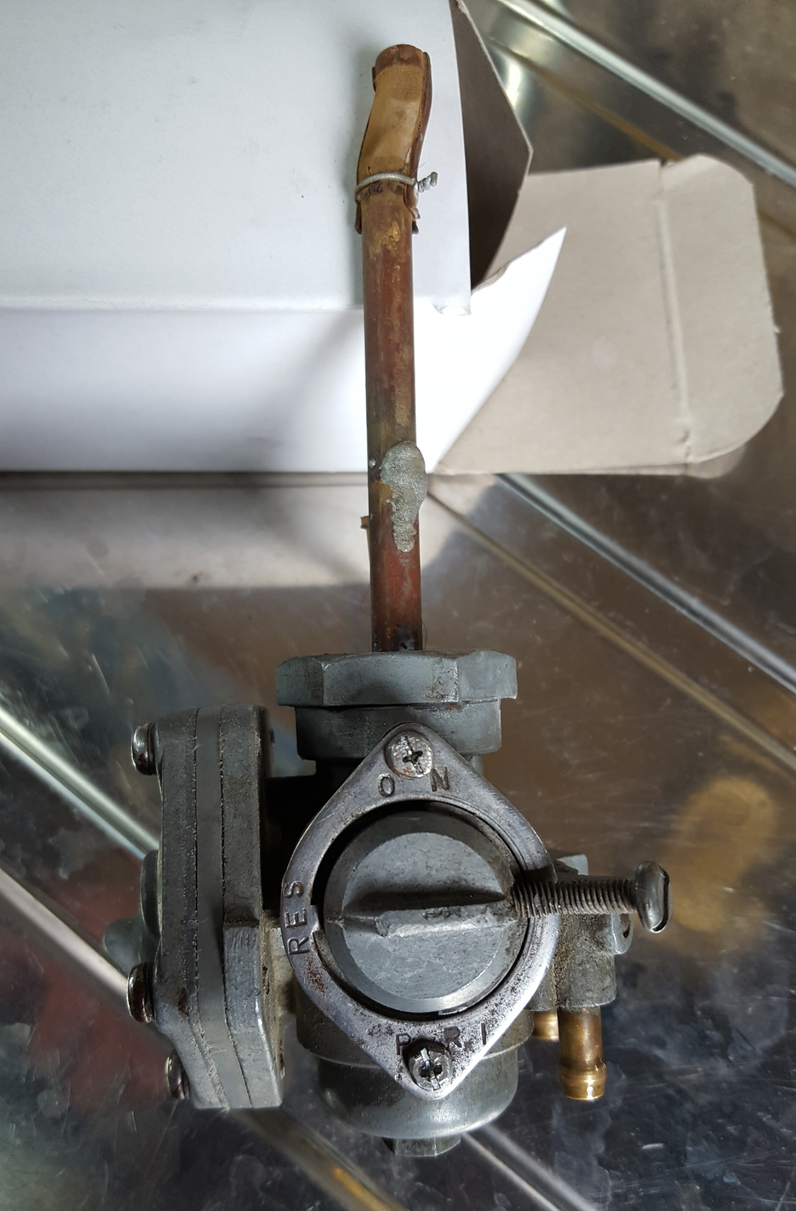

Before and after pics.
Old fuel tap.
H1 - Imgur (5).jpg (4.9 MiB) Viewed 173 times
Revamped fuel tap,now with an off position instead of prime.
