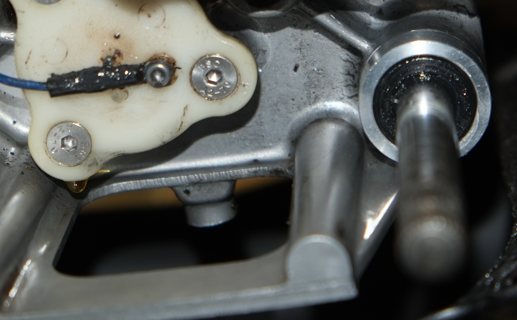

So I've turned my attentions back to Elsie, particularly as it's showing signs of incontinence in its old age. From time to time I need to move the LC out of the shed it shares with the VFR, as space is at a premium. When doing this I've noticed gummy deposits on the floor where the LH centre stand leg was, and it turns out to be gearbox oil escaping past the gearchange shaft oil seal. This is a well-known issue with LCs of a certain age, as the seal wears a groove in the shaft allowing oil past. In some cases the steel shaft actually wears the alloy crankcases giving rise to iffy gear changes. Mine hasn't gone that far (it's never been Yorick'd) but the solution is the same; hoick out the old oil seal and replace it with a niftily machined alloy part incorporating an o-ring, phosphor bronze insert and new oil seal housing which moves its position outwards by 10-15mm and on to an unmolested part of the shaft (see picture).
The machined alloy part is an interference fit and is drifted in to the former oil seal housing using a suitable length of steel tube. Once the alloy part is fully home, the oil seal is then drifted into position in the same manner. By far the hardest part of the whole operation was removing the old oil seal. Once that was out, cleaning up the seal housing and fitting the new parts was the work of a couple of minutes. The kit even provides a replacement for the manky 40 year old nylon sleeve that protects the gear change shaft from flappy chains.
So hopefully that will be the last of gummy deposits on the shed floor...

mangocrazy wrote: Sat Feb 12, 2022 3:32 pm I'm having an enforced break from VFR-bothering, as I've belatedly remembered just how difficult making up braided hose lines really is. The stainless braid is an absolute vicious b'stard to handle, giving you puncture wounds for fun. So I've made a strategic withdrawal and am hatching A Plan on how to deal with it. This involves (as usual) Buying Stuff Online and waiting for it to be delivered.
Not if that switch has any input......
Posted: Sat Feb 12, 2022 8:38 pm
by mangocrazy
Hmmm - good point, well made.
I' haven't refilled the gearbox yet, so will investigate further tomorrow. Without taking a high magnification flash photo of that area (and you pointing it out), I'd never have seen that oil droplet.
Posted: Sun Feb 13, 2022 8:58 am
by David
Happy to be of service....
Posted: Sun Feb 13, 2022 9:45 am
by David
Perhaps I should have said " output".
Posted: Sun Feb 13, 2022 12:37 pm
by mangocrazy
It looks as if the o-ring that seals the nylon plate from the passage of gearbox oil has become brittle and is no longer doing its job. I guess it's allowed to after 40 years in the same position...
Part ordered from Fowlers (still available from Yamaha), so hopefully that will fix the problem.

O-ring arrived yesterday, was fitted with lots of silicone grease and then the gearbox re-filled with oil. It's now on drip-watch...

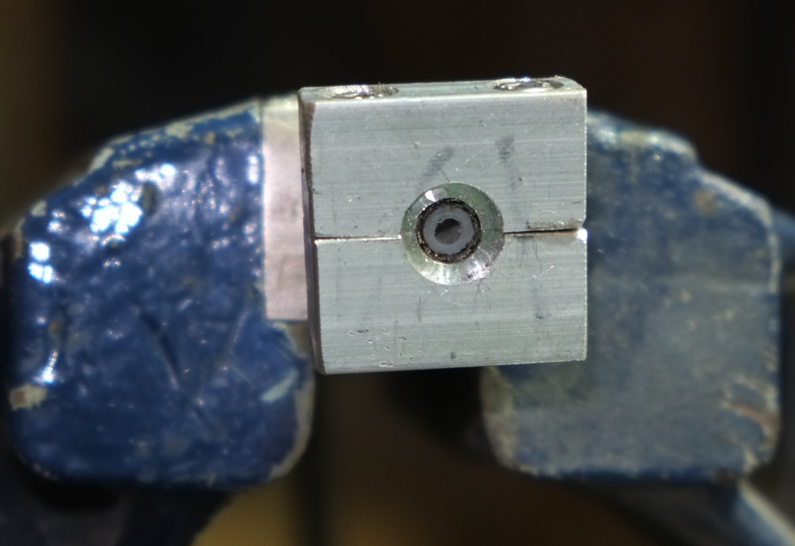

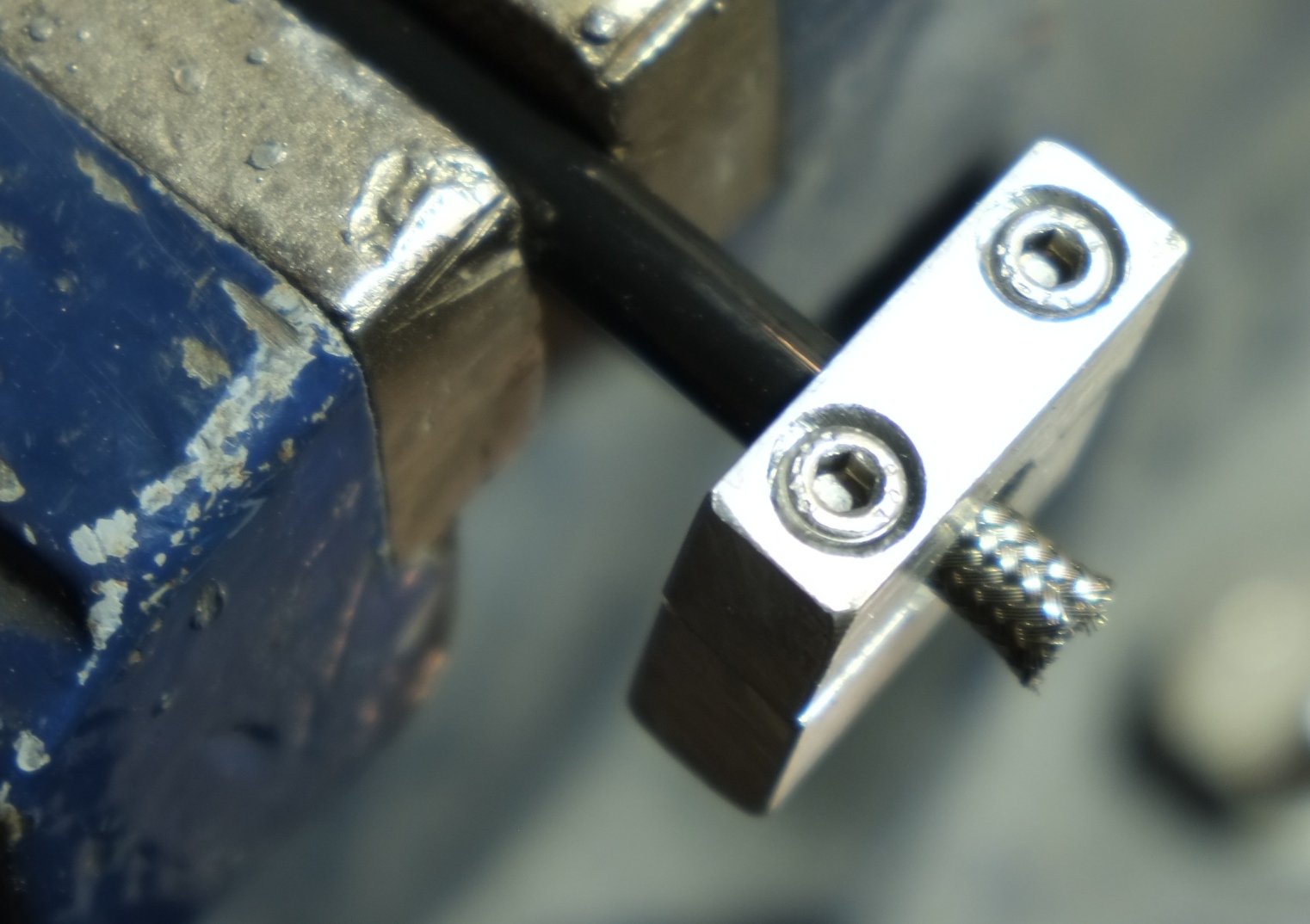

The other Big Thing (as far as I'm concerned - I doubt it will register a flicker on anyone else's WTF scale) was the successful fabrication of a Special Tool to assist me in making up braided steel hose lines without bleeding to death from puncture wounds. The photos show Wot I Dun better than I can explain. I give you the Special Tool...
It's made from 30mm x 10mm aluminium flat bar and has a 7mm hole bored through the centre, which is slightly larger than the o.d. of braided hose in its unmolested state (6.4mm). It also has a 2.5mm deep x 10.5mm wide hole milled on one side, the reasons for which will become apparent.
Top view of the tool, showing how the braided hose flares out (and makes life difficult) when cut.
The tricky bit. The tool is gently pulled down the braid until all the loose ends are contained within the tool and the milled section is free of any braid.

For some reason I couldn't add any more pics on that post, so continuing in a separate one.
Then the ferrule is placed inside the milled section and given a firm push (using pliers to avoid damaging fingers) so that the braid can't escape and is held within the ferrule.
Then the tool is unscrewed and removed and the ferrule pushed fully back.
