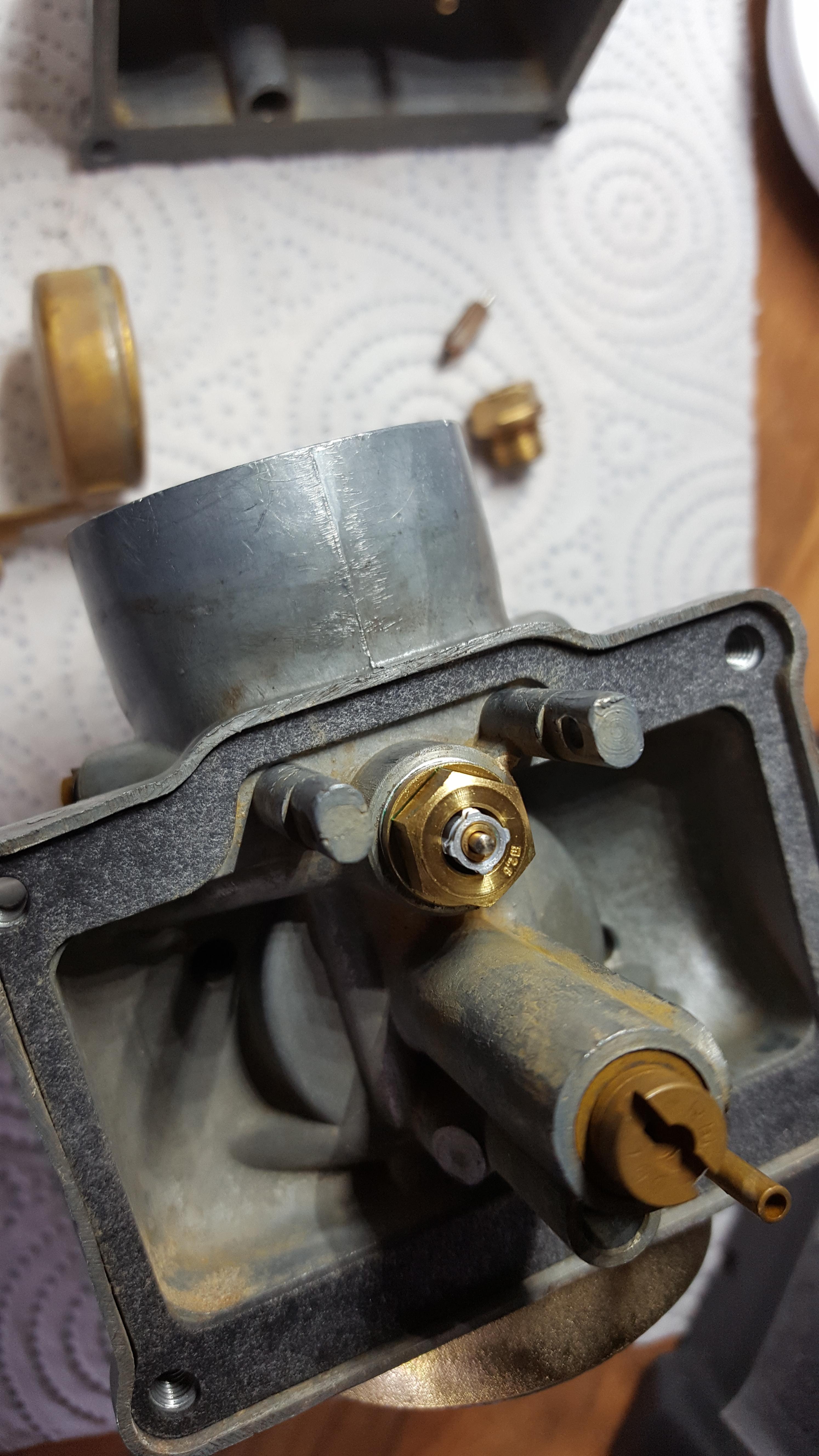

Carbs off today for investigation.
H1 - Imgur (4).jpg (4.18 MiB) Viewed 282 times
No leaks in the float bowl overflow pipe,the floats are sound,but on the middle carb the needle valve was slightly grooved,plus the float tang wasn't closing it properly anyway.
I replaced the needle valve with viton tipped ones from Mikuni and although the other two carbs looked ok,I just did them all while I was in there. I had to reset the float height too,as the new needle valves sat a little lower than the old ones.

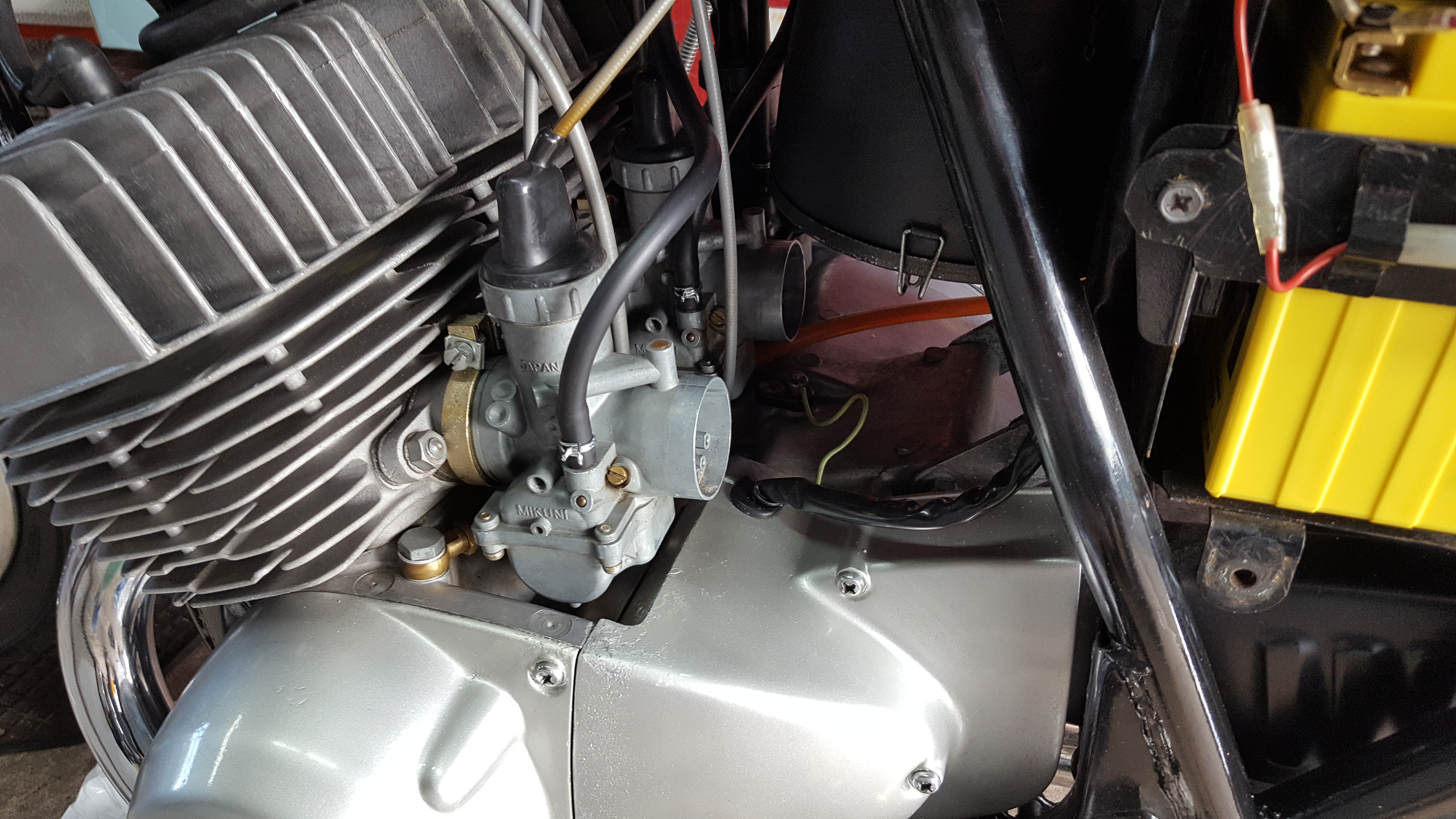

H1 - Imgur (3).jpg (1.26 MiB) Viewed 282 times
I stuck the carbs back on and turned on the fuel. No leaks and the bike fired up and idled ok even without the airbox.
I'll put the airbox back on and do a test run,but hopefully that's the leaks sorted.

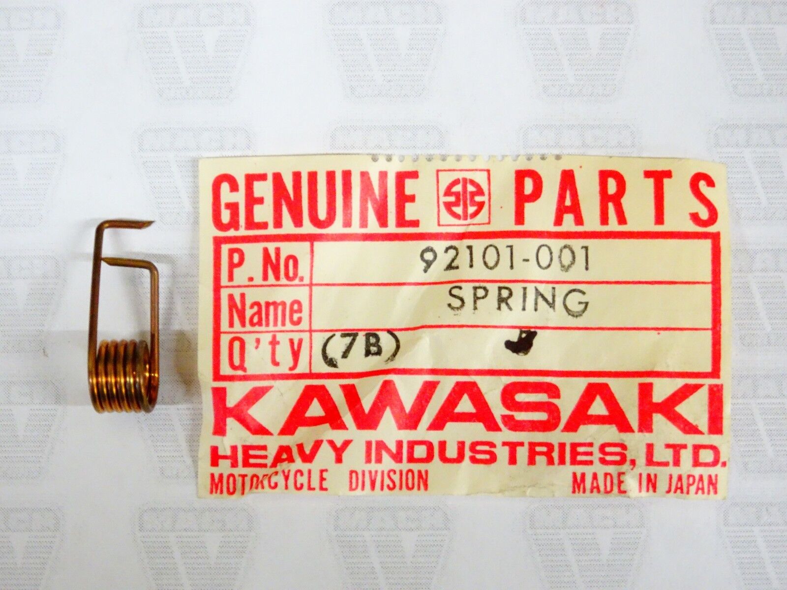

I had a break in the r/h HT lead and there was plenty of length to repair by cutting a bit off. I then came across at least part of the reason for the electrical interference.
In essence,this little spring clip sits on the end of the HT lead and locates on the top of the spark plug. The two rightangled spikes punch into the HT lead for connection. What looks like a plug cap is really just a rubber shroud and judging by the 'welding arc' that was jumping to the cylinder head,it's no surprise it induces electrical noise.
I hadn't come across this arrangement before and the spring stayed in the rubber shroud when I pulled it off,so it was all a bit :wtf: until I got the drift. Every day's a schoolday.
H1 - Imgur (6).jpg (250.79 KiB) Viewed 280 times
Incidentally,there are folk on the bay looking a tenner for this 'rare part' and it can still be bought off Kawasaki for £1.10. Folk forget there is a surprising amount of new old stock stuff still available.
