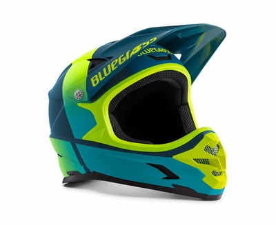

As always, the expense continues..
2021-08-29_10-30-43 by Steve Weeks - Flickr2BBcode LITE
New maxxis minion dhf fitted on his.
New helmet ordered and on its way too
