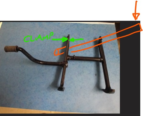

I'm taking the bent centre stand to work on Friday, managed to get access to the BFO vice+bench in the machine shop. Harder than it sounds Here's the drawing I sent.

Cleaned the centre stand up ready for attempted straightening. It's position under a leaky old brit bike meant it was covered in a not insignificant amount of oiley crap, but it only took a bit of paraffin to shift it.
Pretty much what it looks like. That twisted lug needs twisting back. It's steel, so I stand more than half a chance of doing it without it just snapping.

I bent the centre stand back into shape today. It was absurdly easy, just clamped it in a vice and gave it a tweak.
