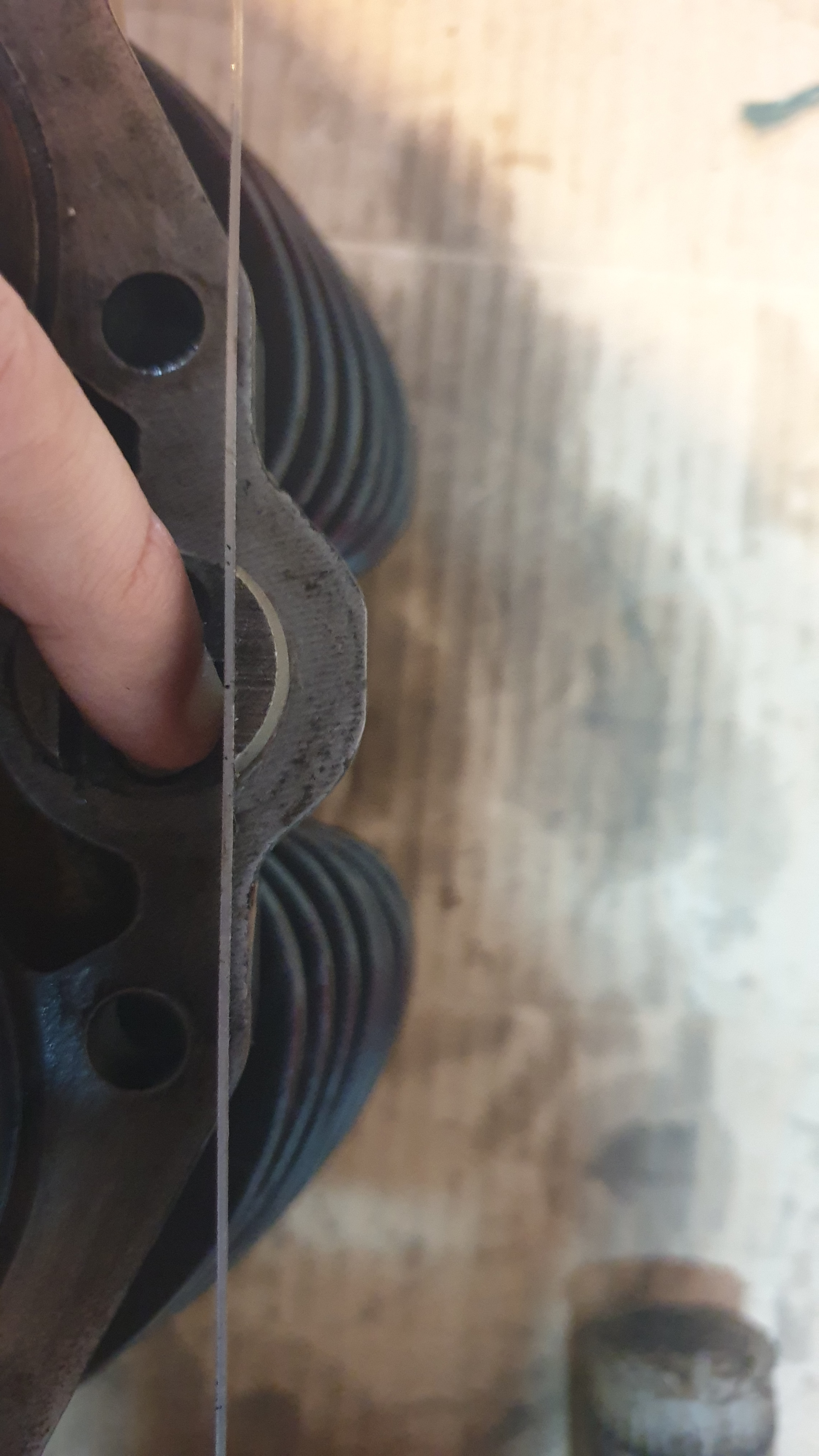

Tonight's job was refitting the tappet blocks. They're just interference fitted into the cylinders, you use a dedicated tool (basically a drift which looks like someone's o level metalwork homework) to drive them in.
I quadruple checked which is which though, the exhaust side has holes in it to allow oil flow to the exhaust tappets...which also have holes in.
I also tried just dry fitting the head to confirm I hadn't ballsed it up too badly.

Looking good - I’m sure you have already done so but doubly check the block is square in the barrel. The locating bolt will still drew in even if the block is a couple of degrees off (which can result in premature wear to the camshaft or followers)

They do look a little on the piss. I was gonna ask the old boys on t'other forum. I just kept whacking the tool until it changed from "dink" to "donk". I'm always a bit wary on things like this...whack it too hard and you'll break something, don't whack it hard enough and it doesn't go all the way

It's not so much that orientation (when it goes from dink to donk it's usually seated well), its more that it can rotate slightly in the hole as you drive it in. One method of checking is to put a length of square stock between the protruding ears and check it is square to the barrel on both sides if that makes sense- never try to rotate it once it's home, you have to drive it out and start again if you have any doubts
Re: Classic Triumph Bonneville
Oh right, see what you mean. I did that by eye, with a steel rule a reference aligning the holes, but it's not straightforward is it? I assume Triumph had an alignment tool in the factory or something.
I found you can 'steer' them a bit by putting torque on the drift tool while you whack it. I.e. twist it like a throttle grip as you go.

Nidge got me paranoid about the alignment of the tappet blocks, I thought I got them in straight but I thought I'd better check using his method. Good thing I did.
Fortunately you don't have to take them all the way out to straighten, you can just knock them out a bit and then "tink tink tink" on the tool as you twist it so they rotate as they go back in...
After that it was time to start the job I actually set out to do: Check the crush on the push rod tube seals. The push rod tubes are just sandwiched between the head and the cylinder. The seals at either end are very slightly bigger than the gap they go in - like most o rings - so they get crushed when you clamp the head down tight. To check they're gonna crush the right amount you build everything up and then measure the daylight between the underside of the head (silver) and the top of the copper gasket. After messing around with a few seals I got to a gap of 30-35 thou, which is about right i think.
I don't actually know what they did, but they give the impression they know what they're up to.
