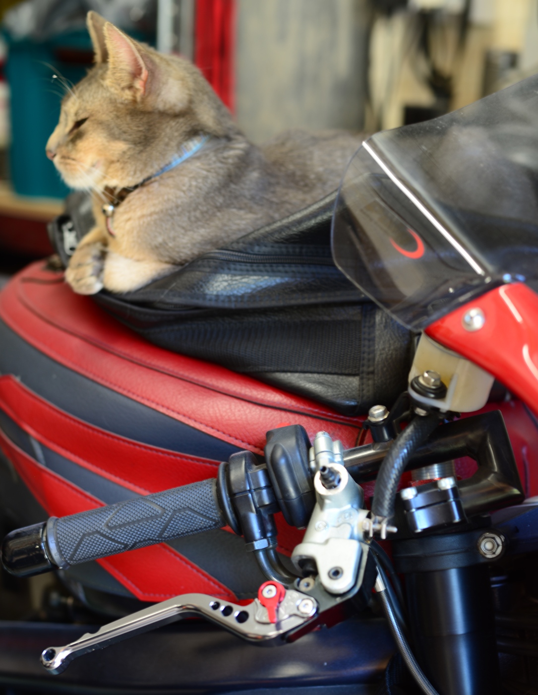

I suppose I ought to reintroduce myself after the length of time I've been away. Stuff kicked off in my private life immediately prior to the Pembrey track day in August (that I missed) and has continued kicking off to a greater or lesser extent until recently. But things are back on a more even keel now, so it's time to return my attentions to two-wheeled matters. And this forum, of course.
It's been nearly six months since I've updated this thread and really given much thought to mucking about with bikes, but I've recently recommenced work on making the Falco a more comfortable place to inhabit by altering the bar position. But first, here's a pic of the current throttle side setup (already non-standard).
The bar clamps will have a 30mm rise over the current clamps and the bars will have an extra 75-80mm offset from the current ones, so the bar position will be roughly 100mm/four inches higher and further back than at present, which is a substantial difference. Go large or go home is my motto...
I did the first trial fit of the new fork/bar clamps and handlebars yesterday, and it's become immediately apparent that surgery of the upper fairing will be required, Thankfully I've managed to acquire a pre-damaged top fairing that I won't feel as guilty about butchering. I got it from a mate after he'd had an off on his Falco on a track day a while back. The fairing is pretty well abraded and scratched on one side but is definitely repairable.
I will also need a replacement screen, as I have no intention to hack my exceedingly rare Puig screen about. As far as I can tell the fairing (and screen) will need cutting forward of the rearmost fairing to screen fastener point - that's at least 4 or 5 inches of the trailing edge of the side part(s) of the top fairing that will need to go. So most of what you can see in the photo of the upper fairing will have to go. I've also ordered a set of Gen 2 Tuono throttle cables from AP Workshops and will be in contact with Venhill shortly to get them to make me an extended choke/fast idle cable.
I'll also need a longer braided hose for the brake lines, but will use John at Hel Mobile for that. I can send him the current one and just ask for the same but 100mm longer on the top section. The clutch line is a funny one. Due to the way it's routed I think I may well be able to get away with using the current one. If not it's a fairly simple task to get a longer one ordered up.
So (at long last) progress is being made. Pictures when I actually have something to show...

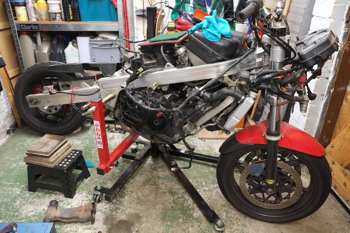

It's now the turn of the VFR to receive some winter-bothering. This spends most of its time in my garage in France, waiting patiently for us to visit. Over the last couple of years it's had to be very patient indeed...
The last major work I did on it was probably about 5 or 6 years ago and involved replacing the OE steel exhaust system with a Motad stainless replica that I'd bought about 5 years previously (possibly longer). The job was a royal PITA, as anyone who has ever had to work on a VFR's exhaust will attest. Getting the old zorst off used up my (extensive) vocabulary of profanity and fitting the new one was only marginally easier. And after all that, the collector box didn't fit correctly, sticking out too far rearwards. This had the knock on effect of making it impossible to re-fit the centre stand, and also meant that the scope for pushing the rear wheel forwards when unhooking the chain (prior to wheel removal) was compromised due to lack of clearance (Clarence) to the collector box.
So all in all, a bit of a fuck-up.

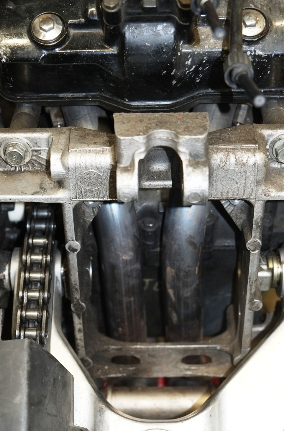

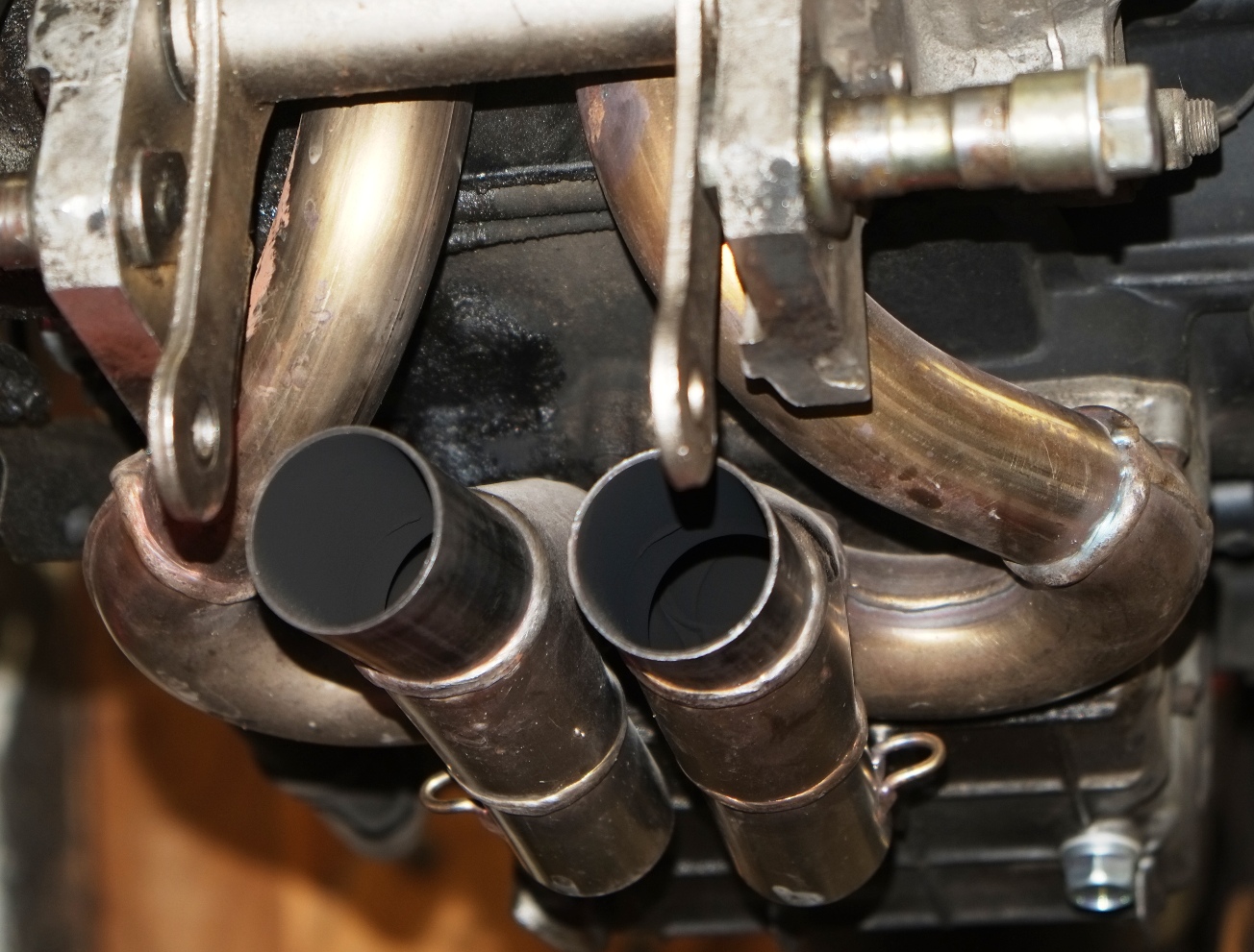

I'm determined to fix this issue, but on closer examination it rather looks like the Motad pipework is at fault - the really complicated, hard to get at bit that serves the rear LH cylinder, to be precise. And in the time between me buying the system and discovering the problem, Motad have very inconsiderately gone bust, so no recourse there.
Anyway, there have already been too many words with no photos, so here's one of a VFR in a state of undress mounted on an Abba Skylift in the stoppie position:
As you will notice the rear wheel, shock, tank, seat, subframe and all bodywork has had to come off and are in various locations dotted about the house. All that lot had to come off to give decent access to the rear headers. Here's a view from the rear of the bike of access to them (heat shield plate removed).
The problem seems to be that the rear LH header outlet is substantially further back than the RH side. No matter how I move them prior to tightening up, there is always a mis-match. The following photos will hopefully make this clear:
