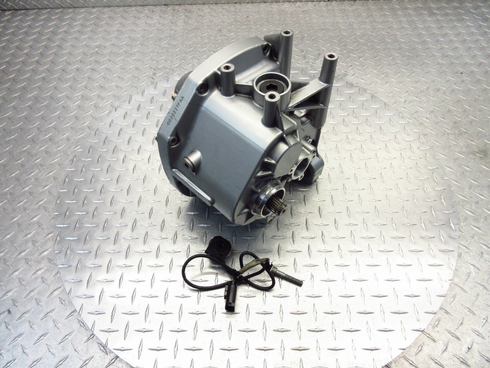

The fours 'posts' are what the centre stand mounts on. Unless you can get the bike up at height it would be a nightmare.

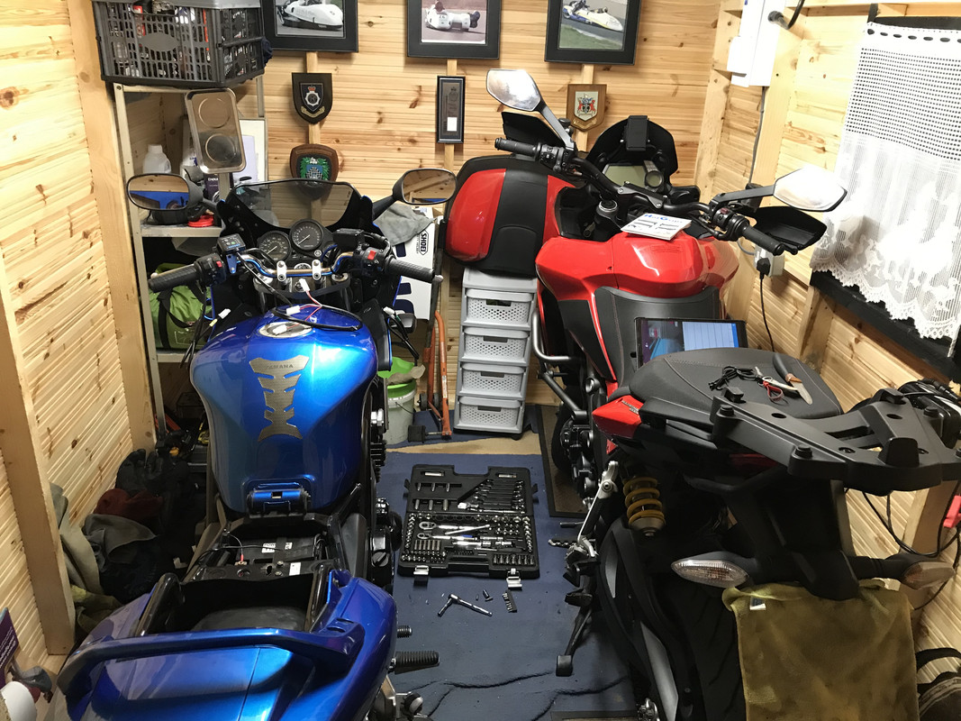

KungFooBob wrote: Thu Nov 26, 2020 7:24 pm Just to upset Weeksy...
I think I've used every tool I have... and not put any of them away.
Working in 'confined' conditions is interesting too.
I was fitting heated grips to the auld Fazer today and was reminded of your "confined conditions" picture. How does this compare??
